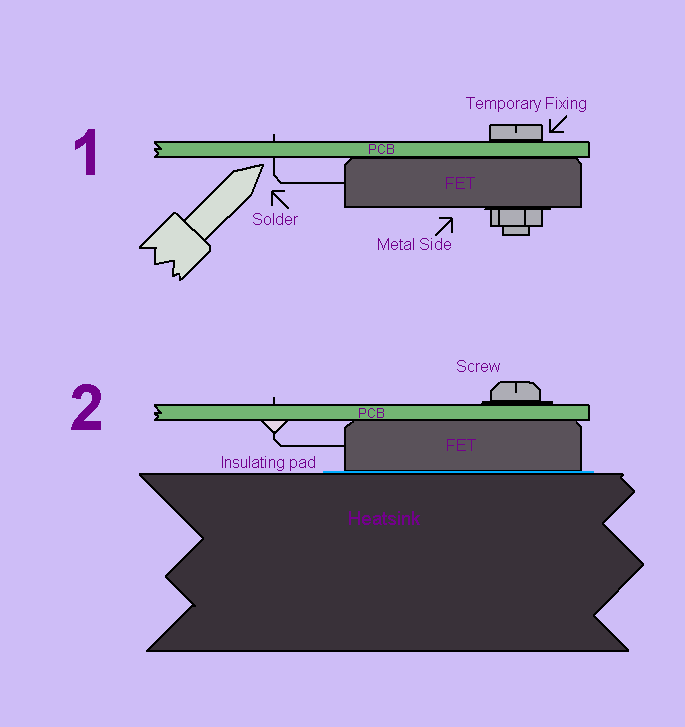

I had an email requesting advice on how to solder and mount the output FETs.
I followed these steps.
1. Using the PCB as a template I drilled the heatsink then tapped the holes for the screws I used.
2. I temporarily bolted the FETs to the PCB with the legs bent back through the PCB solder pads, and once tightened I soldered the FET leads.
3. I removed the temporary bolts, then mounted the board (with FETs in place) to the heatsink using insulating pads and heatsink compound.
4. I checked for shorts from FET to heatsink.
I hope the picture does a better job explaining it.
Cheers

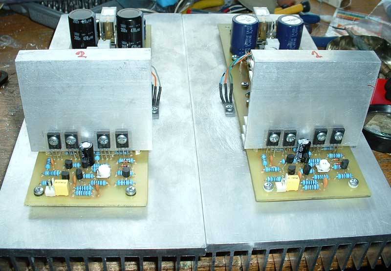

2 amp modules finished

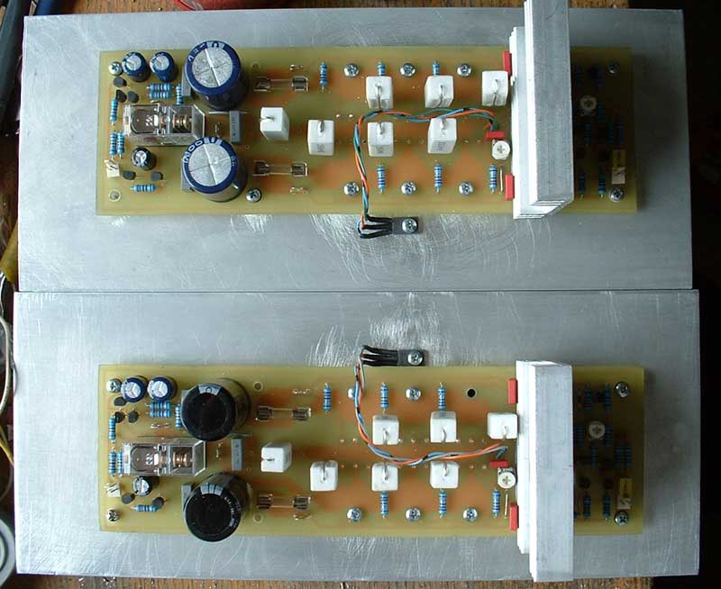

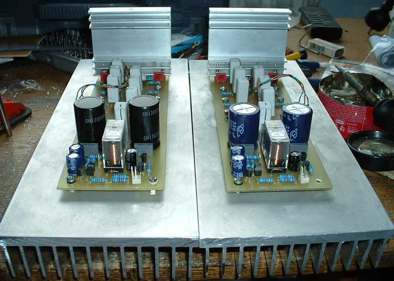

Hi Quasi and others,
I finaly fished 2 amp modules with DC detect.
I had some difficulties with heatsink cuting (so please don't ask me why is one shorter than the other ) :smash: :smash: :smash:
Here are some pics...
Regards...
Miodrag Pejin
pejinm,
Excellent pictures and very neat work. I really like the size of the heatsink for the driver/pre-driver transistors. I have a some quick questions:
1) Is there a special reason the screw at the end for one of the PCB to heatsink mount since taking the pics? I noticed at DC end of one of the boards (one pic the predriver/driver heatsink is marked "1" in red on top of the driver/pre-driver heatsink). there is no mounting screw?) is not being used (or just not installed when pics taken as you were sooo excited).
2) It also looks like one output device (on the board with all 4 PCB mount screws on one pic where heatsink is marked "2" in one pic) does not have a screw to mount the output device to the main heatsink. There is a source resistor there, so am I correct there is an output device there and you were so excited to take the pics before you finished with installing the mounting screw for the output device?
3) Are you still using the MEJ340/MJE350 for pre-driver/drivers?
4) What transistor are you using for the Vbe (T8)? I see the T8 you are using is a TO-126 form factor. I wish to use a TO-126 for the modules I build and expect I will do as you did by running twisted wired from T8 to the PCB connection points for T8.
5) Is there a specific reason the Vbe (T8) is mounted on oppsite sides of the same middle output driver pair for your two modules?
6) It looks like the 4 TO-126's are insulated an thermally mounted using a silcon pad, correct? Is (T8) Vbe mounted as well using a silcon pad?
7) Aside from using a different device for T8 than the schematic, did you use any other different parts (transistors) or values (capacitors, resistors) than the schematic?
Again, excellent work pejinm.
I will be most interested in how warm/hot the pre-driver/driver heatsink of your modules are once you do some testing, stressing and listening of the modules. Why in part I ased if ther are any other different parts used questions above. I am partial to oversizing the heatsink as you have done. You have given me an additional type of heatsink that could be used for these four TO-126 devices.
I hope your modules do just fine in the initial power up and setting of the bias. Based on your careful and clean work so far I feel you should have no problems in powering up and setting up these modules for use.
I am still sourcing some parts before I can finailly dig in myself. I am way behind in making updates to the project web site I created. I also need to take a bit of time to modify the PCB to accept a larger physical size PSU module supply filter cap. I just happened to run into a DC circuit just by pure chance (as usual when not looking for protection circuits) that has LEDs for "Operating" and "DC" and want to see how easy it will be to add these to the DC protection circuit quasi used. I have a few ideas how this can be done.
I hope you enjoy quasi's design with many hours of enjoyable music.

Hi John,
Thanks for your comments.
1) Hole drilling problems, I have't followed Quasis example from earlier post...
2)...
3) Yes.
4) I used BD139 becouse it's easier to mount (and maybe TO-126 case have a smaller termical resistance).I have't testeted the amp yet and I don't know how it will work...If someone have doubt in this please give some advice.
5) It's becouse heat is traveling upwards and it looks simetrical.
6) Yes, yes.
7) I used 12V relay I just changed the value of 470uF cap in dc detect to 100uF and the dc detect works fine (as Quasi sugested). Also I used 2SC2240 toshiba transistor instead 2SC1845 for T1 and T5.
Again thanks for your comments, and comments from the others are welcome too.
Regards
Miodrag Pejin😀

Nice work Pejinm
_______________
Good to see your amp project well under way. Have you powered up any modules yet?
I hope you don't mind if I make some observations.
1. I noticed you are using a link instead of an output coill. That's cool. Think about using a thicker link though.
2. I can't tell if the two 22uf 50v capacitors in the DC detect section are bi-polar (non-polar) types. They might be, just can't see if they are from the photos.
Nice neat work. I look forward to seeing more pics.
Cheers & good luck
Quasi
Hi Quasi,
Thank you for your comments!
1)I have't test any of the amp modules, I need to build power supply and take care for some other things. I will put a coil later. I thought to use one from junked electronics but I did't find it.
2) Yes the caps are bi-polar 22uF.
I'm glad that you like my work. I will put more pictures as soon I progress with amp.
What do you think about BD139 in place of T8?
Will 2SC2240 work fine instead 2SC1845?
Miodrag Pejin

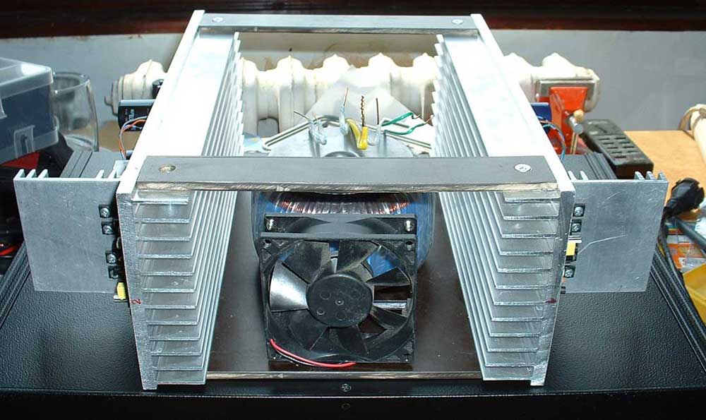

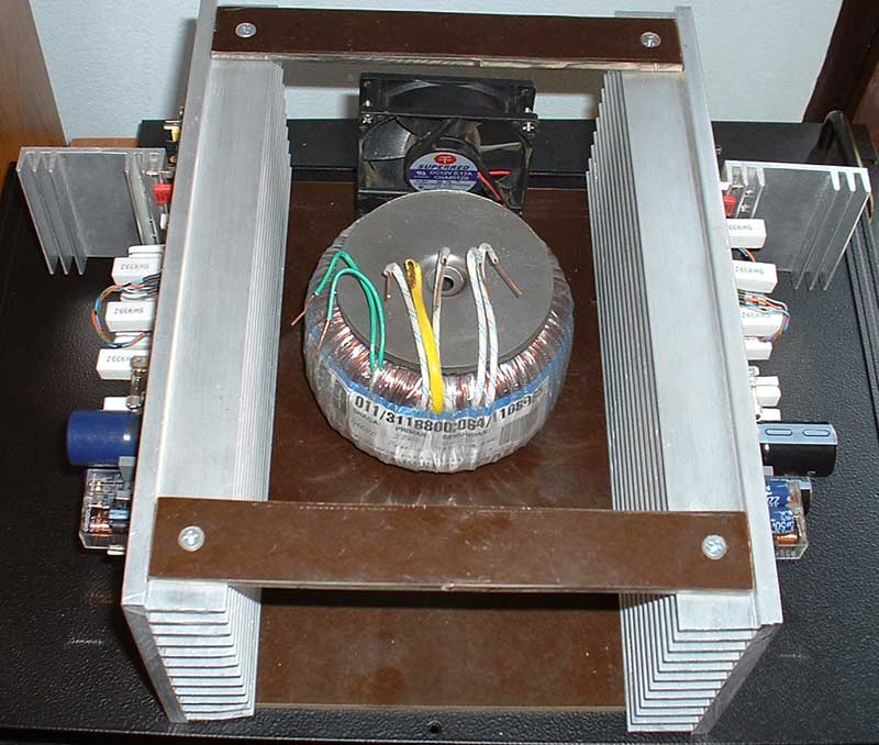

Nice work again Miodrag,
I like the ideas you have about the layout, particularly the mounting of the transformer between the heatsinks. The heatsinks will provide a degree of shielding.
I used a mains rated AC fan in my amp. I find these are quieter and can be slowed right down using a series high voltage capacitor. The fan in my amp is very quiet but still moves enough air around. I had trouble achieving a good result with a DC fan.
The 2SC2240 is a very good substitute and will give great results.
Cheers

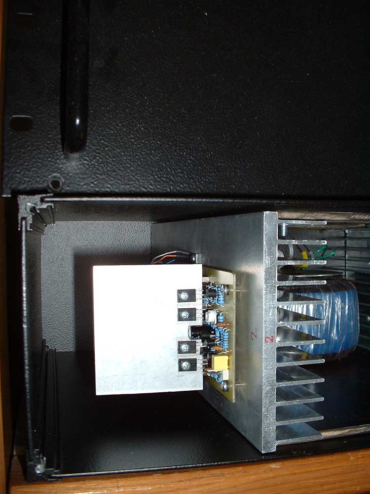

a couple of suggestions.
The fan could be doubled up, one to serve each channel. Then duct the sink fins from the fan to the exterior forming a tunnel exiting at the rear. It would be slightly easier to achieve if the fans were rotated 90 degrees.
Secondly, the driver sink is taking up a lot of case space. Could your extruded sinks, if heated, be bent in half to form a 90 degree angle? Alternatively, could the transistor legs be bent to allow the sink to sit alongside the PCB next to the input end i.e. flat side towards the PCB next to but above the components.
Finally, the suggestion that placing the transformer between the sinks and screening the active stages only works for electrical fields and then only if you complete the Faraday cage around the whole of each of the active sides. The case could be electrically tied into the sinks to form those two Faraday cages.
Hi Quasi and AndrewT,
Thank you for your observations.
Quasi:
You are right about the AC fan and I will probable use one like you do.
AndrewT:
I'm not concern about the space in case. Here is the picture of amp in case, as you can see driver heatsink got good clearance. Also the Faraday cage is complete around amp module.
