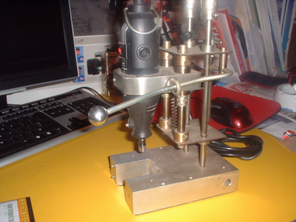

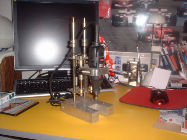

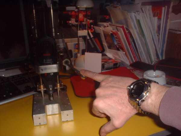

For QUASY & Others
You have touched me with Drilling forum. This is My DIY drilling stand. This stand was made durig NATO bombing of my country in 1999. Never mind! The main thing about this stand is axial/radial bearing. With this stand, I never broke any drill bit, and I can even drill with the force of my little finger. Of course the machine is the world famous DREMEL. I attached some pics.

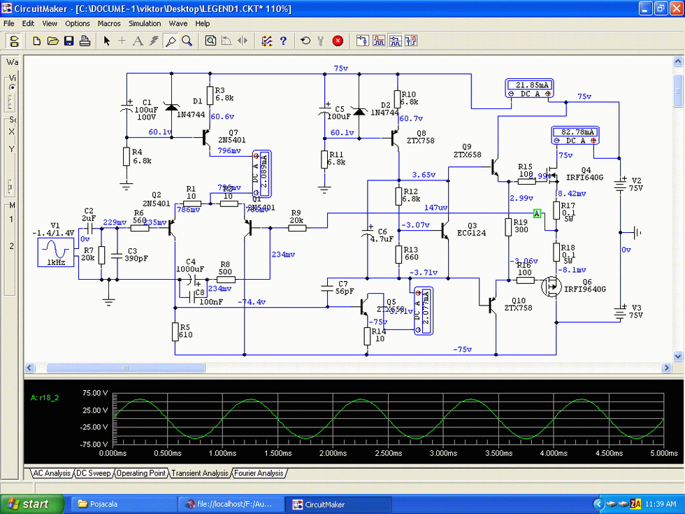

Hi
I designed this amplifier.What's your opinion about my work?!
ECG124 is replased with BD139,ZTX are replased with MJE340&350 or MJE15030&15031,Q8 and Q5 are replased with 2N5401&2N5551,Output transistor's are IRFP240&9240(four pair's).
R5 is trimmer and his value is around 1.5K or 1K.Value of R19 will be 270 0.6W(each mosfet is biased with 2.5mA)
