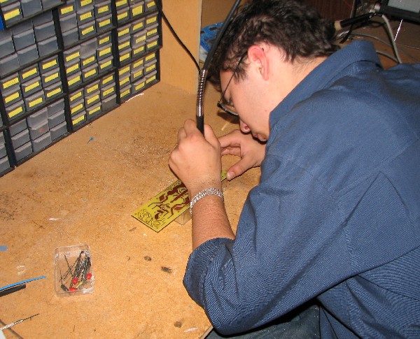

Construction has commenced...
PCB drilling in the Quasi store. Piccy of audiophile's son drilling 2 new PCB's (supplied by Quasi).
Cheers
