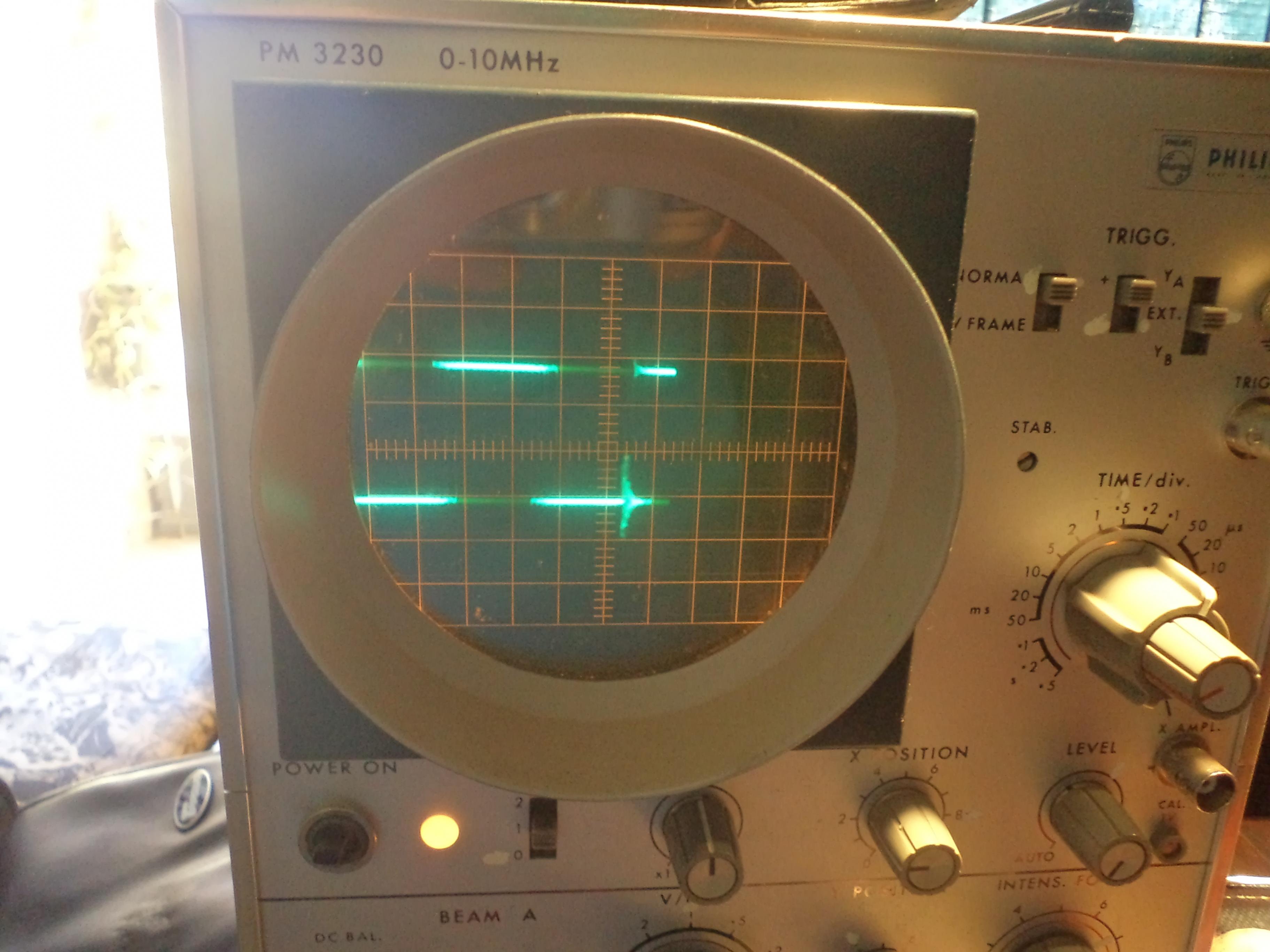

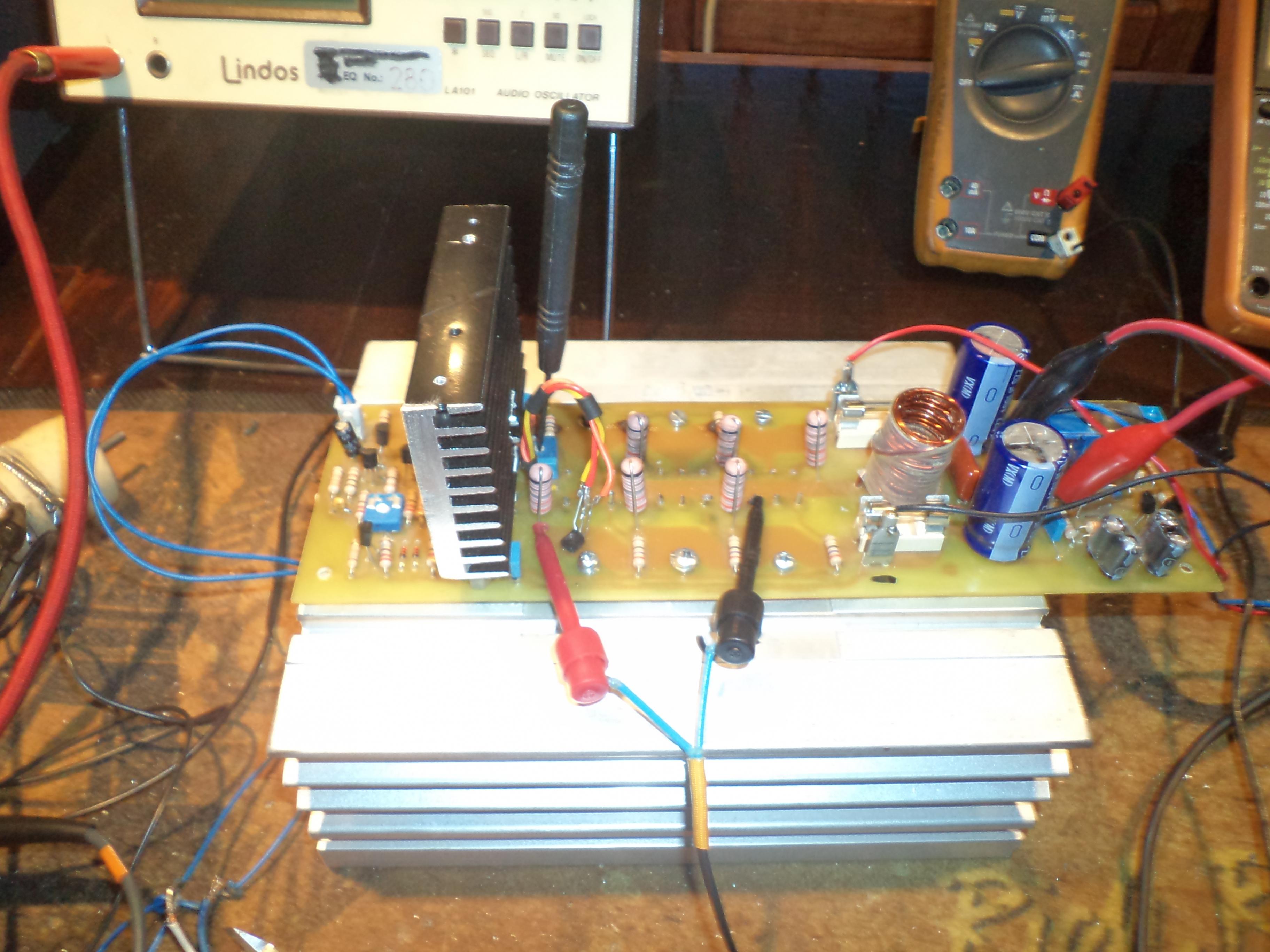

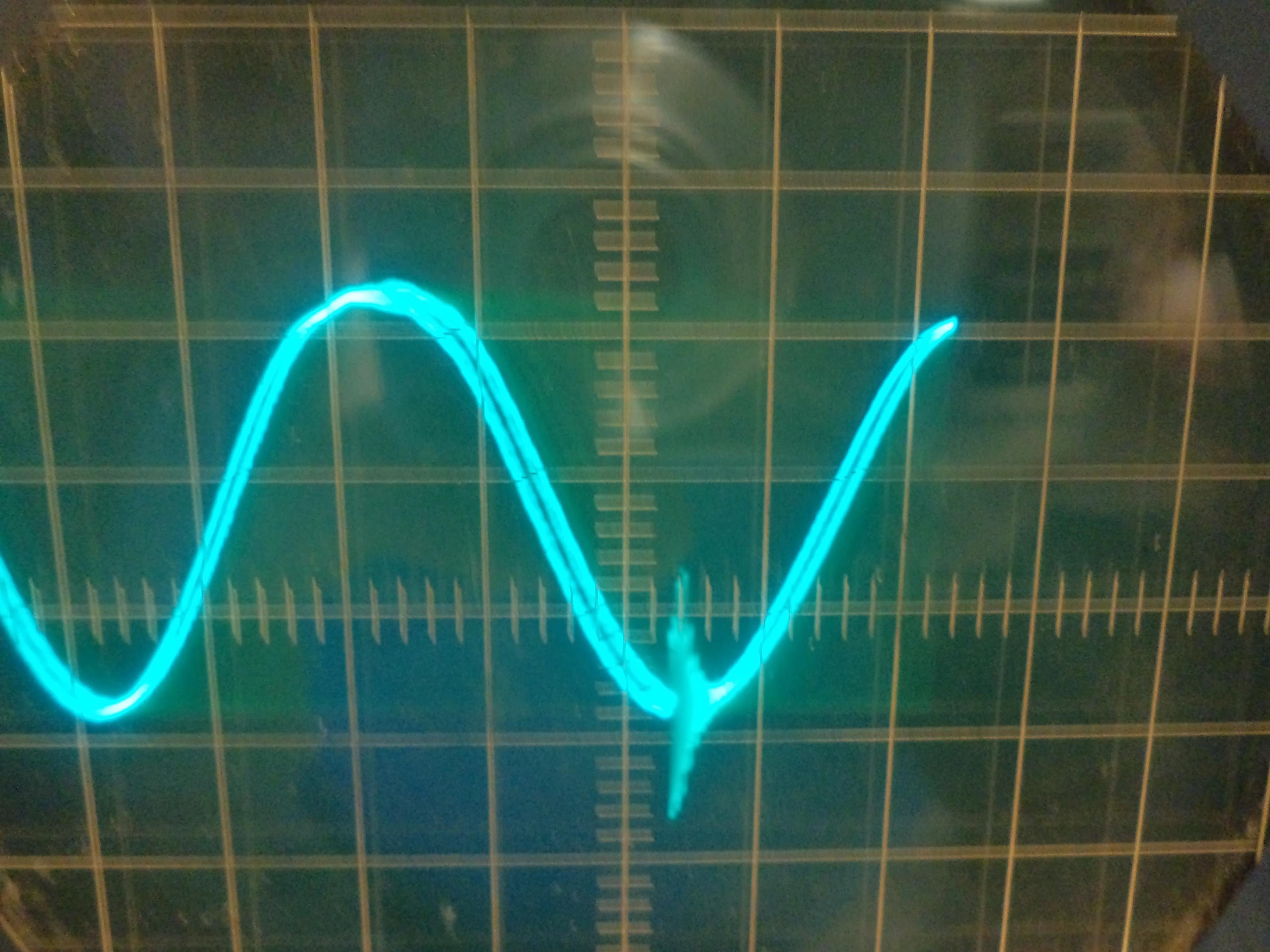

I have had problems with the amps which run OK when they get a low input signal and even does not sound bad on a speaker, but as soon as you increase the level then at some stage the bias starts to run away and the fets that self destructs causes the dog to jump. I have decided to put a scope on and and I find that there is oscillation on the output. On the square wave you can see it better. With or without load. Is there any advice how to cure this problem. With compensation caps ?
Help will be appreciated !

And it is there with and without load in the same way and amplitude?
Does it change with the output level? Or with moving the cables? Chaning Iq of output devices?
Your zobel is then 10R + 68nF? Type of 10R?
Are those upper emitter resistors burned?
BTW: I'd cut off the OPS to test the IPS first wether it's present already there.
Cortez, the previous resistors burned when the bias ran away, but all components are new. I understand about removing the fets and see if the rubbish is coming from the frontend or the output stage. If I connect the scope directly before the zobel it is the same as well, so not the zobel causing it. With or without load, it is the same. I will remove the output tomorrow and see what happens. C5,6,9and 10 are 0.1uf 100V poly caps. Do they need to be a higher voltage, as the rails are 61 +-. Can this be a cause for oscillation ? If IRC C11/12 must be at least 160V caps.

Seems I have got this bugger fixed. I had two problems. The first were the IRFP460 fets that I have used. Their capacitance is too high and they were second hand stuff. One out of three pairs would just blow up for no reason at all. They were recovered from ASM switchmode modules that are more than 30 years old and I think they were stressed. I replaced them with brand new IRFP250.With the other problem I drilled a small hole through the pcsb and mounted the vas transistor on top of one of the output fets. The bias is very stable this way. DC offset 0v and it sound good on the ear as well. Thought I just give some feedback, Now to fix the other channel and thanks for the people that helped. 🙂

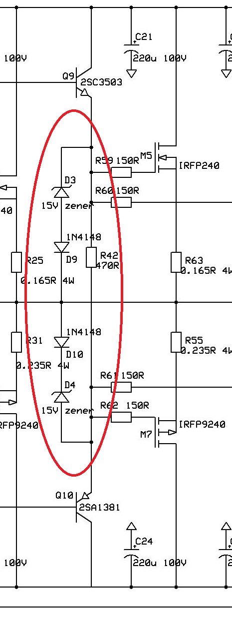

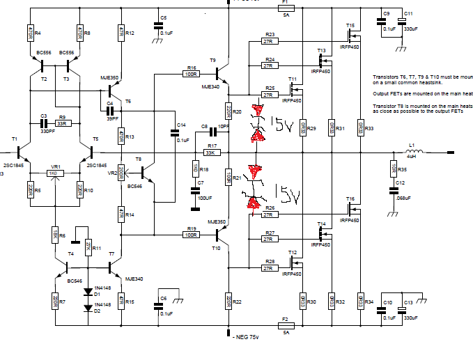

Gooday, can someone plse confirm that this is ok. I don't want to damage working boards due to my stupidity. The Rail voltages are 61Vdc +- and the zeners will be 1watt 15v that will be added where shown to protect the fets. Feedback will be appreciated. The fets are IRFP250N devices.
