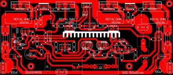

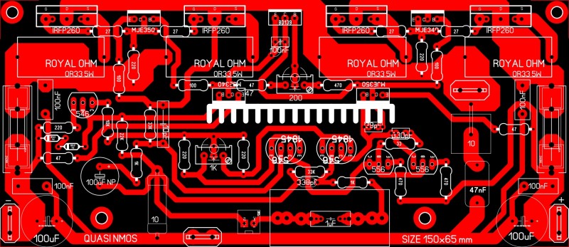

Well, rail voltage is still 50V and you should simply add more output transistors, like nmos 350 version.
I also made a layout with 2 pairs of FET, see below
