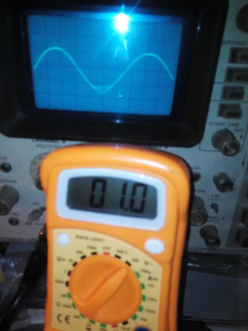

negative oscillation.
Is that due to clipping?
What load and what voltage?
What is the voltage at the output when the 8r0 dummy load is connected?
The amp can not work well because you need about + 10 V / bootstrap to drive negative rail for full rail swing / perefct sine wave without oscillation. Thats why quasi make Acrtk Nmos Amp. This amp have + 10 V to fix this problem, check the schematic you will see
Class D work same, using 2 N Channel Mosfets and have +12 V Bias / Bootstrap for drive negative Mosfets
I don think so... parasitic oscillation it's not in ralation with +10V bootstrap...... with the 39nF on the gate sinewave is perfect.....!

I don't tink this is a problem of clipping, you can watch the photo. Parasitic Oscillation i'ts another problem, I believe.....
I will soon post other photo with te cap connected.

The scope shows a sinewave with oscillation when an 8r0 dummy load is connected.
What is the voltage across the load.
Either Vac, or Vpk, or Vpp?
Not much, in this moment I can't measure.... about some volt, but I remember 170 mA.output offset is measured when the output has no load.
@ 13.9Vac output there is no oscillation !
@ 1Vac output there is the interference again !
13.9Vac = full power. That's 24W into 8r0.
In fact, seems a little bit poor... I not understand the reason.@ 13.9Vac output there is no oscillation !
But @13.9 the absorbtion is 0.8A for the positive rail: (0.8 + 0.8 ) x 130V =208 W. It's correct?
No.
That's not the way ClassAB works.
Measure the Vdrop of the emitter/source resistors and use those measurements to determine the currents. You will need a scope and an isolating transformer to let the scope ground link pull the resistor voltage to the scope voltage.
