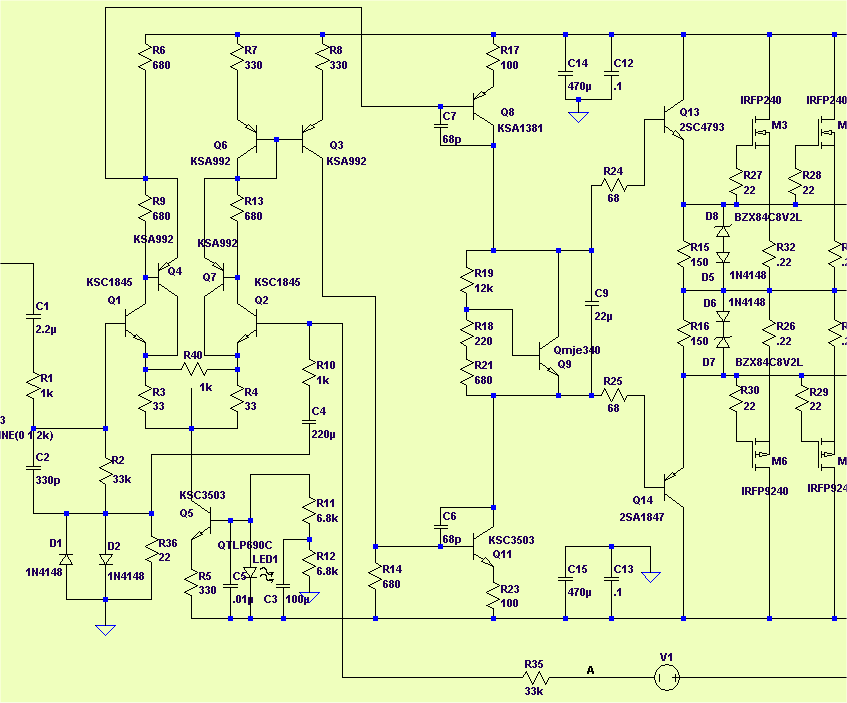

Greetings,
Attached is the schematic for the Nmos 350Mk II.
In this schematic some contributors will recognise their own suggestons for improvements. To you I say a big thank you.
Comments and suggestions for further improvement are of course welcome.
Major changes to date include;
- Cascode second stage to improve the linearity and speed of this stage.
- replacement of the 100 ohm resistor in the driver stage with 4 diodes.
- LED based constant current source with enhanced filtering.
- fuses shifted outside of the output driver gate loop.
Cheers
Quasi

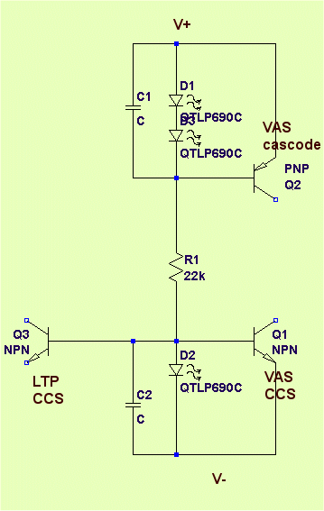

Wonderful improvements... especially CCS and VAS cascode..
Allows for the use of "smokin' fast ,high Hfe T6.
Did the same on mine but complimentary cascode with "magic resistors"😀 and 6mA VAS with bigger Vbias cap. (cooler, smaller
HS)
OS
does C5 connect to negative rail or to ground?
Wow ,can't believe I missed that one..horrible PSRR..
Other changes/improvements R11/12 6K8 for 5 ma to
RED led, Eliminate R7 entirely,change R8 to 330R for 4mA CCS.
(have 4 of these working at home at the moment.)
Also, use nonpolar EL for C9 (still small, bye bye D2/3)

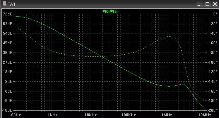

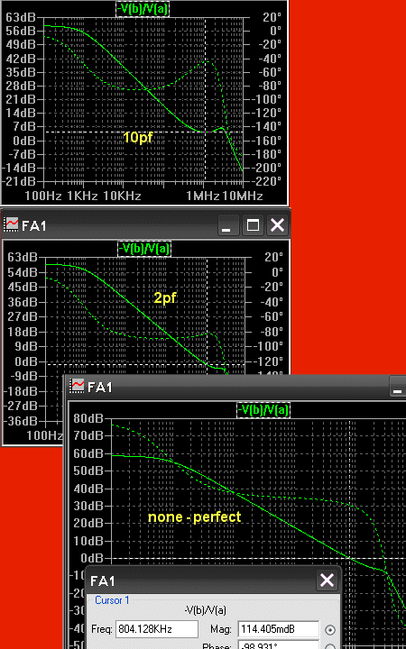

and I always wondered about C11 ,at 10p , way over-
compensated ,2 pf works the best.
At 10 p , huge "bump" at 1MHZ (phase margin and OLG)
almost a 2 pole response.
(see below)
OS

R7 may have to go to 240r or even 220r to get 4mA of tail current. My red LEDs and BC5xx leave ~900mV across the current setting resistor.
How do you check balance in the LTP when that VR1 is in there?
Os,
please post comparative graphs for 0pF, 2pF and 10pF, so that we can recognise what happens here.
Al tests done with my FA1 (same as quasi 2) changed VAS to
MJE's used IRFP240 as OPS, omitted C3/R6 as they are
a low pass filter (good to add them back for high Ft
MOSFET) but for test of LPT/VAS loopgain/ phase they would
throw things off.
OS

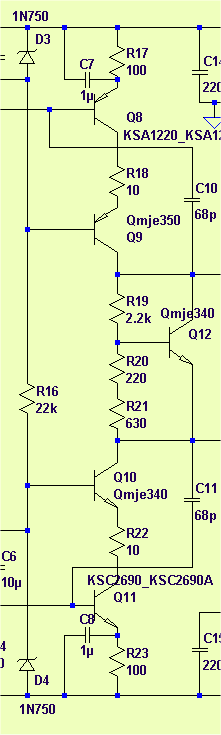

brother of quasi still lives (with better CCS)
Soon I wil replace with the "beast" .. if you can use any ideas
from it (see below) I owe it to you. It runs in the real world with
BJT's now ,so It is proven.. I'm on the diamond buffer "kick' now.
so feel free to use it. CFP and balanced operation are its
strengths and I am only going to use it for my 1 sub.
(see attachment)
OS
peranders said:
C11 should be between base T5 and the VAS, collector T7 or T9. The purpose is to let the output stage run without feedback at very high frequencies. The value should probably be more 33-100 pF.
That's another way of doing it.
The capacitor shown gives phase lead and is another (IMO better) way of doing it, at least for an amp relying mostly on miller compensation.
