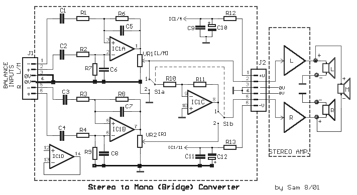

i know that soft start,dc detect are included in nmos/actrk hope someday nmos/actrk can be bridged just by a selector switch/slide switch,means diy'er can easily choose both application according to what he need just like those marketed amplifier these days,with stereo or bridge mono selector
here how it works,
from sam electronic circuit,
This is a very useful circuit for those who want to transform a stereo Power Amplifier, to mono, bridging two channels from him , reversing the phase of the one power amplifier [R] and the polarity, with these connections we can have 4X times the output power (double the output voltage ) . For example : if we use the circuit to a stereo amplifier 2X50W, will have 1X200W output , if power supply assent.
How to Work?
In the connector J1, we can connect two type plugs (XLR) Cannon, and input of two channels it's symmetric (electronic balance). With potesometer VR1 and VR2, we regulate the level of each channel separately (stereo), switch S1a-b [place 2]. When bridging two amplifiers, with the switch S1a-b [place 1], then the level him we regulate only with the VR1. The department of channel [ R ] is suppressed and the input is given only in [ L ] channel. Simultaneously inputs in use the inversion department of phase round the IC1c, driving second power amp. [ R ], with reverse polarity, from [ L ] channel. The output now it should him we take from two [+] positive output final amplifiers. In the circuit it appears association the loudspeakers and for the two cases (stereo - bridge). In order to we have results of precision, should the resistances of input differential amplifiers, be metal film 1%, pontesometer, the capacitors and switch S1, good quality. The power supply of circuit is ± 15V, stabilised. If you want to use the inputs, no as symmetrical (balance), but as asymmetrical (unbalance), you can connect in 0V, the negative inputs of signal J1/1 [L/mono] and J1/5[R ]. The asymmetrical signal now enters in the positive inputs, J1/2 and J1/6.
Part List
R1-2= 47Kohms C1-2= 1uF 100V 5% IC1= TL074
R3-4= 47Kohms C3-4= 1uF 100V 5% S1= 2X2 SW.
R5-6= 47Kohms C5-6= 33pF VR1-2= 10Kohms Log. pot.
R7-8= 47Kohms C7-8= 33pF .
R9-10-11=47Kohms C9-11= 100nF 100v .
R12-13= 22 ohms C10-12= 47uF 25V .
Áll metal film 1/4W 1% J1-2= 6pin Connector .

No,engel dela pena said:......... bridging two channels from him......... with these connections we can have 4X times the output power (double the output voltage )
double the power into double the impedance.
From your example 50W+50W into 8r0 becomes 100W into 16r0.
But, you can feed the 50W into two 8ohm speakers and still get a total output of 100W. You have gained nothing by bridging.
The new schematic shows Ic1a & 1b as inverting, but with the feedback to the wrong input terminal.
Can anyone confirm that these two Ics have been labeled incorrectly?
If these are incorrectly labeled then the unbalanced jumpers go from j1 to 0V and from j5 to 0V.
Finally, the inputs to each channel are not balanced. Either use transformers or add in the extra opamps for electronic balancing if that is what is required to match your source.

andrewT,
Those schematic are not mine and its not my axplanation how it works,just downloaded it from the said site,
anyway,maybe i'm just too much into bridging diy people,
its just because when i compare my uncle's pa sound when he change stereo mode into bridge mono,i realy feel the difference much power i can hear,i'm speaking of crown amp,but its not only in crown,sometimes japan made and china made brigable amp i experienced.
so to anyone who can help bridging an nmos or actrk please share to this forum
