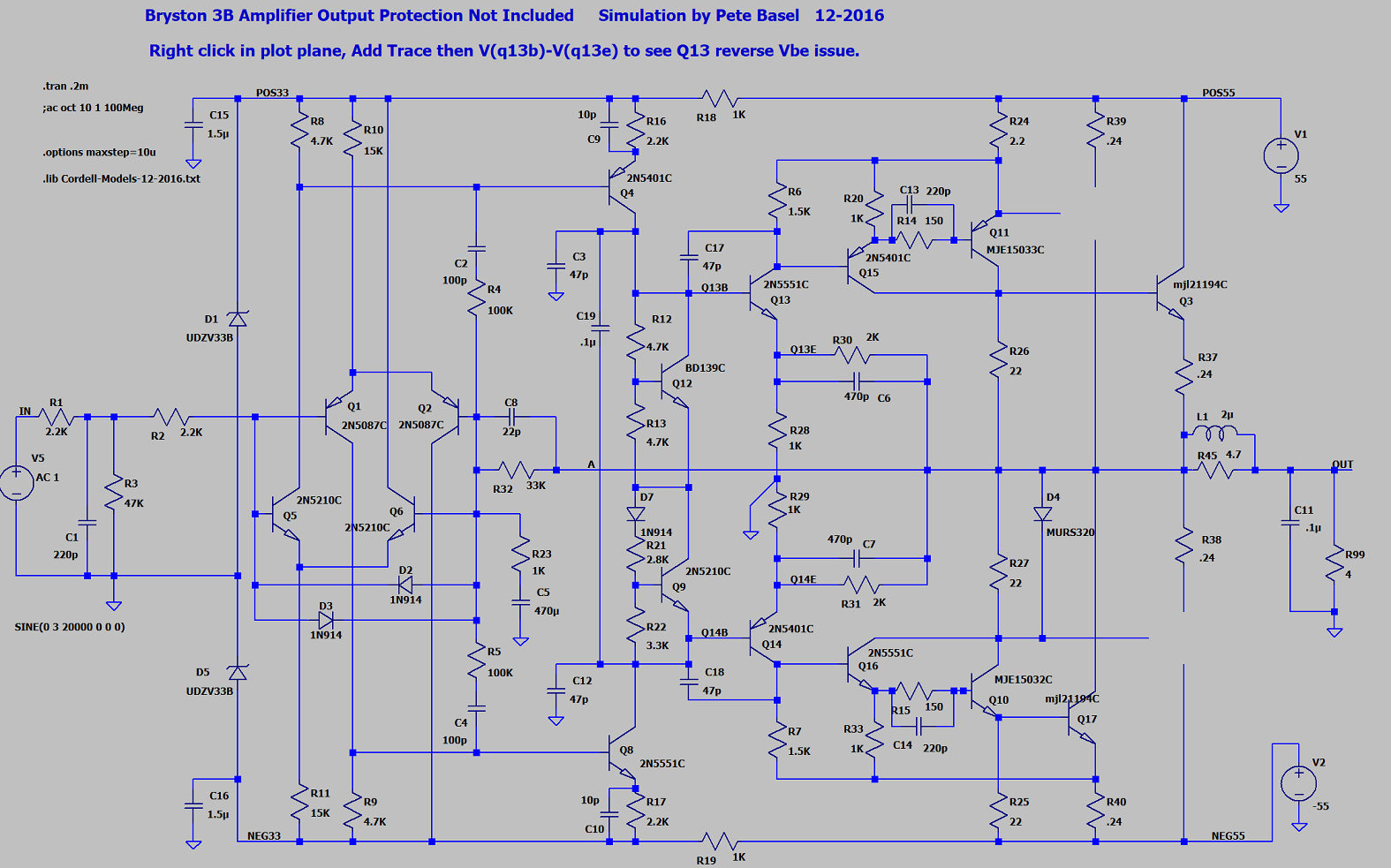

A CFP is sensitive to the drive impedance from the ~VAS because a high impedance means that the ~"poles" of both devices are too close together. An active pull-off vs a resistor on the OP may work but gets complicated, a tricky cost/benefit decision. And we have to watch for clipping stability.
This is what I was talking about with an NPN only output stage, I snipped out the PNPs
added a diode. Didn't try to run the simulation but I believe that it could be made to work
as flawed as it might be. Use whatever front end you like, you could leave it with gain or not:
You could make the top half a normal triple EF, then set the lower half to unity gain.
While it is tempting to remove Q15 and 16, take a look at the clipping/sticking behavior with
and without before doing it.

You are correct about the CFP being sensitive to the VAS source impedance. VAS circuits with Miller compensation tend to have a low output impedance at the higher frequencies where it matters. However, sometimes that impedance can peak at some higher frequencies. For that reason I often put a Zobel series R-C network on the output of the VAS shunting to ground. Sometimes 100 pF and 100 ohms is enough of a shunt. Simulating the output impedance of the VAS circuit can help with this issue.A CFP is sensitive to the drive impedance from the ~VAS because a high impedance means that the ~"poles" of both devices are too close together. An active pull-off vs a resistor on the OP may work but gets complicated, a tricky cost/benefit decision. And we have to watch for clipping stability.

I agree with your concerns. Bryston amplifiers have a pretty good reputation, but that particular Bryston appears not to be a very good design.It still requires Q11. That type (or anything like it) wasn’t around way back when. Best you could do was an MJE350 or one of those TO-66 versions.

It sounds like you've built all sorts of versions, so it is just another alternative. I was going to say check
out the Crest that Bob mentioned but it looks like from your response you are familiar with them.
I think that a problem with CFPs is that stability is difficult enough but if you let the bigger devices saturate
then it becomes worse, so keep both the driver and outputs out of saturation.
The basic Bryston that used a unity gain triple like that (with MJL3281 and 1302 off each driver) was pretty good, reliable, and stable. The circuit above is about a bridge and a half too far.
Modern-day Quasi’s don’t need to do anything “stupid” - one can drive the upper bank with MJE15032 and lower with 15033 and not look back. Turn it on and it works. As long as the rail voltage is constant. With todays sustained beta outputs triples aren’t “necessary”, although it doesn’t hurt when driving four pairs of speakers with an amplifier.

You asked for a quasi that doesn't oscillate for your stock of 2N3773s so I gave you one, but nevermind.
These are good points, but I am not sure there is any benefit to a modern-day quasi.I'm talking about a modern day quasi, you need drivers no matter what so Q11 should not be a problem.

The 3-EF Locathi output stage is what I usually use. It costs an extra Vbe of headroom compared to a double, but the slightly smaller headroom tends to keep the output transistors a little further away from saturation against the rail with maximum signal swing. The other thing that is a bit more challenging with the triple EF is that there is an additional Vbe to contend with regarding thermal tracking. For this, I put the predrivers on a common heat spreader along with and additional Vbe multiplier transistor. This all results in a twin Vbe multiplier bias spreader.
As an alternative for a triple, one can make the pre-driver/driver a CFP. Yet another approach is to make the pre-driver/driver a diamond buffer, but this requires the addition of a pair of current sources to supply current to the drivers.

So-called sustained beta power transistors are nice, but doubles still do not cut it for supplying the needed amount of total output stage current gain if you are serious about high current output capability with sufficiently low loading of the VAS for low distortion.The basic Bryston that used a unity gain triple like that (with MJL3281 and 1302 off each driver) was pretty good, reliable, and stable. The circuit above is about a bridge and a half too far.

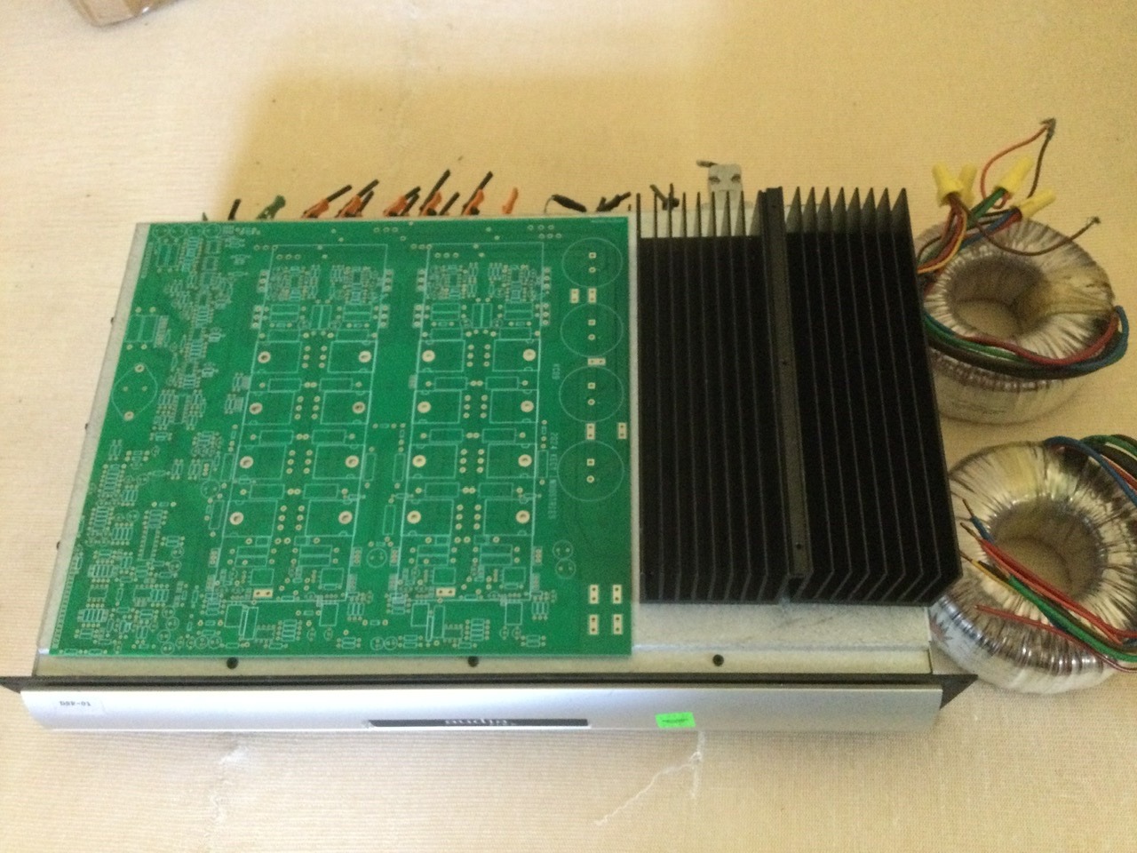

I have a working PL400 that I am refurbishing/redesigning. It will get a completely new IPS/VAS, but I am tempted to keep the Quasi output stage because TO-3 complementary power transistors seem really hard to find, and adapting the physical design to use TO-264 plastic devices seems difficult. The PL400 was biased almost into full class B, with only a few mA of idle bias. In the working version, upping the bias to about 15 mV across the 0.22-ohm emitter resistors significantly reduced the distortion, as expected. I think I can revise the quasi to act more like a PNP than it currently does. We'll see. The design also needs better bias tracking, so I'll use a twin Vbe spreader in the revised design. I'll also add a loudspeaker protection circuit which, God knows, every PL should have had! I'll also add an output L-R network.The old PL400 isn’t hard to out-do with a modern double. I’m not saying I’d do it, but it’s possible. You’re right - it’s not that good of a design. My first PL-ish homebrew used EF3 with 80 MHz C2565/A1095 drivers and D424/B554 outputs but it used lower rails (58V) and a current source loaded VAS. And the op amp stage from the S2. Sounded really nice, and could be tortured bridged at 4 ohms. I built a stripped down version for home use with EF2, same voltage, only 400 VA transformer, half as many power transistors. But I boosted the VAS from 6 mA to 25. Still sounded better than my stock 400. It just ran a 10” 8 ohm 3-way at dorm-room volume. There were another 4 iterations over the years, ultimately becoming more like the BGW than the PL.
Any thoughts on how to fit it with plastic output transistors will be appreciated. I have a PL700 that I will use vertical power MOSFET output devices on, so I will have to confront that issue on that design. I have thought of one way to do it, but it is not pretty and gives up some thermal conductivity.

MJ15024/5 or 21193/4? Not that hard to find these days unless they’re out of stock at the moment. Adapting to flatpacks IS the problem with updating the design - how the hell do you mount them? Flatpacks are the only option for sustained beta high fT outputs. But all 15024/5 driver and output does work pretty well. Unfortunately, those 80 MHz drivers wouldn’t be possible. One could use four outputs and shoehorn MJE15032/3 drivers in there somewhere, perhaps on an internal heat sink or on some blank space between outputs. And use that separate thermal tracking idea.
The original 66546/PL909 combo didn’t like to be biased up to anything close to optimum. Oscillations appeared when output hits around 4Vp-p. Back it off to zero or crank it till it’s hotter than the blazes of hell and damnation and it went away. The one I rebuilt with all 2SD424’s and the others that went full comp were stable at any bias.
I'll look into the availability of those power transistors in the TO-3 package for the PL400 upgrade after I see what I can get out of the existing output stage combo. Now that my new book is in print I have some time to putter around with various projects that pose technical challenges.
I did not see any instability when I increased the bias in the existing PL400 output stage, but I am not surprised to hear if there were oscillations in some cases, since the high-frequency rail bypassing is not great and there is no output coil. Of course, the Quasi design can be improved to be more stable.
For the PL700 vertical MOSFET design I am considering, I will put a 6-3/4 X 1-1/2 X 1/4 inch aluminum heat spreader mounted behind each of the four heat sinks on the inside of the chassis to mount the plastic devices. The heat spreader will be bolted to the inside of the steel chassis with a heat sink compound interface. The finned heat sinks will also be mounted to the steel chassis with heat sink compound on the other side. Heat will thus have to pass through two such mountings to the heat sinks. I am hopeful that the large area of the interfaces will provide an adequate thermal conduction path.
With the heat sinks at a maximum human-safe temperature of 55C, I am hopeful that the maximum internal heat spreader temperature will not exceed 70C, under worst-case conditions, allowing for a 15C thermal loss through the Aluminum-Steel-Aluminum interface. These are just guesses off the top of my head. Each aluminum heat spreader will form an output stage module with 2 or 3 N-channel/P-channel pairs. I'll see how it goes. I'll first do thermal tests with one of the modules mounted in the unit with temperature monitoring on the heat spreader and on the heat sink with a known amount of power dissipation on the heat spreader created by one or more power resistors mounted on it.
