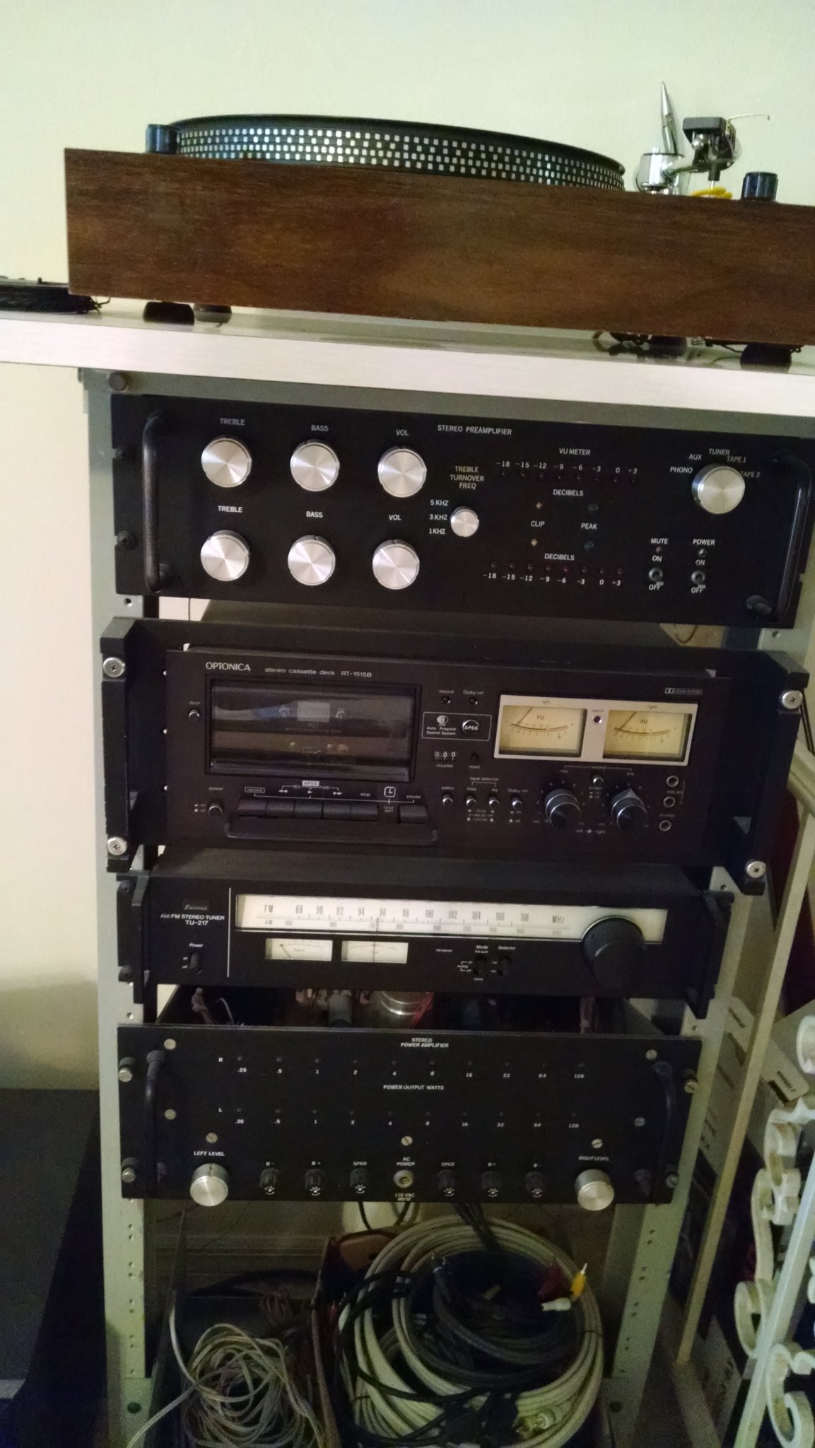

Having built, owned and repaired many different "Tiger" and SWTP power amps of various power levels in the 70s, frequency stability was a big issue with the "Plastic Tiger" of 1971 but thermal stability was HUGE problem with ALL of them. Lost count how many NPN/PNP output pairs I had to replace. None of the amps could survive hours of full power at a Frat party. ;-)
I had the 198 pre-amp, Plastic Tiger amp, 215 amp, Tiger .01 207 amp and Tiger Mark II amp.
The only amp that survived non-stop abuse was a clone I made of the 1st gen Quad 405 I made in 1977. Pre-Amp was my version of the Douglas Self Advanced Pre-Amp.
Still works today.
