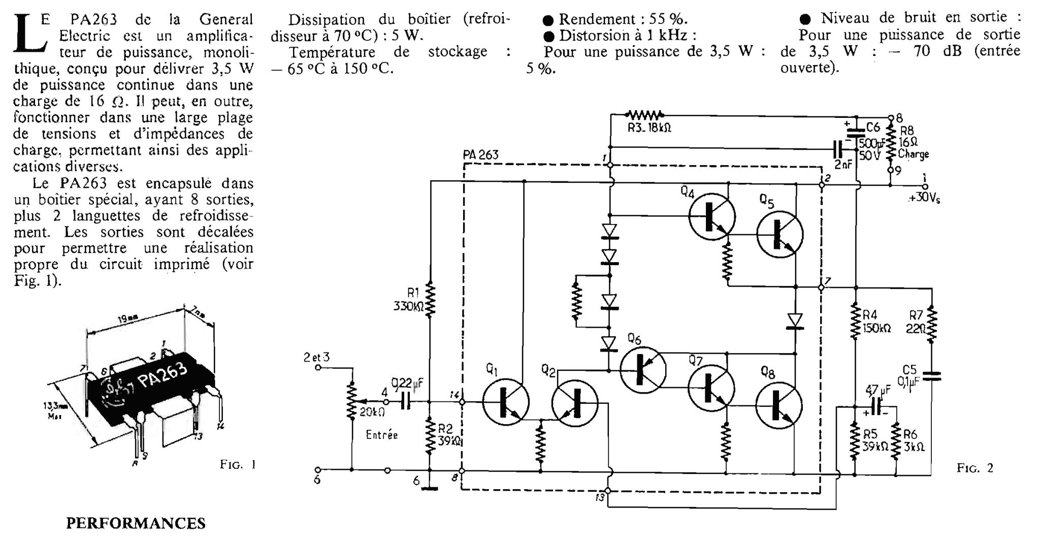

Thinking over the last post where KSTR says that the snubber (Zobel) should go from the output
to the negative rail. I assume this is because the negative, CFP side is more prone to oscillation,
as others have noted here, and that connection provides the shortest lead length to the output
device. Now, what to do in a complementary amp where both sides are CFP? Perhaps two Zobels
placed right at each output device to provide the shortest path - thoughts?
Also, I wonder given that the Tiger amps have long wires (4-6") from the output devices to the
board, should the pair of Zobels be placed right at each output device to bypass the lead inductance?

When my shop gets back in service, I may revisit this. I had a CFP amp board that I set aside and gave up on due to oscillations I couldn’t fix. Not crazy voltage, just +/-25V. I hadn’t tried zobels to both rails, maybe it can be resurrected. This also gives me a couple more rabbit holes to look down concerning QC class H. The four boards in that unit got rewired for full comp, but I’ve still got 6 more unmodified boards in my stash. I could try returning zobels to the two negative rails locally on the board and see what happens. I even remember any of this in a year or so. I only fully explored supply bypassing, but the zobel was always tied to ground.
I think that it is connected with the work of the load, and not with one output arm of the amplifier. An article from a French magazine (Le Haut-Parleur N°1338 13-01-1972 p. 214-215) where the author says that the Zobel chain is used for load shunting. Also, most circuits of the late 60s and early 70s were built on a quasi-complementary output and unipolar power supply.

I often use Zobels or the equivalent in multiple places in my amplifiers. I often put a Zobel before and after the output relay (if there is one). The first Zobel is very close to the output transistor(s). The second one is right at the output terminals of the amplifier. The latter helps to damp the output at high frequencies to absorb some EMI at high frequencies, since the speaker cables act as antennas. Also, when the relay opens if there is a fault, the output Zobel can mitigate some of the EMF spike that may occur across the relay contacts.
In output stages with multiple pairs I will often put a smaller Zobel right at the output of each pair. Dissipation-wise, I prefer not to use wirewound non-inductive sand resistors, and can use metal oxide film (MOF) resistors in multiple Zobels to get the dissipation down low enough to use MOFs.
I also use effectively Zobels in each power supply rail at the output transistors by putting a low-impedance LPF in the rail between the output transistors and the driver transistors. The series LPF resistor at that point might be only 2.2 ohms, so it both gives some HF rail filtering and the action of a Zobel. This can also help reduce parasitic oscillation tendencies by breaking the path between the output transistor and driver transistors at high frequencies. I also use an effective Zobel at the amplifier input, using a small-value capacitor, perhaps a couple hundred pf shunt preceded by a 68-ohm input series resistor. This forms an LPF at very high frequencies but also terminates the input interconnect from the preamp in a compromise characteristic impedance at very high frequencies, all helping to reduce EMI susceptibility at very high frequencies.
I admit that some of this may be overkill, but Zobels are cheap.
