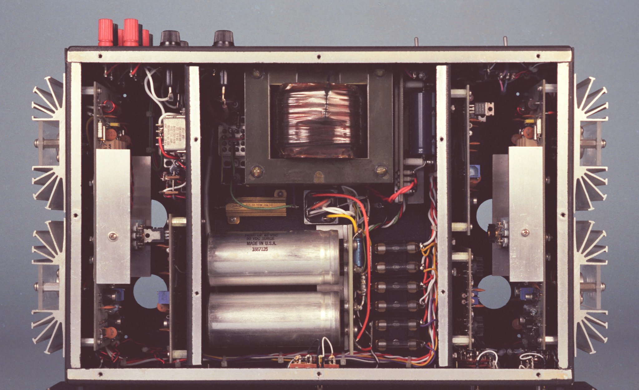

I built a power amplifier in 1980 using the exact Otala topology, albeit with different semiconductors and compensation part values. With 2 pairs of MJ802/MJ4502 output transistors and a power transformer that I custom rewound, it produces 50W into 8 ohms and 75W into 4 ohms. Achieving unconditional stability with its 3 gain stages and lead/lag compensation was laborious but ultimately successful. Lacking any tools like Spice, I manually generated gain and phase plots and optimized them after the addition of each stage. The final key to success was the Miller Input Compensation. There are those who extol the MIC approach but they appear to be in the minority. Bob Cordell does not recommend MIC for audio amplifiers. Having built two power amplifiers using it, I can say that it may be made to work very well. What has worked for me is to configure the amplifier with a differential (balanced) input and drive it with controlled source impedances. The excess noise of MIC is out of band and is not really an issue.
My amplifier produces lovely square waves even into complex loads and has never had a stability problem that I am aware of during its 44 years of service. I still use it to drive remote speakers.
Reactions: PB2

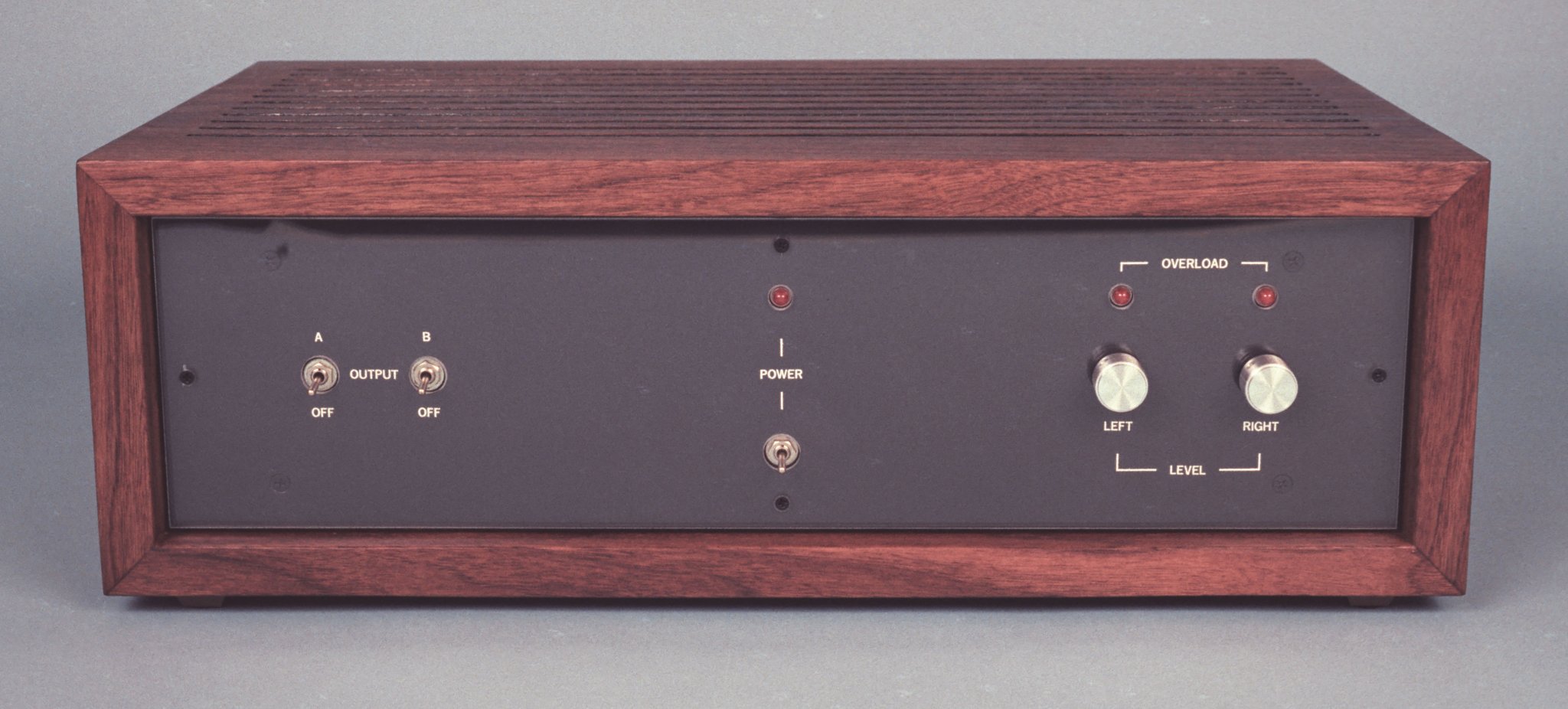

Do you have a schematic handy
Sadly, I have only this embarrassing "hen scratching." In 1980 I had an excellent memory and only needed to look at the Otala schematic and I would remember the changes [who needs a stinking schematic! 🙂]. In 1990 I reverse engineered the amplifier but never got around to drawing a pretty schematic. One may still need to reference the Otala schematic to fully understand it. I will try to answer answer any questions that you might have.
Fortunately, The amp is not quite as ugly as the schematic.
