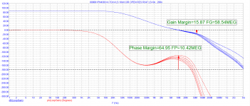

Inductive ceramic emitter resistors should be avoided in amplifiers. Here is their effect on open loop loop gain (resistor inductance from 0 to 200nH in 50nH steps):
As you can see, with an increase in inductance, the phase margin drops significantly.
Yes, I will keep my 1nH SMD resistors, and they make the crossover much cleaner too.

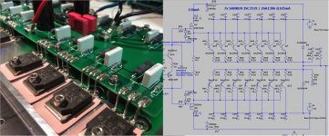

What amp is this? 10MHz ULGF is pretty good!
Very interesting stuff! Even if I have not the knowledge to fully understand all of it.
All at all, I'm happy with what I'm reading compared to the amp I finished last year.
==> Fet Drivers + BJT output stage: positive premature results measured by you. Drivers running at about 130mA.
==> 7pairs of output devices : more devices were prefered over one. This combo gives about 12Wrms, which is more than sufficiënt for normal listening = no cross-over issues.
==> 0R22 Emitter resistors: could not reduce them further, heatsinks couldn't handle it. The lower Re, the better.
==> low inductance emitter resistors: well no info about this. I have installed vishay RS-2B 0R22 0.5% 3W. If anybody has an idea about the inductance of these... resistors.https://www.vishay.com/docs/30204/rsns.pdf
Looking forward to further investigations and conclusions.

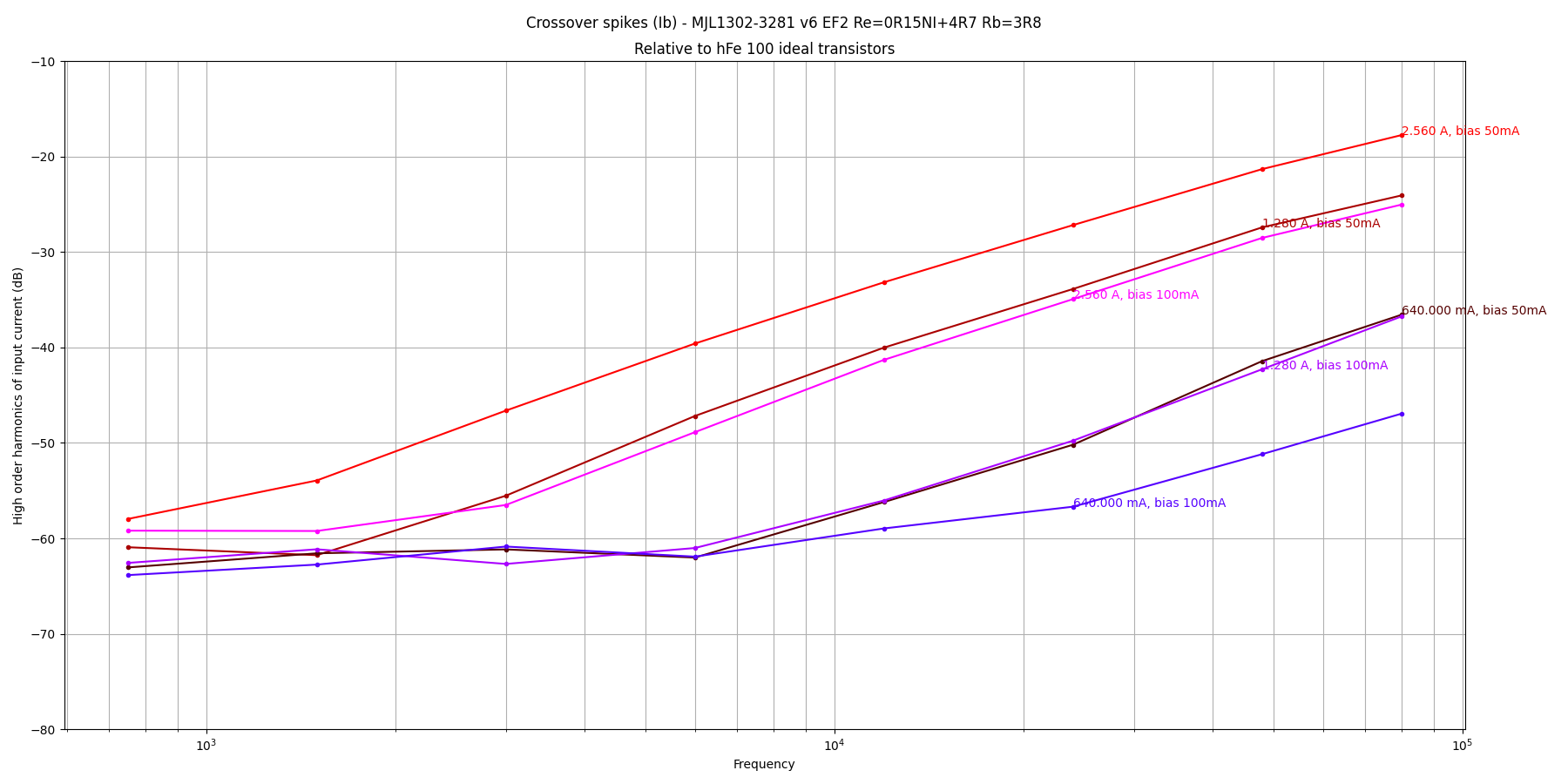

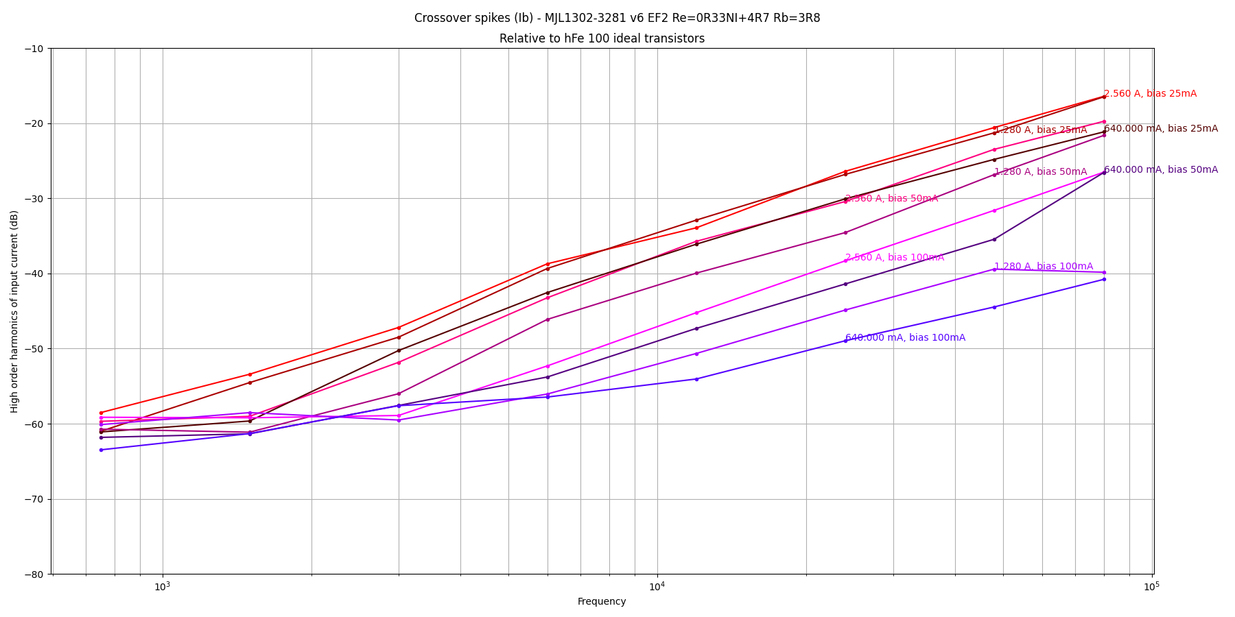

Next episode.
With the real low inductance resistors, results look much better.

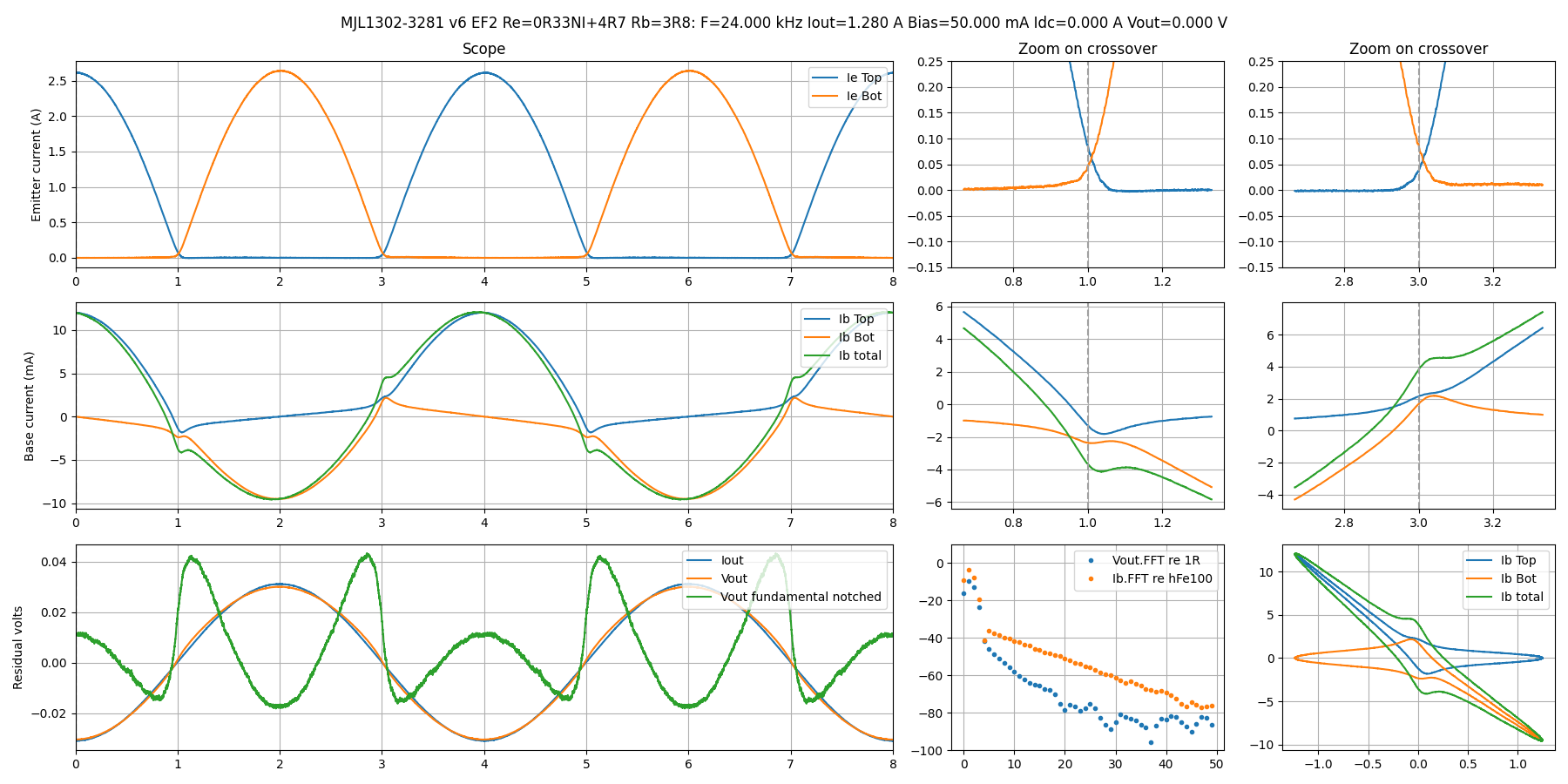

But I did not want to spend too much time comparing plots, so I came up with a metric. I noticed a strong correlation between the ugliness of the crossover spikes and the amplitude of the high harmonics (10th-50th). Below the 10th, it's more about static distortion, gm, hFe and all that. Above that order, the spikes dominate. So I just plotted the RMS sum of harmonics 10-50. This makes a synthetic plot from the measurements at various bias currents, frequencies, and output current.
For example, the difference between 0R33 and 0R15 emitter resistors is not clear from the first two scope style plots below:

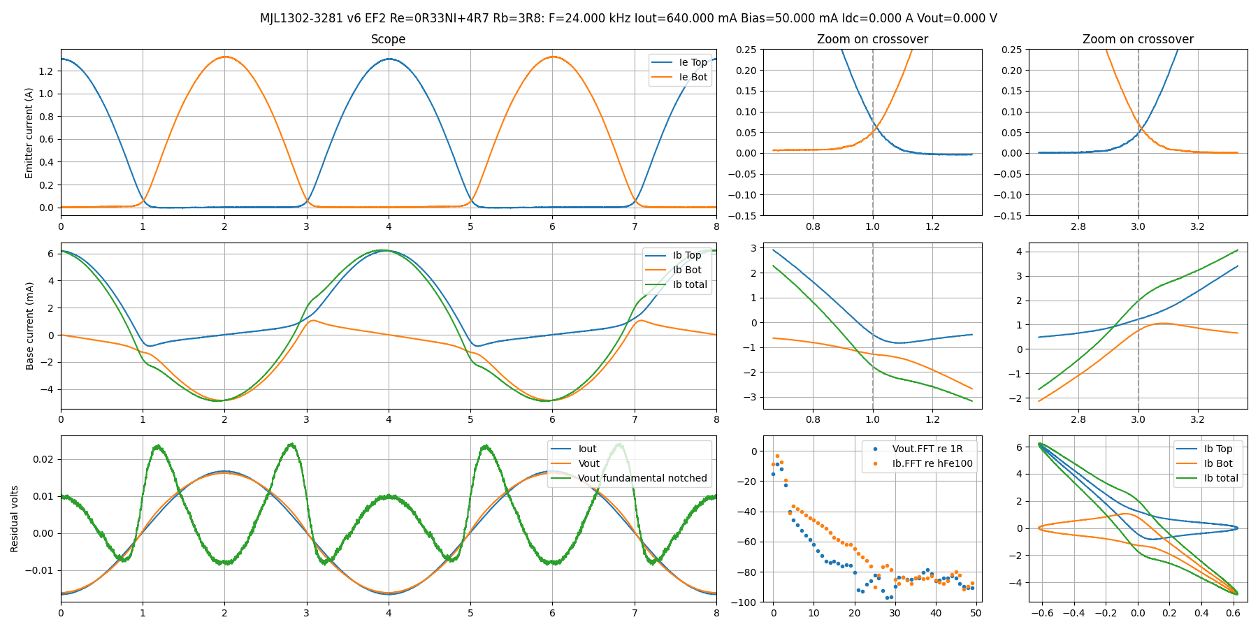

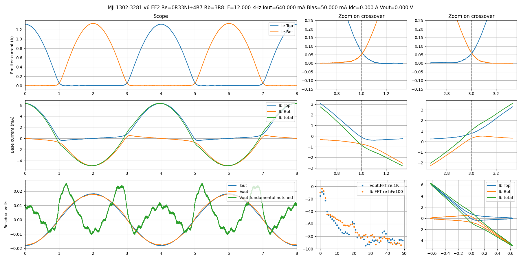

Basically the crossover zone where both transistors are ON has a certain "width", expressed in output current. It depends on bias current, but also on emitter resistor value. With high emitter resistors, the crossover is narrow, it is limited to the gm-doubling zone in the middle. With lower resistors, the exponential characteristic of BJTs comes into play and the crossover widens. This means the output current range where both transistors are ON widens with lower resistor values. In other words, you get more class A in your class AB for the same bias and idle power loss.
The important parameter for crossover spikes (and also other distortions) is that they worsen with high di/dt, and on a sinewave di/dt is highest at zero current. As the amplitude increases, the slope decreases, until the slope becomes zero at the top, before it goes the other way.
Thus widening the crossover means transistor turn-off will occur at a higher output current, thus at a lower slope point on the current waveform, a lower di/dt, which results in a smaller spike or no spike at all.

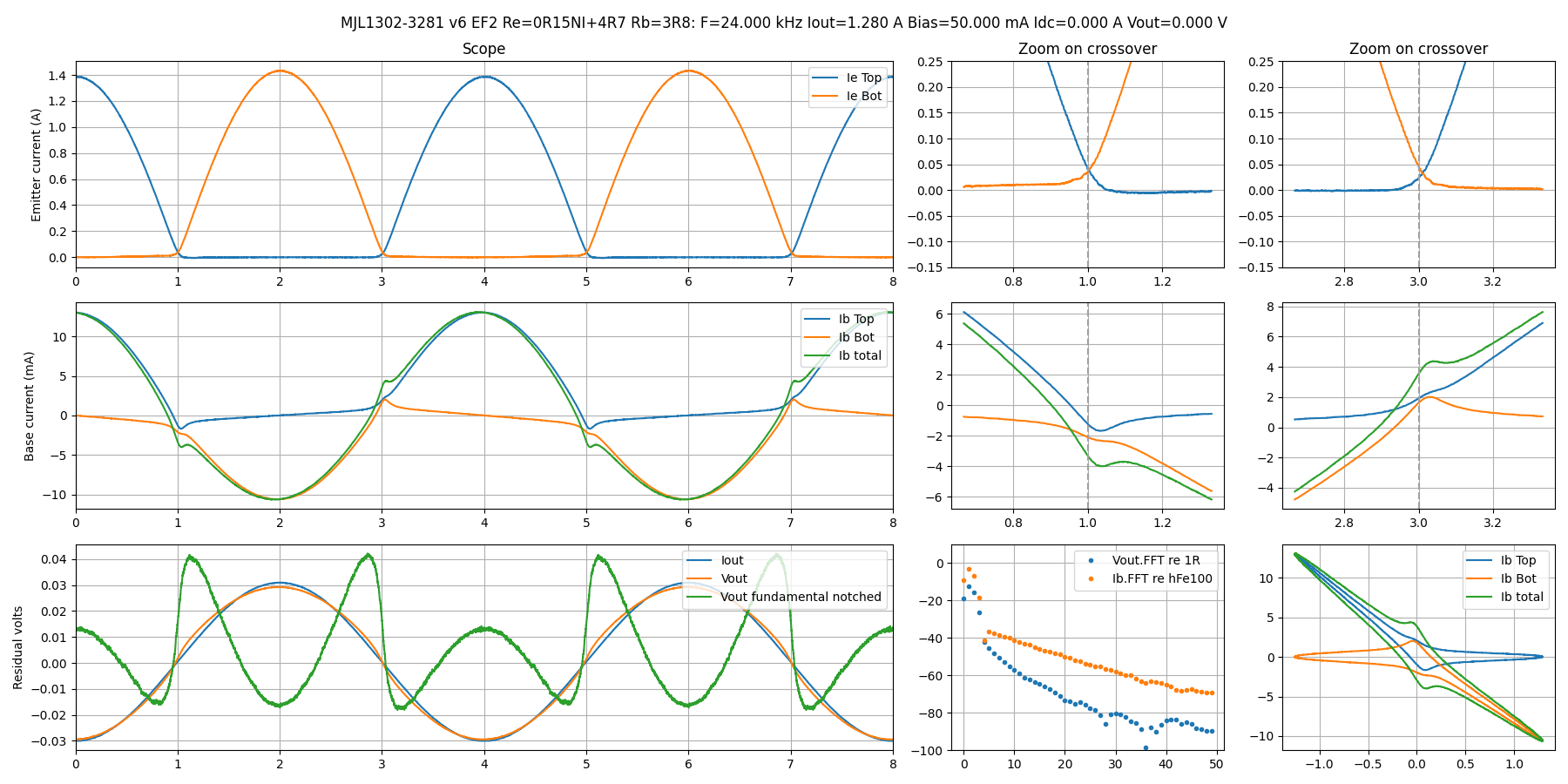

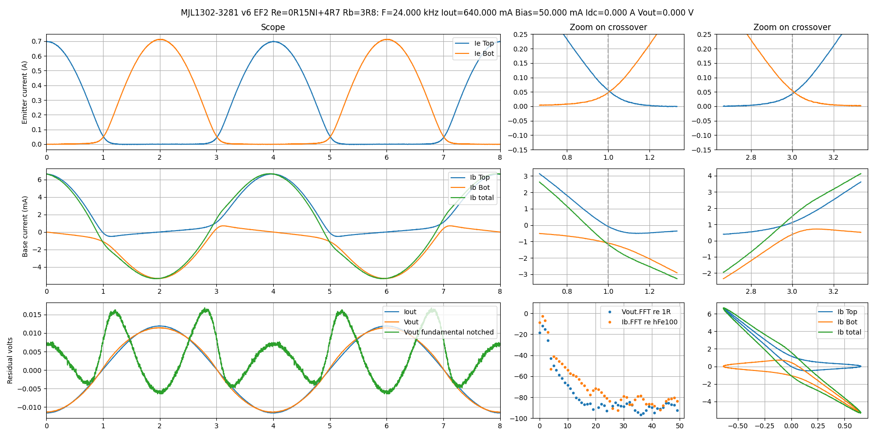

Here's an example: one plot for 0R15, one for 0R33.
In the 0R15 plot the crossover is wider, the transistors turn off at a higher total output current. The crossover spike is beginning to appear at this frequency, it manifests as a "bump" on the green curve (base current) on the left middle graph. As frequency or current increase this bump grows into a spike. With 0R15 ts just begins to appear, with 0R33 it is already beginning to sharpen a bit. The harmonics in the FFT plot reflect this.

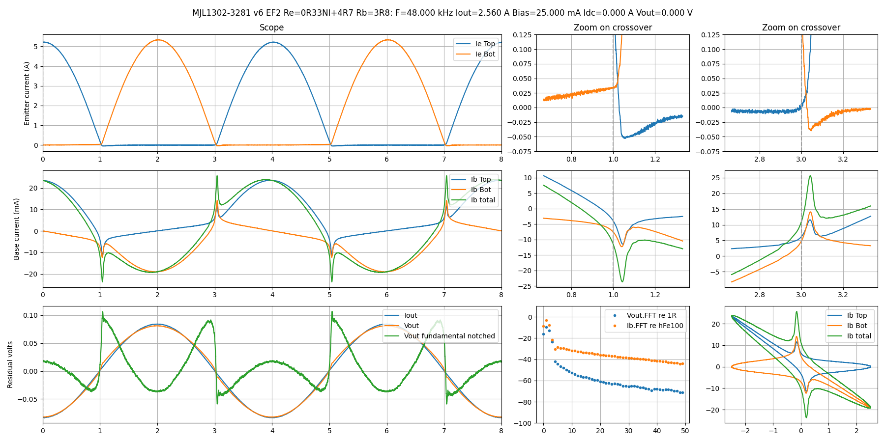

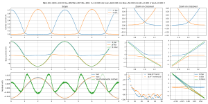

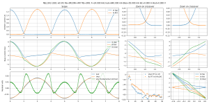

scope-Bias=50.000 mA Iout=640.000 mA F=12.000 kHz MJL1302-3281 v6 EF2 Re=0R33NI+4R7 Rb=3R8--MJL1.png275.5 KB · Views: 136
scope-Bias=50.000 mA Iout=640.000 mA F=12.000 kHz MJL1302-3281 v6 EF2 Re=0R15NI+4R7 Rb=3R8--MJL1.png272.9 KB · Views: 276
scope-Bias=50.000 mA Iout=640.000 mA F=24.000 kHz MJL1302-3281 v6 EF2 Re=0R15NI+4R7 Rb=3R8--MJL1.png285.7 KB · Views: 129
scope-Bias=50.000 mA Iout=640.000 mA F=24.000 kHz MJL1302-3281 v6 EF2 Re=0R33NI+4R7 Rb=3R8--MJL1.png284 KB · Views: 116
So, I said enough scope traces.

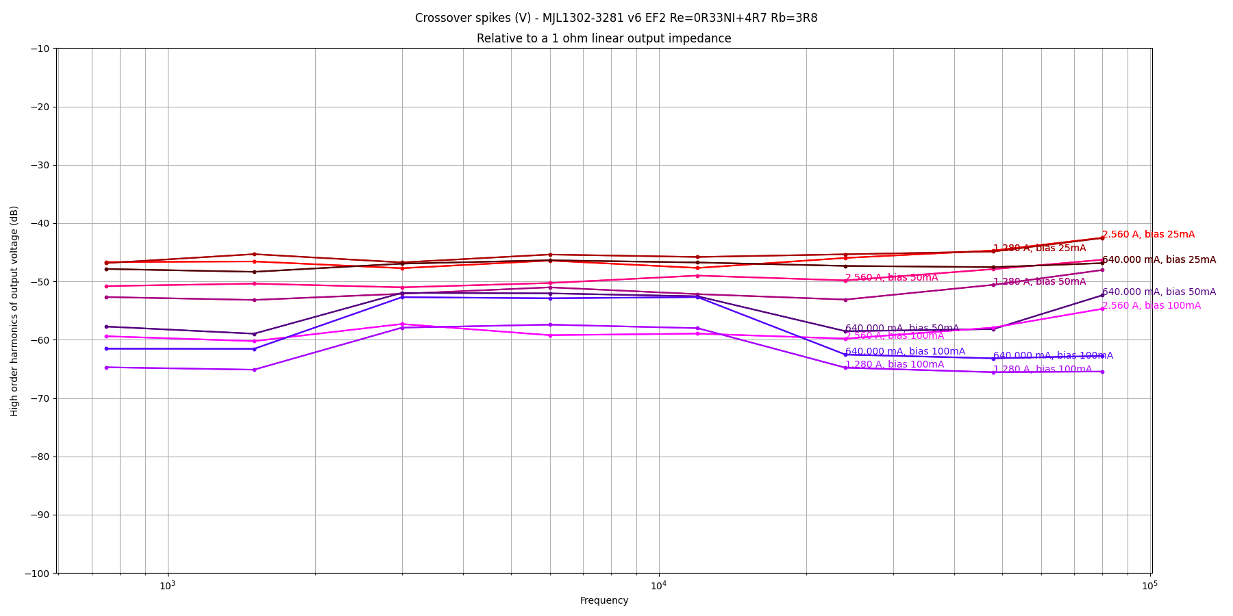

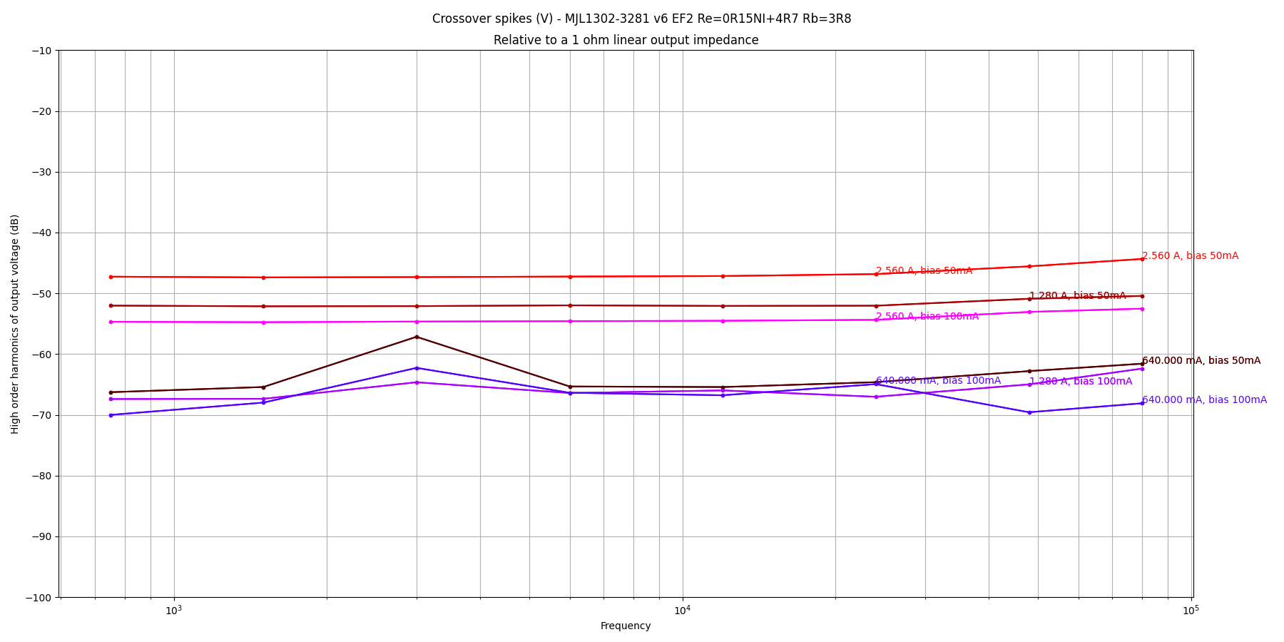

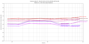

This is MJL1302/3281 biased at 50mA ; first two plots are with 0R33, they show the RMS sum of the high harmonics of output voltage, then the same calculation applied to input current on next plot.
Next two plots are with 0R15 emitter resistors. Unfortunately the test for 25mA bias didn't save the data so it is missing.
Text on the curves is bias and output current. X axis is frequency, Y is harmonics amplitude.
Red colors mean low bias, blue colors mean low output current.
At an output current of 2.56A, there is less difference between both values of resistors because the output current range is much larger than the crossover region. But at a lower peak current of 640mA, the wider crossover due to lower emitter resistors covers a much larger part of the actual output current, which means transistors turn off at a lower di/dt point, and the harmonics drop quite a lot.
Thermal stability is necessary of course, but there is probably a balance to find between the emitter resistor values that yield the flatter gm curve, and the lowest possible value for crossover spikes.
MOSFETs don't have this issue.
high-order-i--MJL1302-3281 v6 EF2 Re=0R33NI+4R7 Rb=3R8B=50.0m,F=12000,A=640.0m,V+=25.0,V-=25.0,V.png165.5 KB · Views: 350
high-order-i--MJL1302-3281 v6 EF2 Re=0R15NI+4R7 Rb=3R8B=100.0m,F=1500,A=2560.0m,V+=10.0,V-=10.0,.png120.2 KB · Views: 348
high-order-v--MJL1302-3281 v6 EF2 Re=0R15NI+4R7 Rb=3R8B=100.0m,F=1500,A=2560.0m,V+=10.0,V-=10.0,.png96.9 KB · Views: 343
high-order-v--MJL1302-3281 v6 EF2 Re=0R33NI+4R7 Rb=3R8B=50.0m,F=12000,A=640.0m,V+=25.0,V-=25.0,V.png130.5 KB · Views: 341

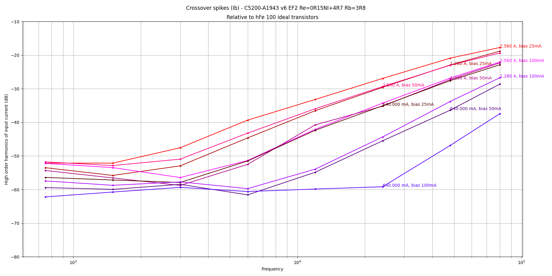

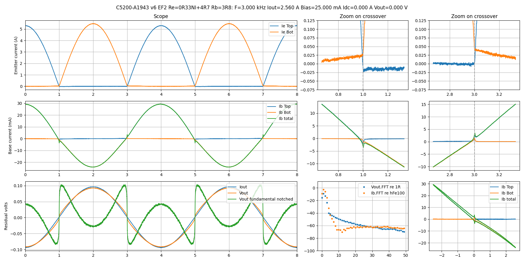

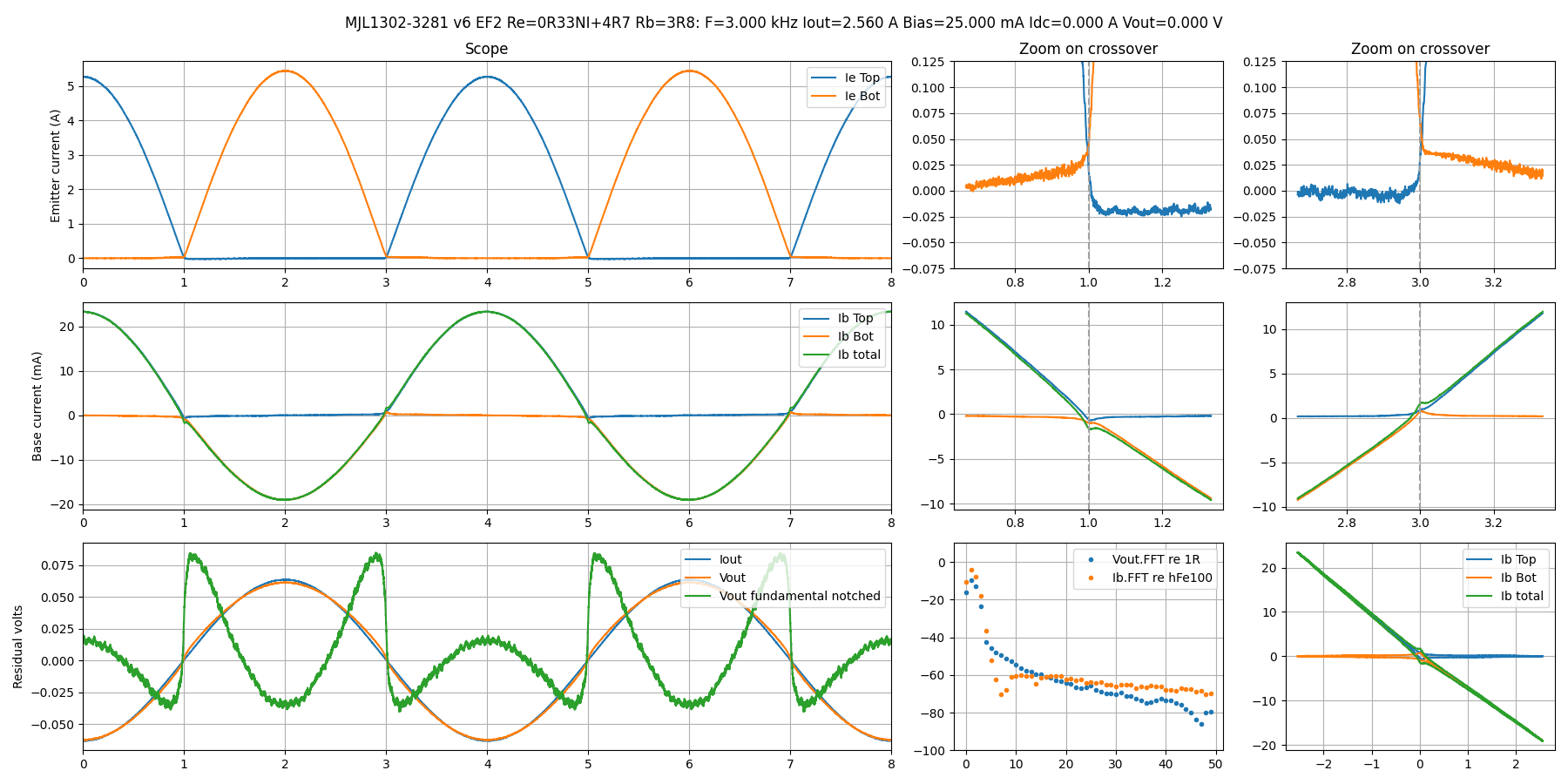

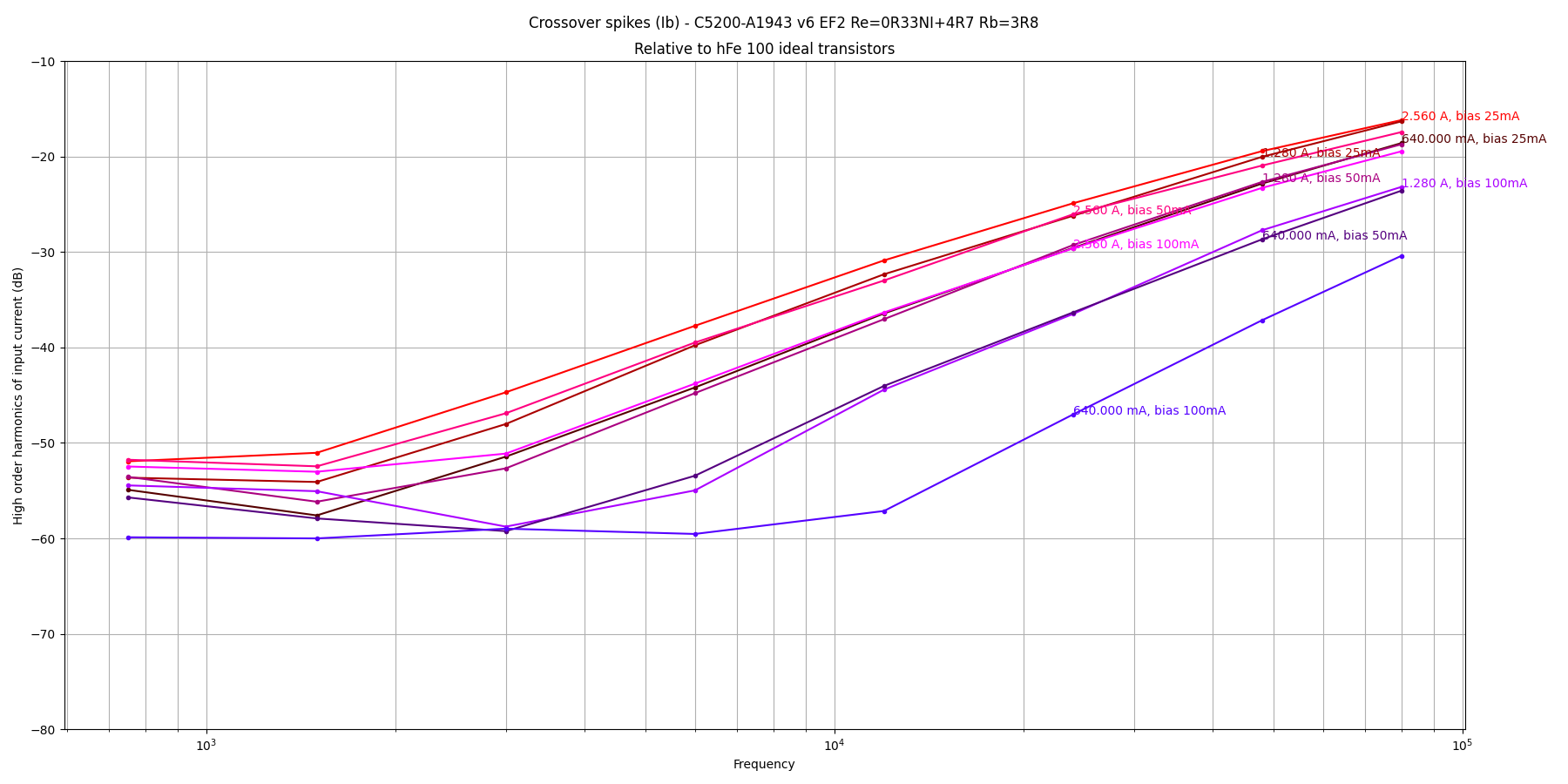

MJLs win against 2SC5200/A1943 in this test: high order harmonics are lower overall. Low orders are better too, because MJLs have better hFe linearity.
So I guess the MJLs keep the bipolar crown for now.
Using several MJL3281 in parallel is a bit overkill, so I wonder if the lower power versions (NJW0281 or something) would have better turn-off, or just the same if they're simply a lower area version of the same chip.

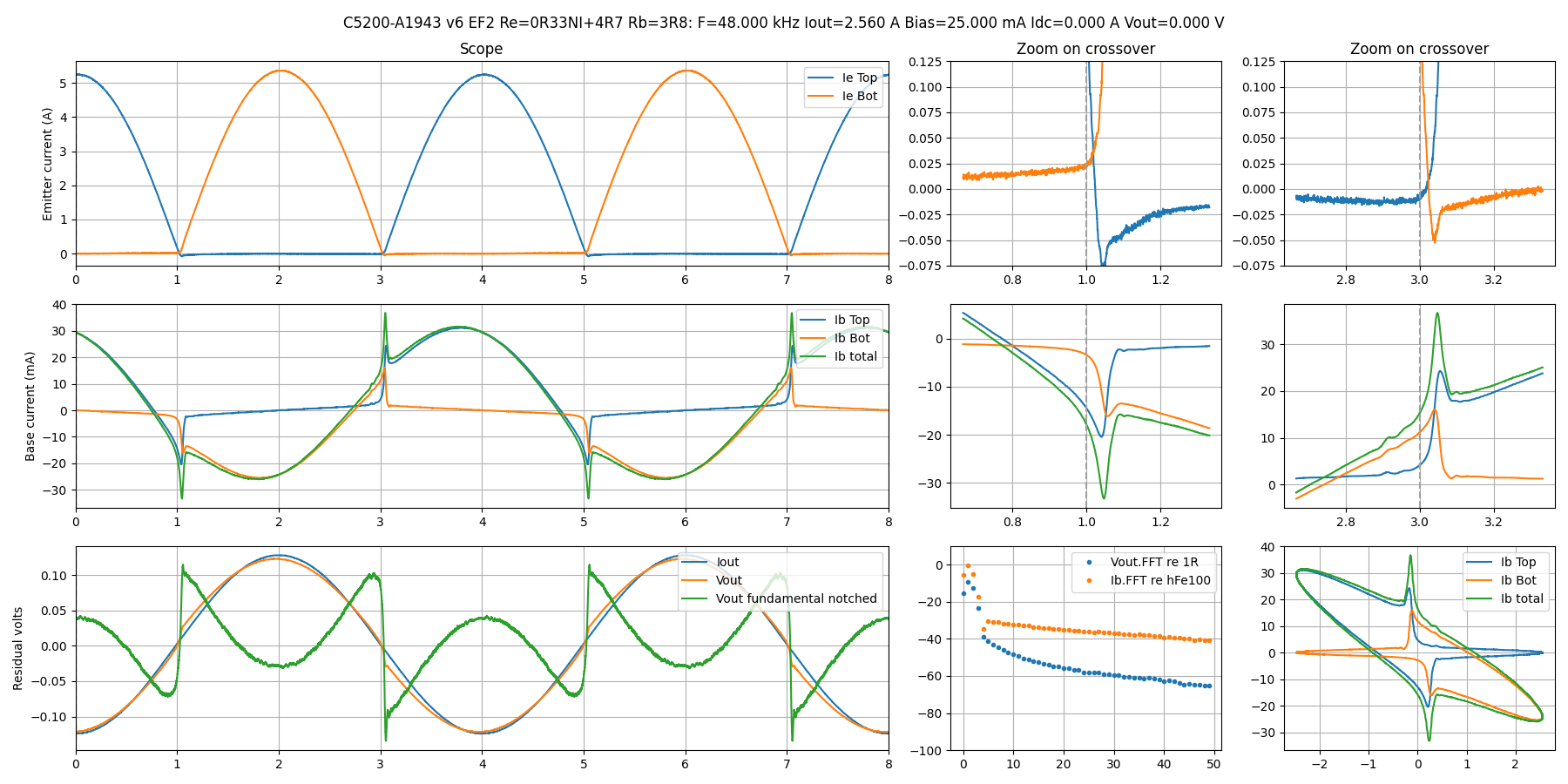

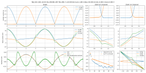

scope-Bias=25.000 mA Iout=2.560 A F=3.000 kHz MJL1302-3281 v6 EF2 Re=0R33NI+4R7 Rb=3R8--MJL1302-.png239.8 KB · Views: 112
scope-Bias=25.000 mA Iout=2.560 A F=3.000 kHz C5200-A1943 v6 EF2 Re=0R33NI+4R7 Rb=3R8--C5200-A19.png242.4 KB · Views: 115
scope-Bias=25.000 mA Iout=2.560 A F=48.000 kHz MJL1302-3281 v6 EF2 Re=0R33NI+4R7 Rb=3R8--MJL1302.png290.5 KB · Views: 117
scope-Bias=25.000 mA Iout=2.560 A F=48.000 kHz C5200-A1943 v6 EF2 Re=0R33NI+4R7 Rb=3R8--C5200-A1.png285 KB · Views: 335
high-order-i--C5200-A1943 v6 EF2 Re=0R15NI+4R7 Rb=3R8B=25.0m,F=6000,A=640.0m,V+=10.0,V-=10.0,Vo=.png167.7 KB · Views: 113
high-order-i--C5200-A1943 v6 EF2 Re=0R33NI+4R7 Rb=3R8B=50.0m,F=3000,A=1280.0m,V+=10.0,V-=10.0,Vo.png166.6 KB · Views: 111

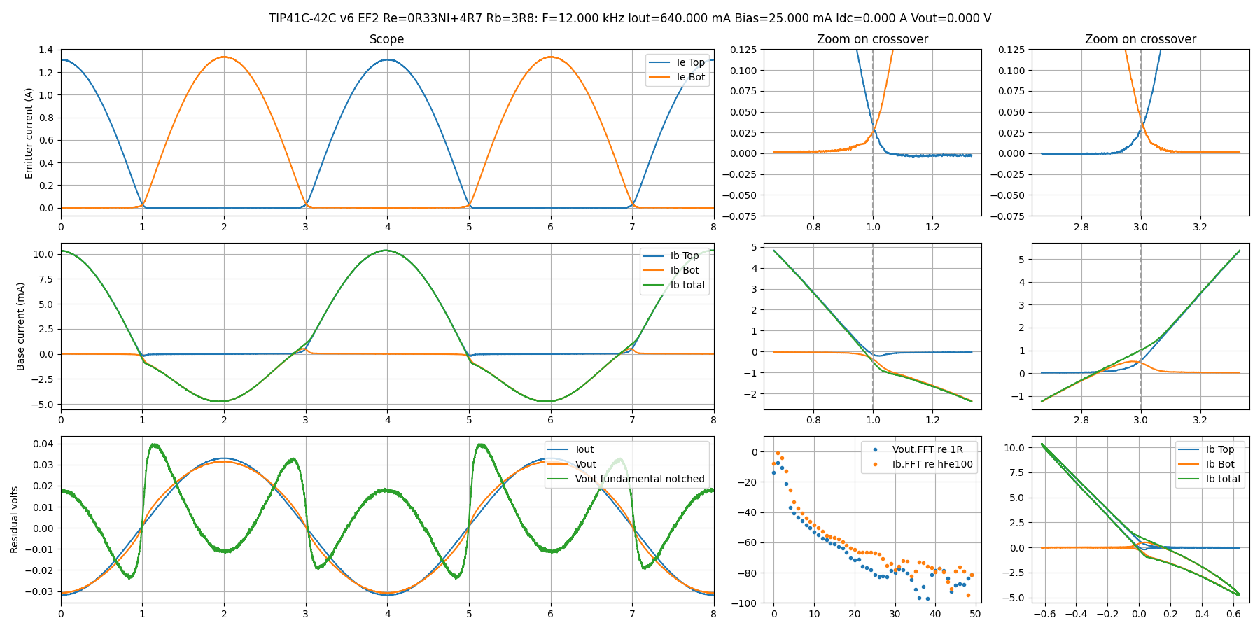

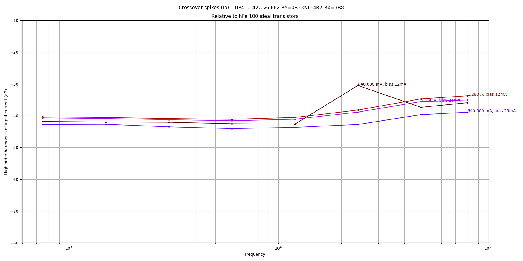

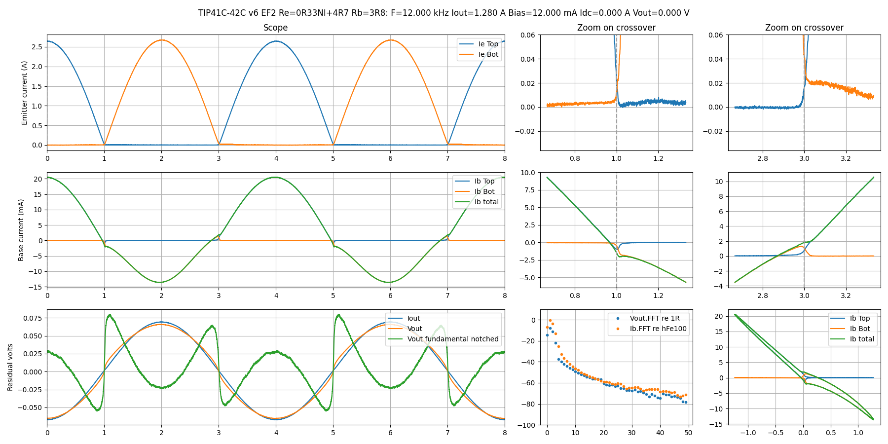

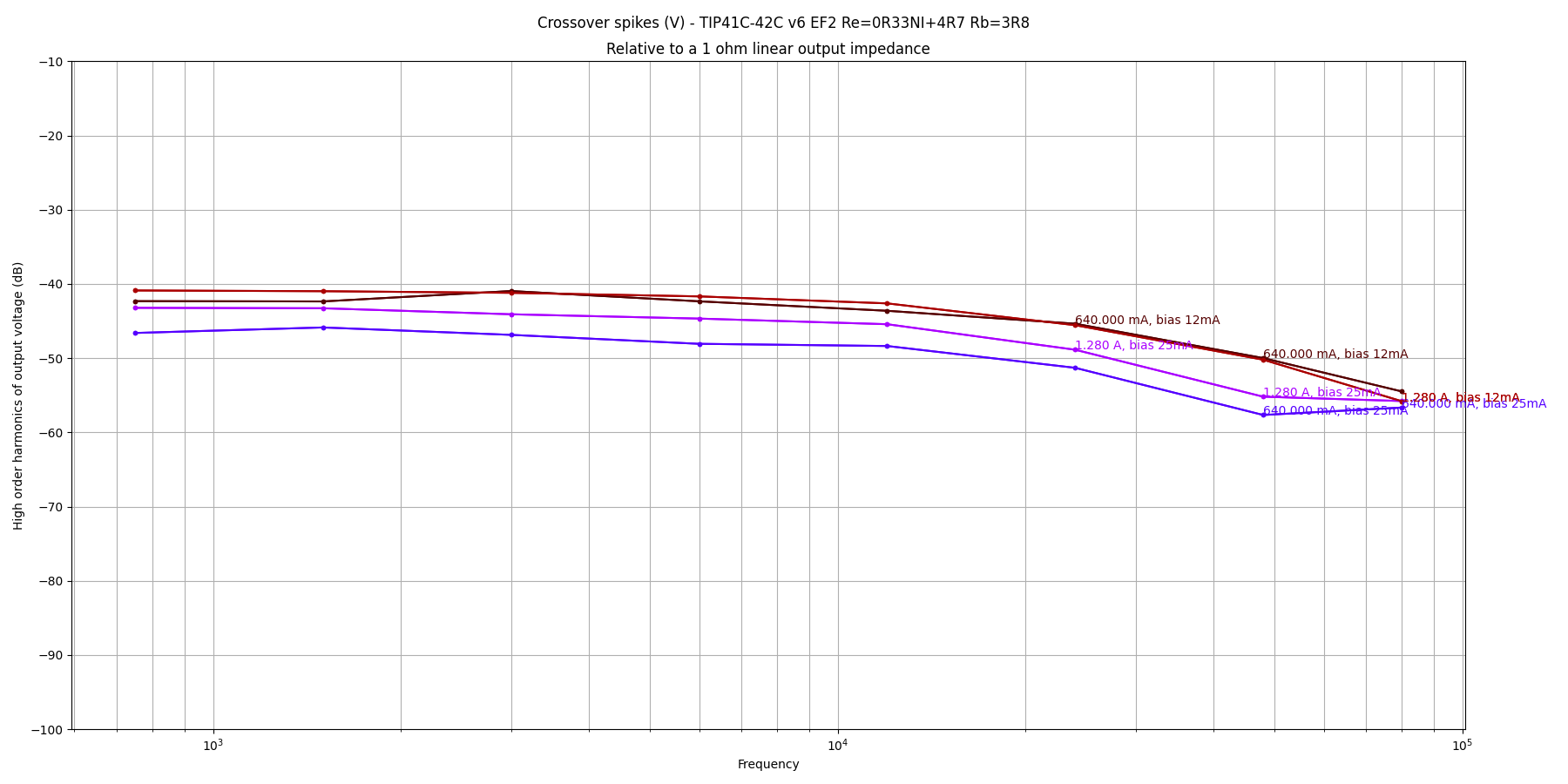

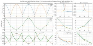

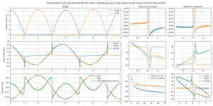

The TIPs were not as bad as I thought, unfortunately the high amount of distortion caused by the strong hFe droop on the PNP, and the bad matching between the two devices from different manufacturers... generated enough distortion to obscure the crossover spikes under study in the "sum of harmonics" plot.
scope-Bias=25.000 mA Iout=640.000 mA F=12.000 kHz TIP41C-42C v6 EF2 Re=0R33NI+4R7 Rb=3R8--TIP41C.png261.9 KB · Views: 117
scope-Bias=12.000 mA Iout=1.280 A F=12.000 kHz TIP41C-42C v6 EF2 Re=0R33NI+4R7 Rb=3R8--TIP41C-42.png250.1 KB · Views: 112
high-order-v--TIP41C-42C v6 EF2 Re=0R33NI+4R7 Rb=3R8B=25.0m,F=3000,A=640.0m,V+=10.0,V-=10.0,Vo=0.png93 KB · Views: 122
high-order-i--TIP41C-42C v6 EF2 Re=0R33NI+4R7 Rb=3R8B=25.0m,F=3000,A=640.0m,V+=10.0,V-=10.0,Vo=0.png73.9 KB · Views: 123

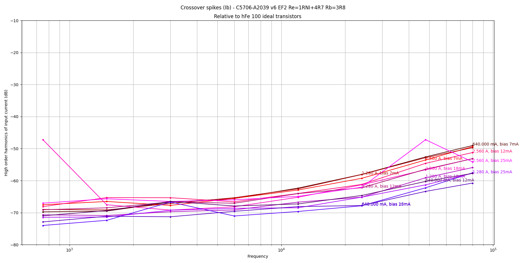

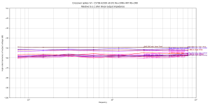

Just had a look at the schematic: it's a cascode output stage, so the output devices should have pretty low Vce, just a few volts from the way it's biased by diodes, which means very low dissipation in the output devices, so that would work. Nice find! I'm gonna try some new bias circuits, so I'm looking for inspiration...
Speaking of cascodes...

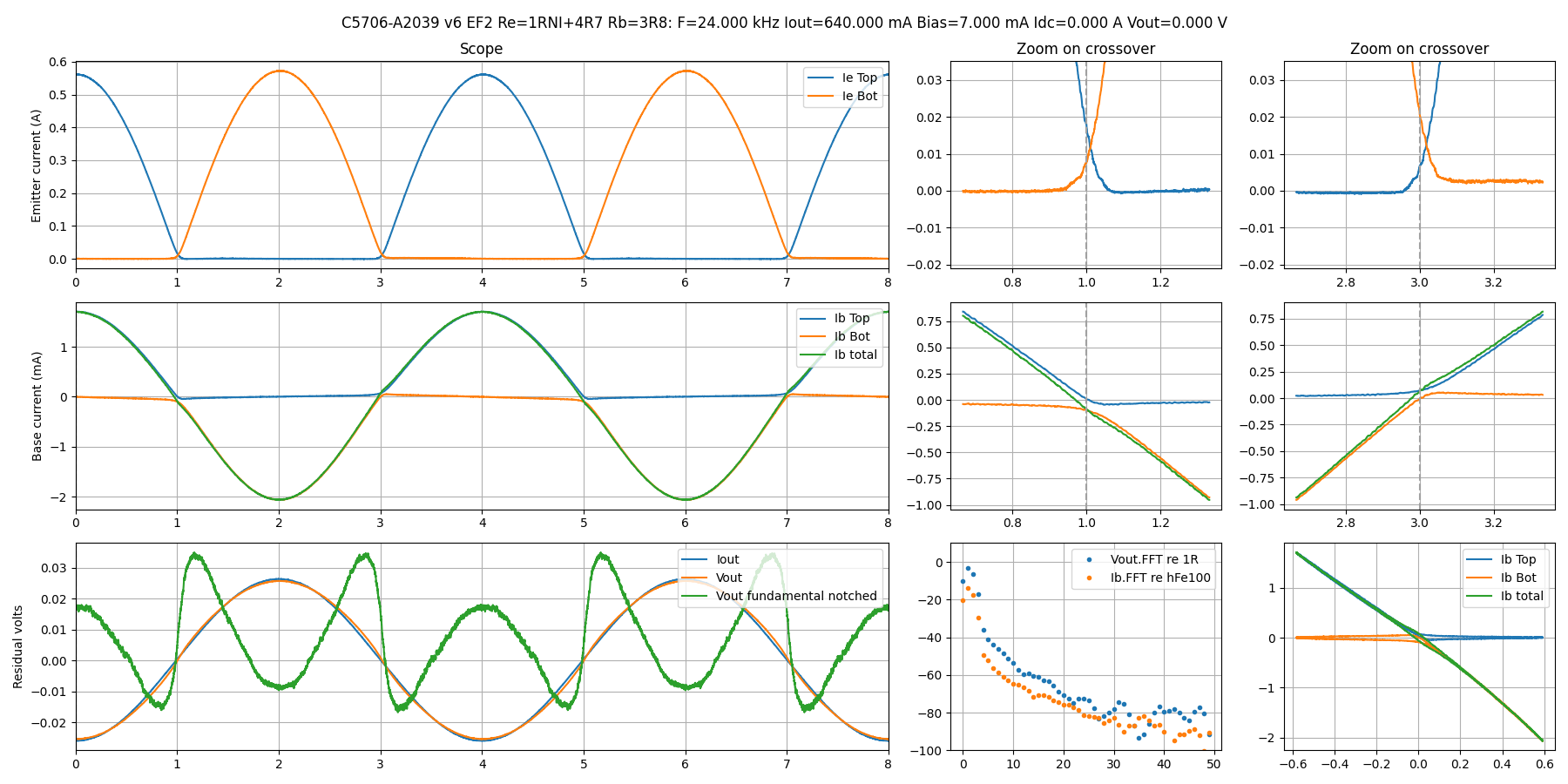

2SA2039/2SC5706 are tiny power transistors with a maximum power of 15W @ 25°C Tc, so they would need a cascode, the simplest would be a big bootstrapped MOSFET for example. But they do have some strong points...
- FBET/MBIT
- 5 amps max, high hFe (500) flat to 2 amps with good match between PNP and NPN
- 100MHz fT at 10mA, 300-400MHz up to 2A
- Adequate SOA for a cascoded transistor (3A at 5V Vce)
About 4 in parallel would make a pretty nice output stage already.

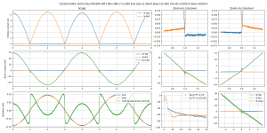

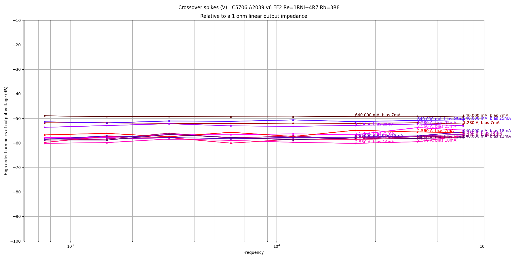

So how do they fare in the crossover spike test?...

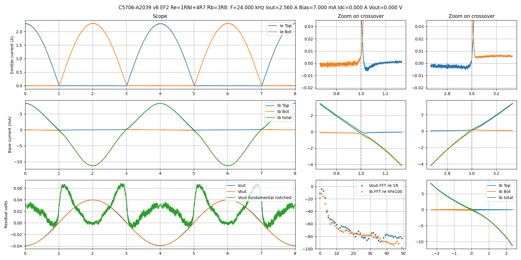

Test conditions:
One PNP, one NPN, at 5V Vce.
1R emitter resistors to keep the bias stable for the test, which makes crossover spikes much worse... in a real circuit lower resistors could be used.
Bias current set to 7mA, but it self heated to about 15mA to 20mA during the test.
Results are spectacular. At audio frequencies, crossover spikes completely disappear. I have to go to 24kHz at 2.56 amps to make them just begin to show up. And at 24kHz 640mA there are none. This is one pair of transistors, with a tiny bias. Four pairs in parallel to get the same current capability as MJL3281 would of course fare much better on this test, with higher flatter hFe and much higher bandwidth...
- FBET/MBIT
Test conditions:
scope-Bias=7.000 mA Iout=2.560 A F=24.000 kHz C5706-A2039 v6 EF2 Re=1RNI+4R7 Rb=3R8--C5706-A2039.png235.7 KB · Views: 162
scope-Bias=7.000 mA Iout=640.000 mA F=24.000 kHz C5706-A2039 v6 EF2 Re=1RNI+4R7 Rb=3R8--C5706-A2.png254.6 KB · Views: 151
high-order-i--C5706-A2039 v6 EF2 Re=1RNI+4R7 Rb=3R8B=25.0m,F=80000,A=2560.0m,V+=5.0,V-=5.0,Vo=0..png150.8 KB · Views: 152
high-order-v--C5706-A2039 v6 EF2 Re=1RNI+4R7 Rb=3R8B=25.0m,F=80000,A=2560.0m,V+=5.0,V-=5.0,Vo=0..png131.3 KB · Views: 142
