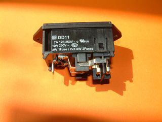

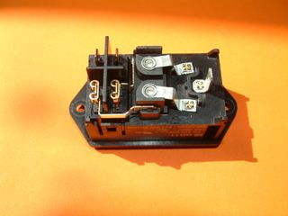

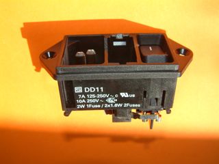

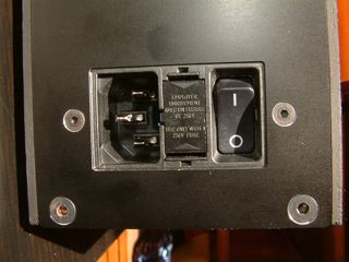

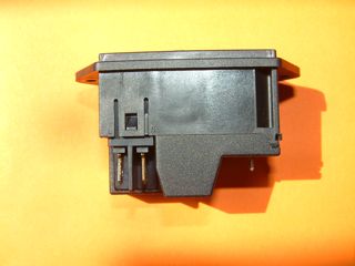

I have attached a few photos of the DD11 IEC connector. I really only like it when it is mounted on the inside. When mounted on the outside it does not look very high-end'ish......
Patrick, please verify if DD11 is an option at all. When mounted on the inside (hoping there are no brackets in this zone🙂) it will be deep close to 36 mm. With an angular 4.8x0.5 mm FASTON crimp connector (Farnell: 488379) another 5-7 mm is required in depth bringing us to say 45 mm at max...
If mounted outside this will be 5.5 mm less (say 40 mm at max).
