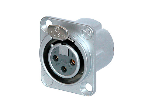

They are indeed very nice - especially the NC3MD-LX-HE - would be a perfect esthetic match with the case....

I would also vote for the DLX XLRs and I'm sure they look great even if they are mounted outside. But I assume we need the NC3FD-LX-HE, not the NC3MD-LX-HE (they have the same mounting holes however, so it doesn't matter).

Yes F for input/receive socket.
F for input plug.
M for output/transmit socket.
M for output plug.
Basically the opposite to mains plug tops and socket outlets, since these can kill.

Neutrik NC3FD-LX-HE (post #391)

Neutrik female XLR (not included, see three posts above)
