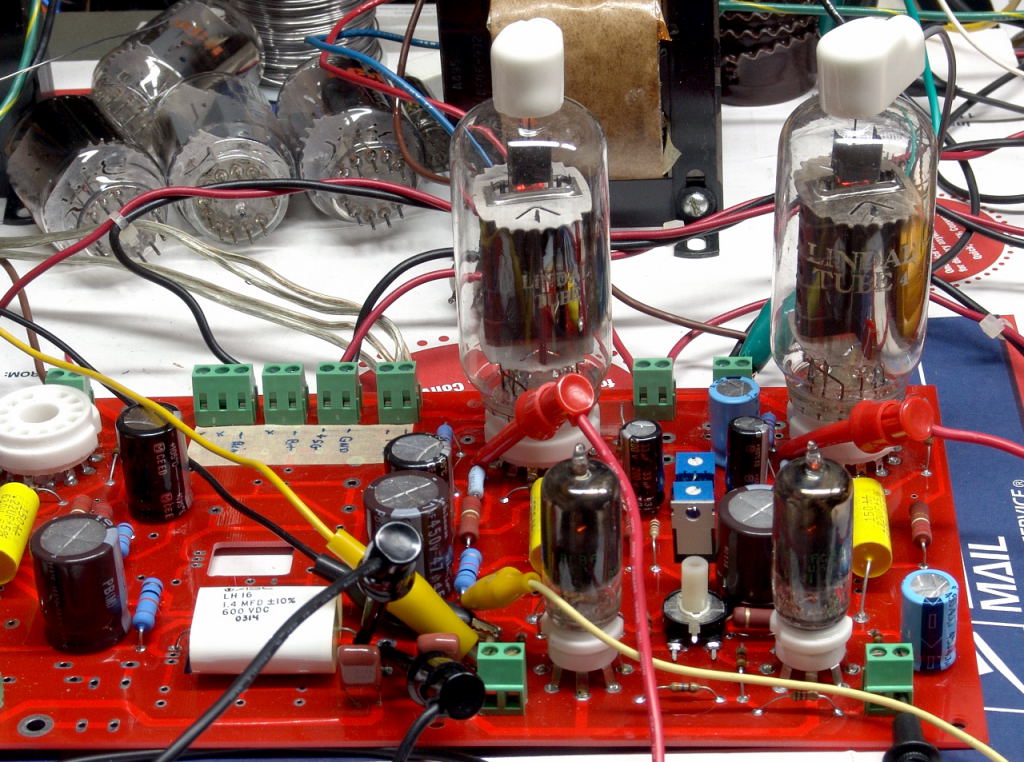

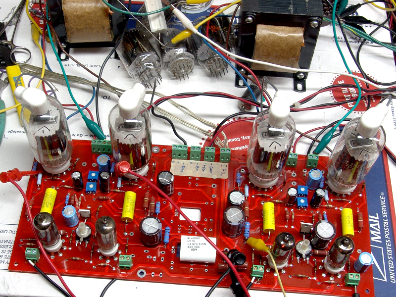

So with a bit of 'musical tubes' on the input side I was able to get the distortion and gain numbers for each channel dialed in. Now @ 1 W out I'm looking at ~.45% THD in each channel. ~30 WPC @ 5% THD. No global feedback.
The above came with some dialing in of the a few voltages. 435 on the plates, swapped out C6 for a 500V metal can Sprague. With the B+ hotter I was pushing the max plate voltage on the 6CB6's so swapped out R48 and R49 for 10k resistors to bring that down to ~200V from ~300.
http://www.flickr.com/photos/duganj/4080956544/
At this point I think I ready to move on to actually building a chassis for the thing.
I replaced the missing resistor, and exploded cap, and changed the same parts in the good channel since they suffered the same voltage overdose that the exploded ones did. The caps were the exact same kind as before. I did swap R48 and R49 for 10K 3 watt parts so they would be harder to fry and lower the voltage on the 450 volt caps.
I fired the board up at 450 volts and all was well. I turned the knob to the right until the voltage across the exploding capacitor read 450 volts. The power supply was at 520 volts. It would take some bigger resistors or a real regulator to allow cranking the B+ up farther. I don't have time for this right now.
With the 6JN6's in place I still saw over 70 WPC at 520 volts. The distortion at 1 watt is 0.7% without GNFB.
I had a few minutes to play, so what to do if I can't turn up the voltage any more? Well, I picked the biggest looking sweep tubes in the junk box, plugged them in (remember to remove R3 and R6 unless you want to watch them explode), and crank them up.
The tubes are 6HF5 (not a cheap tube) and they are compatible in this board with no modification. I set the power supply back to 520 volts ans flipped the switch. The power and distortion is the same as with the 6JN6's. This is expected.....until I change the load impedance. I moved the 8 ohm load over to the 16 ohm tap to reflect a 3300 ohm P-P load to the tubes. The 6JN6's could not drive this load without glow and distortion. These guys can!

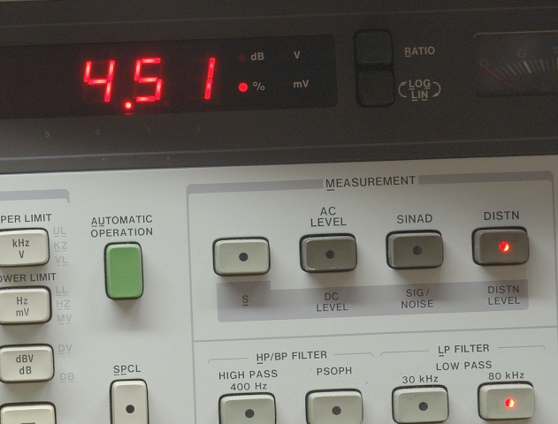

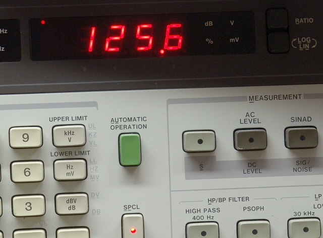

I cranked the drive up until the output just started to clip. How much power? Only 125 watts at 4.5% distortion. The OPT's that are in place were neven meant to deal with this kind of power, so if I get time this weekend, I will drag the big Plitrons out of their box.

Well, the obvious answer is LOUD, which is very true, and I must admit to having the volume control dimed for over an hour with a scope across the speaker leads. I never saw the amp clip once. I am sure that Petes setup has plenty of gain for driving the 6JN6's to 18 WPC from a CD player, but I can't achieve clipping with my CD player with the 6HF5's that are in there now. I did capture some transients on the scope that were over 80 volts P-P which is in the 100 watt range so the amp is plenty powerful, and maybe you don't want (or need) to run it into clipping.
