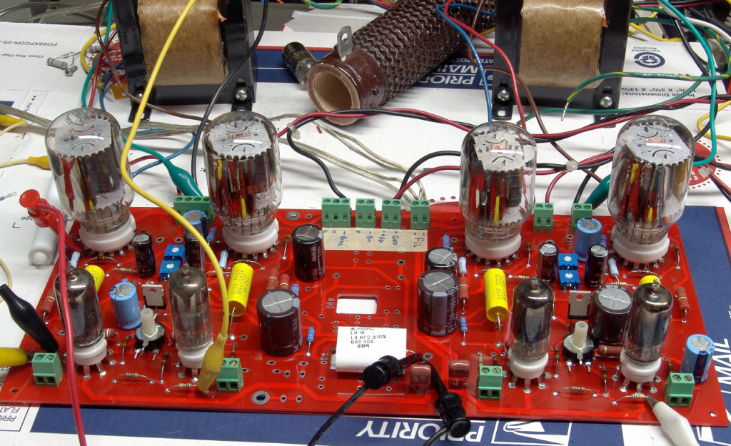

As with my other amplifier projects I will not populate any of the power supply components until last. I have several adjustable regulated bench supplies up to 650 volts at 1.7 amps. Enough to dial up some serious action. My main objective with this board is a learning experience. The 6GV5 looks an awful lot like a 6AV5 with a funny looking base and a plate cap. I also have about 25 different IF amp tubes to try with somewhat compatible pinouts including a few hundred 6CB6's.

I was originally planning to build the board as Pete intended without modification until I realized that some surgery would be needed to accomodate all of those different tubes. I did find 5 6JN6's so I still wanted to build the board such that it could be tested as it was designed before modification. Unfortunately I didn't have some of the parts, and this was to be a "one day project", so I was going to make do with what I could find.
Saturdays build didn't go well at all. I had already soldered some black phenolic 12 pin sockets into the board because they were the only PC board sockets that I had. I tried to test fit a tube into one of the sockets. It refused to go in and I refused to give up. The stalemate resulted in a shattered tube and a bleeding hand. At least we will all get to see a teardown of a NOS Sylvania 6HF5 sweep tube. Sherri convinced me that this was not a de-stressing activity, so we retreated to the local sports pub to drink some beer and watch the Gators and Hurricanes win.

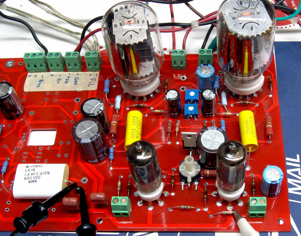

Stun? Yes, I must be getting old, but I set all of the power supplies to the voltages specified in Petes schematic. OK, I rounded 340 off to 350, but his paper clearly says 340 +/- 20%! I don't have any 8K ohm OPT's but I got boxex full of 6600 ohm OPT's so that is what I used.
OK, I put in the 6CB6's and attempted to test the circuit. It didn't work. No B+ to the driver tubes. Why, OOPS I forgot to put in the resistors that feed those tubes (R48 and R49). It then took 9 6CB6's to find 4 that I can get to balance. This may not be an issue with known good tubes.
Next, the 6JN6's. Again it didn't work on the first try, and again it was because I left out some more resistors. I must state that I modified the board a good bit and didn't exactly follow the prescribed parts list too well.
Now, with all of the tubes in their sockets, and the bias set to the prescribed 40 mA per tube it is time to crank it up. Using 6JN6's and a 6.6K ohm load I find that Petes estimate of 18 WPC was a bit conservative. I get 30.
I measure 30 WPC at 2.2 % distortion in one channel without GNFB, and 1.2 % distortion with GNFB. The other channel clips asymetrically which is caused by one wimpy output tube. I get 3.4% distortion at 30 watts without GNFB and 2.2% with GNFB in this channel. No attempt to optimize anything was made because my "one day project" is running out of time.

Now what. I have an hour left in the evening, so there are two important things left to do. Crank up the power, and crank up the volume.
The amp looks so benign with a mere 350 volts, so I decided that 450 volts would be a good place to start. So, I set the phasers somewhere in between stun and kill and flipped the switch. There was no earth shattering kaboom, it just worked, I didn't even need to readjust the bias. Power was now 50 WPC at some ridiculous 1.05% distortion number. I decided that this was more than my speakers really like to eat, so I stopped here and connected the CD player and speakers up.
This thing ROCKS. The sound is very punchy and dynamic, as long as you unhook the GNFB. I tried music from mellow to metal, but in all cases I liked the sound better without the feedback. More experimentation will occur but this is a good sounding amp from the start. I haven't even turned any of the trimpots yet.
