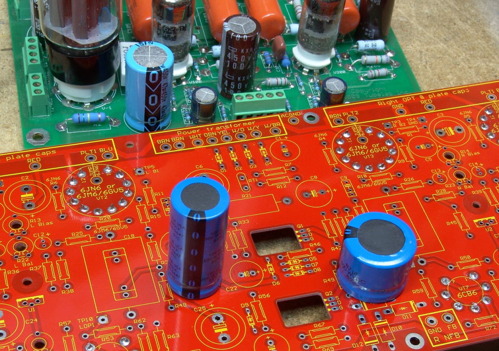

I'm trying to keep costs down. Would I be able to get away with a 820pf X5F ceramic instead of mica? I would expect that this has an anti-RF application and an X5F may not do well over 10Mhz?
I would expect the ceramic would do fine. I put the caps there because there was some tendency to oscillate if the OPT leads were very long - not sure exactly what the FB path was. Also tended to optimize the square wave response and damp any ringing. You may not even need them...
Pete
I can't find any 10uF 500v electrolytics .... I have a 47uF 500v Panasonic that seems to fit.....Scratch that. The 47uf is a 450v, not 500v
862-6216 100uF 500V $2.31 Still shows 17 in stock, but I ordered 10 this morning.
I got these today, they are tall and skinny, and they fit the board just fine. Unfortunately, now they are all sold out!
862-6214 82uF 500V $2.03
I got some of these too, but they are short and fat and cover up some surrounding components. They will work in a low profile version of the Simple P-P which is why I got them. I didn't order any other caps this time.
Thanks for the parts tips. The customer support at Allied is excellent. I got a bunch of 470uF 450v's for a bargain a while back.
I notice that 862-6212 is a likely skinnier 82uF.
I also figure 507-0802 is a compromise to the mica equivalent, but is significantly less expensive.
I figure I can kludge in 586-0378 in positions C22 and C30. Won't be pretty at all.
