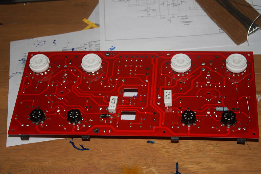

Received Pete's bloody red board .... wow .... looks sexy! Might design an arcrylic enclosure to display it !?

You will need some compactron sockets, designed for PCB mounting.

Pacific T.V. - Vacuum Tube Sockets - Compactron
Part # B12C-PCB - $4.00 / ea.

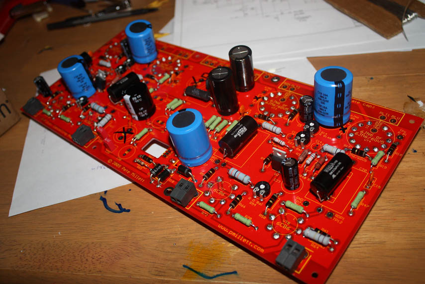

I'm stuffed! Well, almost at least.
I'll be using a Hammond 370HX for power and not sure about the output transformers. I hope to fit it all on a 17x10 plate, but it's gonna be tight.
I decided to go with some 82uF 500v's (the big blue ones) and they crowd some of the parts. A couple items had to go on the other side of the board.
q1, and q2 will be FUJI 2SK3524's (600V, 8A).

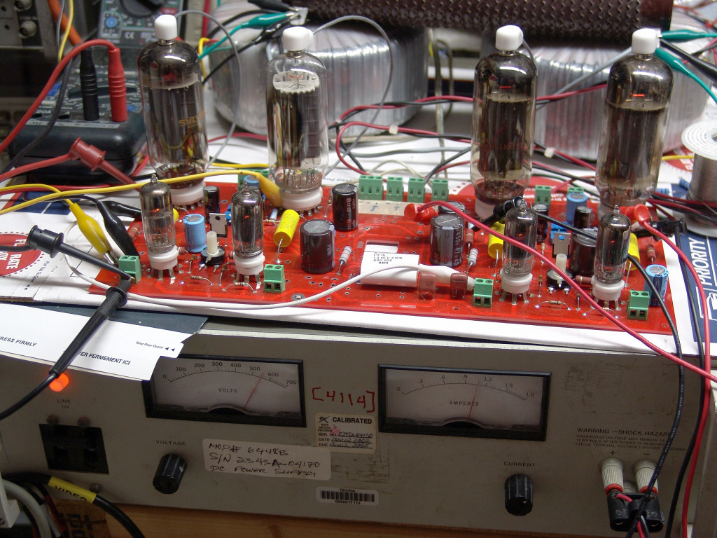

Another forum member sent me some tubes in unknown condition to evaluate. I promised to test them and send him a suitable trade if there were any useful tubes. There were four 6KD6's. I have 3 6KD6's. I have a big red board. Last night I packed up the dual Simple P-P amp and carted it all off to wood shop class to build a cabinet, so I have an empty spot on the bench. Do tubes glow?
I connected the red board back up with the 6HF5's still in it. This time I got out the big Plitron OPT's that I have. These are rated for "400 watts at 20 Hz" and have a 1250 ohm impedance. I have already found that they work OK at 2500 ohms and 5000 ohms by hooking the 8 ohm load to the 4 ohm or 2 ohm tap. The 6HF5's really didn't like the 2500 ohm load but did manage 130 watts with 525 volts of B+ and a faint hint of redness. They previously made 125 watts with a 3300 ohm load.

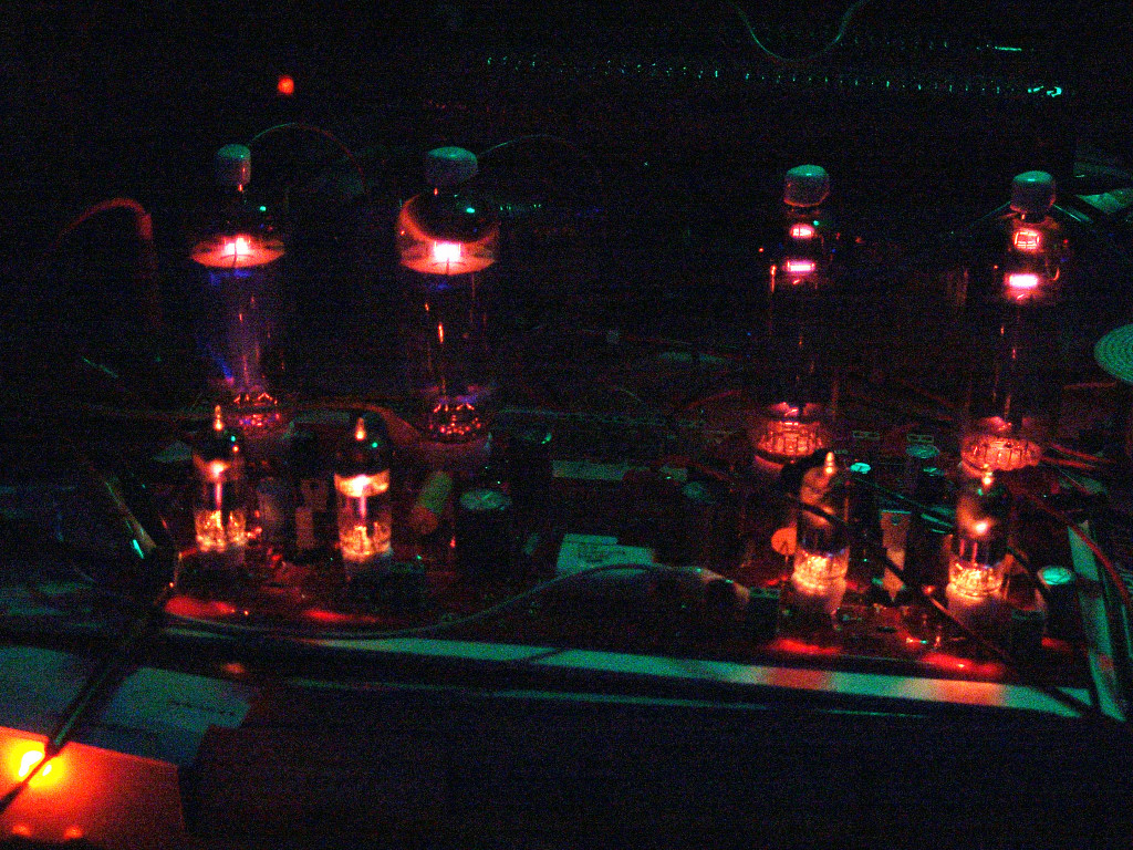

I stuck a pair of 6KD6's in the board, set the power supply on 450 volts and cranked. Two NOS tubes (One GE, one RCA) in the right channel, but the bias won't equalize. Something is wrong. I decided not to risk NOS tubes, so I stuck in the crustiest looking pair of tubes that I had. A pair of Admiral branded GE's. These tuned right up to Petes prescribed 40 mA each. Nothing exploded, so i turned up the power supply I ran this amp for half an hour at ridiculous power levels. I swapped tubes around until I have found 4 tubes that play nice with each other.
I shut off the fun before I blew anything up. Tomorrow I should have more time to experiment.
Note the meters on the plate supply. 550Volts at 1.1 AMPS! The watts are displayed on the 8903A. In the ususal night photo, there was nothing glowing. Yes the audio analyzer shows 243 watts. That is just one channel.
