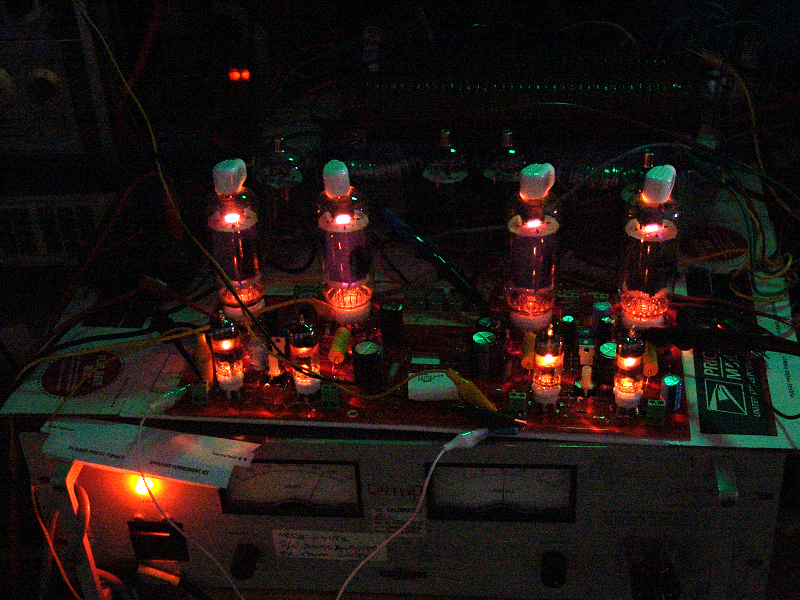

Posted new P-P power amp design
(or should I say abuse).
Nah, these things are just too hard to find to abuse. Yes the watt meter said 240, but I was operating the tubes within their ratings. That voice inside my head, you know the one that keeps telling me to turn it up, convinced me to crank the power supply knob up to a litle bit over 600 volts. I could get well over 200 WPC at reasonable distortion, and I made the watt meter read 300 for a few seconds (severe clipping). The voice of reason reminded me that this is how I scattered bits of capacitor all over the room last time, so I put the knob back on 550.
I was bugged by high distortion in one channel, so today I played musical tubes. I did have one bad 6CB6 but the distortion followed the output tubes. I swapped tubes and found that the culprit is one of my NOS tubes. So now I have the 4 tubes that I got from you in the amp. All 3 of the tubes that I have suck, and two of them look brand new!
I decided that If I were to actually build an amp with this board, I would need to make a real power supply. That means that I would need a power transformer, and power transformers for 400 watt amps don't come from Walmart. I already have an Antek 4TK400 so it will have to do. In fact I have two of them.
The 4TK400 makes about 550 volts of B+ with a light load, and I am guessing a little over 500 volts if it were trying to run this beast. So I set the power supply to 500 and I can get 130 watts on one channel and 150 watts on the other.
OK, what would happen if I changed the tap on the OPT to reflect a 1250 ohm load? Over 200 watts happen. Unfortunately cranking the amp to hard clipping pegs the current meter on the power supply, which is too much current for these tubes. Turning off the lights reveal some redness in the tubes. So for now I set the OPT back to 2500 ohms.
Another thing that I discovered is that these tubes take some serious drive voltage. It takes nearly 10 volts P-P to drive this amp to clipping. A CD player won't get there. The simplest way to improve this is to find a different input tube that has more Gm and maybe play with the plate load resistors since I have way more B+ voltage than Pete ever dreamed of. The first candidate that came to mind was the 6EW6, but I couldn't find any. I did find a bunch of 6GU5's. Could a tube that has 5 grids work better than 3? Yes, gain went up, and the distortion went down. One channel has 0.78% at 50 watts and the other has 1.67%.
Now, all I have to do is hook it up to the speakers and annoy the neighbors.

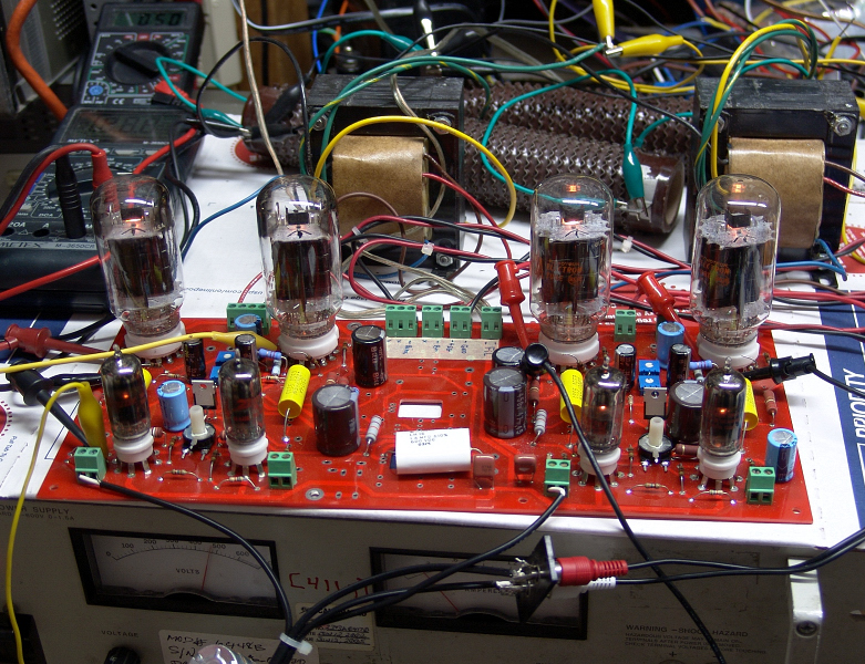

I made a few more tweaks. I found that I could play with the screen voltage and the bias voltage to optimize power VS distortion. I had been running the screens at 175 volts because thats what worked the best for the 6HF5's. I find that the 6KD6 / 6GU5 combination likes 150 volts. The screen current goes so low that it doesn't show up on the 0 to 300 mA analog meter. The distortion at low power levels goes down. The good channel reado 0.11% at 1 watt. The bad channel reads 0.77% at 1 watt. I set the power supply back to 520 volts, where one channel makes 160 watts and the other 140 watts. The distortion at 100 watts is 1.8% and 3.03%. Dialing the frequency down to 20Hz but leaving the power at 100 watts only changes the distortion 0.1%. Plitron makes some killer (but expensive) OPT's.
I hooked up the CD player and speakers. Yes its LOUD! I was afraid that I was going to blow up my speakers. It is still not possible to drive this amp into clipping from a CD player, but it isn't necessary. I listened for about 2 hours with the scope across the speaker leads. I never saw the amp clip once, but I did observe over 110 volts peak to peak across my "8 ohm" speakers on multiple occasions.

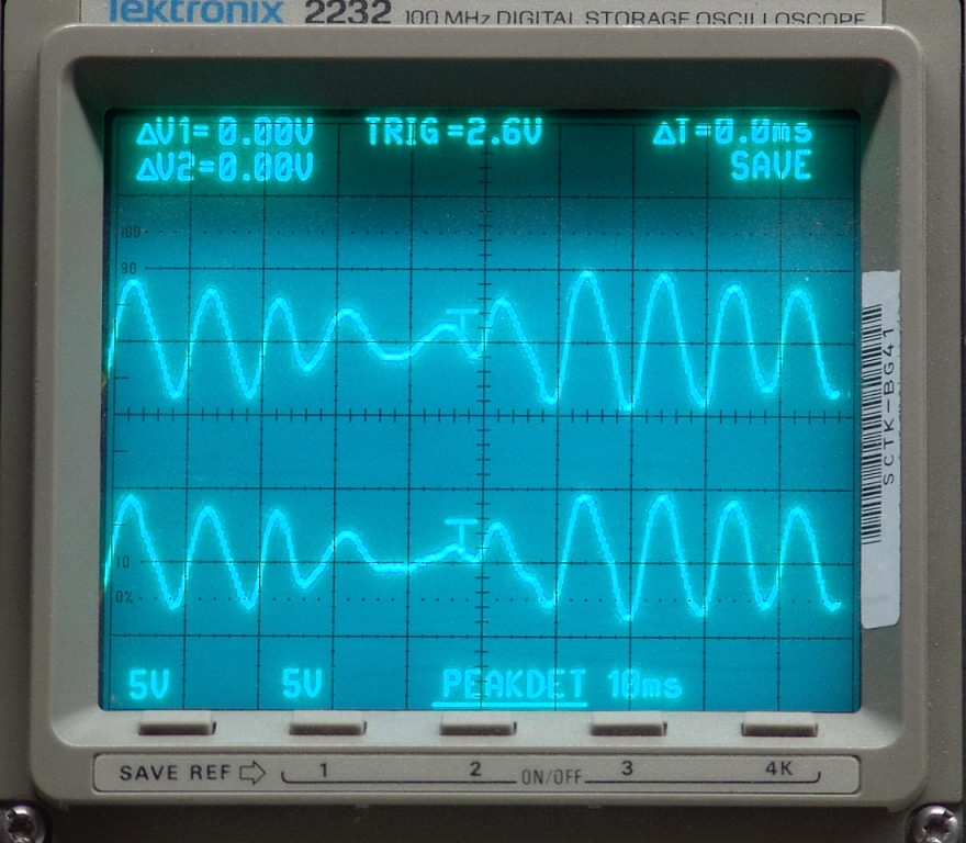

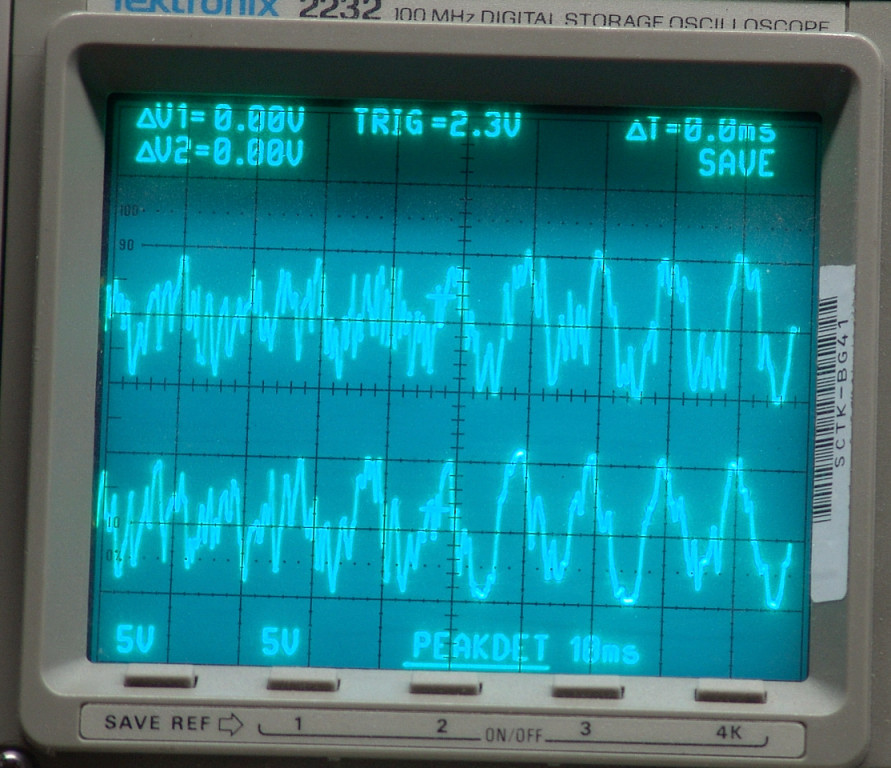

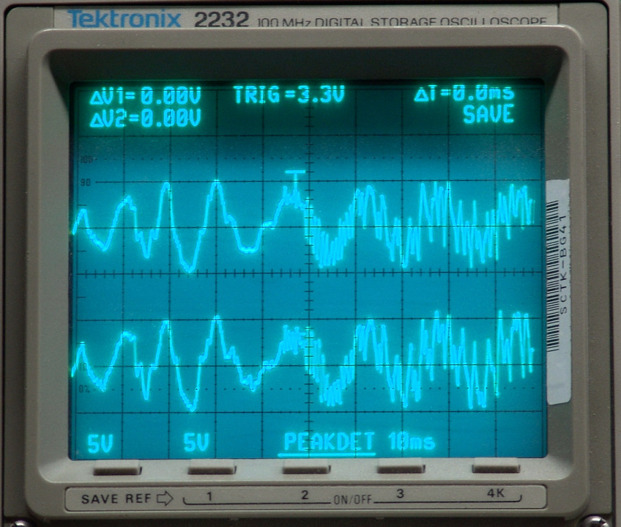

The scope is set on 5 volts per division with a 10X probe. That makes 50 volts per vertical division. It is also on 10mS per horizontal division. That puts the bass guitar notes in the third photo at about 100Hz. In all photos there are clean unclipped bass notes in the 80 to 100Hz range that are 80 to 110 volts P-P. No this doesn't mean that the amp is putting out 180 watts, it means that my "8 ohm" speakers are in the 10 to 15 ohm range at these frequencies. This is not uncommon with small speakers.

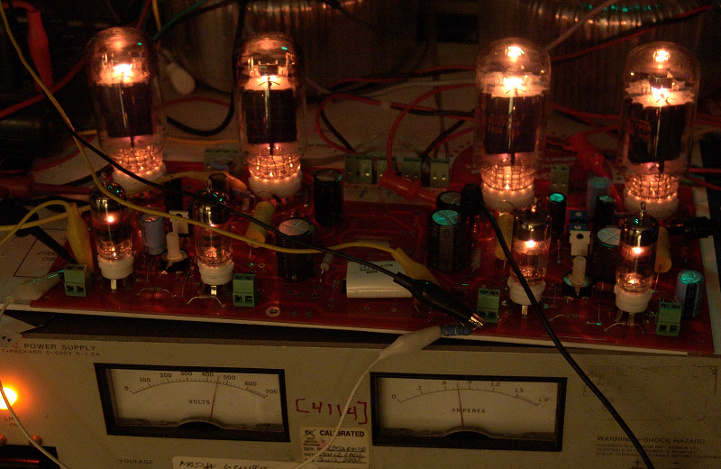

I have one 6LX6 tube and one 6LF6 tube. Some say that these are the same tube, so into the amp they went. The maximum power was only 80 watts. These tubes needed a bunch more negative bias, and more drive. More drive than the little driver tubes can make.

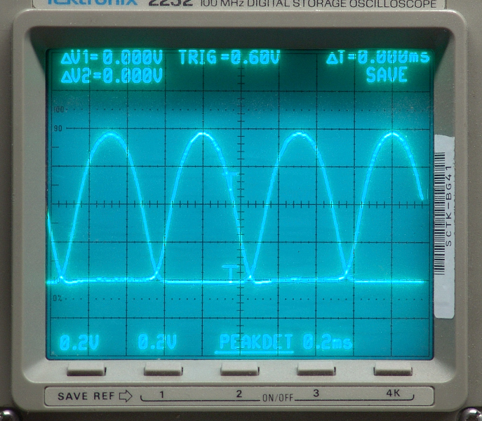

I have been playing with this board during the entire football game tonight. I have made an important discovery. Last night I reported some seriously low distortion readings on one channel, while the other channel refused to go below 2%. I believed that this was output tube related. I also discovered that the distortion VS output power could be tweaked by playing with screen grid voltage. Experiments tonight reveal that the situation is a bit more complex.
I have 8 6LR6 tubes that I got cheap on Ebay. They are all used, some a bit more used than others. I picked the 6 tubes that looked useable. The seller had already identified two as bad and they both look completely toasted. Together they make 26 watts at clipping from a 550 volt supply with the bias pots set for maximum current. I discovered that I could pick a pair of tubes that made awesome power ( 170 watts @3%) with good distortion when all of the trim pots were tweaked at max power. However the distortion went up as the power was reduced. WTF?
Pete alluded to the fact that some distortion cancellation was taking place. OK, last night I saw 0.11% at 1 watt and 0.77% at 50 watts, on an all pentode amp without any GNFB. Clearly Schade's magic is working here!
I have never seen it mentioned but it seems that for Schades magic to work well in a push pull amp, the transconductance in the output tubes needs to be reasonably well matched over the range of current that they will see in the amp. The range of currents seen in this amp go from cutoff to 800 mA in each tube! The first photo shows the cathode current for each tube in one channel on the scope while the amp is cranked to 180 watts. The vertical scale is 200mA per division. When you are dealing with used tubes finding a pair that really match isn't so easy. Some of the used tubes seem to lose transconductance as the current goes up. This seems to unbalance the amp. There is a sharp transition from "normal" to "broken" as the power level in increased. Swapping the two tubes within a channel moves the distortion from the top of the wave to the bottom.
Is this because I am cranking 10 times the power level out of my board than Pete intended? Will this be a problem on a more "normal" build? Can I even build something "normal"? I still have 20 brand new 6GV5's and a few other small tubes to stuff into this thing. Maybe the whole "matched tubes" thing will be fixed by using new tubes. Maybe the matching requirement diminishes as the power level is reduced. I have seen evidince of this. All will be told in due time, but I don't see powering this thing up again for at least two weeks.

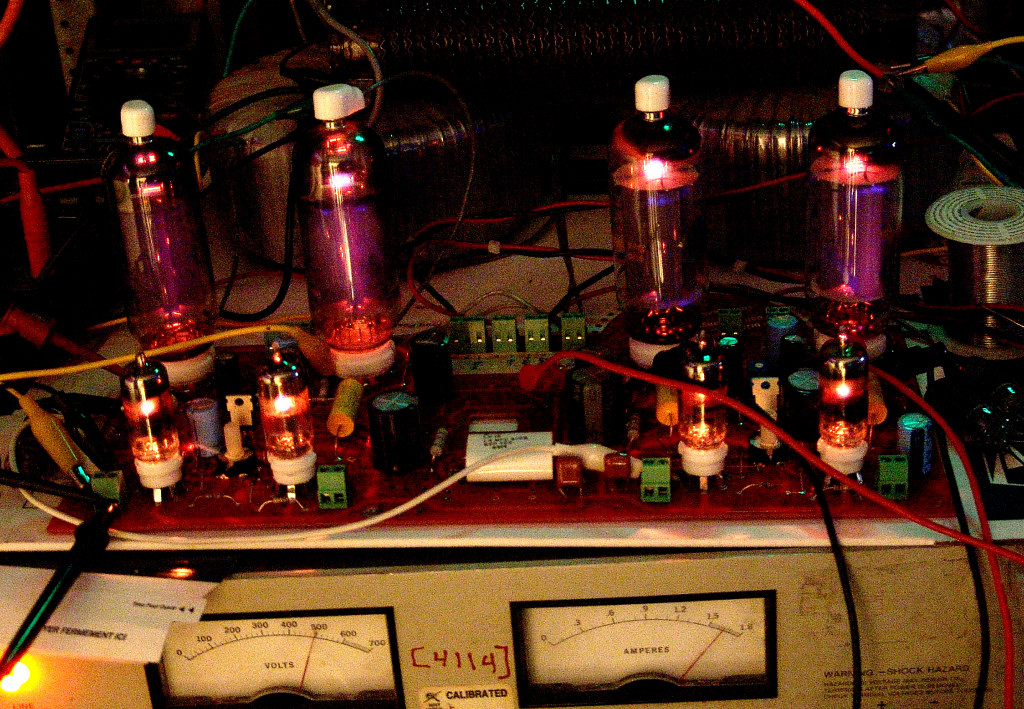

OK, so why be normal, it's so boring. It is a safe bet that the 200W SE test amp made with clip leads and an 833A doesn't fit too many peoples definition of normal. I could see how squeezing 150+ WPC out of the red board may not exactly fit in with "normal" either. In fact most of the engineers think that playing with vacuum tubes itself isn't exactly normal. So......
My rational side keeps telling me that 30 to 50 WPC is plenty, and after spending some time with an amp that now makes over 150 WPC I have come to the realization that my already bad hearing and my speakers are both in jeopardy.
That other inner voice keeps telling me to turn it up, after all why do you have 400 watt capable OPT's if you can't use them to their fullest. I have seen that the safe limit for the large sweep tubes is around 150 WPC, but I have a bunch of "grande" sweep tubes that I havent even tried yet.

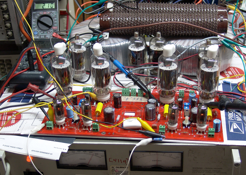

I hooked up the "normal" sized OPT's, wired for a 3300 ohm load. As expected the power output dropped. Instead of 100 WPC I was only getting 75 :( So, what to do? Turn up the voltage. I could get my 100 watts back at 530 volts, but these OPT's can't do that, can they? I dialed the supply back to 475 and hooked up some music. As I said before this board ROCKS.
The big tubes connected to the big OPT's definitely had bigger sound, bigger bass and total effortlessness. I did feel however that the amp could explode at any minute.
Now there have been numerous discussions on this forum about the right way to design and build an OPT. The discussions all have technical merrit and explain how to wind multiple interleaved windings and properly interconnect them to make the best possible OPT. What these discussions dont tell me is how these ultra cheap OPT's that were made for use in guitar amps, that have no interleaving at all, measure and sound so good! I have used these OPT's with everything from EL84's to 300B's and they just work.
Either way this amp works and it has been playing for over an hour. After cranking some Billy Idol at near clipping, the idle current returned to exactly 40 mA per tube when I turned down the volume. Despite the clip lead connections, the total hum and noise is 2.2 mV across the speakers.
