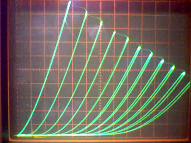

Here are some curves for the 35LR6 in various modes:
Plot1: g1 pentode: 50 V/div horiz., 100 mA/div vert., 125 V on g2, 2.7 V steps on g1

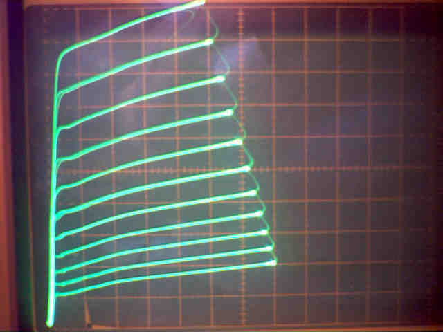

Plot2: g2 pentode: 50 V/div horiz., 50 mA/div vert., 5.3 V steps on g2

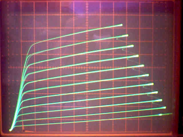

Plot3: g2g1 scaled: 20 V/div horiz., 100 mA/div vert., 5.3 V steps on g2, 5.3V/3.5 steps on g1

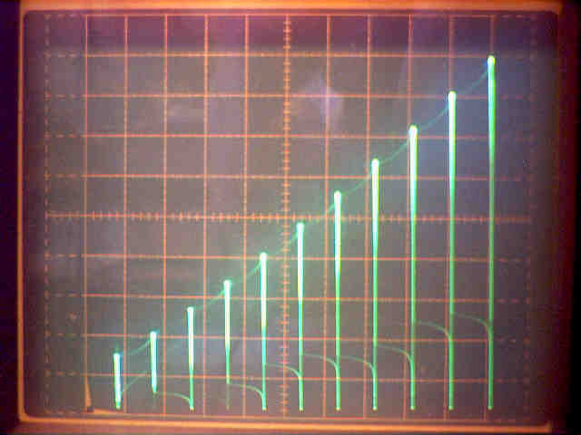

Plot4: triode config.: 20 V/div horiz., 50 mA/div vert., 5.3 v steps on g1

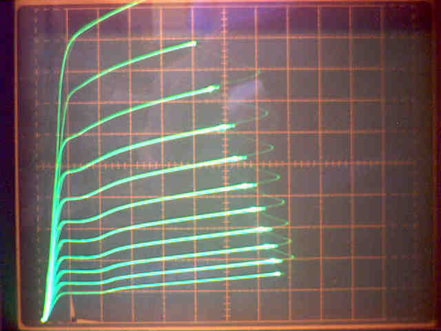

Plot5: g1 pentode: g1 volt versus plate volt (stepped)
Plot 5 seems to be the only gain function available, and I don't see any ready way to use it for P-P

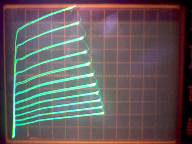

The little runt 6GF5 doesn't seem to have any datasheets either. Here are plots of the 6GF5 and 6GE5 under identical conditions (I didn't even have to touch up the bias, virtually matched), both GE manufactured.
I'd say they are the same tube, 6GF5 is just a chopped 6GE5. Can convert their datasheet gm's for similar currents with GM/gm = (Ip/ip)^.66 Same again.
Plot1: 6GF5: 50 v/div horiz., 20 mA/div vert., 100 V on g2, 1.4 V steps on g1
Plot2: 6GE5: ditto

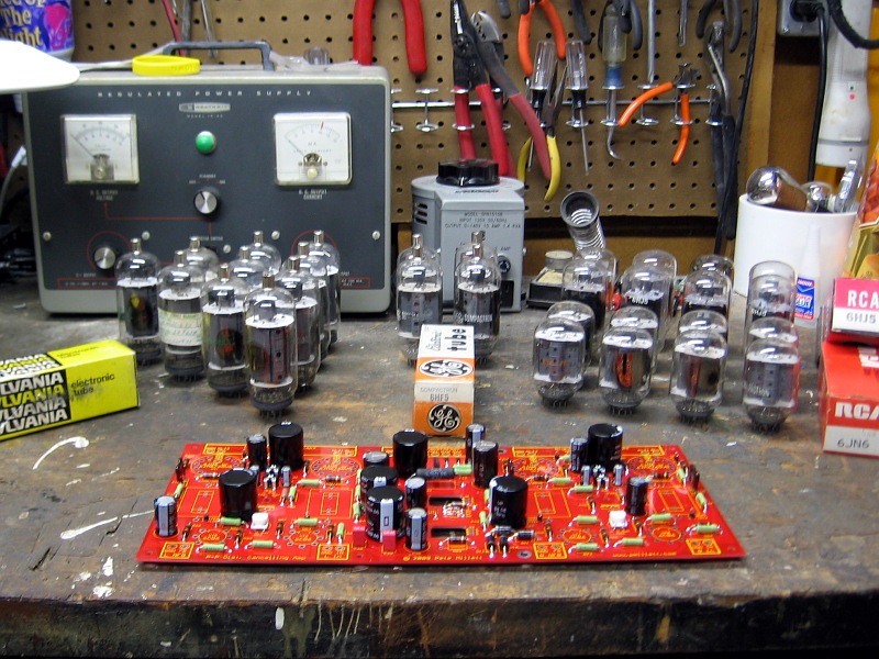

I just got back from a rather cold and wet hamfest weekend in Orlando. The weather really killed the crowd except for a few hours on Saturday.
I stopped in at the ESRC warehouse on my way up on Friday to pick up some tubes. I got some more EL84's for the Simple P-P builds, and I picked up 20 more 6HJ5's for experiments. I didn't look in the box until I got home. I now realize that I have 18 6HJ5's and 2 6JH5's. Stan told me that there were at least 2 other orders for these tubes after I called him for mine. If anyone else accidentally receives 6JH5's (they are bigger than a 6HJ5) DO NOT PLUG THEM INTO THE RED BOARD. You might get a visit from the smoke monster and the fire gods. I will contact Stan on monday to see about exchanging mine.
I did manage to collect about 25 interesting cheap tubes Saturday morning. I got 7 6LF6's for $1 each. I have a suspicion that they are dead since the seller was selling "untested" tubes for $1, but the "tested" ones were $20 each. Either way, I will be wiring my red board back to the original configuration to "test" these tubes.
After spending two hours with these 7 6LF6's and the two that I already had, I have come to realize that my two original tubes are bad.
I started plugging tubes into the red board and began to wonder how it is possible for a tube that looks perfectly normal with a shiny getter to be so dead that I have to zero the bias and crank up the screen voltage to get any current. After 4 in a row I was beginning to believe that I had wasted $7. The next tube would draw 100 mA of screen current but zero plate current. Yes someone had glued the plate cap on with JB weld. After popping the cap I found that it had been arcing and there was only a nub of wire left. Connecting the plate up with a clip lead yeilded a good tube. Then the last two tubes went into the board. Bingo both tubes matched and cranked out 95 watts with 450 volts and a 3300 ohm load. After I saw this I put in the tubes that I already had. Only 40 watts. One hamfest tube and one of mine in any combination yeilded unbalanced current and clipping on one side only.
Well now I have 18 6HJ5's to test. Time to rewire the board again.

Succumbed to peer pressure. Thanks to Pete for yet another distraction...my wife is thrilled already (not). The pin outs of these tubes are different, as has already been mentioned, but the net differences are subtle because of how some grids show up on multiple pins for some. Just a matter of lifting a resistor and/or criss-crossing a pair on the PCB, depending.
Time for some experiments. Thanks to George for pointers on different sweep tubes to try. A big sweep tube amp might be in the future, depending on the condition of those 6LR6's on the left.
I see some of the magic tubes in the picture. There aren't too many of them left, so I plan to get a few more before they are gone forever. My board seems happy running them in the 80 to 100 WPC range using a pair of the "ugly OPT's" wired for 3300 ohms.
The red board has been temporarilly voted off of the workbench so I can finish 3 different Simple P-P builds.
At least Sherri thought the board is "pretty". I have since uglied it up a bit.

That is the first time I have seen that much of the surface of my workbench in years. I finally finished the basement renovations a month or two ago, so the heap of tools and junk has finally been put/shoveled away. Can do some tube projects there again. I've been meaning to rig up the SSE and TSE for some measurements, but lacked the space to do so.
Also have one of Pete's sound card interfaces mostly-stuffed, but I am missing a few components. Will have to keep using the Vellemans for now. I need a real scope.
The red board will be voted off the bench for a while shortly as well....
