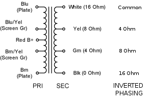

Thanks, do I just hook up the feedback to both the 4 and 8 ohm posts both? Sorry for the stupid questions.
Al
If you are inverting the winding the way I described above, then you would use the 4 ohm tap for feedback (because it's really now the 8 ohm tap). I have attached a Hammond diagram modified to illustrate what I mean.
I would assume that you want to use the same tap that Pete used for feedback regardless of which tap you use for your speakers.
Someone correct me if I am wrong here.
I must have been smoking something pretty good when I wrote all that. I am completely wrong on several levels...ignore what I said about swapping the secondary. Hook it up as it should be (common on ground, 4 ohm on 4ohm, etc) and use the 8-ohm tap for feedback. The way to invert the phase on a PP OPT is to swap the PRIMARY wires. I suspect Pete has it all figured out for the Edcors. I don't know why he hooked it up that way.

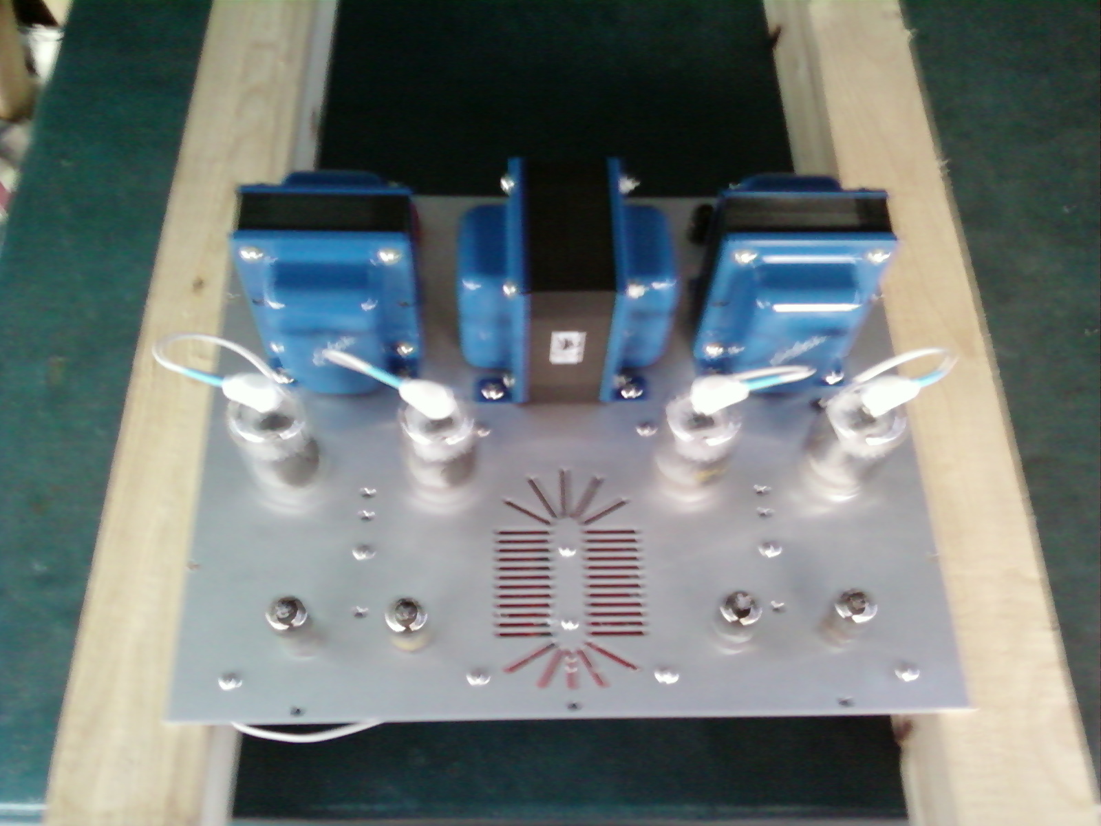

Well ok. I hooked it up as you said earlier and it seemed to work ok on some minimus 7s. I will hook it up the other way before I fire it up again on good speakers. Here here is a crappy cell phone pic. Now I need to give this lady a skirt.

Thanks I bought it off a guy on ebay. He added a couple of extra things such as holes for plate caps and the extra hole for a binding post. I think he is selling them for 45 bucks. The sink seems to work, after being on for 45 min the plate was barely warm.
