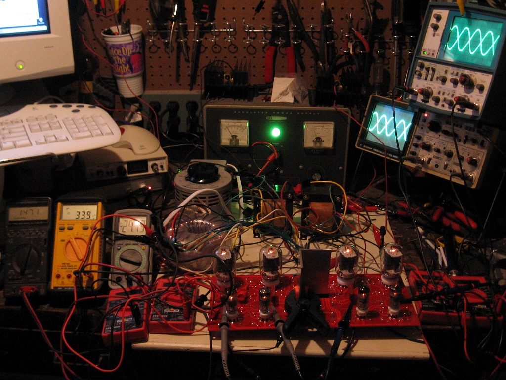

Let there be volts. This is the "stock" setup with 6JN6s. Got about 21W before clipping @ 1kHz. The GNFB loop was not hooked up, but the spectra looked decent even though the tube matching was poor. I didn't spend any time trying to find a better match. Setting the bias was touchy.
The board is powered by the AN-4T360 on a variac to give me 340V B+. Bias is coming from the bench supply right now. Tested it for maybe 5 minutes before hooking up speakers and playing some music. Sounded good and had plenty of power to kick around the "good" shop speakers, which are not easy to drive.
Next step is to reconfig for 6HJ5 and see how the stock PSU filtering behaves at higher B+ voltages and currents. That makeshift heat sink got quite warm during this quick test.
Oh, and the 6JN6s cranked to 450V B+ briefly yielded a little over 40WPC at clip.

Had a few moments to play with it again. Got about 30WPC out of the 6HJ5 at 350V B+, but I was having some trouble with runaway at higher voltages. I'm only using pin 11 to control the grids. Maybe I should use pin 3 too? I'm also thinking that 1k is too high for a screen resistor.
