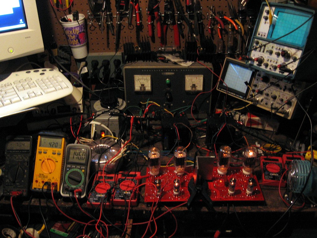

Got about 30WPC out of the 6HJ5 at 350V B+, but I was having some trouble with runaway at higher voltages. I'm only using pin 11 to control the grids.

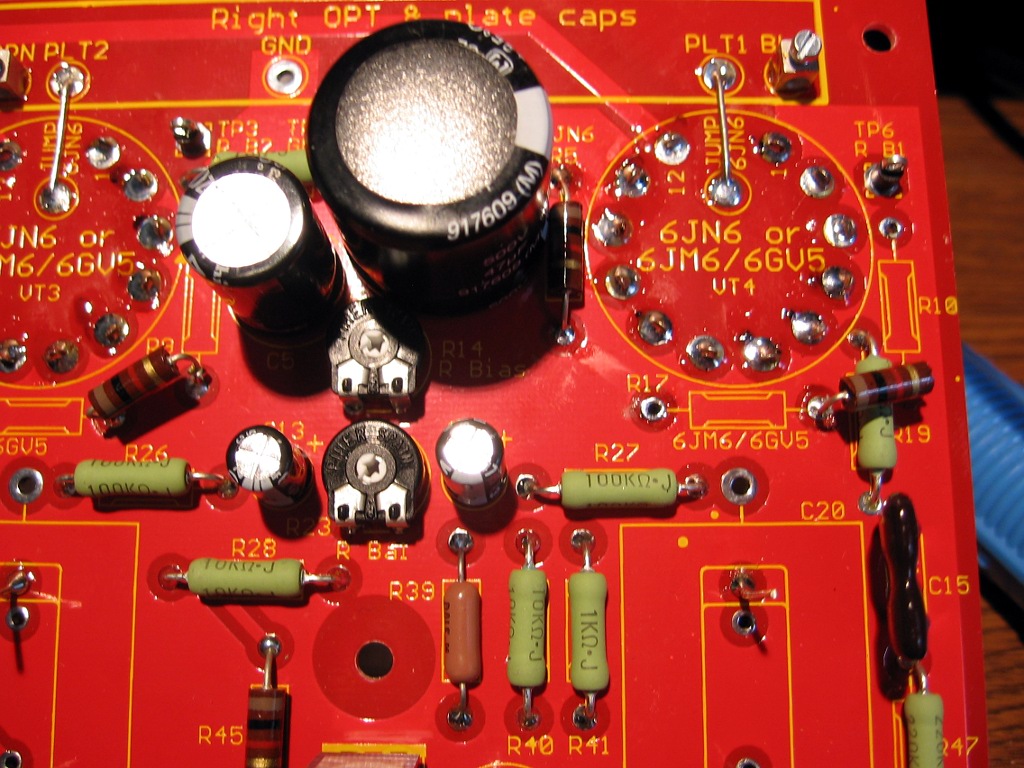

I looked at my board and I only have pin 11 connected.
I'm also thinking that 1k is too high for a screen resistor
Usually a bigger screen resistor helps in the runaway department, but I have 620 ohms on my board. That resistor value was based on the fact that it was the first reasonable value that I found when digging for parts during the build. My grid stoppers are 1K 1/4 carbon comp (again based on availability). The other deviation from the normal build is that I am using a regulated power supply for my negative voltage and I have it set on 75 volts. Some big sweep tubes need even more.
I have run my 6HJ5's to 600 volts briefly but settled on a lower voltage until I swap out a few capacitors to prevent another explosion. I am using the 3300 ohm connection of those OPT's to get more power.

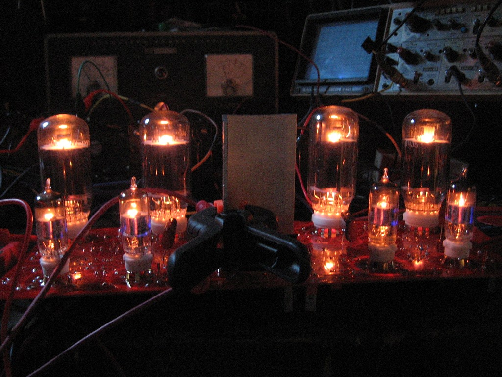

Thanks. One of my tubes appears to have an internal short. I tried it one more time and I saw a little yellow spark inside before it went nuts. Reset back to 350V and I could make the bias go wild by tapping on the tube.
I'm also using a regulated supply for the bias, but it is connected at one of the rectifier diodes so simulate the real conditions more. I'll play with it again today if I have time.
Swapped the two tubes that were giving problems. The amp is more stable now. The last batch of 6HJ5s Stan sent me were not well packed...they were sort of flopping around in the box.

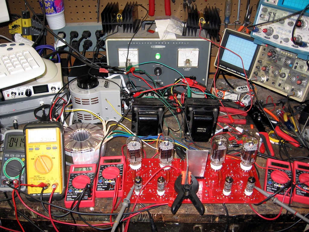

Got 80WPC at 500V B+ until the fuse blew on the variac, LOL. I keep a small fuse in there...probably 2A or something. This is through the mystery transformers. They are 60s vintage, so if I assume they are 8 and 16 ohm taps then I measured about a 6.4k primary. Based on the weight they are probably 50W iron, so I am probably reaching the limits of what I can do. This was with an 8 ohm load on the 16 ohm taps.
This is through the mystery transformers.....They are 60s vintage
Are you referring to the transformers that you got from me? That's what I see in your picture. If so the date code on the carton that I took that pair from reads 9016, early 1990. They are 6600 ohms CT with 4, 8 and 16 ohm taps. Black is common with yellow being the 4 ohm tap, green-yellow the 8 ohm tap, and green being 16 ohms. I was using the black and green wires with an 8 ohm load for my 6HJ5 experiments. This will reflect a 3300 ohm load to the tubes. The spec sheet said that these were 80 VA transformers intended for use in a guitar amp from 80 Hz to 4 KHz. The actual useful power rating is limited by saturation and depends on what frequency range you want. From 20Hz to 20KHz you can put about 15 watts through these transformers before they begin to distort. From 30 Hz up 25 to 30 watts is OK. At 1KHz I have run almost 200 watts through one without distortion or smoke. At this frequency I am afraid of insulation breakdown due to voltage at any higher power.
I had one that put its own internal light show before sparking out. Lots of purple lightning bolts inside it. That resulted in me testing all 20 but it was the only bad one. I got 20 more last weekend, but have not had time to test them yet. Stan replaced the bad one from the last batch.

I thought I was going insane yesterday. Turns out that one of these mystery transformers is phased opposite of the other. Normally this wouldn't matter that much, but since I had both OPT "commons" grounded and my shop speakers have their negative wires tied together at a switch box, it ended up mostly-shorting one of the channels...but only when both OPTs were connected. Couple that with the really strange experience of seeing a fair amount of output coming from an amp with no output tubes in it, it makes one question their sanity. The latter behavior is due to the driver stage feeding the OPTs backwards through the plate-to-grid feedback resistors. I wouldn't expect to see much output through a pair of 220k resistors, but boy was I wrong.

Returning to the world of the sane. Everything works fine now with everything hooked up and powered sanely. The heaters on these tubes max-out the 6.3V windings on the transformer, so it turns out that the voltage surge at powerup is only about 460V. No need for special power-on mods with the AN-4T360 and 6HJ5s. The surge was worse with the 6JN6s as their heater requirements are much lower. In fact, B+ sags to around 420V with the tubes biased at about 50mA. The tubes want more volts and more current. Time to pull-out the AN-4T400.
George, what are you idling these tube at? I went as high as 80mA and they seemed to want it and more, but I don't think I can sustain such high currents on both channels with the on-board power supply.
Listened to it for an hour or so at normal settings (420VB+, 50mA bias) playing some really heavy bass stuff (ASoT). This thing kicks the stiff woofers on my shop speakers with even more authority now! My wife was not pleased that the living room upstairs was rattling, but I've never heard these speakers sound this good (Boston Acoustics A60s).
On the dummy load I got about 60WPC at clip at this B+ level. If I crank the variac to the max I get about 80WPC. The tubes showed no sign of distress and the amp was very stable. The only problem with increasing the headroom is the amp needs more gain to use it. A preamp would be a must to reach its full potential, but how much power do I really need?
