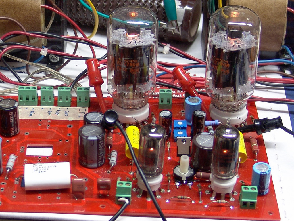

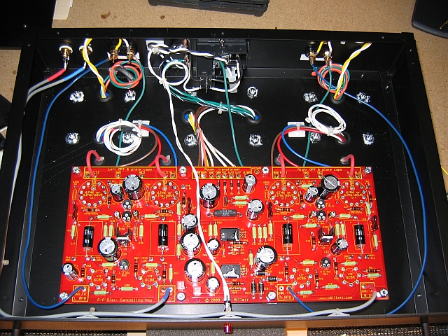

With the arrival (at last) of the Edcor iron yesterday, I finished Pete Millett's "Engineers Amplifier" (aka DCPP) this afternoon. This has been one of my most satisfying tube projects to date; mostly due to Pete's excellent PCB and error-free BOM and instructions.
I built my DCPP pretty much as per Pete's original, deviating only on the chassis type and use of 6JM6 (plate cap) Compactrons. The PCB is beautifully laid out, and stuffing it is a breeze. The PCB is worth every cent Pete asks for it.
I can't comment on the design as the details of it are way beyond my knowledge. However, I do have a good set of ears and some very good audio gear as a reference. I built this amplifier confident in knowing Pete's reputation in the DIY community. I wasn't about to be disappointed.....
I connected some cheap speakers and a CDP, and threw the switch for the first time. Tubes lit and music played! I connected some DVM's to the handy test points on the board, and set the bias and driver balance. Easy.
After about an hour, the circuit stabilized nicely with 40ma on the Compactrons. And yeah... no hum, no hiss. This baby is background quiet!
At first, I thought of connecting the DCPP to the bookshelf speakers I usually use with a "small" amp. But what the hell...instead, I hooked up my Vandersteen 2ce Signatures. The 87db Vandys usually laugh at little amplifiers, only playing well around 70wpc and beyond.
Popping a familiar Wayne Shorter CD in the player, I sat down fully prepared to be under-whelmed. Not! The DCPP made me sit up and take notice....this thing kicks ***!! Talk about dynamics. The Millett design does deep, tuneful bass along with clear and sparkling highs. Other discs showed more good stuff. Overall, it's a very honest and revealing amplifier. In a nutshell, I'd say the best qualities of tubes, with the punch of solid-state.
I imagine with 50-100 hrs on the circuit, the sound will be very near equipment costing much, much more. It's going to be fun playing music with the DCPP.
Many thanks to Pete Millett for the design and the quality PCB. And thanks too, Pete, for your other, generous contributions to the DIY audio community.

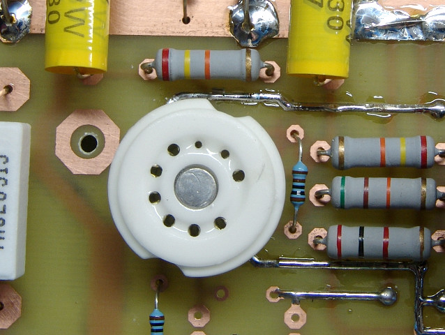

Need some help
Hi all,
I am having trouble finding the correct 7 pin sockets for this project. I have order 2 set from 2 different places and I so far none of them fit in the board. Anyone out there willing to share their source and part number with me?
Alan
Hi all,
Alan
Hey Alan...
I got mine from the tubestore.com
7 Pin Socket for Miniature Tubes
You do have to tweak (bend outward) the tabs a bit to fit the board. It's not a problem.
Those look like the same ones that I used. I am sure that they all come from the same Chinese source. Verify that the tube actually fits in the socket before soldering it into the board. I have found more than one of the 9 pin versions of this socket with one or two holes that were too small.
George...
You make a very good point that did, in fact, come up during my build.
I'm sure all current ceramic sockets of this type do indeed come from China. Good thing too, as we'd have a tough time finding the odd-ball sockets for Compactrons etc.
Anyway, I found these sockets have very tight fitting retainers. If I would have forced the issue, I would have ended up with broken glass in my hand! You need to take a very finely-pointed object (I use a dental pick) and open up the metal retainers just enough for a good fit. I had to do this on every 12-pin and 7-pin socket I bought. As a matter of fact, if you looked at the sockets, as purchased, you could see some of the retainers were fully closed up!
I got mine off of eBay from a vendor that turned out to be ESRC.
I got mine at a hamfest, but when I buy sockets at most hamfests I get them from Stan (ESRC) unless I am looking for something that he doesn't have.
These sockets are of the two piece variety. There is a ceramic cover that holds the pins in the socket. I have found a few cases where the holes in the top ceramic cover are smaller than the tube pins. Enclosed is a picture of the very first Simple P-P prototype board. I built the entire board and then found out that one of the 12AT7's doesn't fit. I then tried to drill the ceramic with a Deremel tool resulting in a drill bit broken off in the hole. I no longer use the 2 piece 9 pin sockets, but I haven't seen a one piece 7 pin socket yet.
