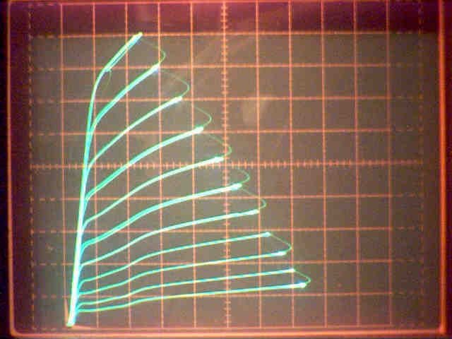

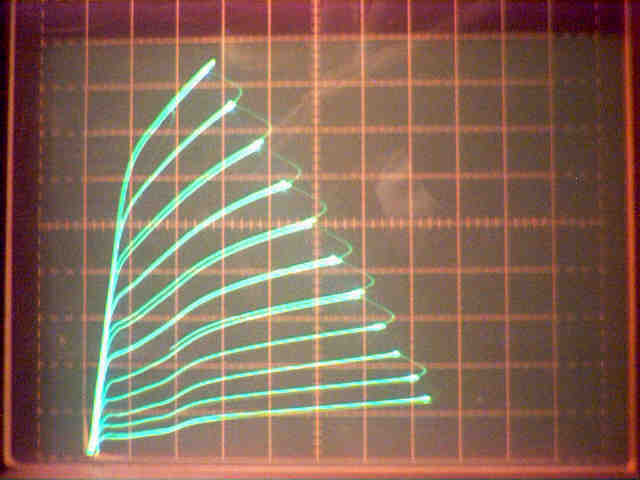

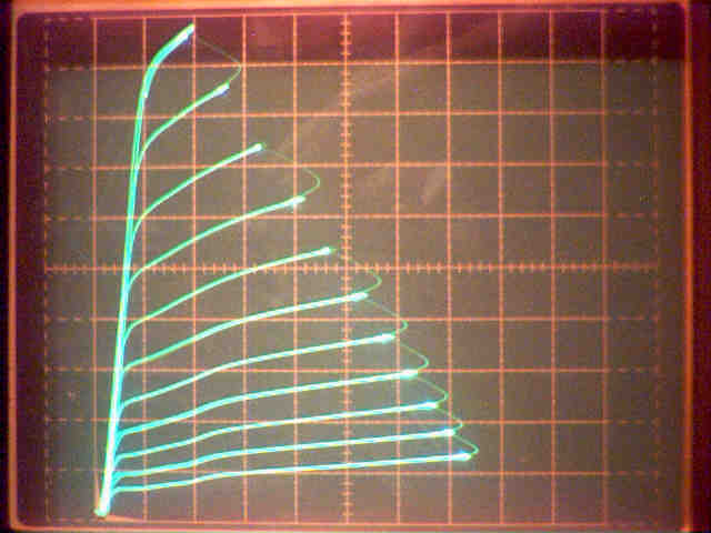

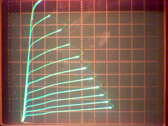

Here are the curves for the 6HJ5 (50V/div horiz., 50 mA/div vert., 2.2 V g1 steps, 115 V vg2) for a 0 Ohm, 120 Ohm, 480 Ohm, and 960 Ohm stopper on g2. One could play around with the value of the g2 stopper R to modify the harmonic dist. spectrum. But obviously the most power output, for a given screen voltage supply, will be with the lowest stopper value possible.

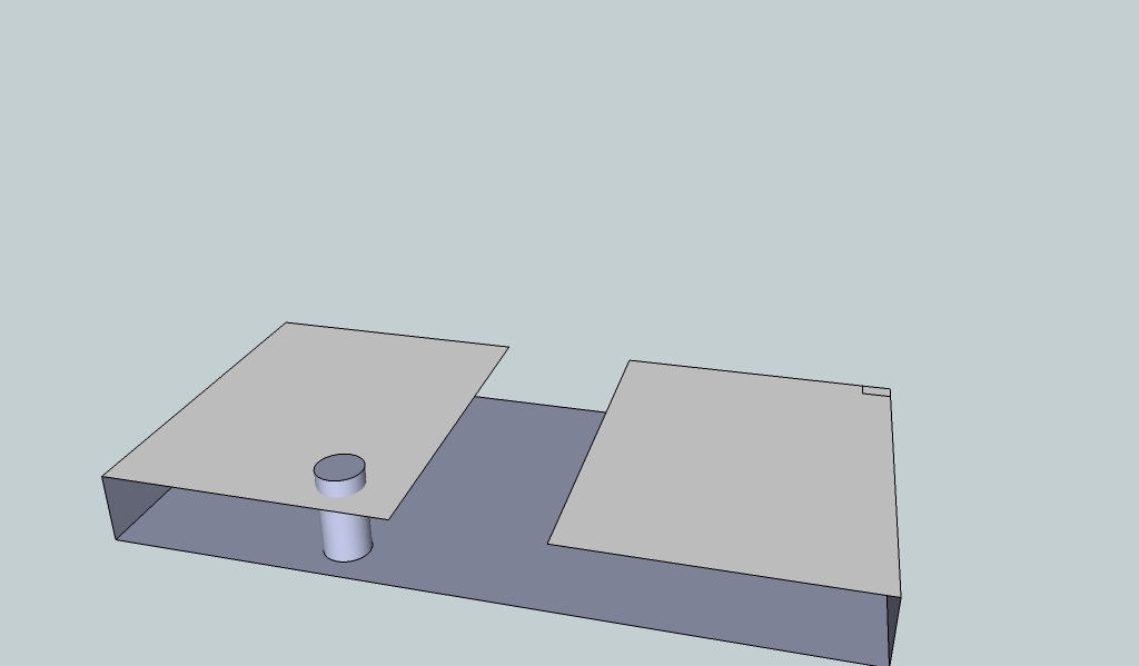

For mounting your giant capacitors how about creating a mounting platform that is secured to the mounting holes on the board via some standoffs. It is a bit hard to explain. If you used something like a 1" nylon standoff you will probably have to cut some holes in the board to allow the electrolytic caps to stick through. Perhaps some vent holes as well. The picture is pretty bad, I did it in about 30 seconds. But I was thinking you could leave the middle portion of the board open where the fets are. Use two boards on either side secured by bolts from each of the 10 mounting holes.
