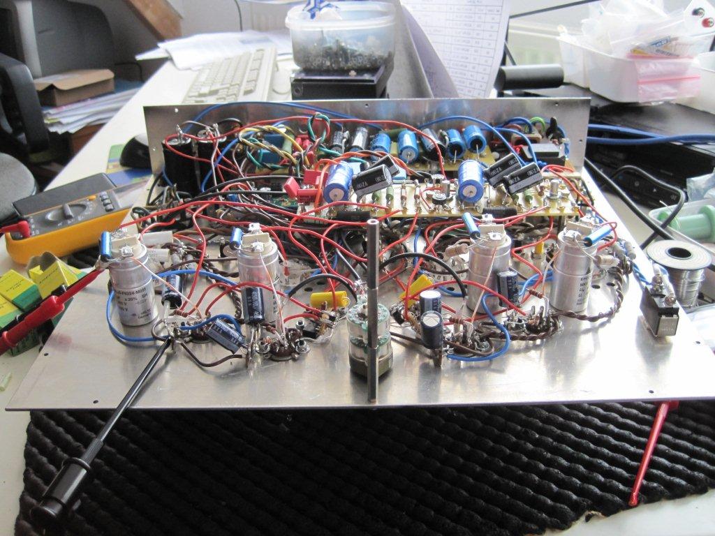

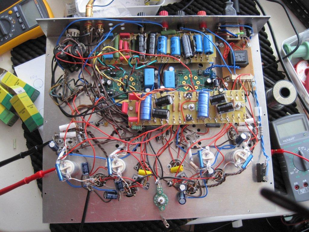

I made it P2P and it looks like a jungle or a Japanese city under the deck, but there is very little hum on one channel and none on the other channel. I use a different B+ regulator with dn2540 mosfet and 2 glow tubes in the 150V regulator.
The amp sounds really unbelievable good in the first minutes already. I will tweak it further and report later.

I would like to see a picture please Jaap. Sounds like a daunting task.

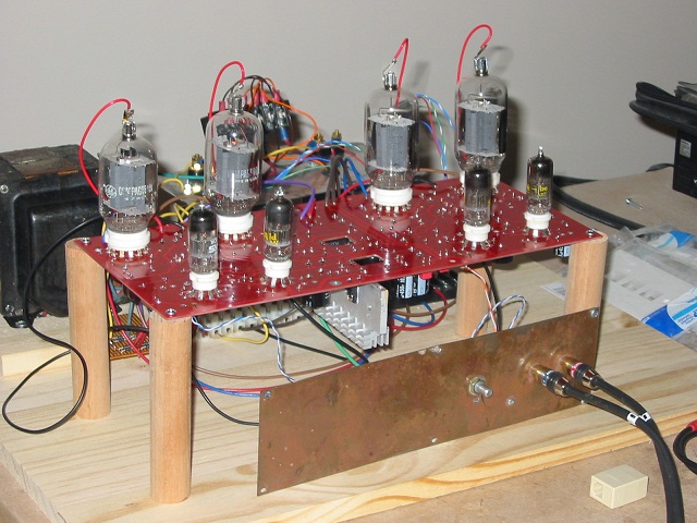

Woo its all coming together. Edcors are on order, mouser shipped, got caps, got sockets.

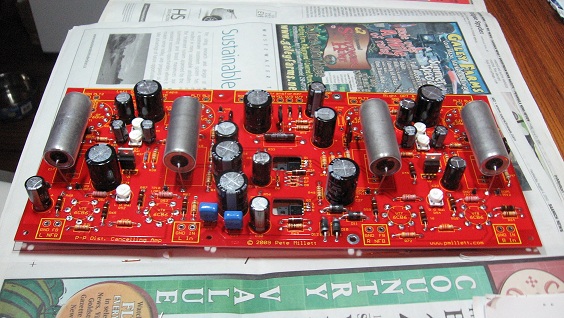

One question since this is my first tube pcb, tubelab seems to put a half components width in between the board and the component. Ive only done this in the past for ferrite beads, should I do this with this board for i assume heat disapation?
I personally would. There is quite a bit of heat radiating off the board. I also find it easier to take measurements when they are off the board a bit.Woo its all coming together. Edcors are on order, mouser shipped, got caps, got sockets.
tubelab seems to put a half components width in between the board and the component......should I do this with this board for i assume heat disapation?
Part of this habit comes from personal experience, part may be supperstition. I worked in TV, stereo and other consumer electronics repair through high school and for a few years after that. 1967 through 1973. I watched TV sets and stereos transition from PTP wired tube circuitry to PC board tube circuitry (Zenith was the last hold out with their "hand wired chassis") and finally to PC board mounted solid state. The early PC board designs had new failure mechanisms not seen in PTP wiring. Much of this was due to the junk phenolic PC boards used in the early sets, but we learned that components pulled down tight to the board often failed to an open, expecially radial leaded electrolytic caps. The PC board and its components in a vacuum tube design go through some serious thermal cycling in normal use. This can rip leads loose from the internal connections inside components over time. I must have changed dozens of cathode bypass caps in the vertical output section on late 60's Philco TV sets. They didn't go completely open, they became resistive or temperature sensitive leading to stretched out pictures.
PC boards have improved a great deal since the brown phenolic junk of the early 1960's. Components designed for PC board use have improved too. I used to recommend putting a piece of double stick tape on the bottom of radial electrolytics since we did this in TV sets to prevent callbacks. Notice that good quality caps now have a thick rubber base to allow for some thermal expansion and contraction. I would still allow for a small space between the cap and the PC board, 1/32 of an inch is good. The lead will get hot when it is soldered. It can grow by 1/32 of an inch during soldering. It will shrink as the solder cools putting the leads under stress form the beginning. I still don't like pulling the components tight to the PC board since the board itself will grow when hot and chances are that its thermal expansion characteristics are different than that of the components. You don't want the board pulling on the component leads.
Components like resistors will generate heat too. You want airflow all around the component to help shed this heat and avoid dumping it directly into the PC board.
