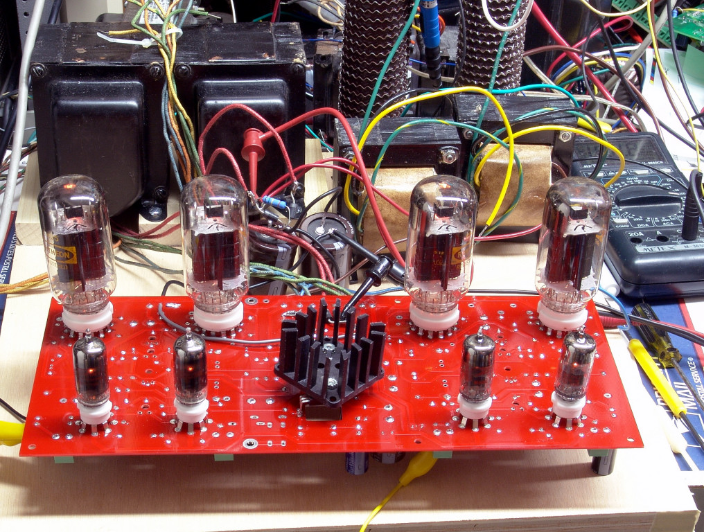

I plugged in the second power transformer, reset the bias and cranked it up. When both channels are driven hard the power instantly rises to the expected 125 WPC, then folds back to about 100WPC.
Measure the voltage at the output side of the resistor at the junction of the resistor and the mosfet. The voltage is about 280 with no signal and drops to 130 when the amp is cranked hard.
No pictures now. Micro$haft installed updates yesterday and now Vista won't recognize the CF card without a reboot. They think if they update Vista until it doesn't work any more I'll buy 7.....not happening....I'll put XP back.
More experiments tomorrow.
I replaced the 4.7K resistor with a 2.5K resistor and the amp now cranks out 125WPC. The screen voltage holds a steady 147 volts from no power to full power.
The B+ voltage is lower than the last board, using the same tubes and transformers, but it has been very hot and everybodies AC units are humming. It is also dinner time. 600 volts at idle, 560 volts at 250 watts out.
I also made some changes to boost the gain and get the driver plate voltage up to 135 volts with 6GU5's. Time to hook up some speakers and crank it!

LOUD was putting it mildly. I just achieved a new personal best. A turn it down call from 1200 miles away! It seems that the lady that lives across the street was taking her evening nap when I dimed some Linkin Park. She called the house phone a few times without success, so she called my wife in West Virginia who called my cell phone which was set on vibrate in my pocket.
I played this amp for an hour at full volume. Disturbed and Linkin Park could provoke some audible distortion. I don't know if it was clipping, OPT saturation, or speaker Xmax limitations, but it was extremely loud. Most of my other CD's were loud with no trace of distortion. Dave Brubeck was comfortably loud, but it is a quiet CD. I think the amp still needs more gain.
I will have to make sensitivity measurements on this amp and board #1 to see if my changes made any difference. It seems louder, but it's still not enough. I am not sure you can get to the point where clipping can be reached on all CD's without another stage, but that is what board #1 is for.
#2 passed the burn in test without burning out, so now its time to make a pretty box for it. #3 will be reserved for the results of some experiments on #1. I am itching to feed it some DH pentodes.

I am amazed at the sound and power that comes through these little OPT's with this board. I have seen them saturate with a Simple P-P at 25 WPC. I saw a perfect 40 Hz sine wave flowing out of this amp tonight at 80 WPC. The distortion was 3%. They are guitar amp OPT's made for 6600 ohms, but I am running them at 3300 ohms by putting my speakers on the 16 ohm tap. One of the experiments I am going to try is to see if running 2 OPT's in parallel will make even more power.

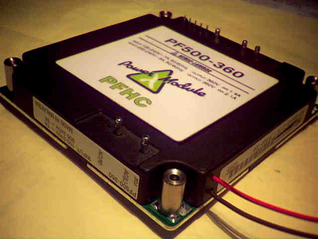

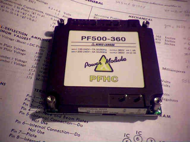

You could get 360 V regulated out of the 10 pounder by using one of these:
(got it on EvilBay for $30, rated for 500 Watts! There's a 1000 Watt one too.)
Oh, and found a tube (17.5 watt, octal though) that is cheap and might be of interest to try on the board: 12GC6
It was a buy it now deal from a few months ago. Hopefully more will show up some time. I got one of the 1000 Watt modules last Spring for $25. I hadn't really been looking actually, it just showed up in a search for a Lambda power supply I was looking for. No idea how often they show up. They aren't isolated, have to use some kind of isolation xfmr, 100 VAC to 240 VAC input range. They are PFC, or power factor corrector front ends for a power supply (a boost converter). They draw current proportional to instant AC voltage, so look like a resistive load on the power line. But they also regulate to the 360 V output, very convenient. They can be bought new, but are around $150 I think. It's a Lambda PF500-360. I think the new units are PF500-360A, just a control mod for on/off sequencing with their DC/DC modules.
OH, takes a couple capacitors on the input (after the rectifier in the unit) and output and a resistor or thermistor for soft start. Fairly simple to set up. An input filter module is also recommended too since it is a switching unit. They make a custom module, but a surplus Corcom line filter works fine.
Vicor makes a similar 260 VDC unit (off of 120 VAC), called VICOR-HAM or HAMD module, but I haven't found one of them yet.

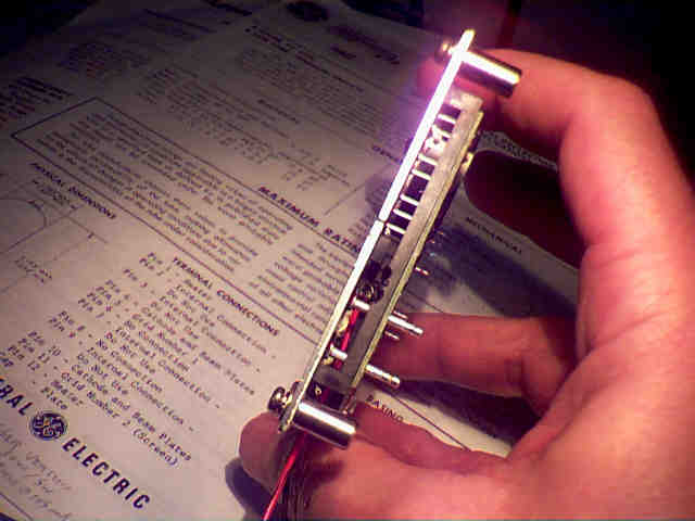

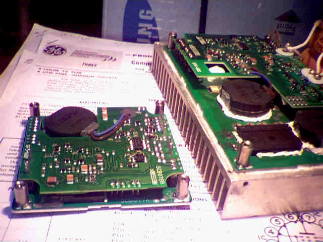

Arghh! The bridge rectifier is readily accessible on the 1000 Watt model, but the 500 Watt model has it stuffed between two PC boards 1/4 inch apart. Can reach the neg. bridge terminal easily, but the positive bridge terminal is 1/2 inch in from the edge with some plastic spacer in the way. Might be able to solder to it with a long thin soldering tip.
Can always just put another bridge rect. in front of the PFC module with a small cap across that, then in to the PFC. But nicer to avoid the extra bridge diode drops if possible.
Turned out to be easier to connect up the aux cap connections to the PFC bridge rectifier than I expected. I just used "precision" surgical technique (a small Rat Shack soldering iron with a #14 copper house wire tip, custom bent up to form the soldering tip in just the right way) to reach in and solder the recessed terminal. The easy to reach neg. terminal proved to be the harder one to solder since it had some silicon glue on it. Then a couple of small holes thru the case completes the job. TFE covered leads.
Have to determine what minimum size cap works to keep it in continuous mode operation with the specified load now. I'm guessing a 1 uF/600V mylar cap will be sufficient to eliminate the ripple glitch. The 360 VDC output should look like a linear regulator output now. Well, I'll put some ferrite filter beads on the output too, a common mode ferrite choke too. A second big electrolytic at the OT CT too.

All the PFC designs that I'm aware of are NON isolating, although it should be possible to design one at increased expense. (would be a nice product for tube audio) The place where I see these as being most useful is for a Circlotron or Elliptron amplifier where two floating B+ supplies are needed. I got some Stancor TGC175-230 split bobbin xfmrs (175 Watt, 2*120 V to 2*120V, just 67 pF common mode capacitance) to use this way. (Triad, Magnetek, Hammond, .... all make similar)
Trying to make two floating, regulated, B+ supplies the usual way with very low common mode pF capacitance would be too much of a headache. And the usual switching supplies have high capacitance between input and output and ground. (but could be run through the same split bobbin isolation xfmr, seems a bit redundant/silly though)
The PFC units are a good match for the 10 lb boat anchors if you just want 360 VDC regulated.
Even at the $150 new price, they are about the same or less than the usual tube iron. But for surplus iron, well, have to go surplus PFC to compete.
Oh, yeah. I forgot to mention that these modules provide a remote turn on logic level input for delayed B+ power up (as well as standard soft start). Could be quite usefull too. (They have an SCR in them that can turn on the DC output, but not turn it off without power removal)
