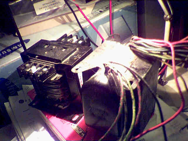

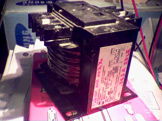

There are those 480 V industrial control xfmrs on Evilbay. Pretty cheap usually. I got some of these 500 Watters a while back for $15.
2nd picture: Warthog versus Boat_Anchor. About the same size. The industrial xfmr would normally be rated at 300 Watts at that size, but this is wound with Hi-temp materials and rated for an 80 degree C rise. Probably cook eggs on it at 500 Watts. The boat anchor is probably a 250 Watt xfmr.

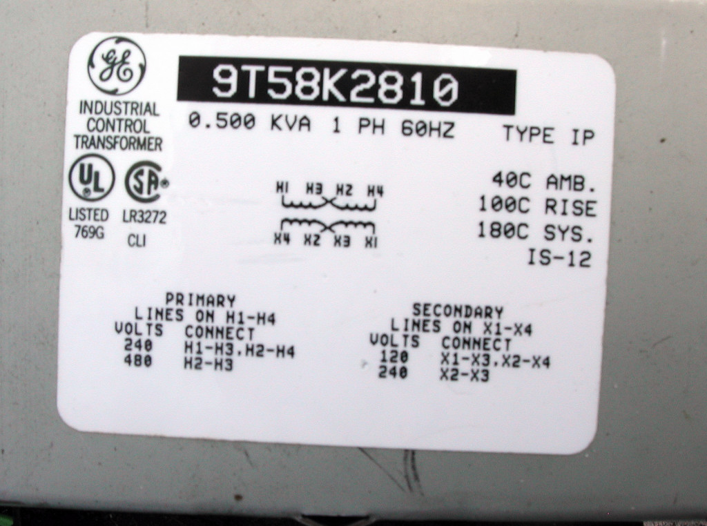

I have seen quite a few of these that have 220-480v primaries and 120v secondaries. These seem if wired with 120v as the primary you would only need to find a bias and filament supply. This seems like a pretty affordable option as well. The few I have seen are in the neighborhood of 750va....pretty large.

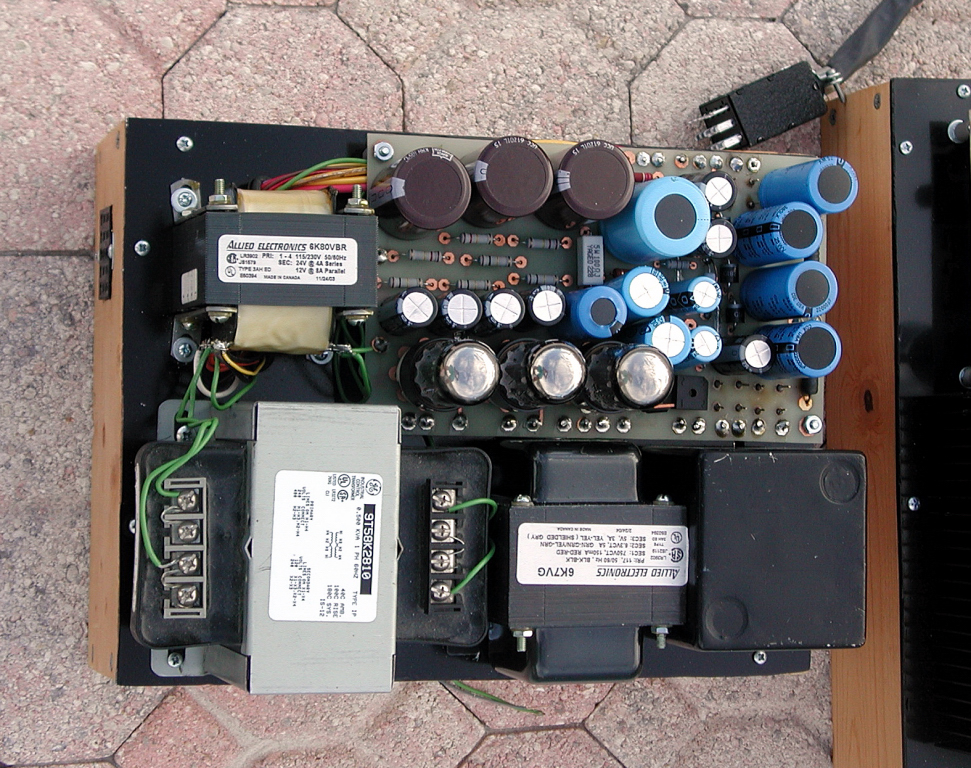

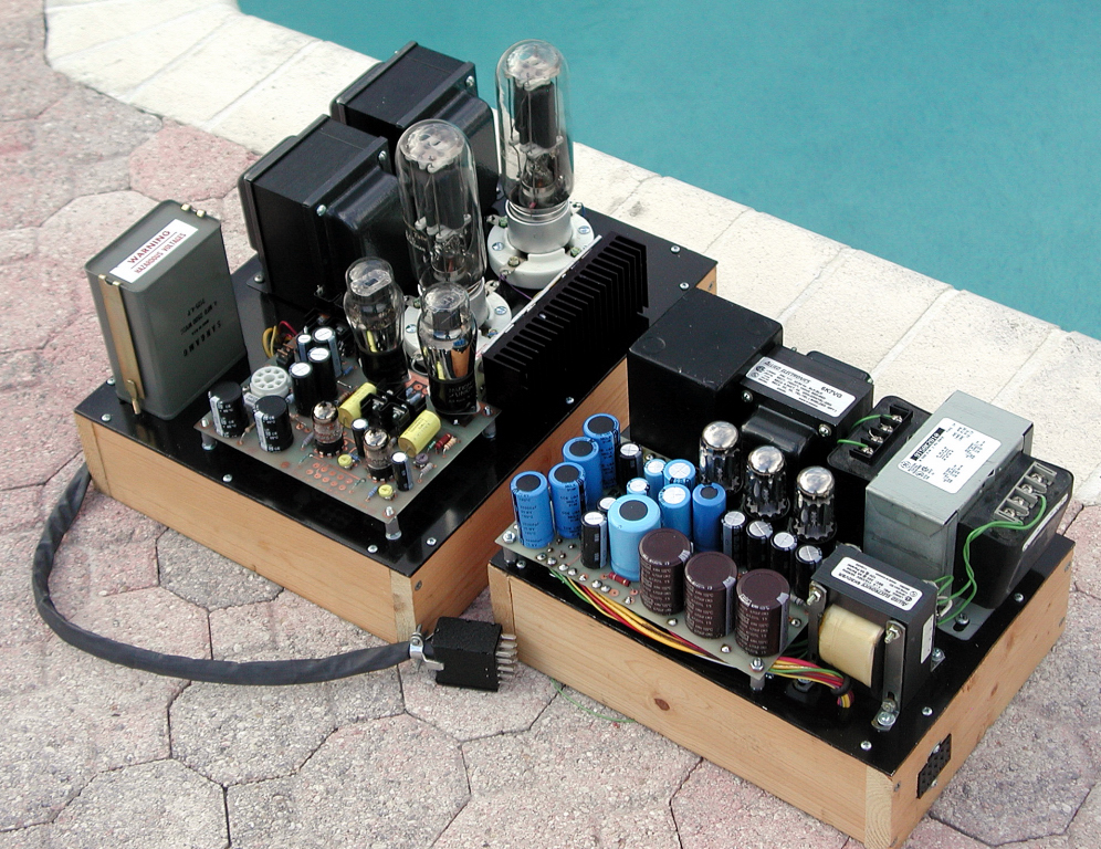

I used a 500VA GE 480 to 120 volt industrial control transformer wired backwards for the HV power supply in my 845SE amp. It feeds a voltage doubler made with 5AR4's. I get 1100 volts with no load, about 1050 with a 120 mA load and just over 1000 volts cranked up to 220 mA. The old Sovtek 5AR4's haven't exploded yet. I am guessing that you would get just about 600 volts with SS diodes in FWB instead of a doubler with tubes.

Note the rated 100C temp rise at full load. How do you want your eggs?

I LOVE the industrial look of that amp.
I built that at least 6 years ago, maybe longer. My woodworking skills have improved a bit since I made it. Note the use of cheap pine boards and sheetrock screws.
Just keep your hands in your pockets!
YES, there is lethal voltage all over this thing. The tube sockets for the 845's have 1050 volts on the plate pin.

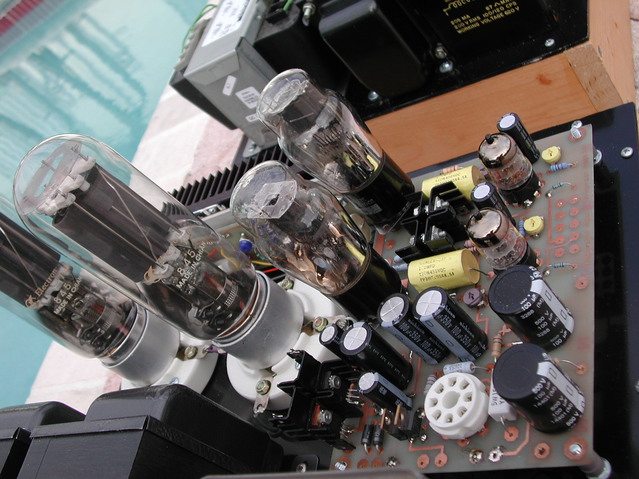

Note that the driver board is a Tubelab SE that was cooked up on the kitchen stove. I made this amp (and the Lexan TSE) before I sent the TSE out for commercial quality PC boards. I replaced the PCB in my Lexan amp a few years ago. I rarely use this amp since it is a serious room heater, so I never upgraded it......someday.
