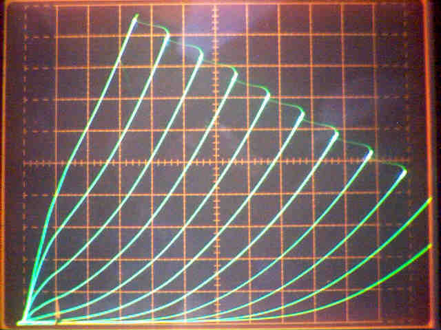

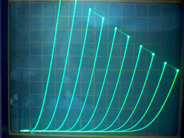

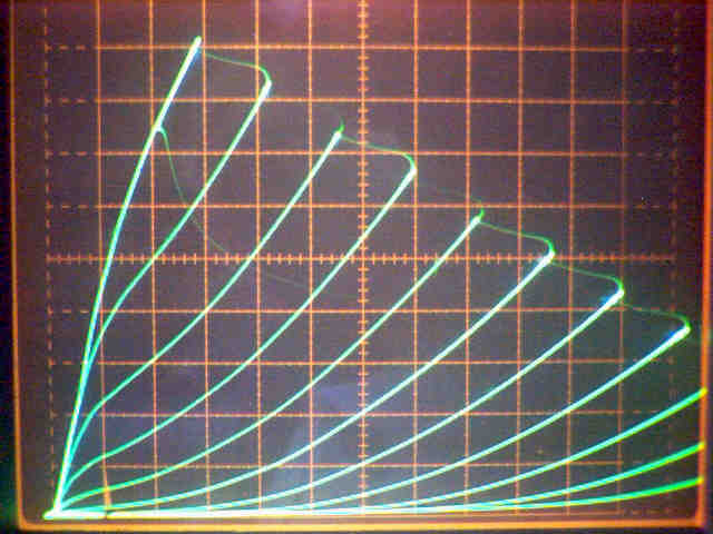

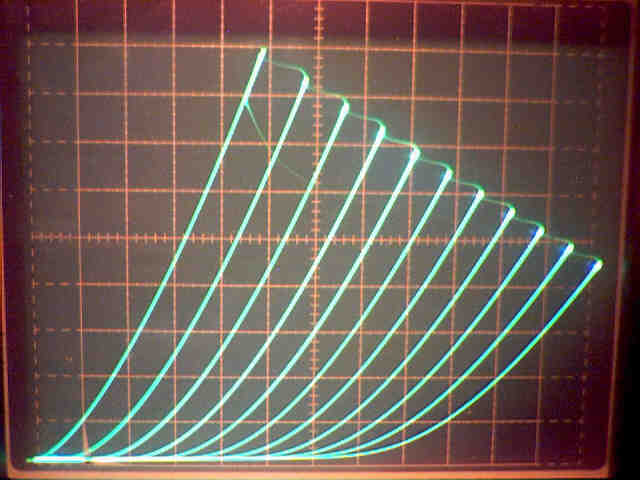

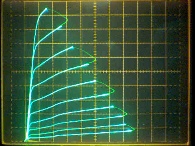

I took some pics of the 6HJ5 in Schade mode on the curve tracer. (Someone requested these in another thread. Likely some interest here too.) There was no cap in the Rfdbk path, so the 0V step and a few after are actually running the grid positive due to the R divider directly from the plate.
A: 6HJ5 Schade 50 mA/div Vertical, 20 V/div Horiz., 123V on g2, 5 V steps, 124K Rfdbk, 20.66K Rinput
B: 6HJ5 Schade 50 mA/div Vert., 20 V/div Horiz., 123V on g2, 5 V steps, 62K Rfdbk, 20.66K Rin
C: 6HJ5 Schade 50 mA/div Vert., 20 V/div Horiz., 123 V on g2, 5 V steps, 186K Rfdbk, 20.66K Rin
D: 6HJ5 actual triode configured, 50 mA/div Vert., 20 V/div Horiz., 3.8 V steps g1
E: 6HJ5 actual triode configured, 10 mA/div Vert., 20 v/div Horiz., ? steps g1 probably 2.4 V

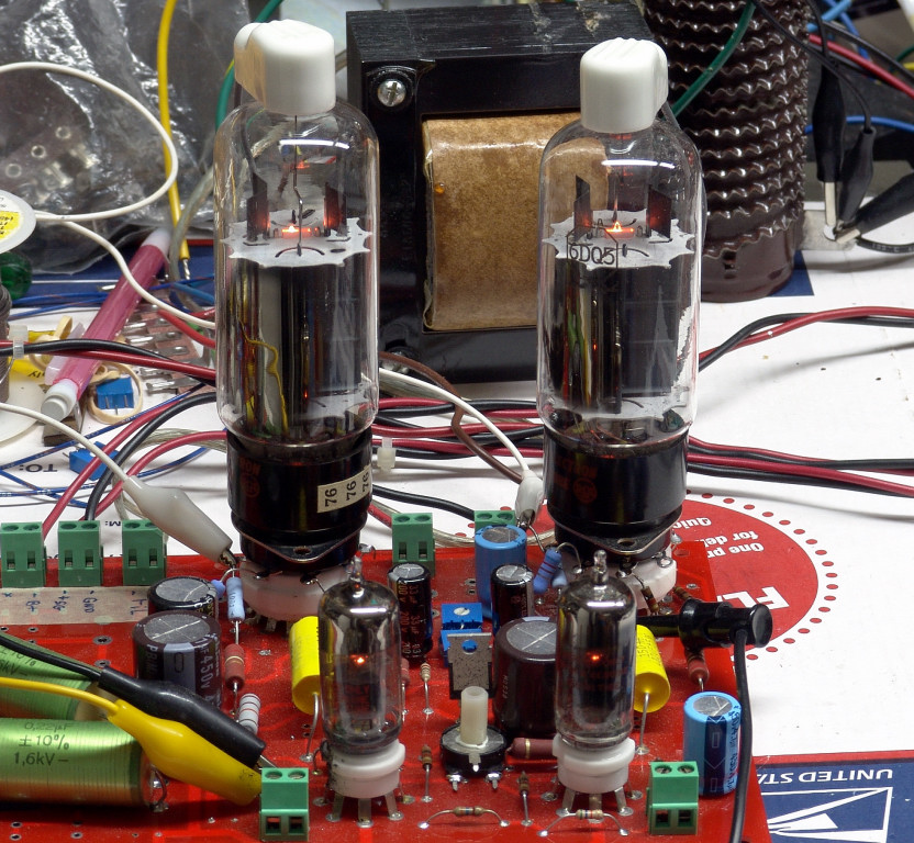

I have received a few requests to test some octal tubes. In fact one forum member even sent me some to test, so I wired in a pair of octal sockets and plugged it a pair of 6DQ5's. Assuming that they aren't much different than most other 24 watt sweep tubes, I was assuming that 550 volts and 3300 ohms would net 100 watts.

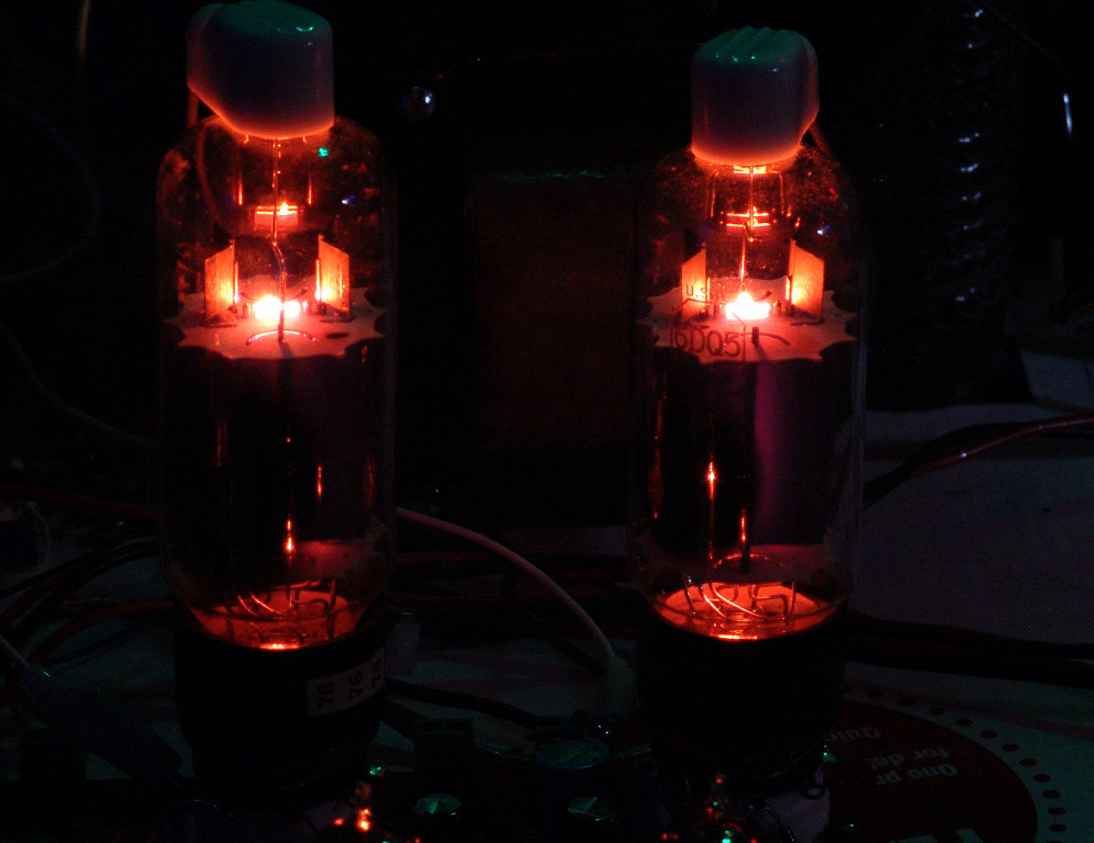

So I wired a pair of 6DQ5's into the red board, set the screen supply at 150, the plate supply at 550, and adjusted the bias current for 30 mA. I applied enough signal to get 1 watt and tweaked the bias current and the balance for minimum distortion. 0.37% distortion comes at 33 mA and more or less current raises the distortion although it remains under 0.5% from 27 to 50 mA.
I then applied more crank. As the input signal went up, so does the output power and the distortion. 50 watts makes 1.89%. 100 watts gives 3.27%. I usually state amplifier power as the power at which the distortion crosses 5% which comes at 107 watts. Crank it till square waves appear reads 129 watts although this is not an accurate number.
The tubes show a faint glow if left at 100 watts for several minutes in a dark room. Since the power goals were met at 550 volts, I see no reason to go higher since more glow would appear, or the bias current would need to be reduced.

Mornin George,
Given the results, would I do any better with a 4.2K transformer? Edcor has my order, but has not shipped yet.
Ray

I currently have G2 wired to pin 4. This works with E130L which really surprised me. I could get 120 watts with just over 500 volts and adjusting to a more sane power level of 80 watts showed really low distortion numbers. I decided to wire in two more octal sockets so I could play some stereo music through it and listen. The wiring was completed last night but I ran out of time before firing it up. Not sure when I can get back to it. I think I'll swap the G2 connection so I can light up some 6CB5's and some 6CD6's.
You would get less power and increasing the voltage to recover the power would raise the tube's dissipation. Reducing the current to stay in safe limits would raise the distortion in the important first watt. I don't have an easy way to get 4.2 K without a trip to the warehouse which isn't likely before I have to leave town.
So, do you feel with 4.2K I could get 75-80 watts with lower distortion than a 3.3K?
That is a tough call. I have found that a triode or triode wired pentode in SE mode almost always shows lower distortion at a higher load impedance. This is usually the case in a class A triode P-P amp too. It however is not always the case in a P-P pentode amp running in AB1 or AB2. To add to the uncertainty a class AB pentode amp usually requires some NFB to keep the output impedance under control.
In my experiments with the red board I have seen cases where the distortion is not monotonic. The distortion should increase with increasing power. I have seen it goup, then dip, then go up some more. This is one of those things about the red board that I don't fully understand yet, but it seems to happen more often at higher load impedances. Of course the results will be different with a different driver circuit.
I think that 3.3% at 100 watts is not a problem. Unless you want to thump the walls with disco or rap music your amp will spend very little time in the 20 to 100 watt power range. You want to optimize the distortion in the 1 watt range, and minimize it from 1 to about 20 watts, and don't sweat the higher power stuff. Unless you have big speakers the distortion produced by the speaker as the cone attempts to leave this galaxy will overshadow the amp.

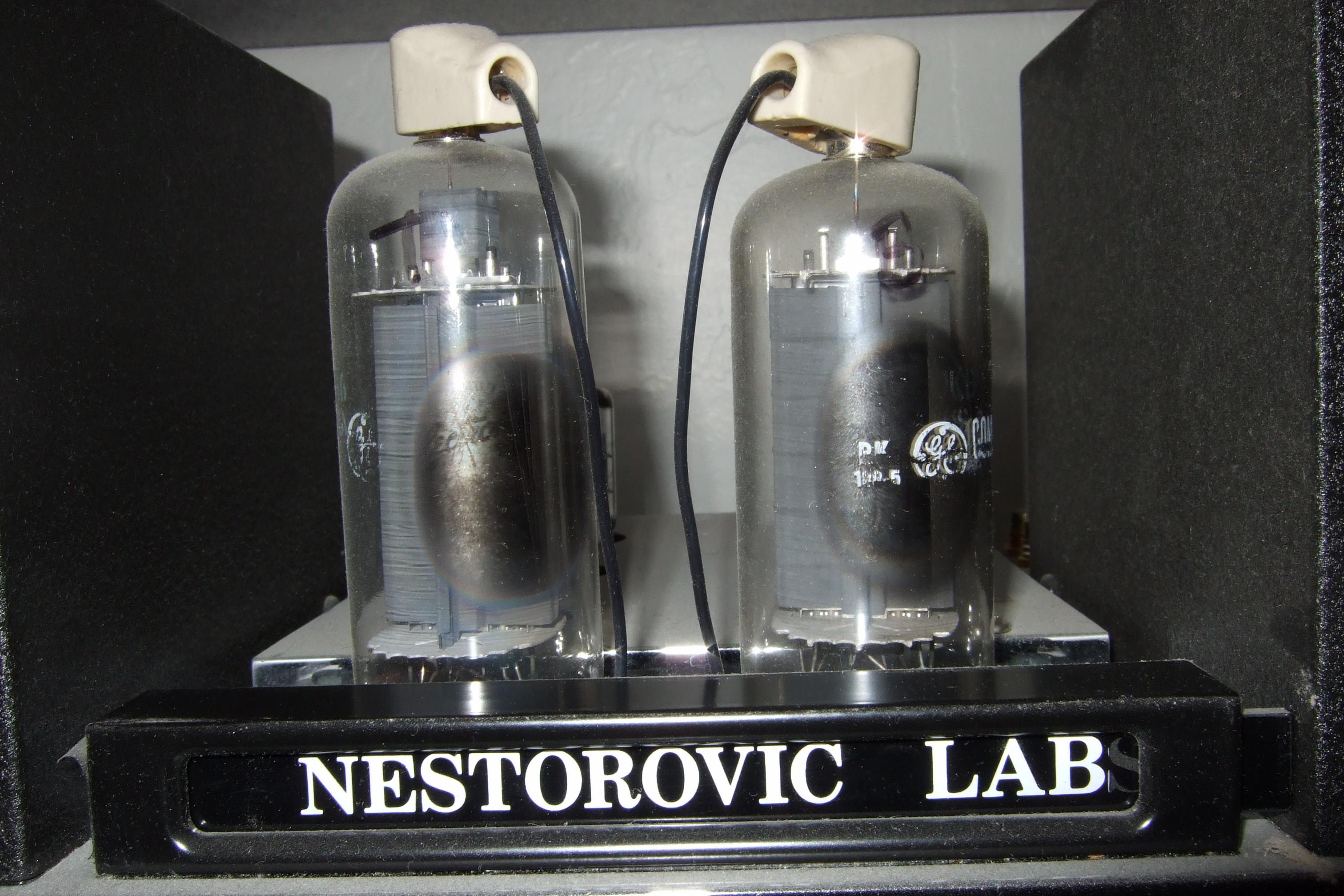

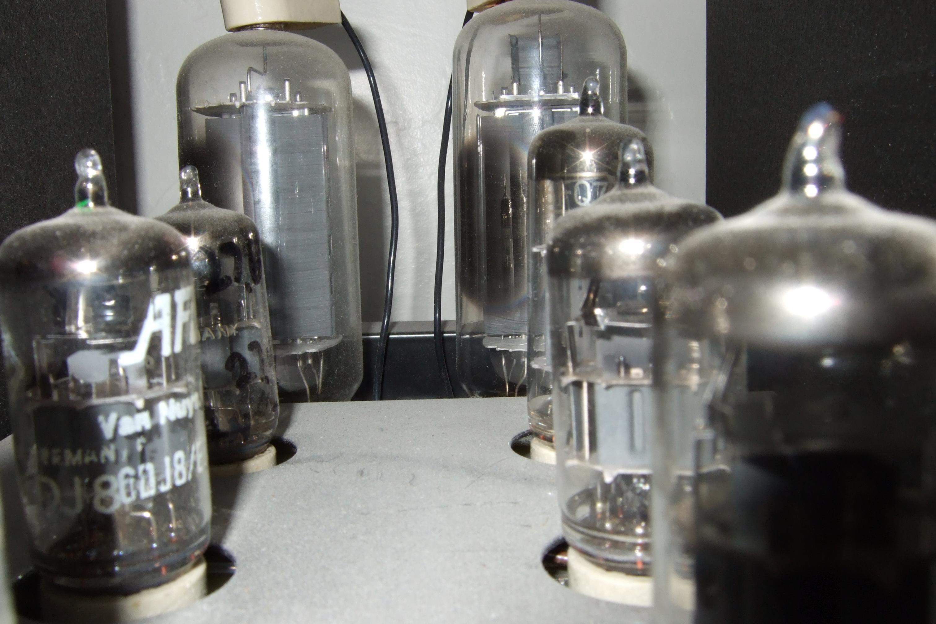

Thought you might like to see a balanced dual 6KD6 mono amp from Mila Nestorovic. 5 E88CCs with a cathode follower 6CG7/6FQ7 driver. I never got a schematic for it.
Other than the sound, I liked the fact that I could use either matched pairs of GE or pre ECG-Sylvania 6KD6s. No need to start trying ones made in the UK or EU etc.
I never tried 6KD6s from Japan, Mila advised to stay away from ones made in Japan and stick with Slyvania 6KD6s. I think he had a bias for Sylvania 6FQ7 and 6KD6 because he used to work for them?
