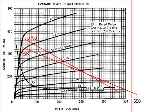

I don't have any circuit at present for what I want to do, which would be 100-120W output using 550-600V B+. There are three possibilities - using the 35LR6 in straight pentode mode like here, conventional screen drive, or G1 +G2 combination drive. I've yet to make up my mind as to which approach, and I probably won't get really serious until I actually go and spend the money on the Edcor output transformers.

You might want to re-examine your load line. I just ordered a pair of 100W Edcors for 550-600V B+ and I came up with 5K Zpri. With 3K5 you should only need about 480V B+ to get 100W Po. If you plan to go with only local feedback, a higher Zpri will improve your damping factor. PS - I was quoted 3-4 weeks delivery on 6/24

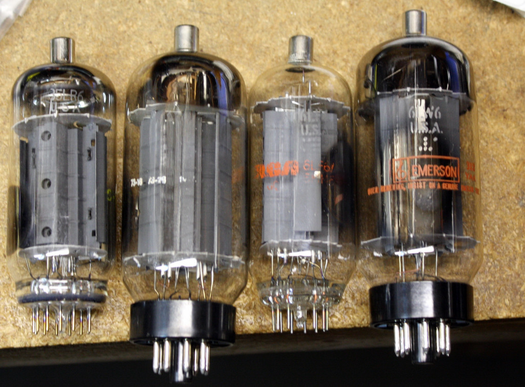

The photo shows 4 tubes. The 35LR6 is on the left. Next is a 6LW6, then a 6LF6 and another 6LW6. You know which tubes are my favorites. In reality the central core of all of these tubes are the same. I have seen versions of all 4 with different configurations of heat radiating fins welded to the plates, and I have seen versions of all 4 without the fins. The 35LR6 and the 6LF6 shown here do not have the fins. I have seen 6LW6's in small bottles (same size as a 6LF6) and in fat bottles like these. The versions without heat radiating fins start to glow at about 50 to 60 watts of dissipation. The fat bottled 6LW6 with the big fins start to glow at 90 to 100 watts. The octal base is a plus too.

I have a long list of tubes that I want to "test". 6LW6, 6CD6, 6CB5, 6DQ5, 6146.....6HV5...307A....45. I skipped a few, but note the wide range of tubes. The red board has been a great learning tool, but I think I have explored about everything I can within its limitations. Maybe I will just do as it was intended and make an amp out of it. I liked the 6HJ5's for about 100WPC and I do have a big pair of 6000 ohm OPT's that have been around here for several years. Add one big Antek, stir well.....

I've already been over my load line. I'm going for the 3.5k transformer so I can get a clean 100W and a little over, going with the assumption that I consider the output tubes to be bottomed out at ~50V Vp. This seems to be a pretty much universal number for specifying sweep tubes, with VG1 =0 and around 100-120V on G2. Under that assumption, 5k gets me a little under 100W, without accounting for any voltage drop in the transformer windings. I'm playing things conservative to make sure I get what I want. If this results in more power in the actual product, that's just a little more peak reserve I can keep tucked in my back pocket.

Sorry, I had just come to a different conclusion but I think my goals are a little different and I'm not looking for a lot of headroom above 100W. I also want to use a machine tool transformer for the B+ without having to lose a lot of voltage...

Hey I just read the other thread LOL. You were thinking 5k at that time...

I was thinking 5k at the time but had already realized that given the 50V proviso I've mentioned, I was only going to get 98W or so, not counting various and sundry voltage drops. The next step down from 5k in Edcor-land is 3.5k. No LOL, just compromise, as in just about any engineering enterprise. I'd much rather over-design a bit than under-design.
Sorry, I didn't notice the 4k choice when I was looking at the list at the Edcor site, and it looks like I mis-remembered the 3.5k value. That gives me more choices when I actually buy the transformers - more power, or less distortion. I've pretty much nixed the 5ks for right now, as I don't want to go much above 550V in my SMPS design because of the way I'm partitioning my B+ windings. 4k is kinda convenient. At any rate, I'm working on a JFET crossover, a new JFET RIAA amp, a 6JB5/6JC5 P-P amp with SMPS, a JFET/Mosfet amp with diamond output stage, and a 6LR8 /JFET hybrid P-P (another SMPS, too), so it'll be a while before I get to the 100W design. Maybe I'll change my mind again by the time I get to start the project. I figure things get set in stone once I order the transformers, not until then.
