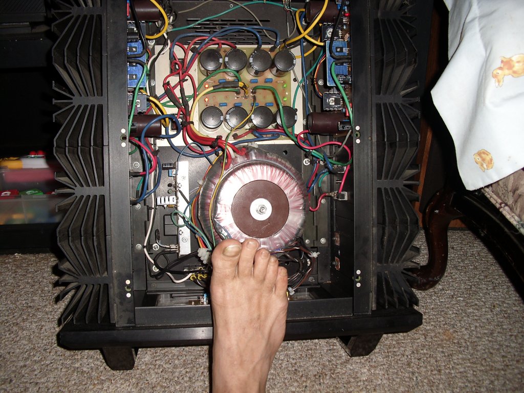

Last time I posted this thread I was using a stupid webcam (640 X 480) 😱
Now I have a 12M pixel Polaroid. 😎
After 1 year and 1000's of hours the supersym's ,(below) are going to the dogs (MONGREL's).
A very good sounding amp , BUT I want commercial quality and separate modular Voltage and current stages.
Never clipped it once , I'm sure my speakers thank me. 🙂

nice toes! are they yours? 🙂
Foot fetish ,aye...
feet are healthy , carrying oversized amps and digging barefoot in gardens(man, It is hot
Had to power up after yearly cleaning (spiders were inside).
OS

nice amp...very clean...not to mention those nails... nice heatsinks too...they must be real heavy...drop them sinks to your toe and they'll flatten...🙂🙂🙂🙂🙂
