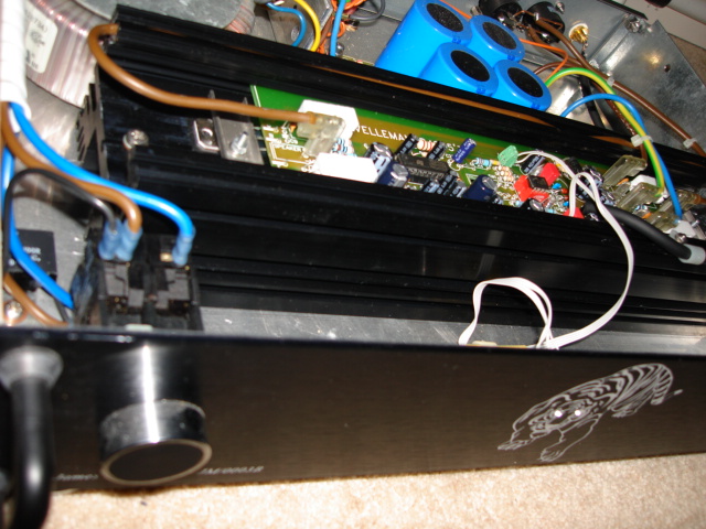

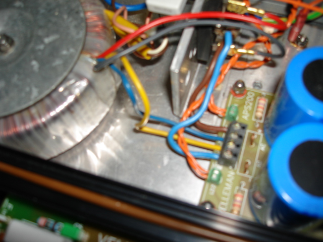

Velleman amp

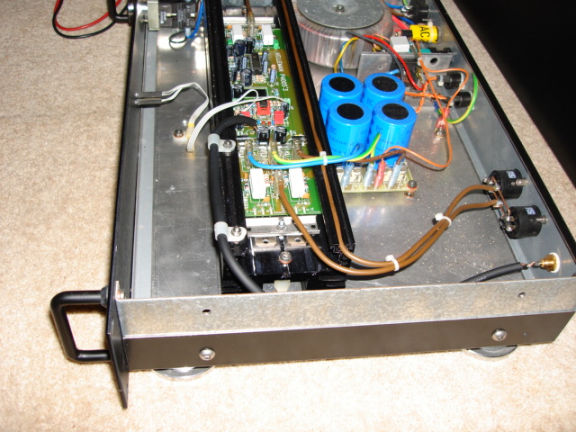

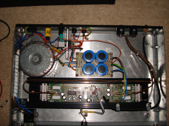

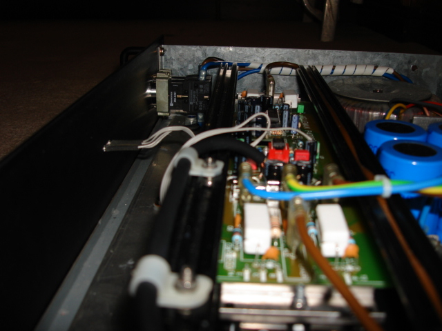

Hi All
please see my velleman amp that I have just made. The front is laser engraved and the tigers eyes light up when the power is on. Sounds good to my ears. what do you think?

k4005
Hello
not at all, sounds very good with no hum. The only issue is that the amplifier can shut down when pushed to hard. I can adjust the current monitor resistors in the feedback system, to solve this. but otherwise I was very surprised with the quality of the sound.

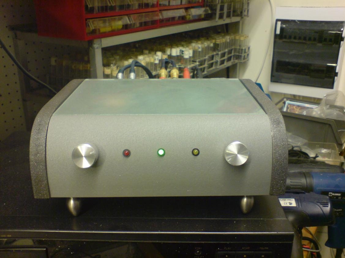

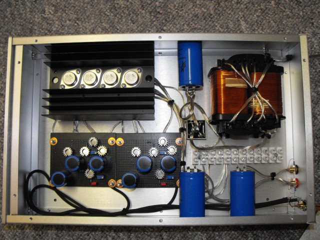

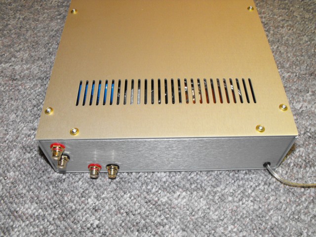

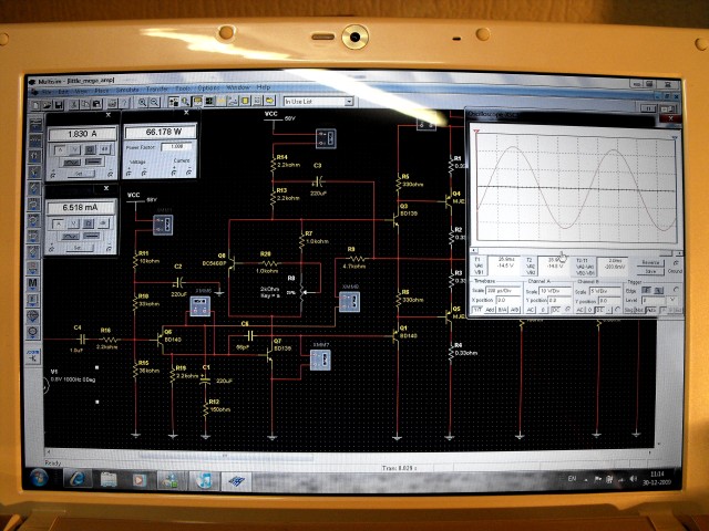

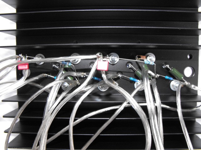

My Retro amp project back to the 70's

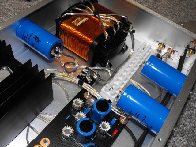

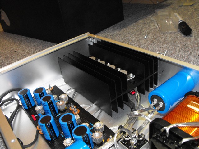

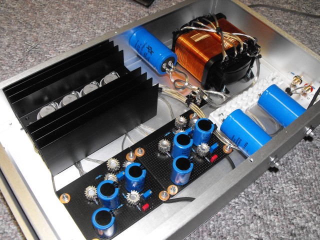

Hello,
I recently finnished my retro style amp.
It is an current feedback amp on a single voltage rail of ~ 52v.
All driver and pre transistors are BC141-16 BC161-16.
Power transistors are ST MJ2955
The heatsink is from an old Philips X-ray power supply from 1966, originaly it had 4 germanium power devices on it.

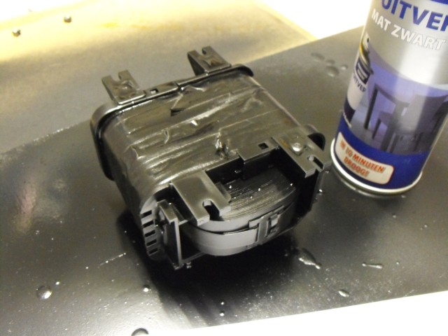

The transformer is from an old philips reciever and i painted it black and re- applied the top wiring.
It puts out ~ 52v at 2.5 amps and this is regulated and then buffered by a 10,000 Uf capacitor.
The same capacitors are also used as output decoupling.
This amp is obviously not build for perfect sound reproduction but mere for the sake of old times though it sound very nice for what it is and put out alot of power.
I will post some pics of the build feel free to give your opinion

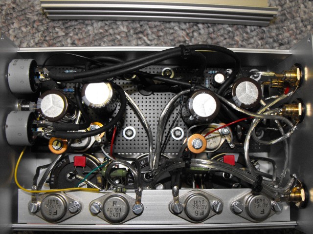

Another one of my Retro projects
This is a 2x5 watt Amp based on germanium devices.
I have build this little amp 1 year before the amp in the post above thats why it resembles it in some kind (the copper revets for example).
It has a kind of warm round sound to it, though 5 watts is enough for easy listening, it lacks power when it comes to having a party or whatever.
So thats why i have build the amp in the post above.
That one delivers 30 watts per channel.
It only uses a BC154P gold pin low noise silicium transistor as preamplifier.
The rest is based on AD161 and AD141
Please comment on this little computer amplifier
