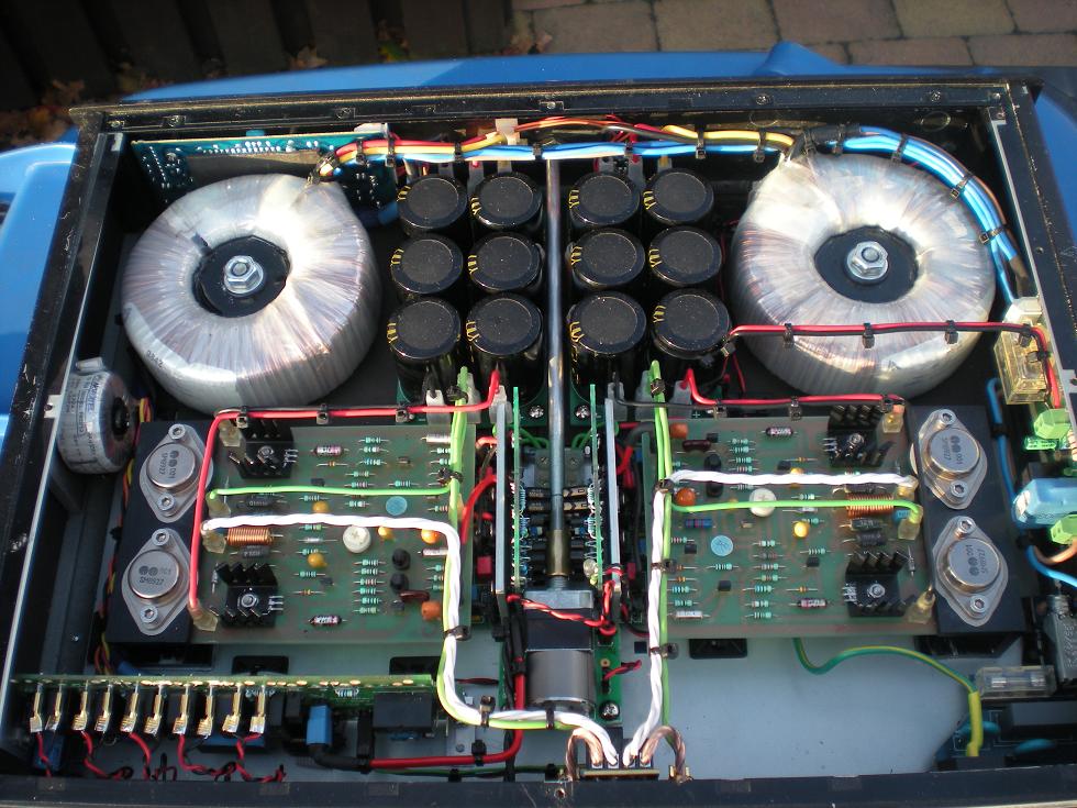

My lightly modified Cambridge Audio Azur 340A SE 😀 😀 😀
Now dual mono Naim poweramps with dual Avondale audio minicap6 PSU's. 2 x 225VA trafos. Dual mono SKA audio SKpre class-A preamps running on TeddyReg's. Relay input switching from Dantimax.dk, Alps motorpot. Everything works off the original Cambridge audio front panel pcb so I have the full function of the front panel buttons and remote. No tone or balance any more though....
Its still not completely finished but Ive had it running. Sounds v nice and should be even better with a few more small tweaks. Thinking of adding a pair of separate transformers and filter caps for the preamp section. They currently piggyback off the main amp supplies.
EDIT: Apart from the case and front panel control PCB I have re-used the AC main's inlet and switch (left rear corner of photo), and re-cycled the original output relay. This connects to the front panel PCB and gives me a muted 3 second delay on switch on to allow the amps to settle. So no pops or thumps when I switch on. And I have full remote function with the original remote.
I'll be filling in the unused holes for the balance/tone-control's and headphone/ipod sockets. Then I'll be respraying in automotive high gloss metallic paint. Probably in black. I hope to have the front panel professionally engraved at some point to identify the input buttons and power switch.

Hi Mike,
very well laid out, obviously very well planned.
It looks factory assembled. A credit to the DIY enthusiast.

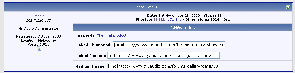

Yes, you can use the IMG feature from the gallery to put images into posts. In fact when you're viewing an image in the gallery there are BBCode links already preformatted for you so you can just click, copy, and paste (see attachment). Pretty cool!

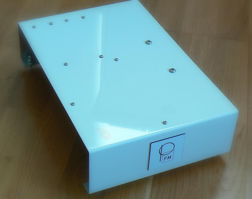

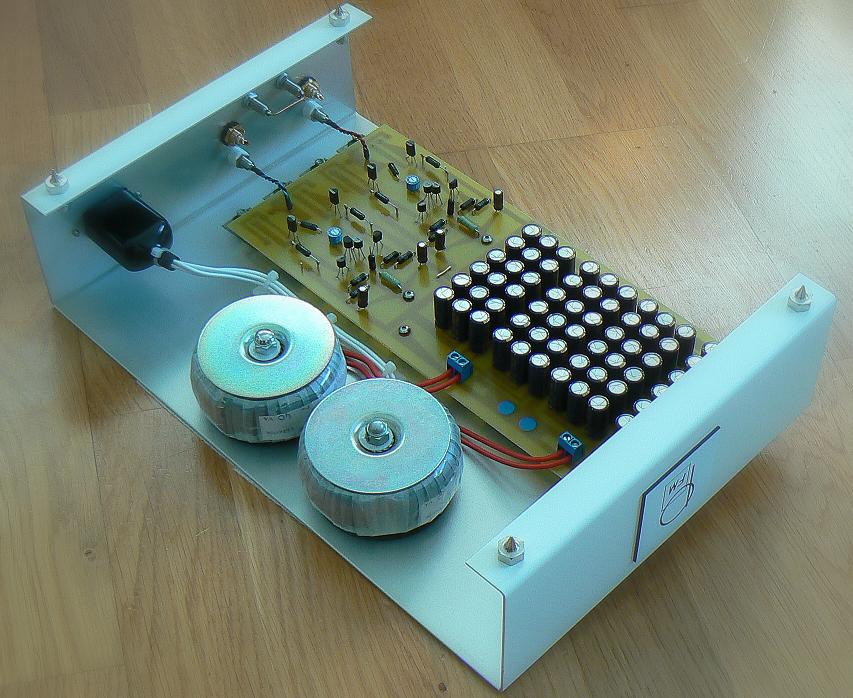

MRR White serie
Hi There, ( hi destroyer, hi dark horse )
my very last realization !
Gorgeous sound... Amazing dynamic...
Eighty capacitors ( ultra, ultra low ESR )
Class A ( 2 x 7 watts ) with no Heatsink
Yeahhhhhhhhhhhh ...
Have fun
Yeahhhhhhhhhhhh ...
Have fun
Very nice Rockmandrake..... lovely amplifier
Beautifull circuit, wonderfull colour, nice shape.
Great!
Carlos
Great!
Carlos

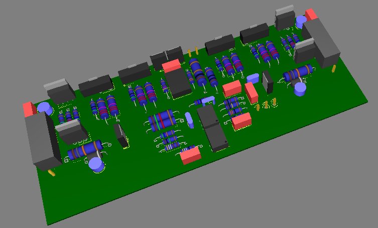

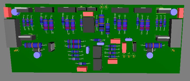

oke, on topic now, here is a design of the topamp, what i made for someone here.

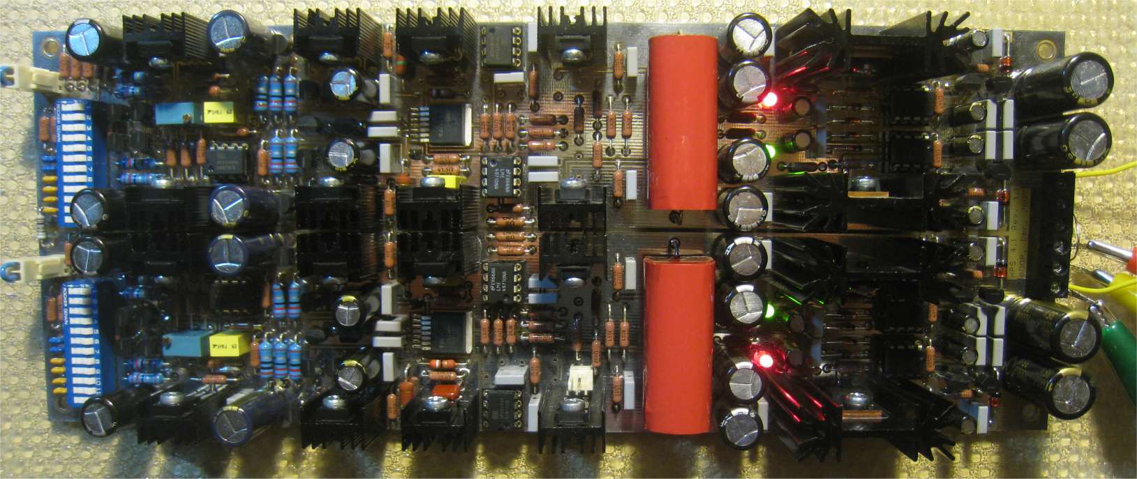

See the pictures.

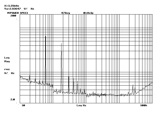

This is a full bipolar version that uses Jung regulators and local bipolar buffers. It is also high impedance (default 47kohm), while the input current can be trimmed to under 50nA. No caps in the signal path.
Full measurements to follow, but here's the first noise measurement. RIAA correction is not installed, gain is a little over 80dB (will be 60dB @ 1KHz after RIAA correction). Bottom line - 0.28nV/rtHz.
Distortions are much better than in the HPS 3.1 JFET, I suppose because the large (8 x JFET) nonlinear Ciss is now missing. Overall, about 70ppm at all frequencies and output levels, up to +/-20V. HPS 4.1 has the same headroom of 32dB.
