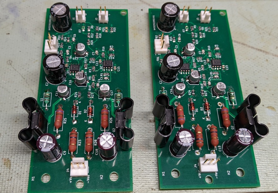

I designed and built my own, based on Doug Self's ideas. They are powered off each channel's rails by a simple zener referenced linear series regulator to make +/-17V for OPA1656s.@Zoji6645

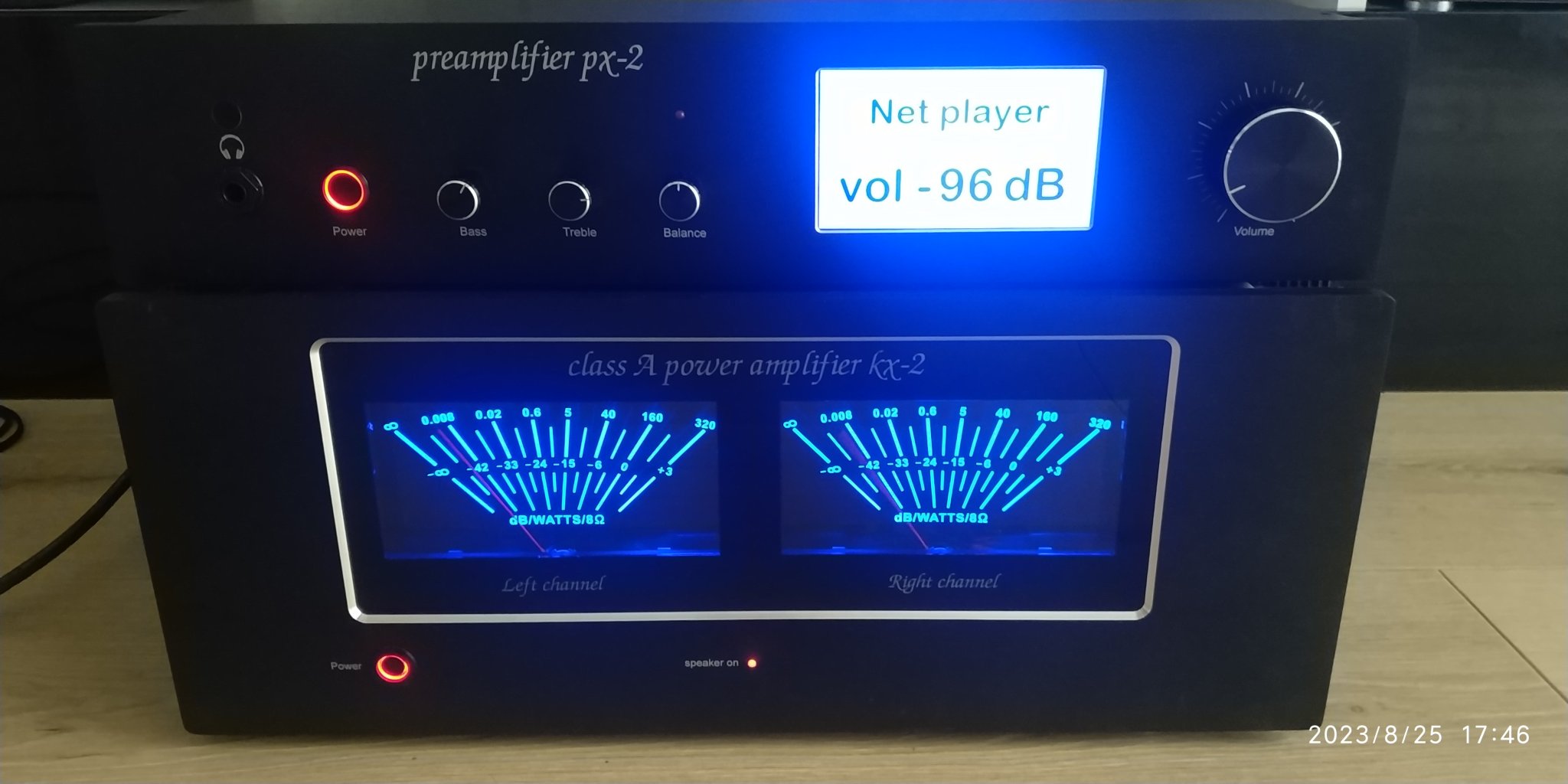

The VU meters' back light is dim upon power-up then when the speaker relays close, they brighten up.

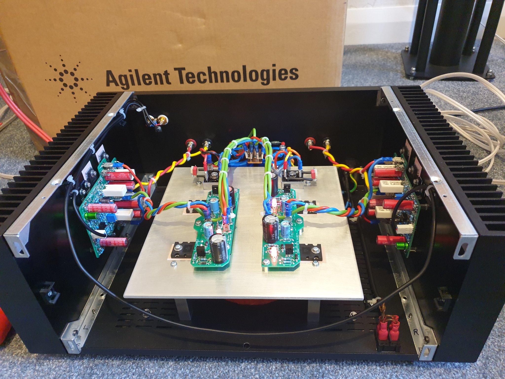

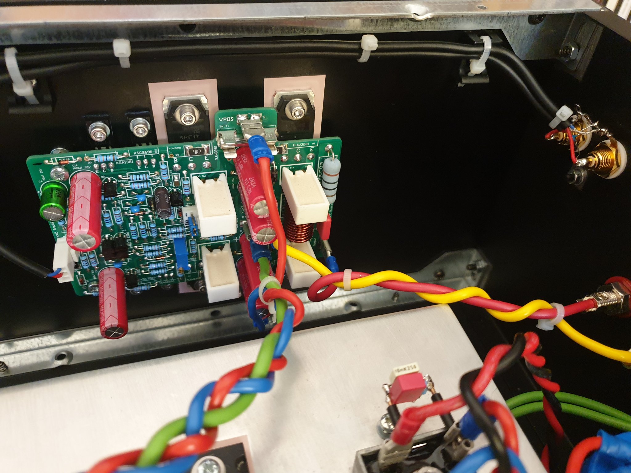

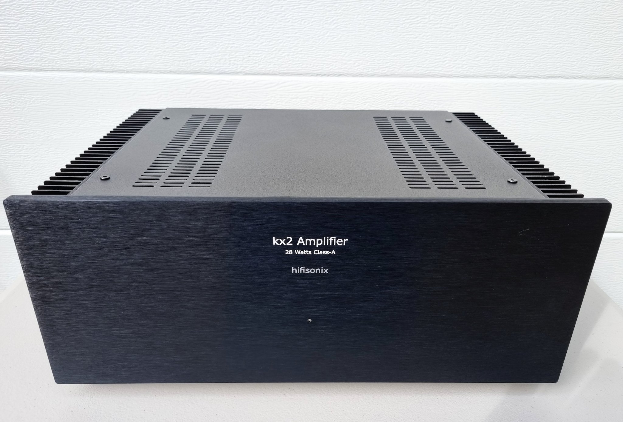

I used a Modushop 4U 300mm deep case with the old style heatsinks for my kx2 and followed Bonsai's excellent build guide. In Class-A the heatsinks get pretty warm (50ºC+) with 30V rails and about 1 amp bias 🙂. I highly recommend this amp, even if you can't run it in Class-A 👍👍👍!

Fantastic looking build David. I'll be putting a few of your pics up on the hifisonix kx2 web page in the next week or so. 2 1/2 yr old grandson visiting so my hands are full at the minute!

This is my kx 2 power Amp and Douglas self preamp
Beautiful build! Where did you source those VU meters?This is my kx 2 power Amp and Douglas self preamp
Beautiful meters! Lovely looking amp! 👍👍👍👍This is my kx 2 power Amp and Douglas self preamp
