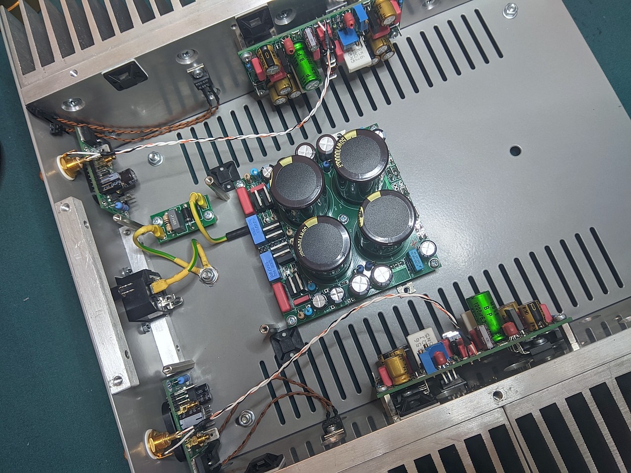

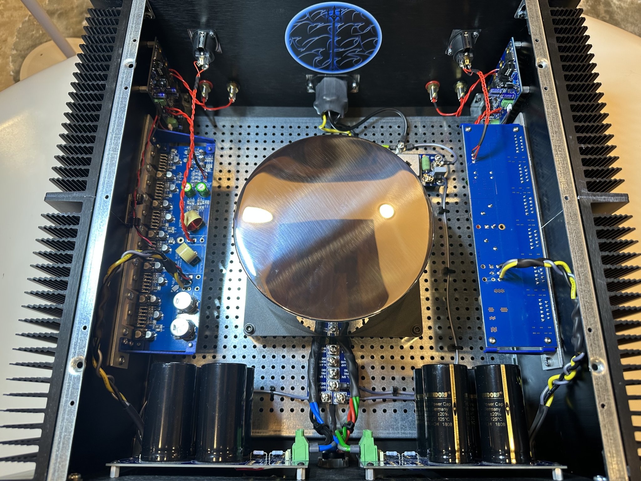

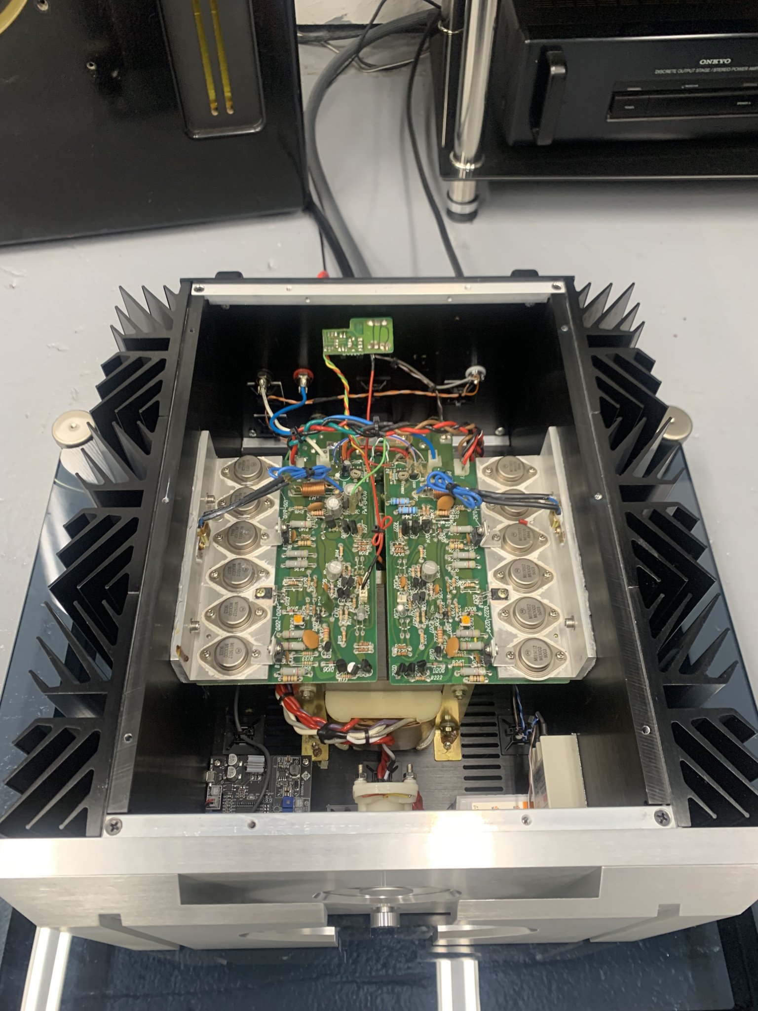

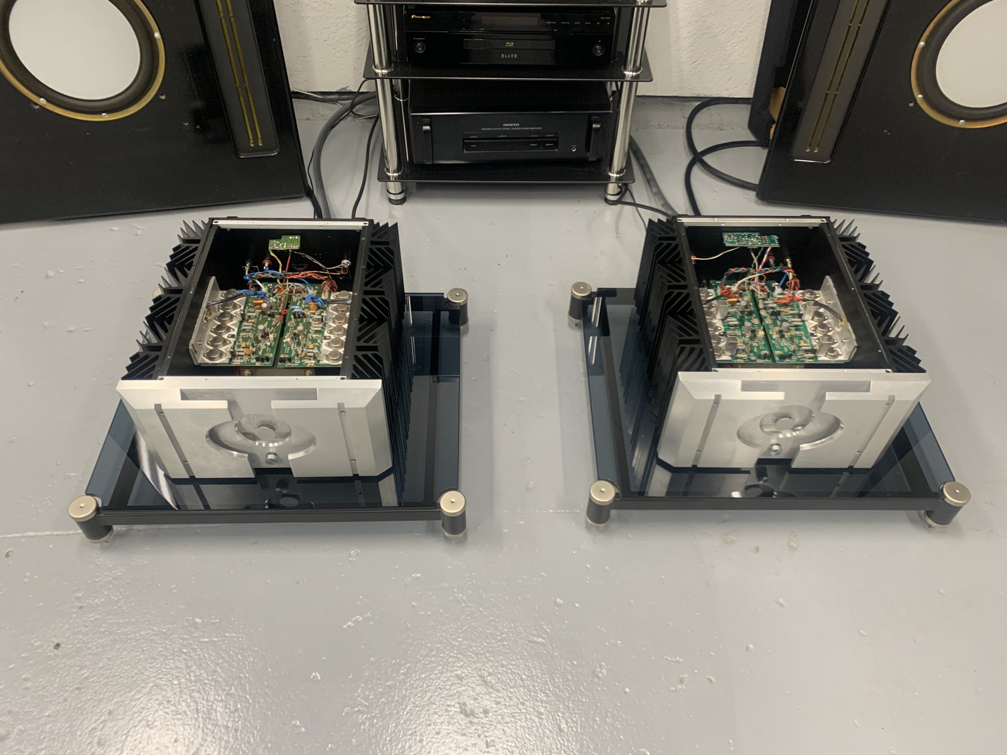

Absolutely gorgeous job. I like how the entire amplifier is enclosed. This is a great consideration especially with Class AB designs where idle current/bias is low. Very nice and clean. And dual mono to boot!
It looks like a Modushop 4U/300 enclosure but steel based, correct?

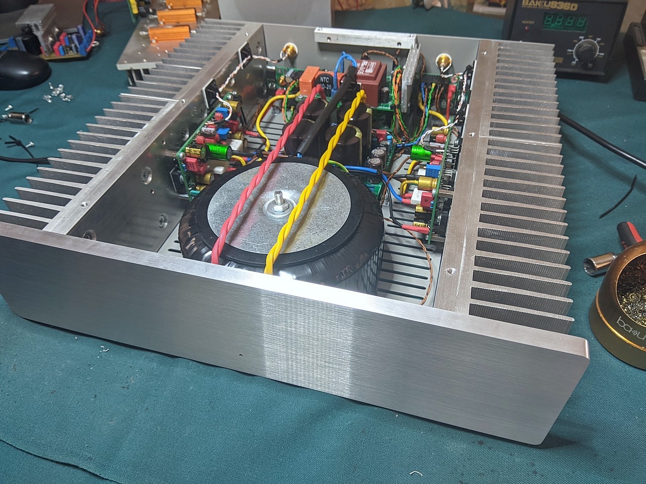

I switched to metal screws for the TO3Ps which was a good idea anyway, but it did not fix the problem. In the end I switched to mica + grease on one of the boards and did a (very scientific) test where I ran the amp hard and held my thumb on a TO3P of each board (mica + grease versus silpad) and the difference was astonishing. The mica + grease combo does a much, much better job of conducting the heat into the big sinks. What I can say is do not bother with TO3P silpads from Jaycar (this will only be relevant to AU/NZ). The issue is that Jaycar don't sell TO3P mica pads so I had to harvest mine from the parts bin.Maybe it's not a good idea to use nylon screws? Won't they stretch and deform slightly with temperature? The pressure on the transistor needs to be consistent otherwise you'll get small pockets under the transistor that aren't in contact with the pads. Thermal paste should improve things.
It was my first time using mica + grease and it is very messy and fiddly but the end result was worth the effort.
Patrick,
A beautiful job! Very nice wiring - did you resolve the hum?
Hugh

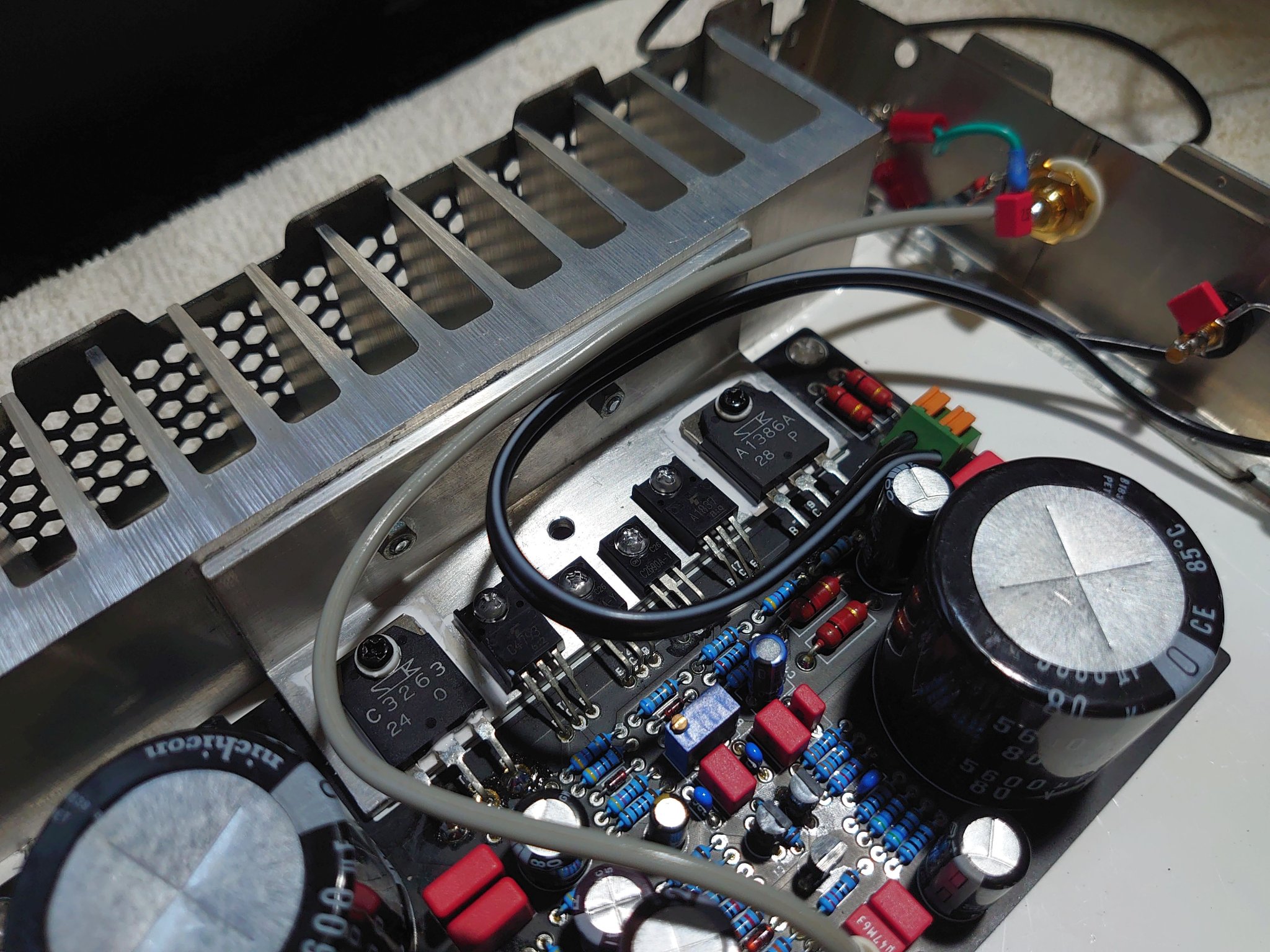

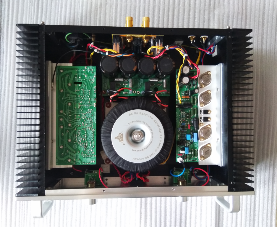

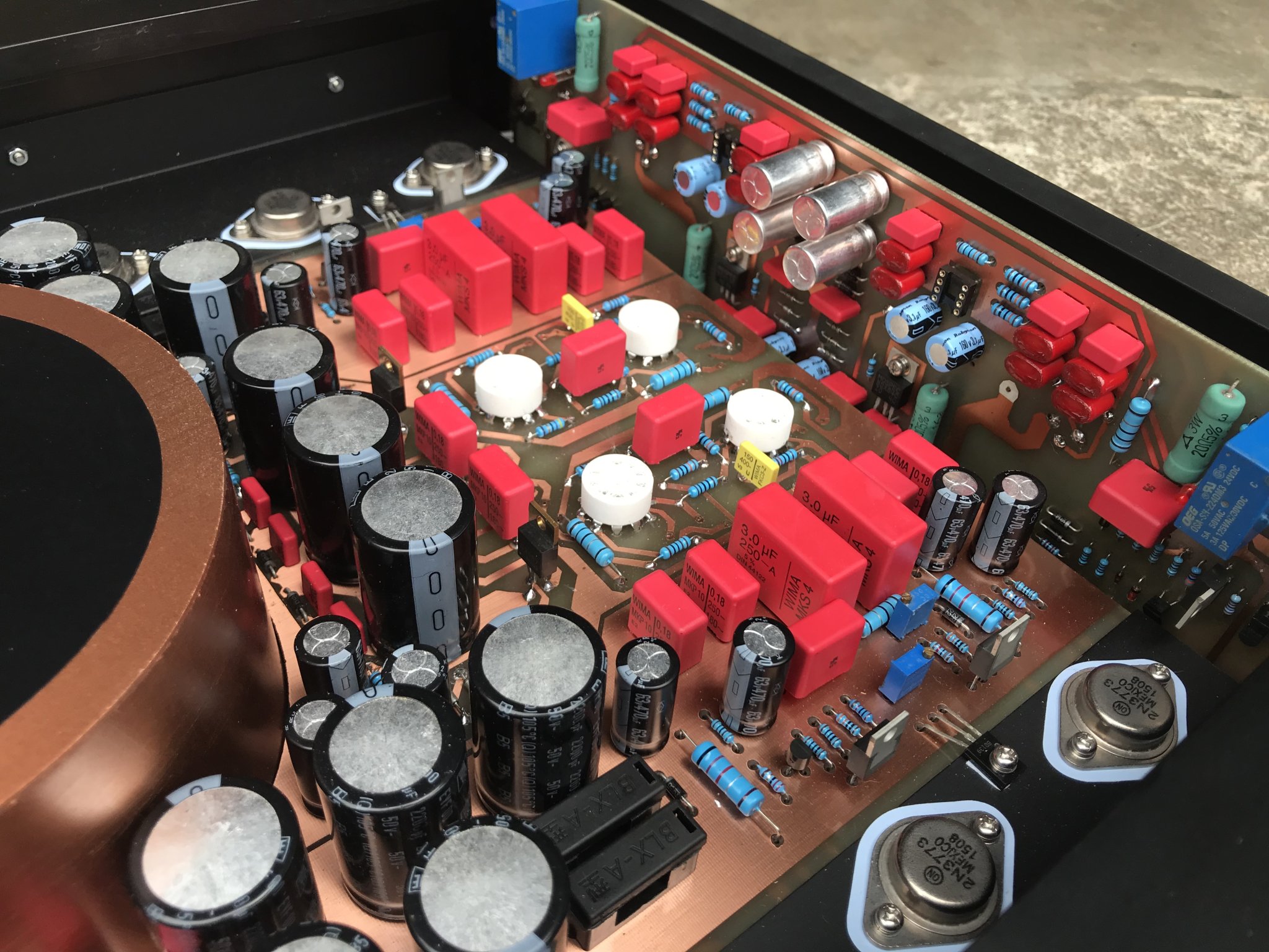

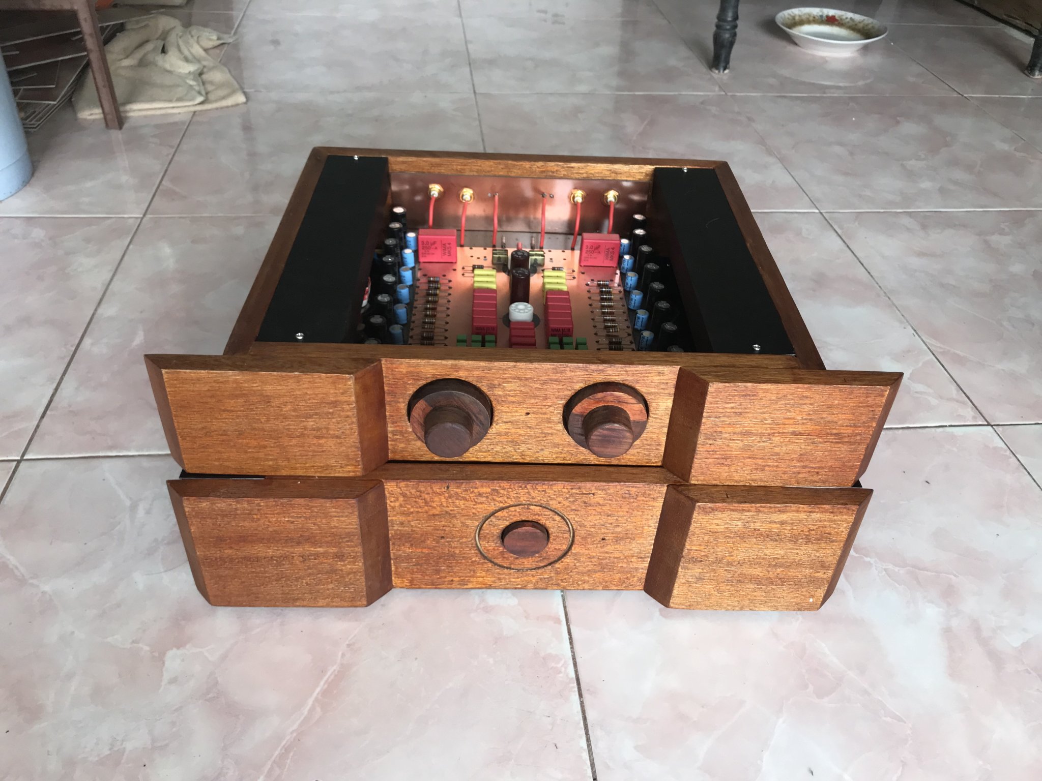

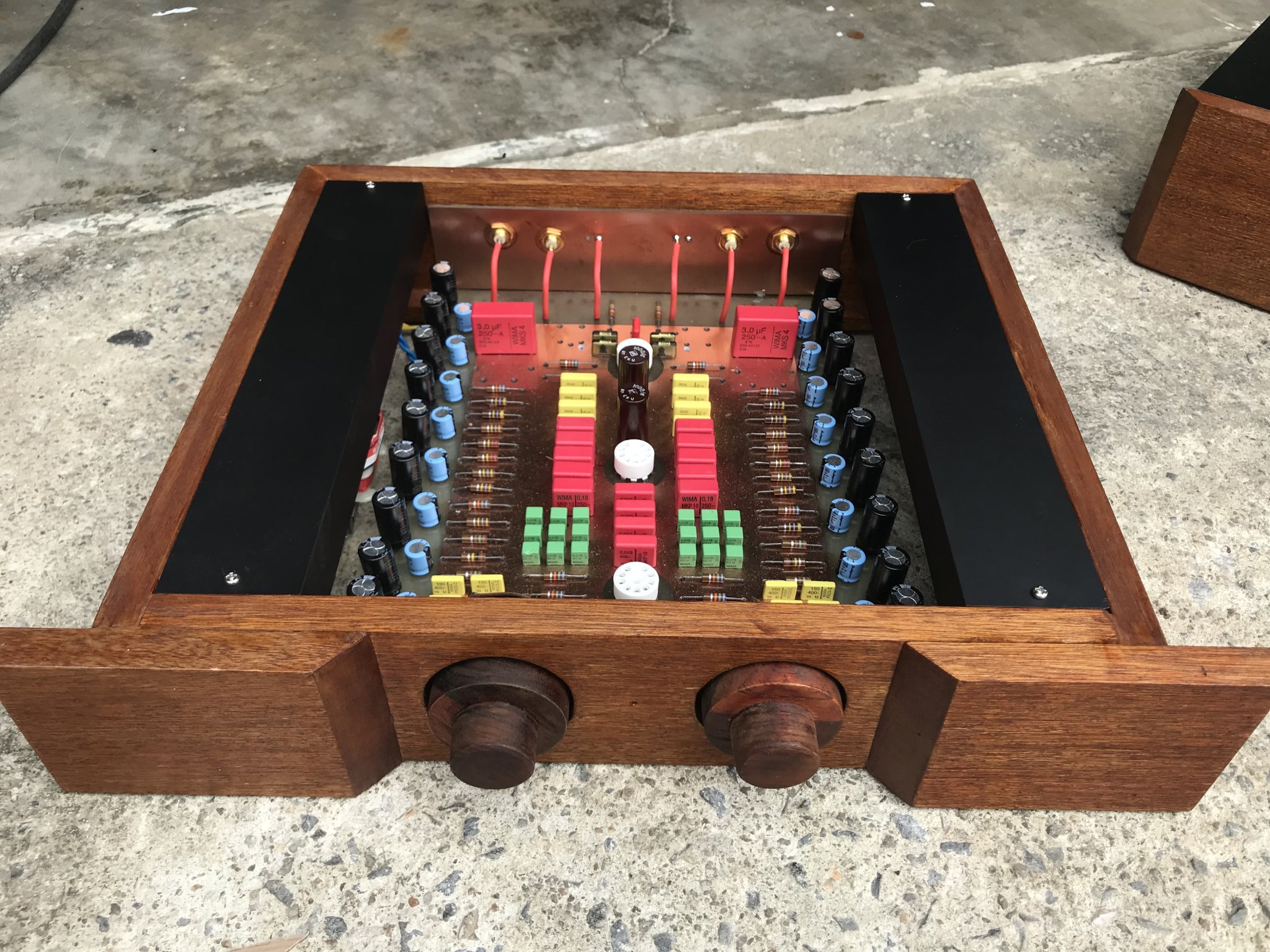

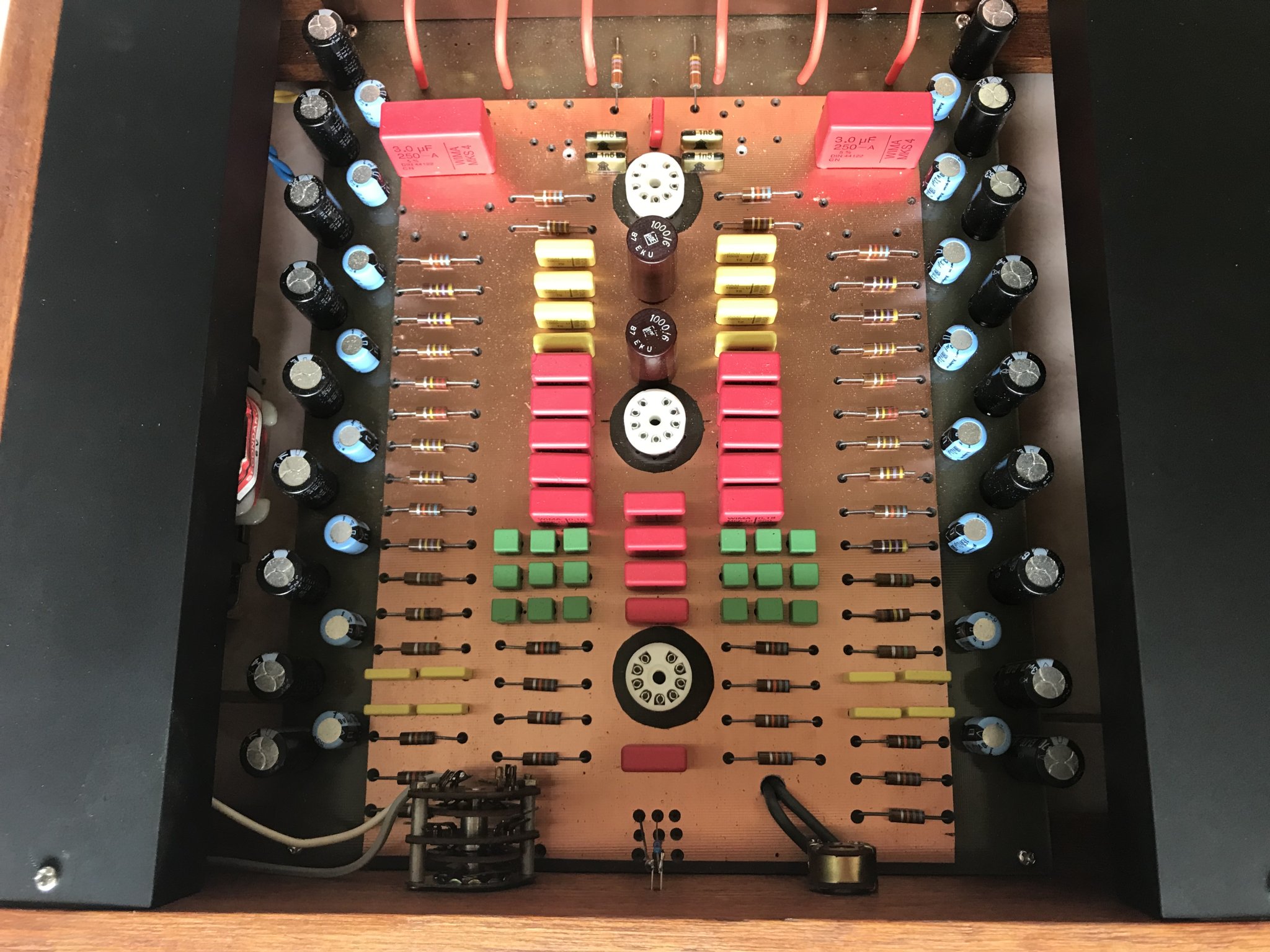

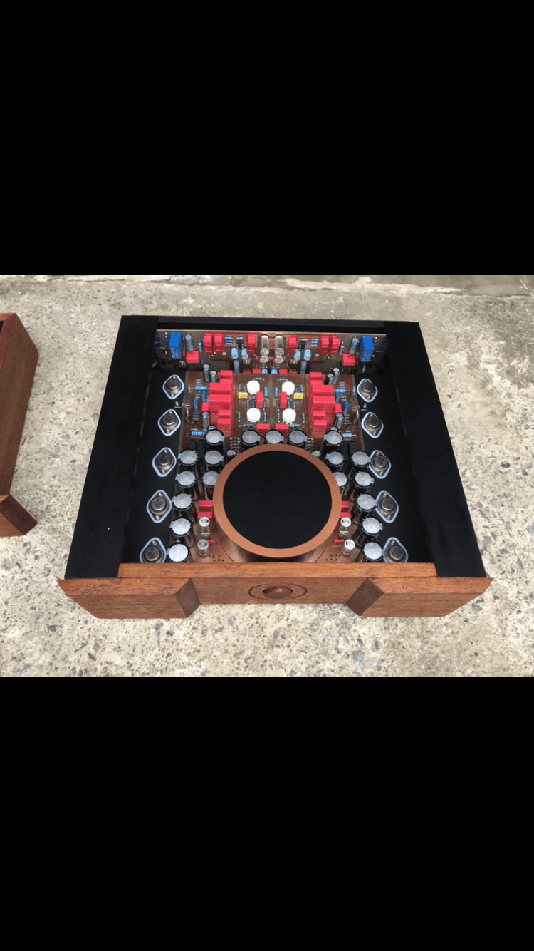

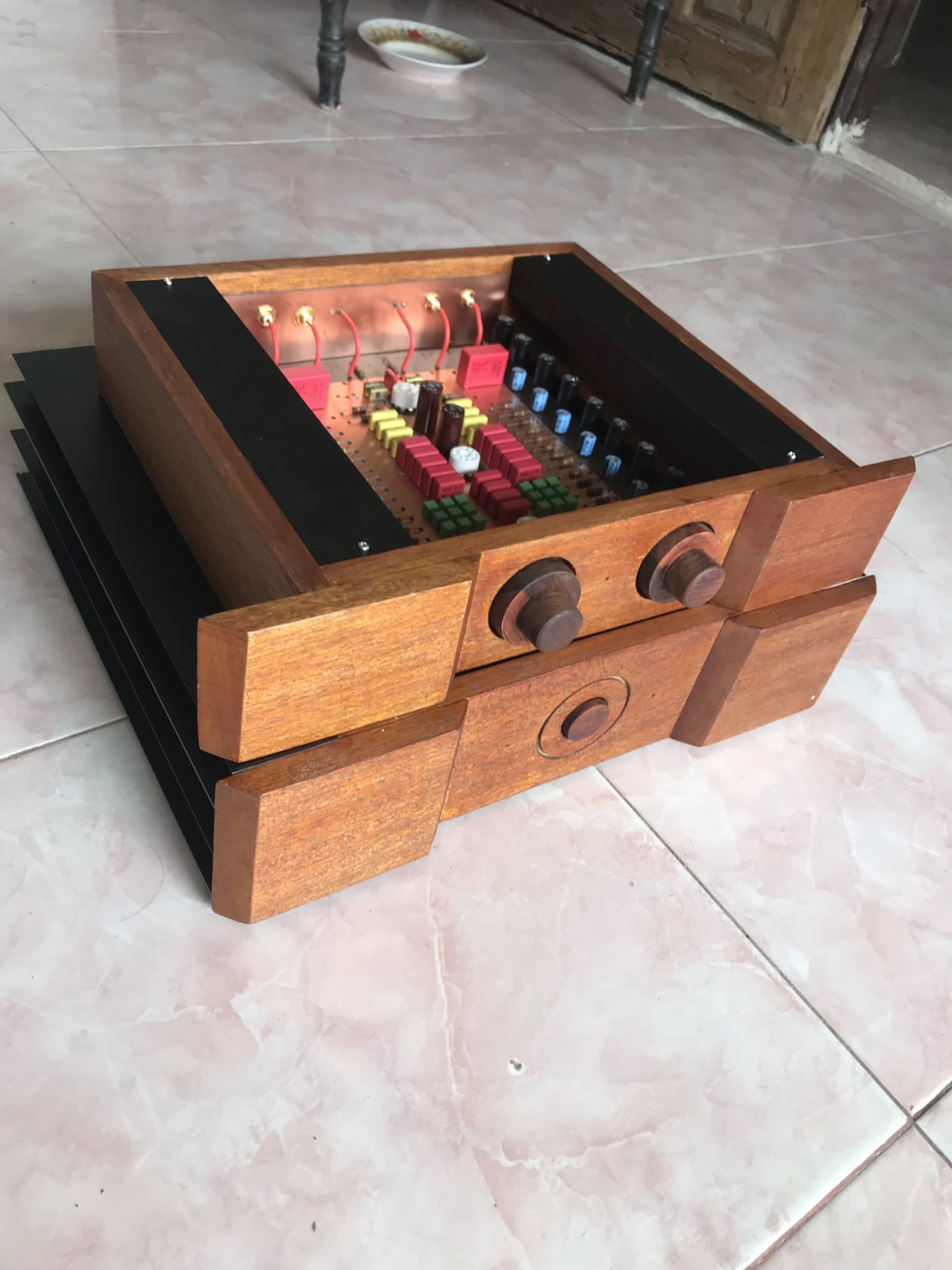

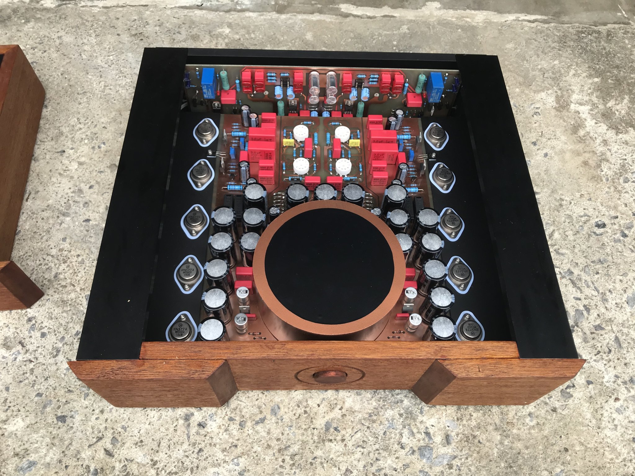

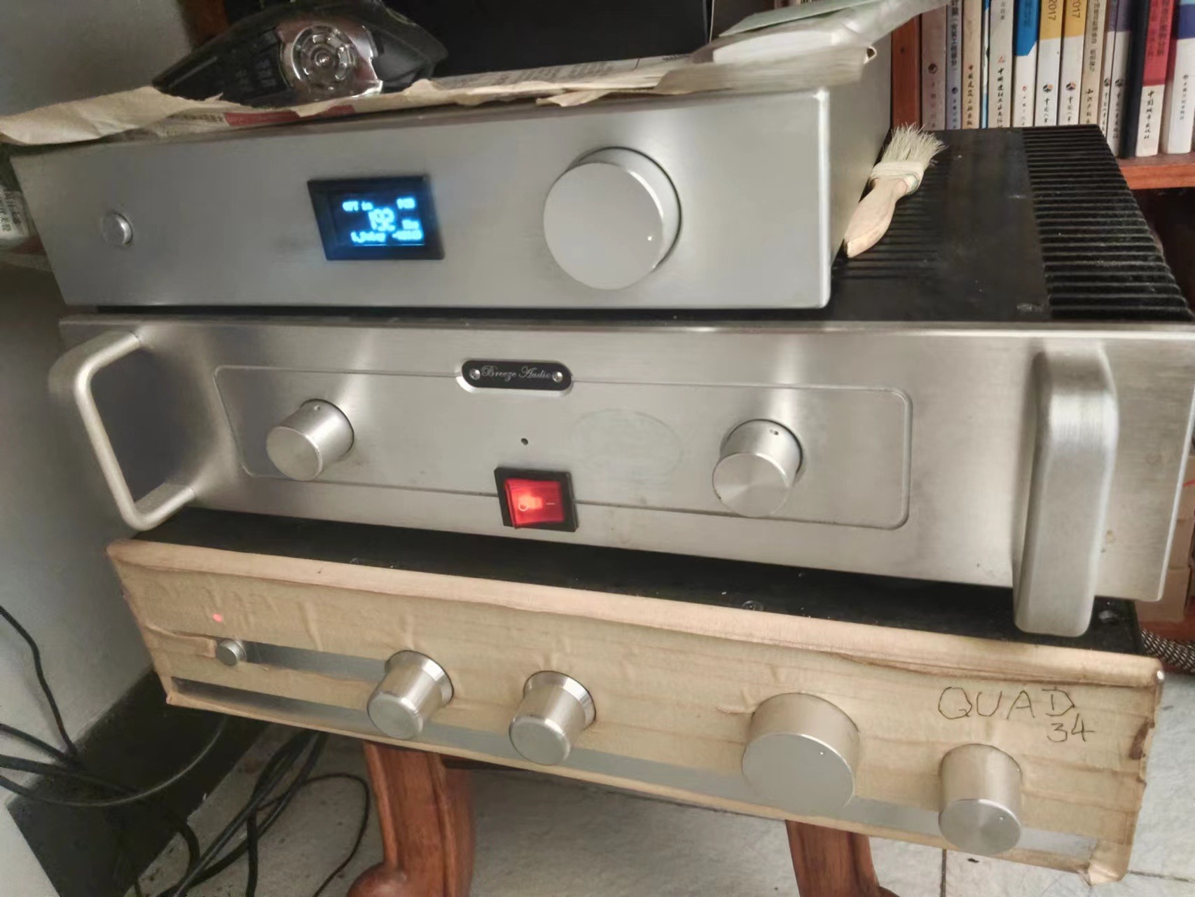

is another version of counterpoint
that uses a transistor as the final amplifier that arranges a quasi complementary circuit instead of the original output that is a MOSFET
The resulting sound is soft and smooth. different from the original one that uses mosfet
Compatible with preamp clone mcintosh c22
sound matching all frequency bands come out completely in

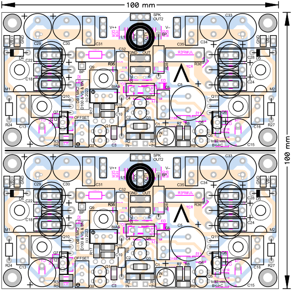

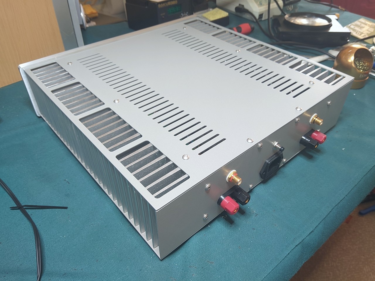

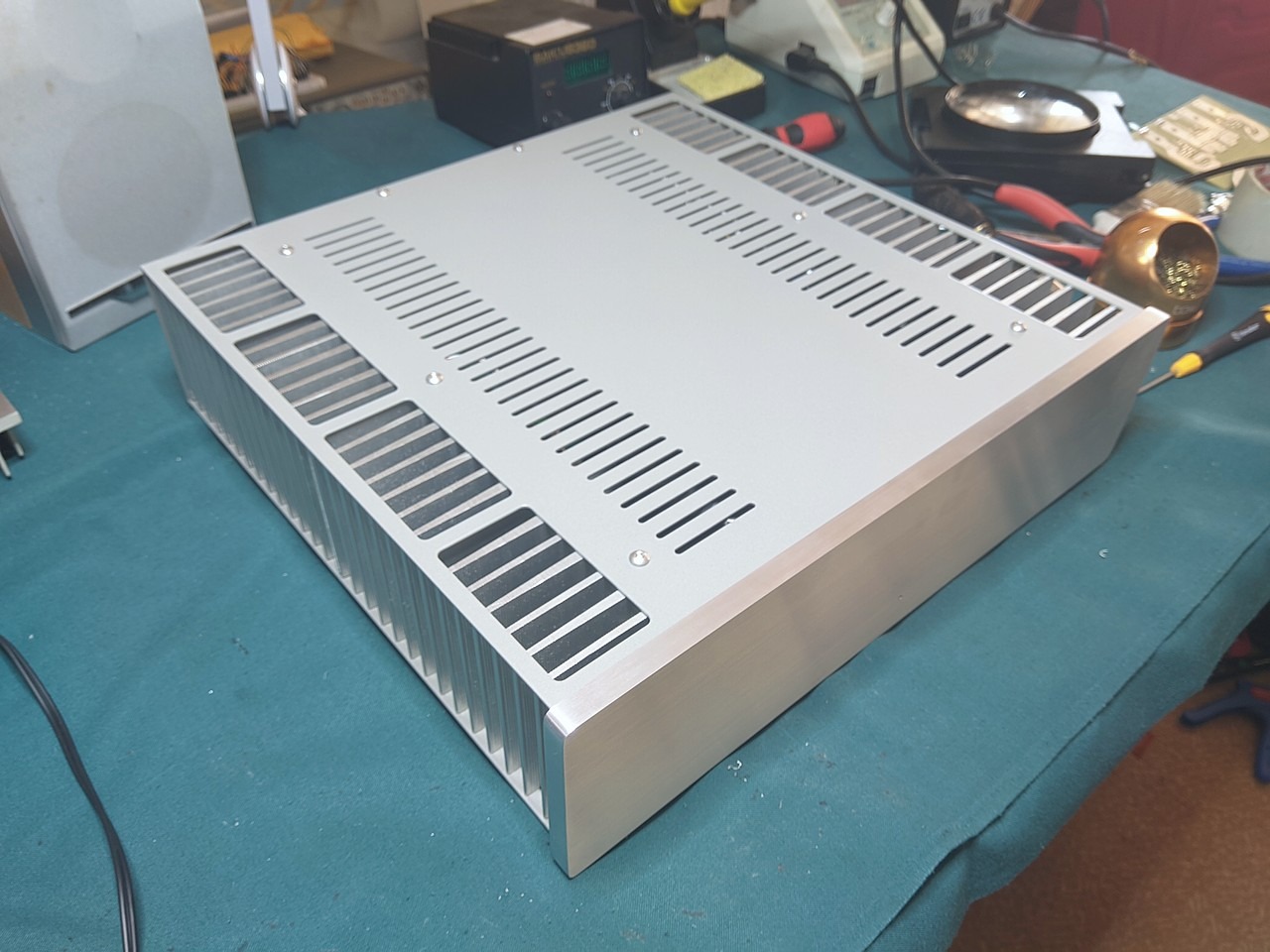

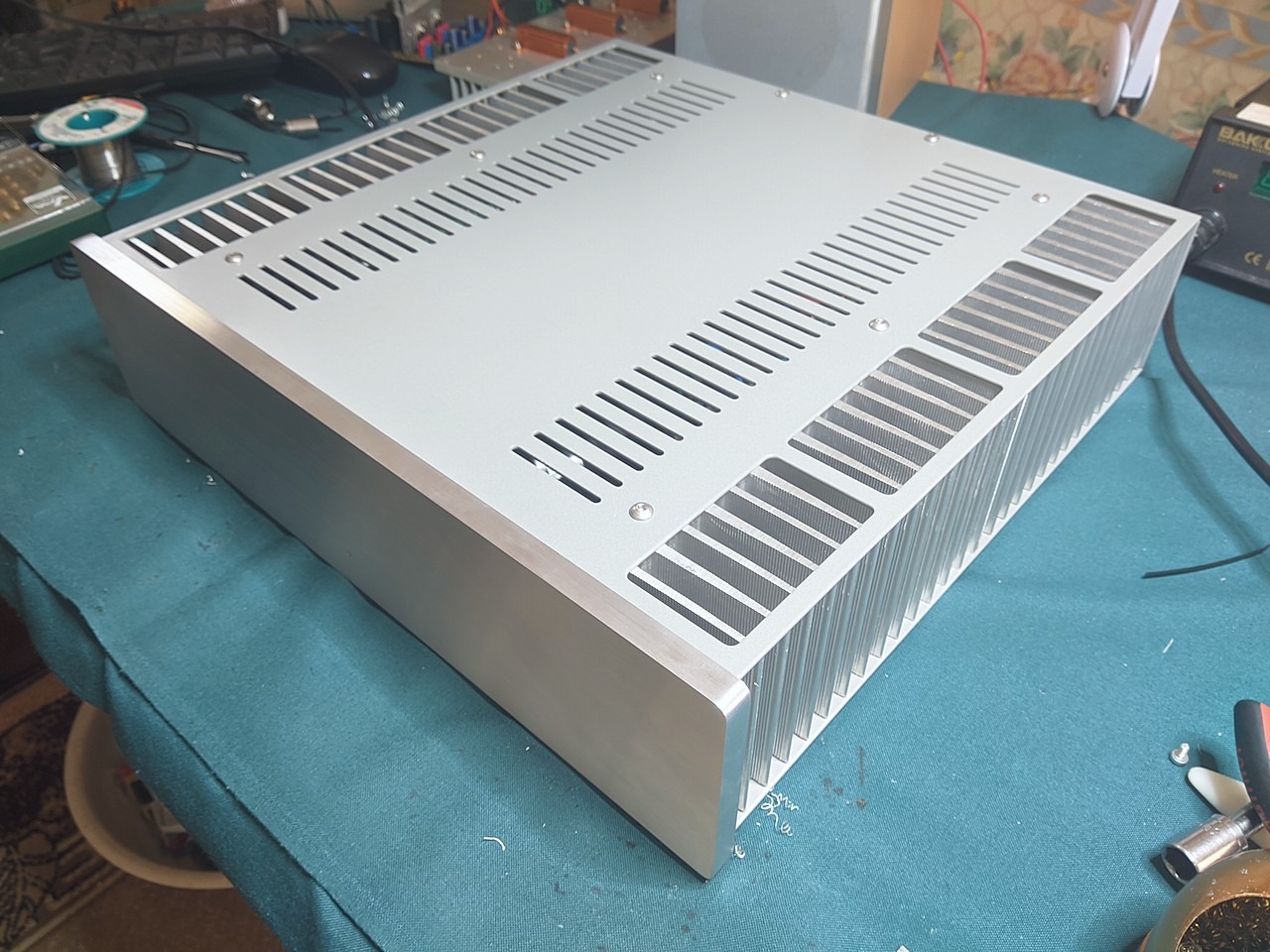

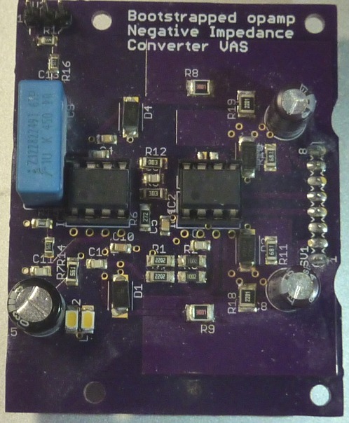

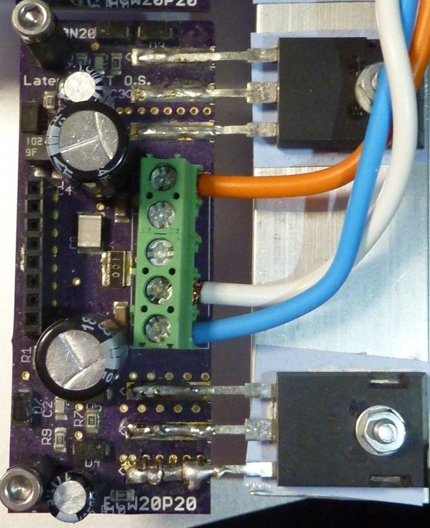

Been back to working my NIC opamp VAS design (actually replacing a damaged PCB that had a heatsink dropped on it...), so I thought I post a couple of images while at it. The original thread is: https://www.diyaudio.com/community/threads/nic-opamp-vas-topology.348646/
The main PCB (all but output stage):
The output stage PCB:
The output devices are ECX10P20 / ECX10N20 lateral FETs, so no thermal feedback needed for the bias, a tiny 11 turn cermet preset to set the bias.

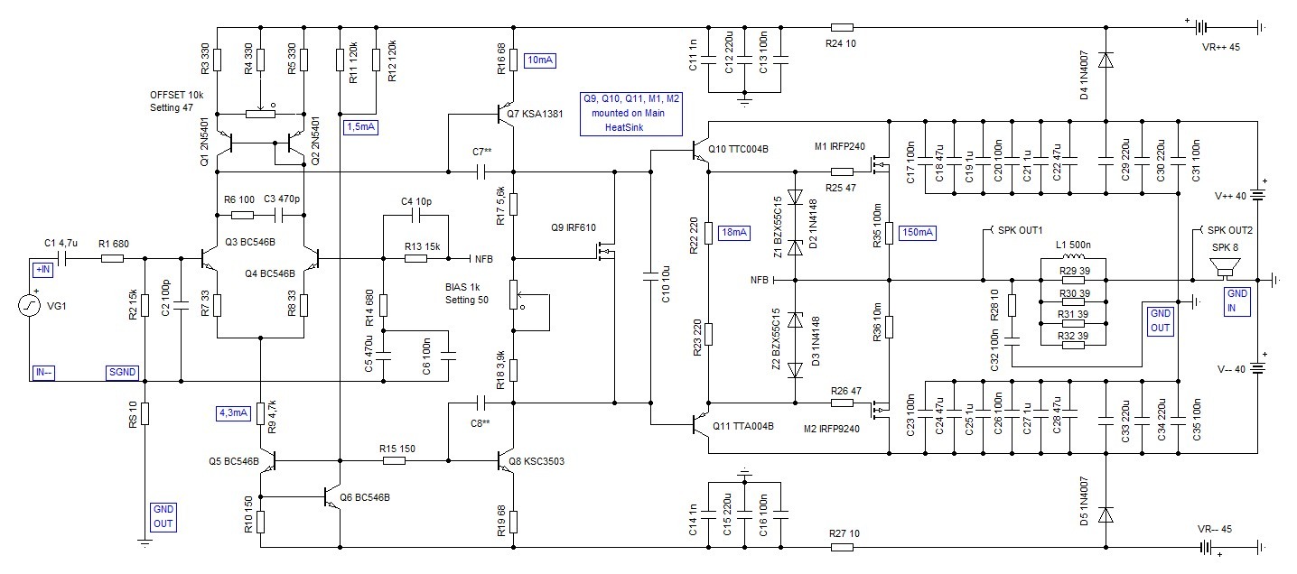

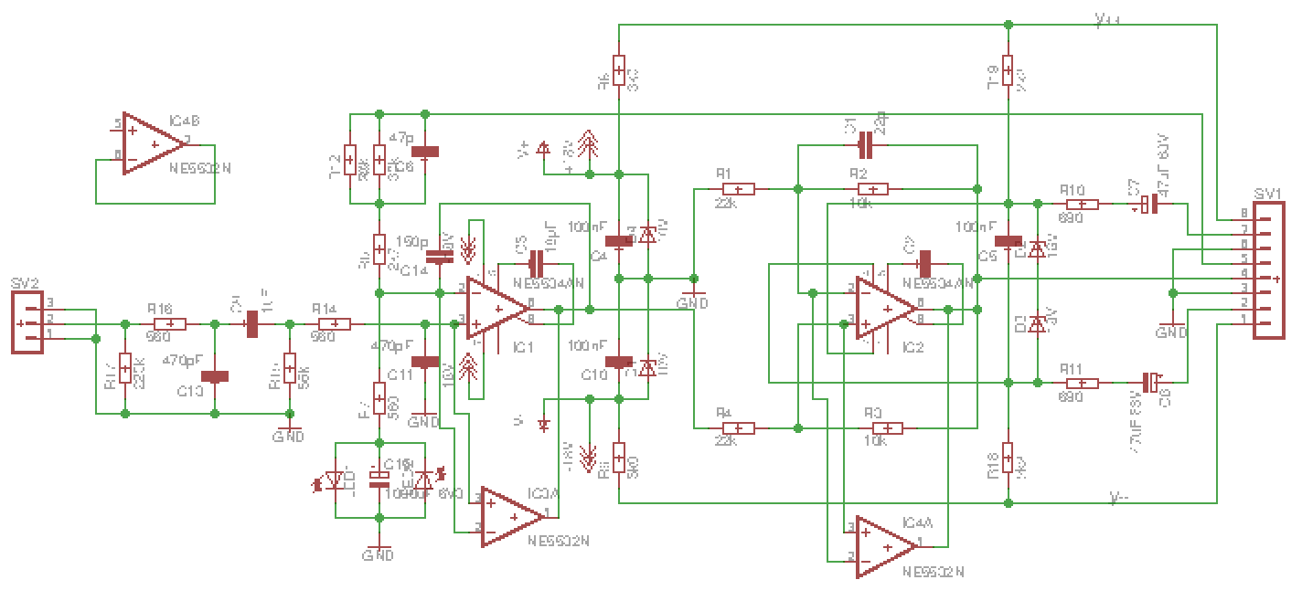

The Eagle schematic for the main PCB:

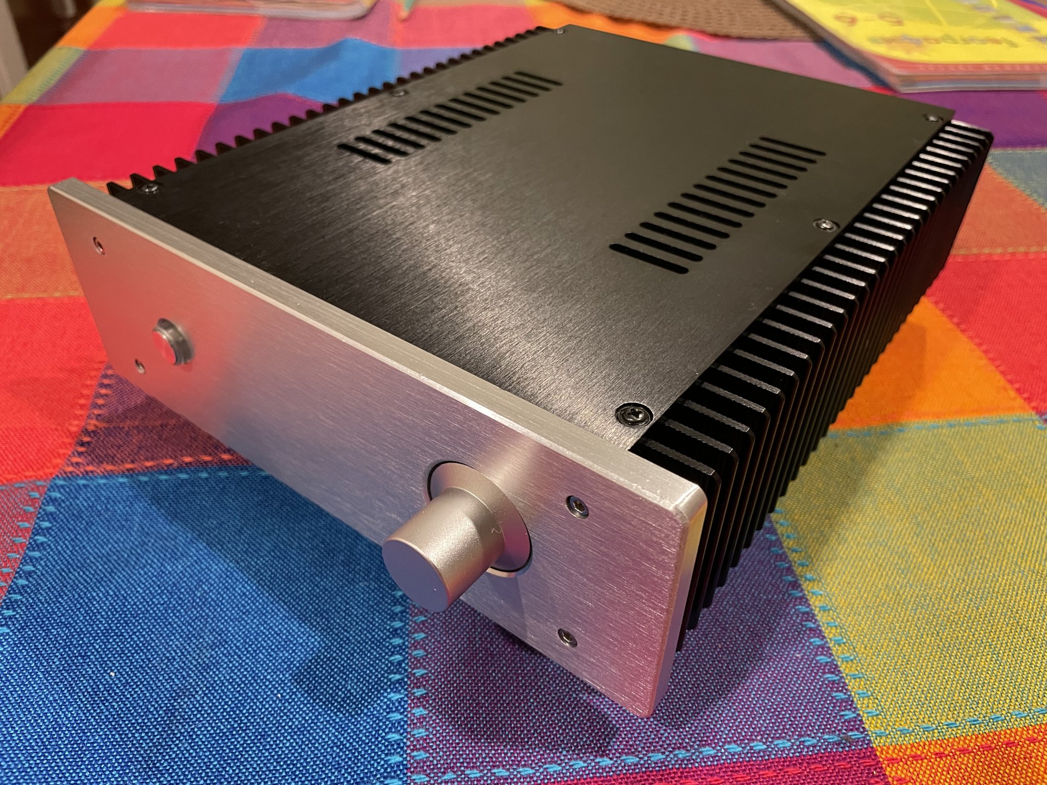

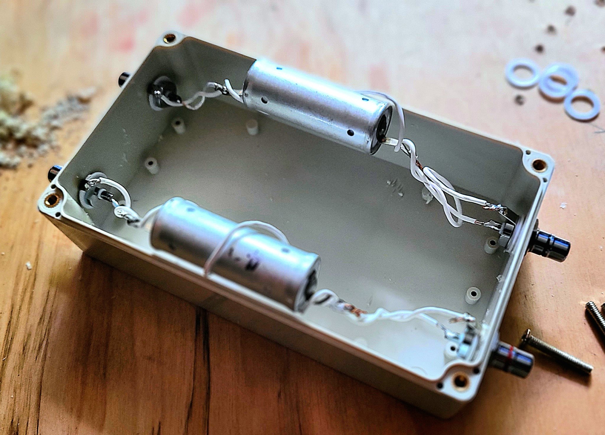

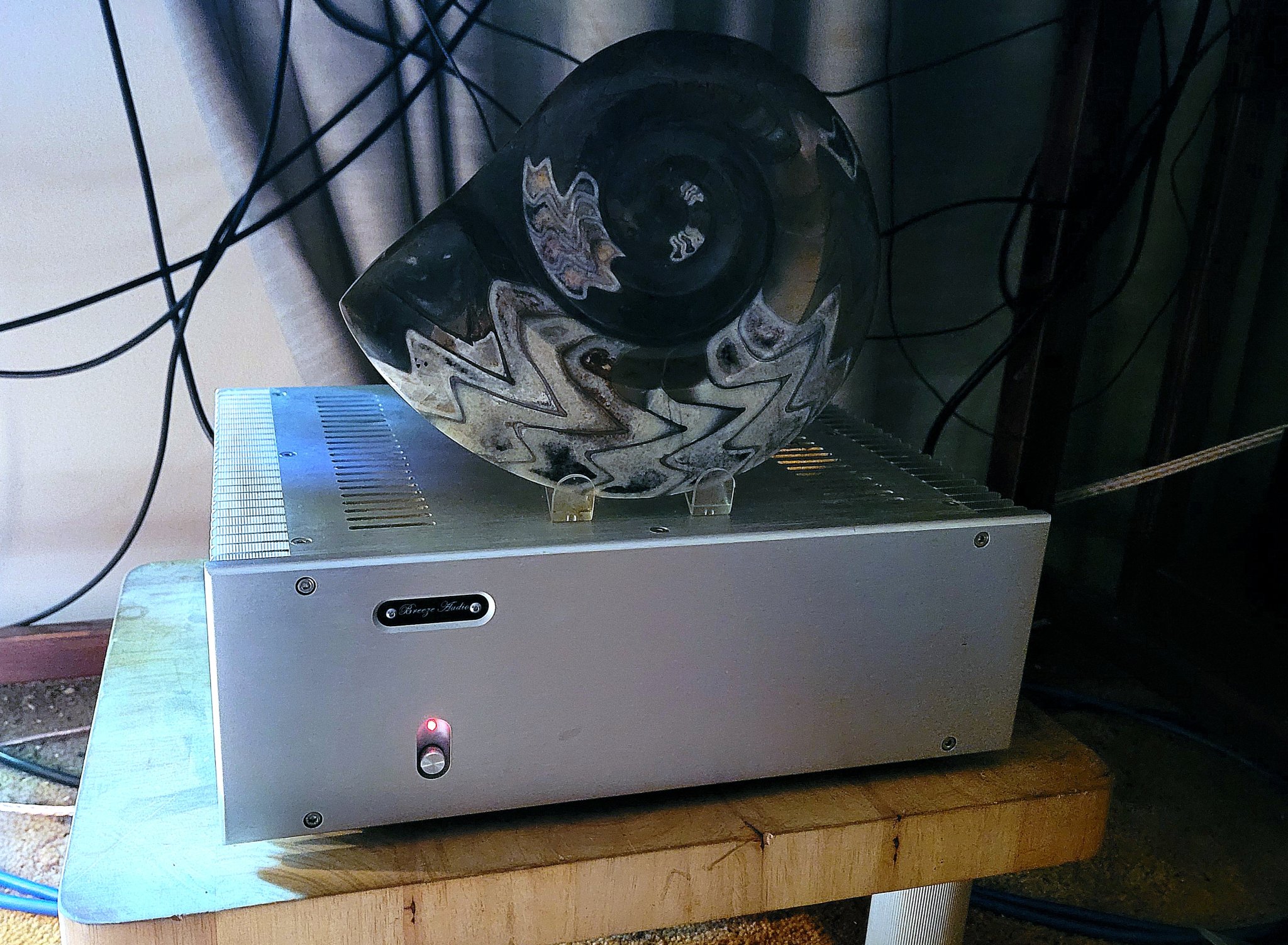

My little Breeze Audio class A power amp. I used to use active crossovers, but switched to a simple amplifier highpass filter, to the point just above where a pair of full range drivers flap around without producing much sound, and augment the lower range with an open baffle bass frame.
Maybe a little cleaner than without highpassing the amp; especially in the upper midrange.

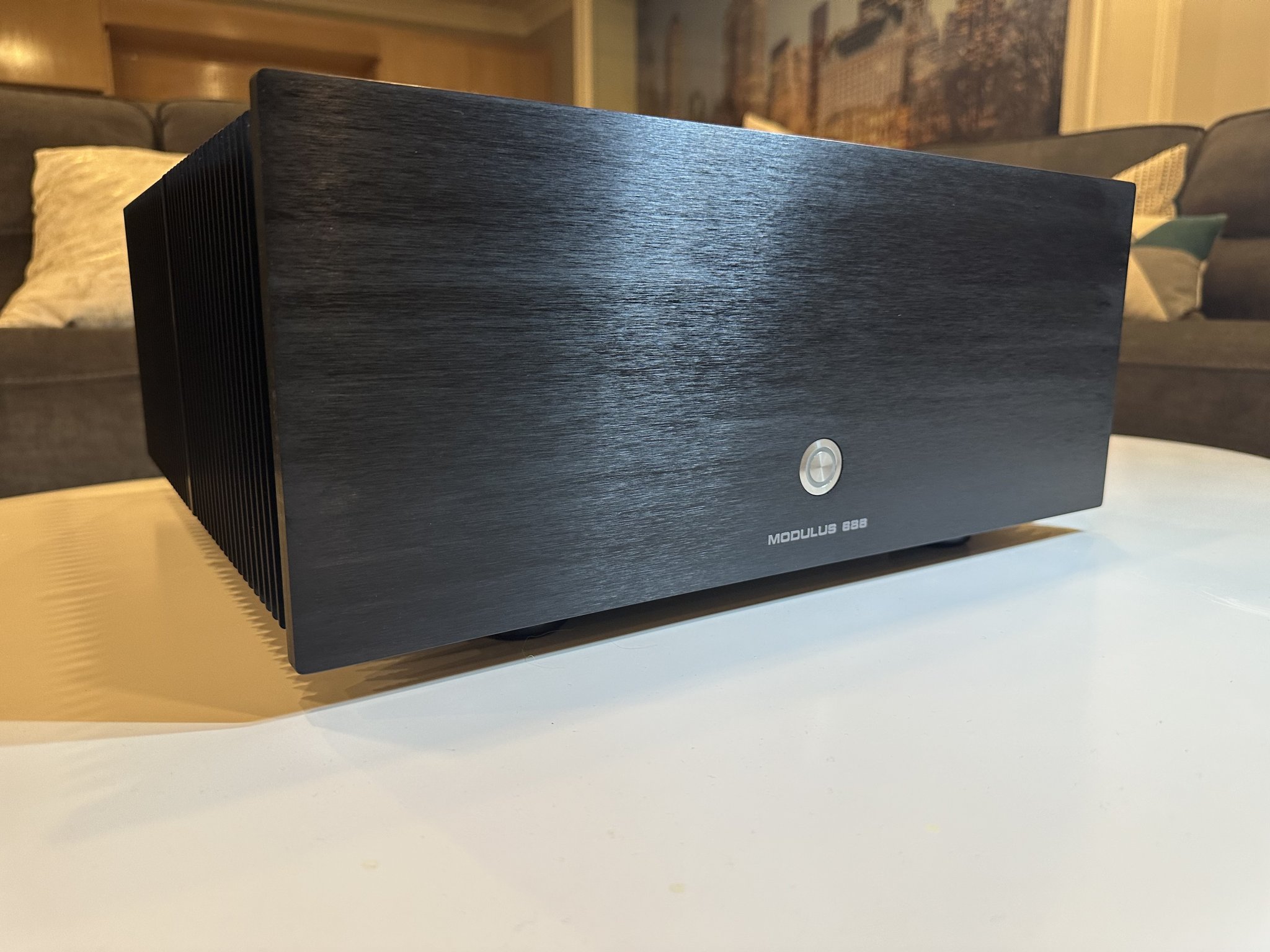

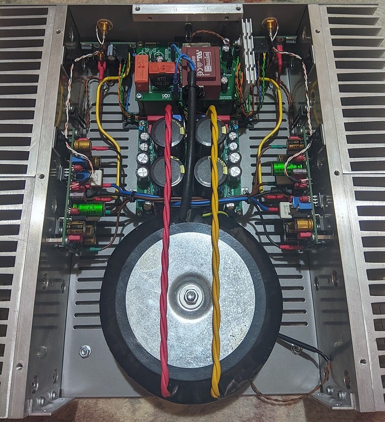

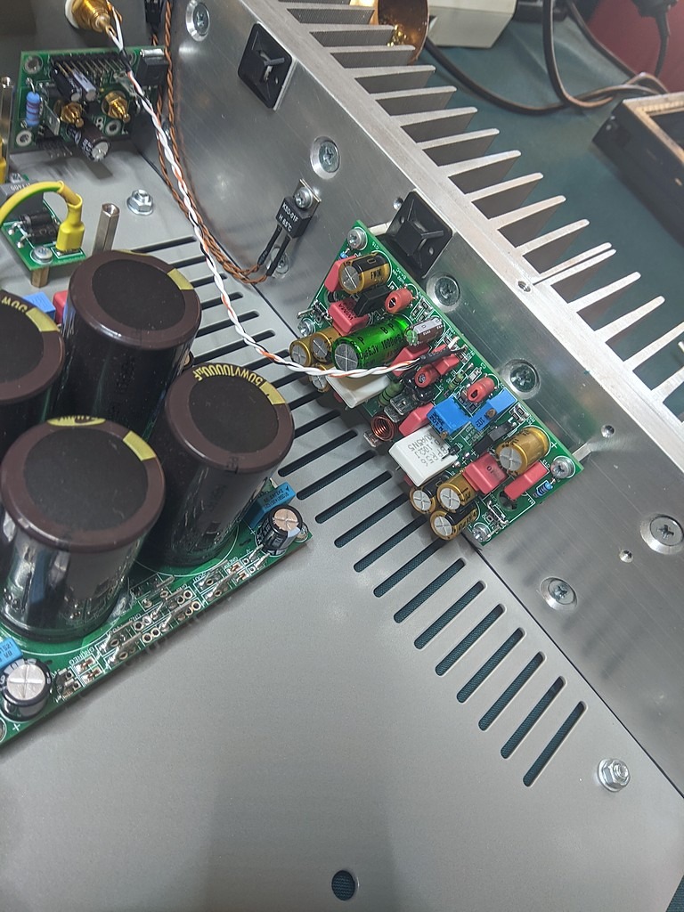

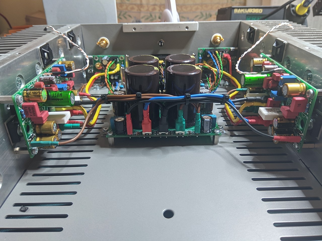

Another day, another Class AB amp. This time, the Neurochrome Modulus 686:
More info and preliminary measurements here.

nice looking
but these heatspreaders are flimsy
not enough contact area, not thick enough, not stiff enough
with heatspreaders, there is really no overkill - you need to overcome additional heat transfer step, sorta go in territory of one step back and two steps forward

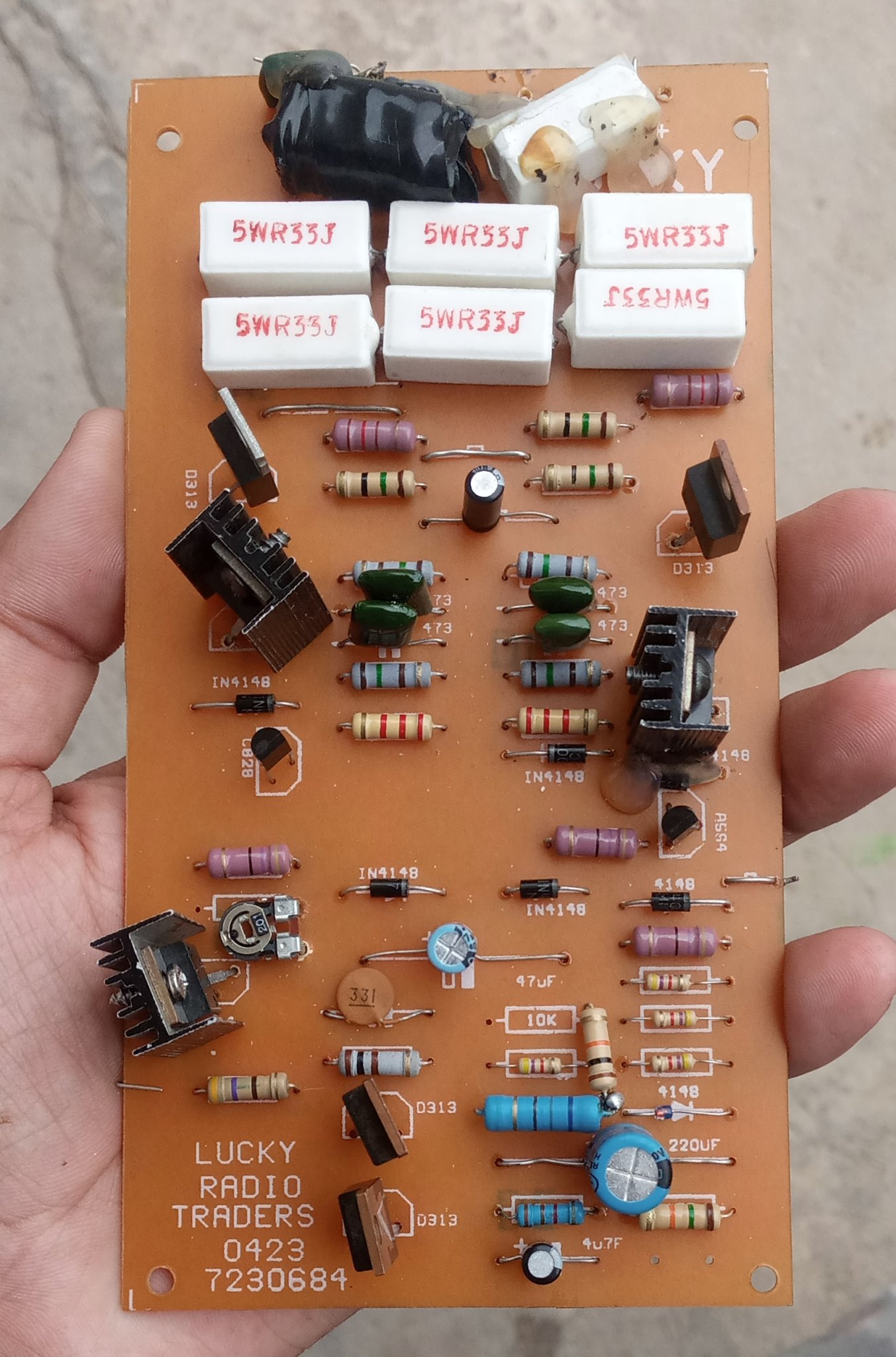

Nice clean layout.
Vertical FET "quasi amp". Might of been advantageous to add beta enhancement to Q7. More OLG = less THD.
