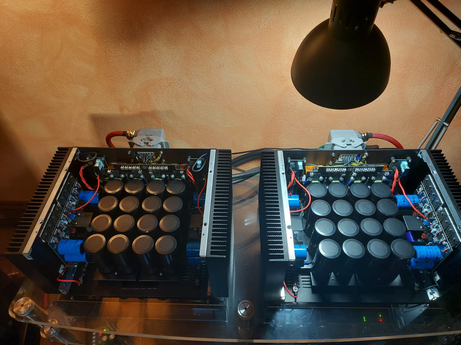

Hi all, been reading posts on here for a few years on and off as I've considered building some electronics... about 2 years ago I finished my power amp based on Project 101 by Rod Elliott. Currently working on a pre-amp to go with it that's based on Doug Self's circuits, I'll post photos later if anyone is interested. Any questions or suggestions fire away!

Lovely hand machined face. Have you thought of how to satin brush it? You can sand blast and the use etching fluid to eat the rough out of it. It would seem that you have a separate regulator for everything. Impressive. The chassis is nicely lay out and symmetrical. Never hear of that pre-amp module, could be interesting since all connectors and mounted on in and obviously floating from the chassis. The earth bar is nice but since you spent so much, it could have been solid copper "very high end 😢". Carefully looked over your solder joints, I could see, and your soldering skills are great. Wondered why there was a floating screen, did you find a ground loop? Beautiful choice of knobs, resembles those of an old Luxman , try to get a similar finish on the fascia. Remember a little felt washer under the knobs, it would be very professional and smooth operating, as well as hide any flaws in the holes that might be visible. I have build and designed literally thousands of amp prototypes in my lifetime, and your work is "world-class". You are moving rapidly to the work of Bonzai, one of my favourite designers, ranking with and even exceeding Nelson Pass. In many cases, both aesthetically, functionally and quality. He could give you many hints (I won't name-drop just in case he objects. I have been here only today after almost 2 years of absence. I trust that it sounds as good to you as you wanted it, with the sound signature you desired. Have a great life! Divulging specs is totally unimportant, it has nothing to do with sound signature, stuff with perfect specs normally sound terrible and only appeal to the owner, design to a basic spec, measure and listen a lot. You may alter any sound and the final product would be exactly to your sonic expectation, bragging rights is only for the audiophile idiots not for true Listers and music lovers. If you have ever seen what happens in a recording studio, it makes you wonder how you could ever have listened to some crap available. Having to then only buy audiophile recordings is expensive and wasteful. Actually, having a too revealing amp could make all your super loved tracks sound like crap, then you have to mess around with all kinds of brands of headphone/speakers to try and correct it to be listenable and half enjoyable "more unnecessary expense". Room treatment is a total waste of money - tone controls are absolutely necessary as you have included in your design. Kindly drop a sample of your library recorded directly from your amp on the forum. I would love to hear it through one of my systems. Sorry, I forgot Mooley, and excellent resource and vault of knowledge, practical and theoretical - mostly spot on with his comments and extremely helpful, always good to refer to his posts. I will not pay too much attention to the young mavericks on the forum, reason why I lost total interest besides they mostly try and tear your design that sounds magnificent to you apart and super annoying, try not to post any detail on the forum, I would recommend direct mail to Mooly or Bonzai. Avoid the PASS forum, there are one or two know it alls that could really annoy you. This product you designed IS for your pleasure, no one else.
Thankyou for the kind words Nico, they are appreciated, although I don't consider my design to be world class by any means 🙂 This is the first pre and power amp I have built. I'm sure there are things I could have done better, things that I have 'over-engineered' with unnecessary expense, things I have overlooked but I have enjoyed the process (and continue to do so, as the preamp is not complete).

I still need to decide on the finish of the preamplifier front panel. The power amplifier is black anodised but I'm going to change it as it looks dull. Obviously the preamp front panel will match it once I've figured things out.
Regarding the preamplifier, the design is based on circuitry by Doug Self that was described over 3 issues of Elektor magazine in 2012. I didn't buy the PCBs that were available for the project but instead designed my own, which allowed me to incorporate the modifications I desired. This included more advanced bass and treble controls (which allow control of the turnover frequencies as well as the bass and treble levels). I added a headphone amplifier and also made provision for the relay attenuator boards which fit vertically in slots provided in the PCB.
The 'earth bar' if I understand correctly is actually an aluminium upright section to which linear regulators are attached for the power supplies of the 'control' part of the preamp, a microcontroller is being used for controlling the relays, switches etc. The cables going to the relays are screened, maybe overkill but I didn't want electrical noise from the microcontroller to disturb the analogue circuitry. I was temporarily using the aluminium to ground the cable screens. The cable screens are now attached elsewhere (the preamp is still being designed and the photo is a few weeks old). The analogue circuitry itself is grounded at a star point near to the output of the linear regulators on the PCB, near to the central copper box that is screening the MM/MC phono stage.
Given that I had never heard the Elektor preamplifier, and I spent a considerable amount of time and money before connecting my PCB to a bench power supply and my power amplifier, I was nervous as it started playing music! I was glad to hear that it had been worth the time and effort. I have some revealing DIY speakers (they can be seen here http://www.troelsgravesen.dk/CNO-25-James.htm) which will soon tell you if something isn't right and I'm glad to say that I'm happy with the sound. To my ears it is transparent enough to enjoy the details in the music, and it is easy to hear the difference between good recordings and bad, but I haven't played anything yet that is simply unpleasant to listen to. I had an integrated amplifier in the past that was perhaps a bit more transparent in the mid range, and sounded a little 'forward', but this 'forward' sound had drawbacks with some recordings. I also prefer the bass and treble extension of my pre/power amp combination.
