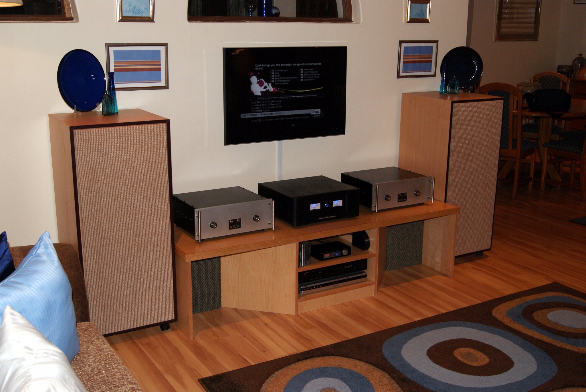

I posted in this thread umpteen times, maybe one last time will include how nuts I was.

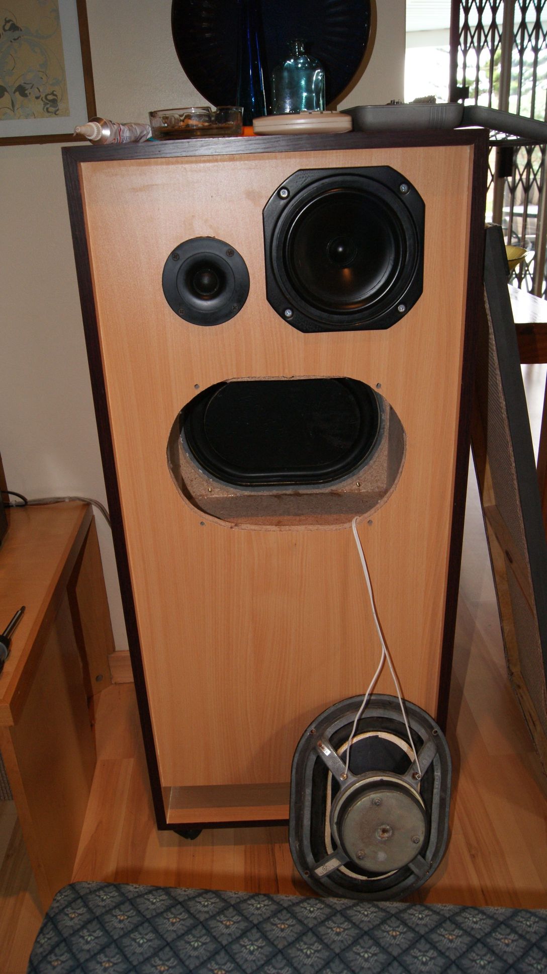

I posted in this thread umpteen times, maybe one last time because I am too much will include how nuts I was. Speaker's Isobaric, transmission line, digs down to 16Hz. Tinkering and tweaking this system for close to 20 years, the stand includes quite sophisticated horn loaded Mid-bass to augment the sharp leading edge because the woofer has so much mass. I have zero sound problems', hut suffered from faint hum. now and again. Paced a chart recorder in the power line and soon solved it completely. Noise floor now close to -103 dB, below full out. Not a TV guy just plonked it there incase I want to see album art.should it be there. I have no woodworking skills, and our local wood supplier made it to drawing, that was never listened to until their arrival. There is no simulator anywhere to analyse the speaker cabinet. Power is derived from 8 power amps preset to max 20 watt per amp, 10 dB below clipping. Never crawled round on the floor to hear bass, was never needed. This is a simple three-way design, utilizing Linkwits-Railey topology. My reference amp RAS-ELD. Few years after posting its basic topology encountered now infamous amp with massive DIY following being identical to ELD, my initial topology followed Toshiba app note, which was very simple but modified heavily now very complex, not even resembling the App note. These are all class A, as you may notice, I opted using Seebeck effect that drives small low noise fans as soon as temperature differential between this and ambient reach a preset threshold. Case temp is only 8 deg centigrade above ambient and remains infinitely stable. Higher bass mid in sealed cabinet above woofer. A little edge refraction from tweeters, but later solve with a bit of self-adhesive foam. Internal stuffing, real sheep wool and 20 mm thick bitumen panels.. Open speaker reveals ISOBARIC chamber. Speakers were a pain to find, four of these matched is almost impossible, but doable. Cross over set to 30Hz.; 70 Hz followed by 3000 Hz (mid/bass to tweeter. Was almost impossible to design a crossover with so many elements and poles to integrate have ruler flat frequency response as well as their effect on each other, then opted for active using the best sounding op-amps available to me including two Krellish KSA 50 amps, which turned out not so super as I imagined and needed heavy-handed mods to bring them in line with what I liked. Used an actual Grand Piano directly coupled to amp, to calibrate the system with no mics only accelerometers and Spectrum analysis. Adjusted networks as required. Measured speaker movement with differential instrument amps also by accelerometers until the output resulted in zero difference. Room Effects has nothing to do with it. Think of it as anechoic........

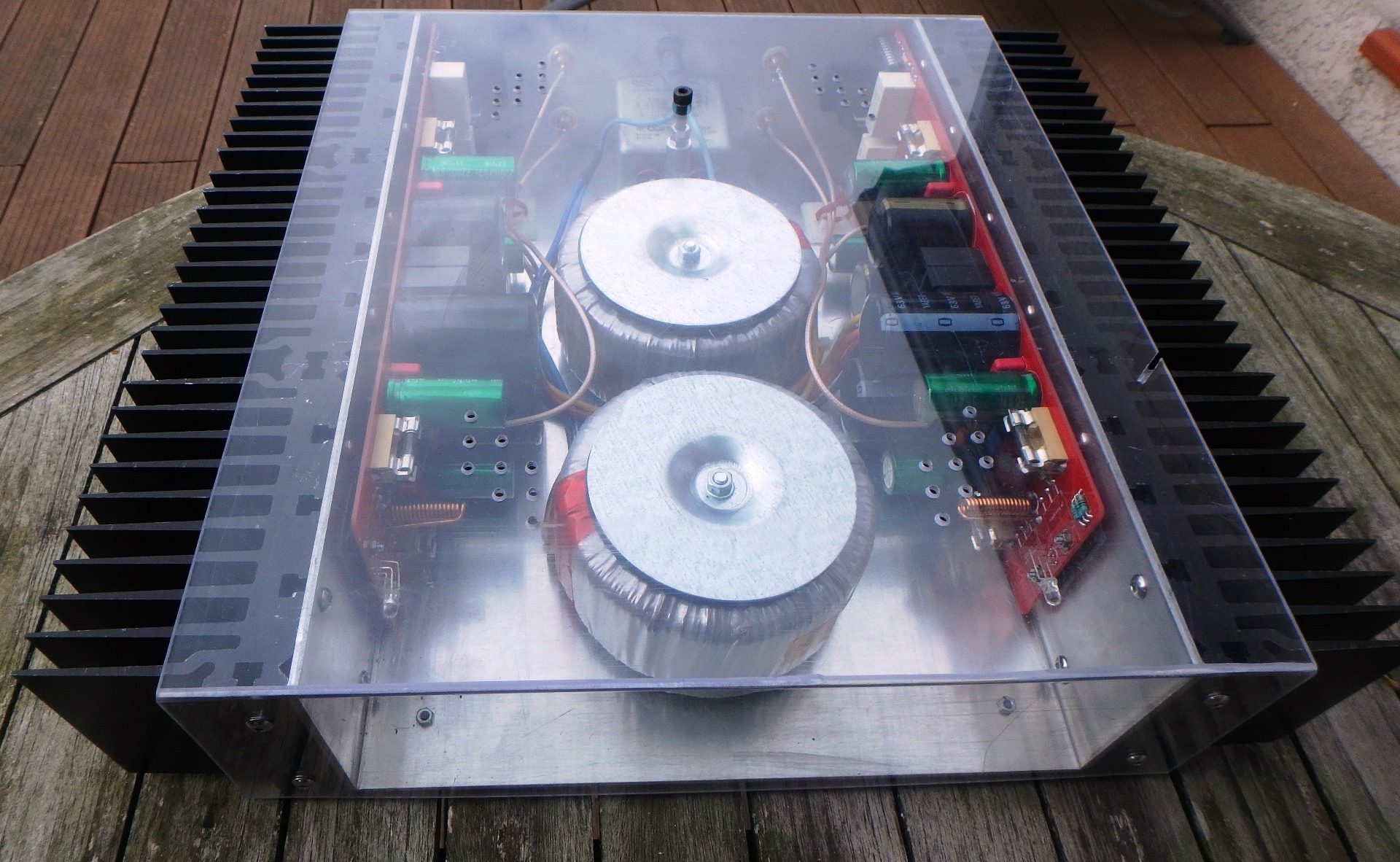

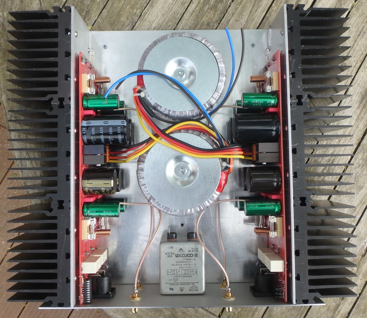

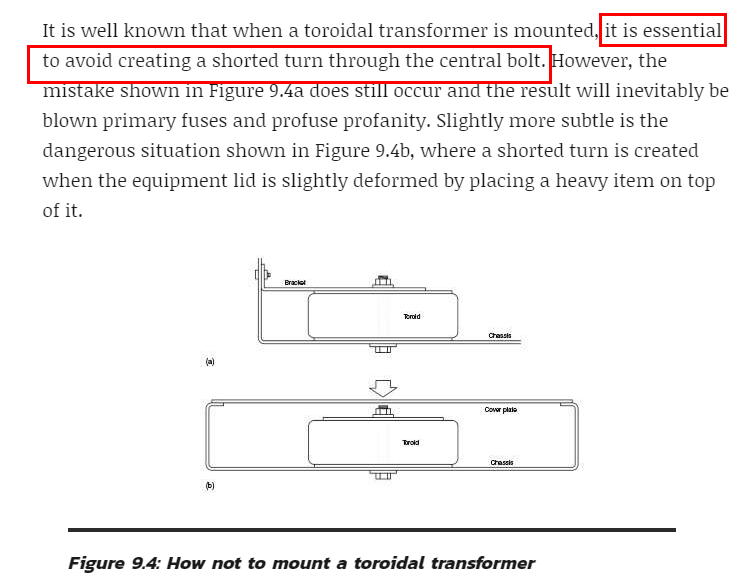

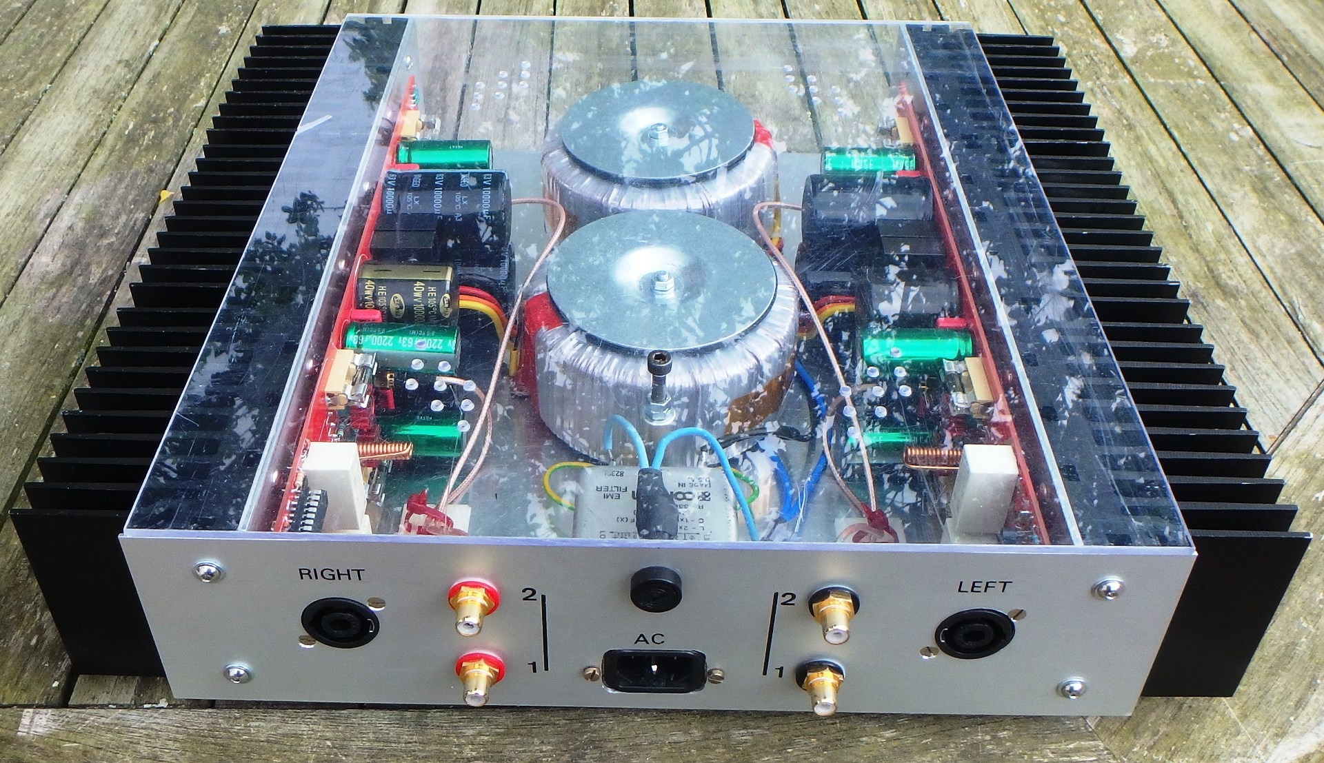

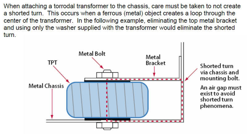

@SDF

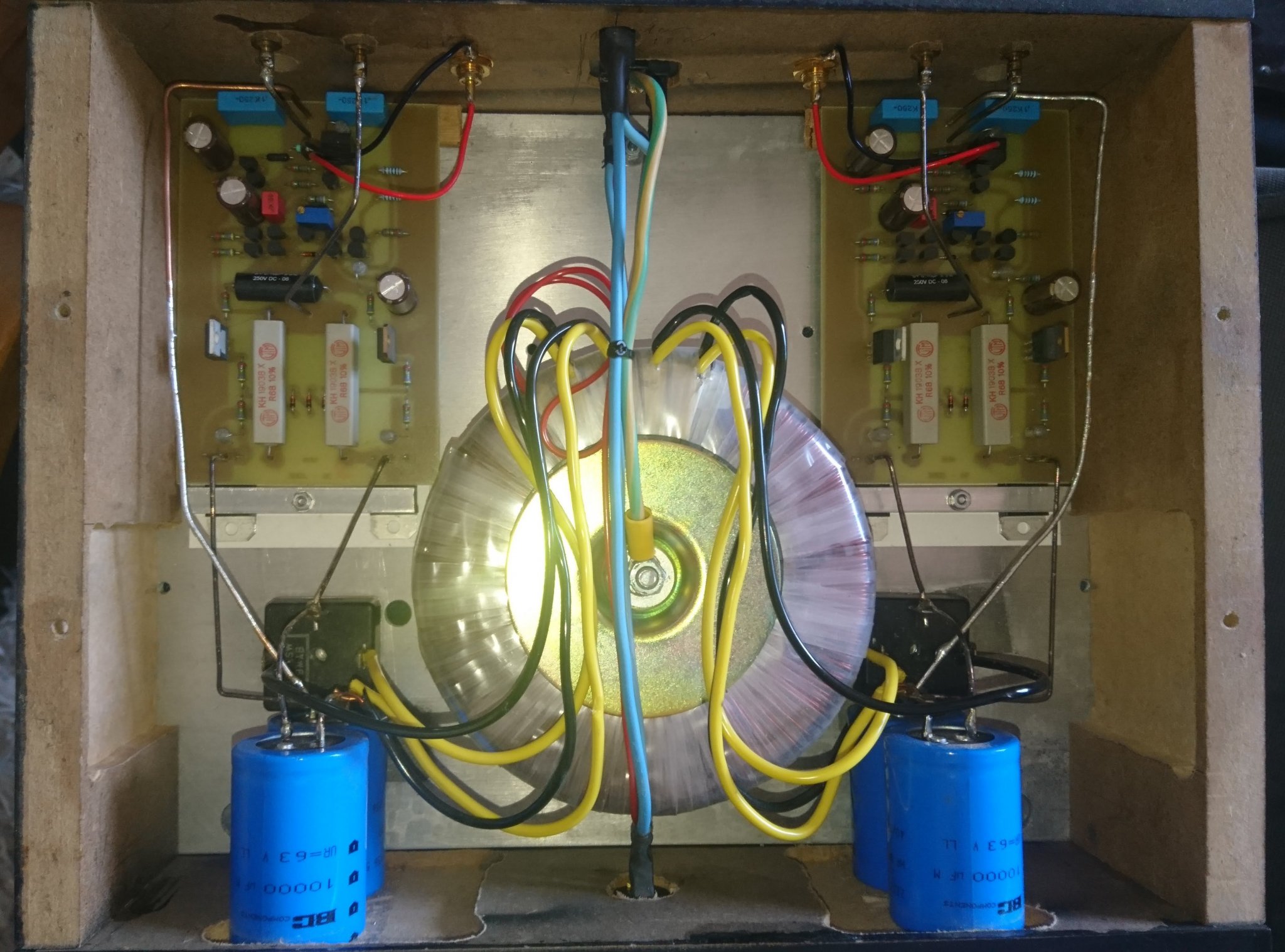

In your NVA clone you connected the Safety Earth on the bolt of the xformer.
This is the worst Site to do it! Connection a Instrument e.g. a Scope with safety
Earth creates a shortage of the xformer . Burning the instrument🤖. On the left
there is already a hole on the chassis for better conection.
Stay safe
