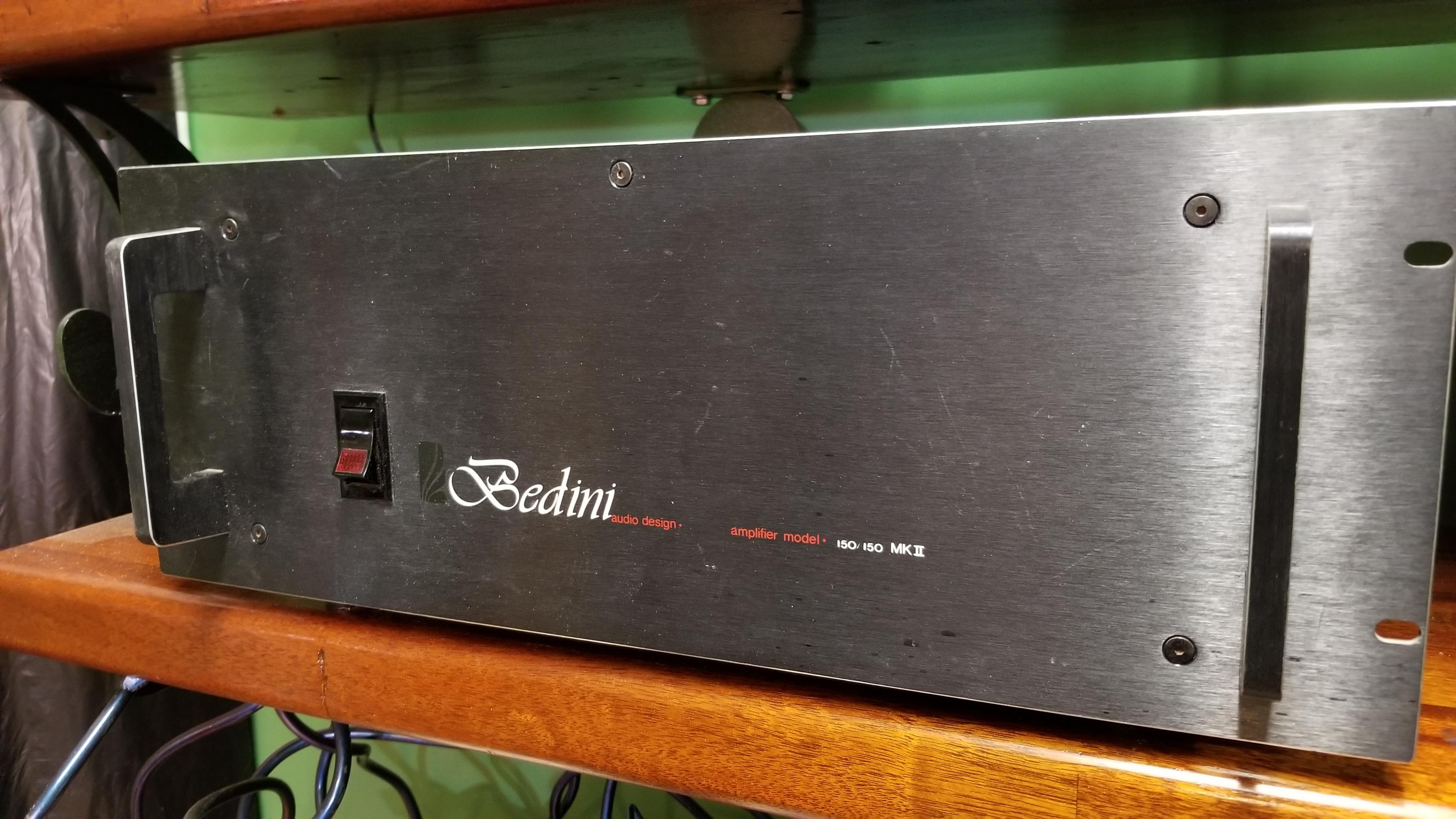

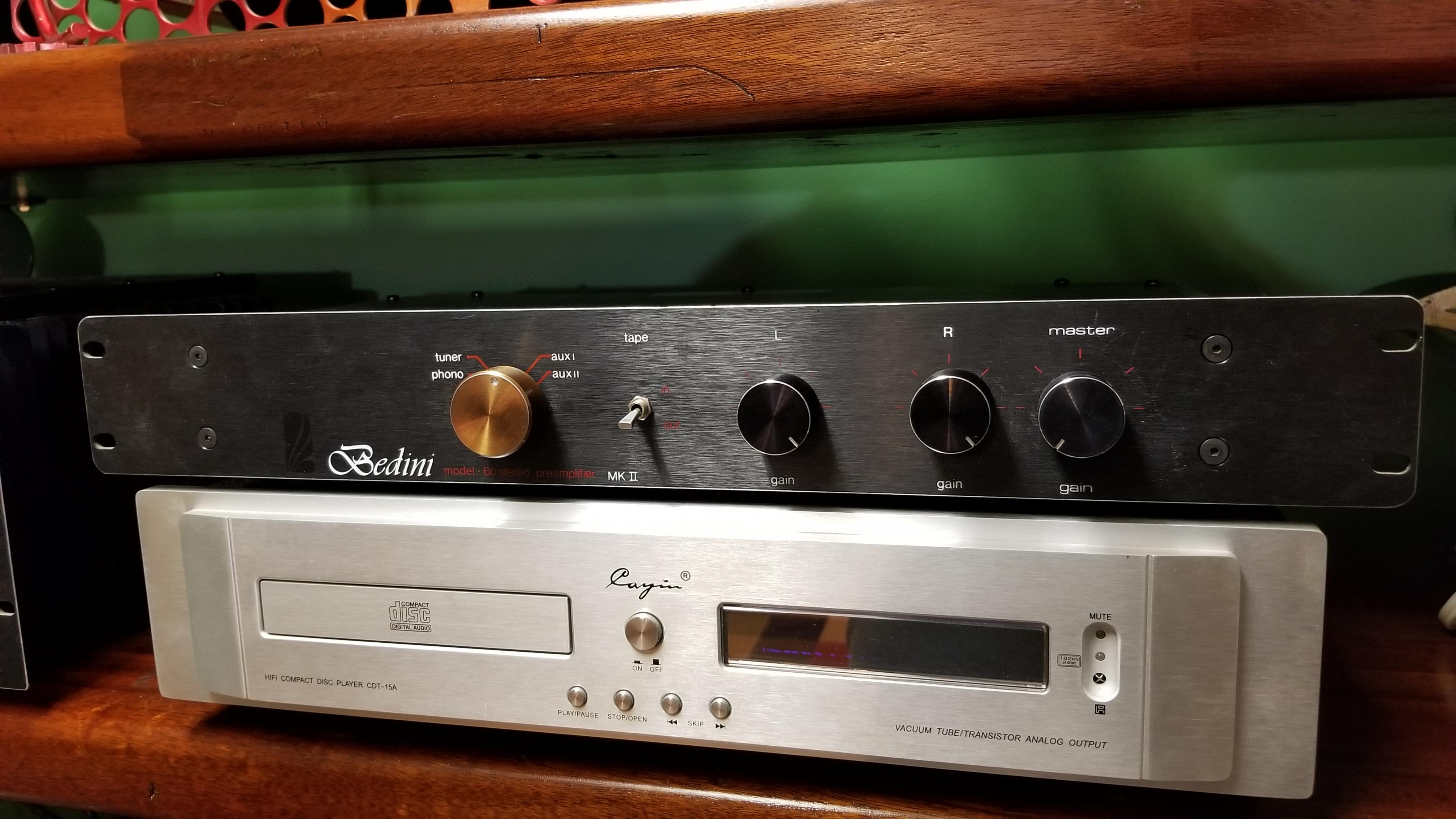

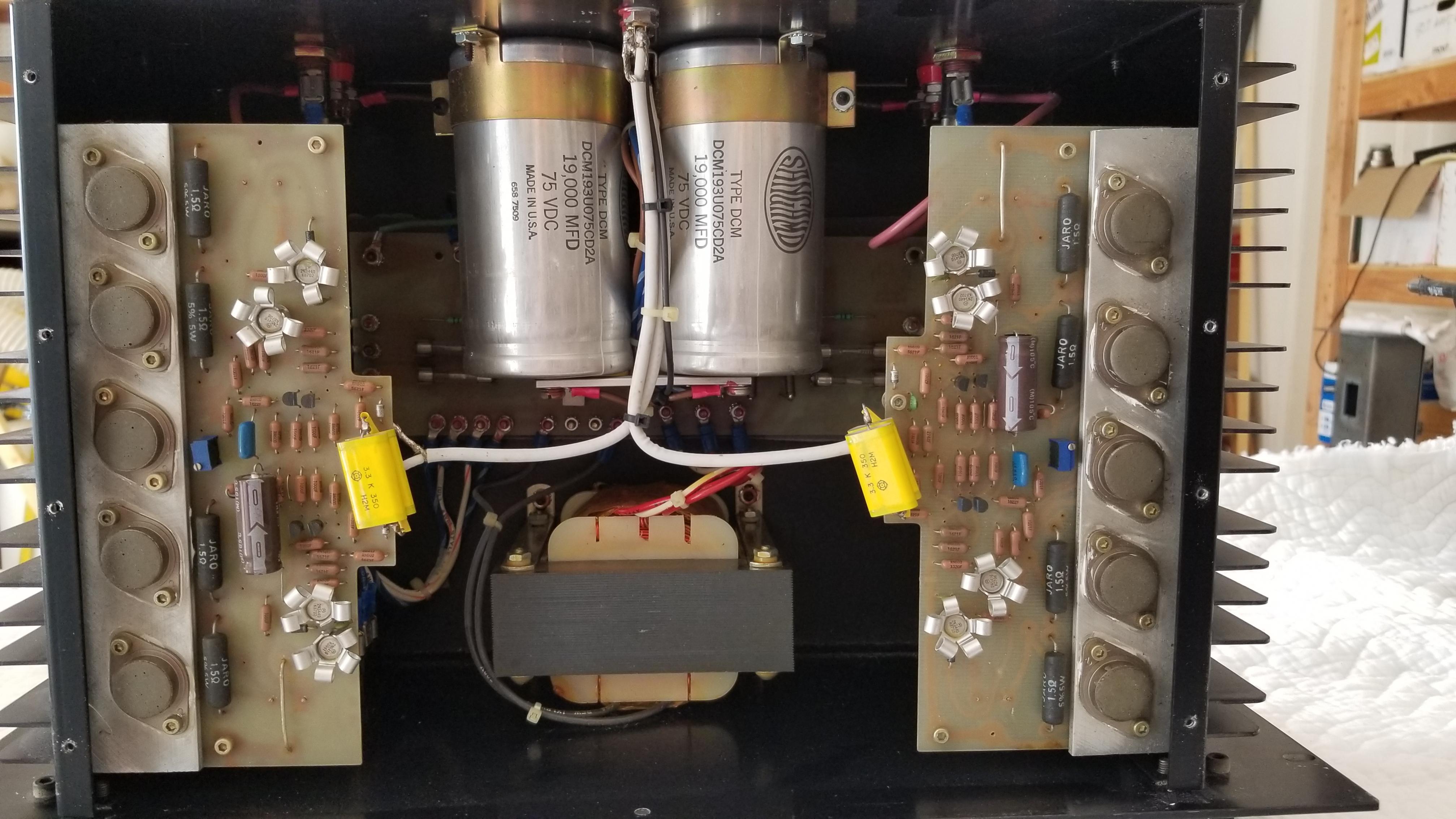

The last time I had a SS amp was the Advent I bought new in the late 70s. It's been tube amps ever since until a month ago. I bought a Bedini 150 positive feedback amp and Bedini 50 preamp.
I am absolutely taken with this new amp and preamp. I can't find much on the Bedini but what I do find is very positive.

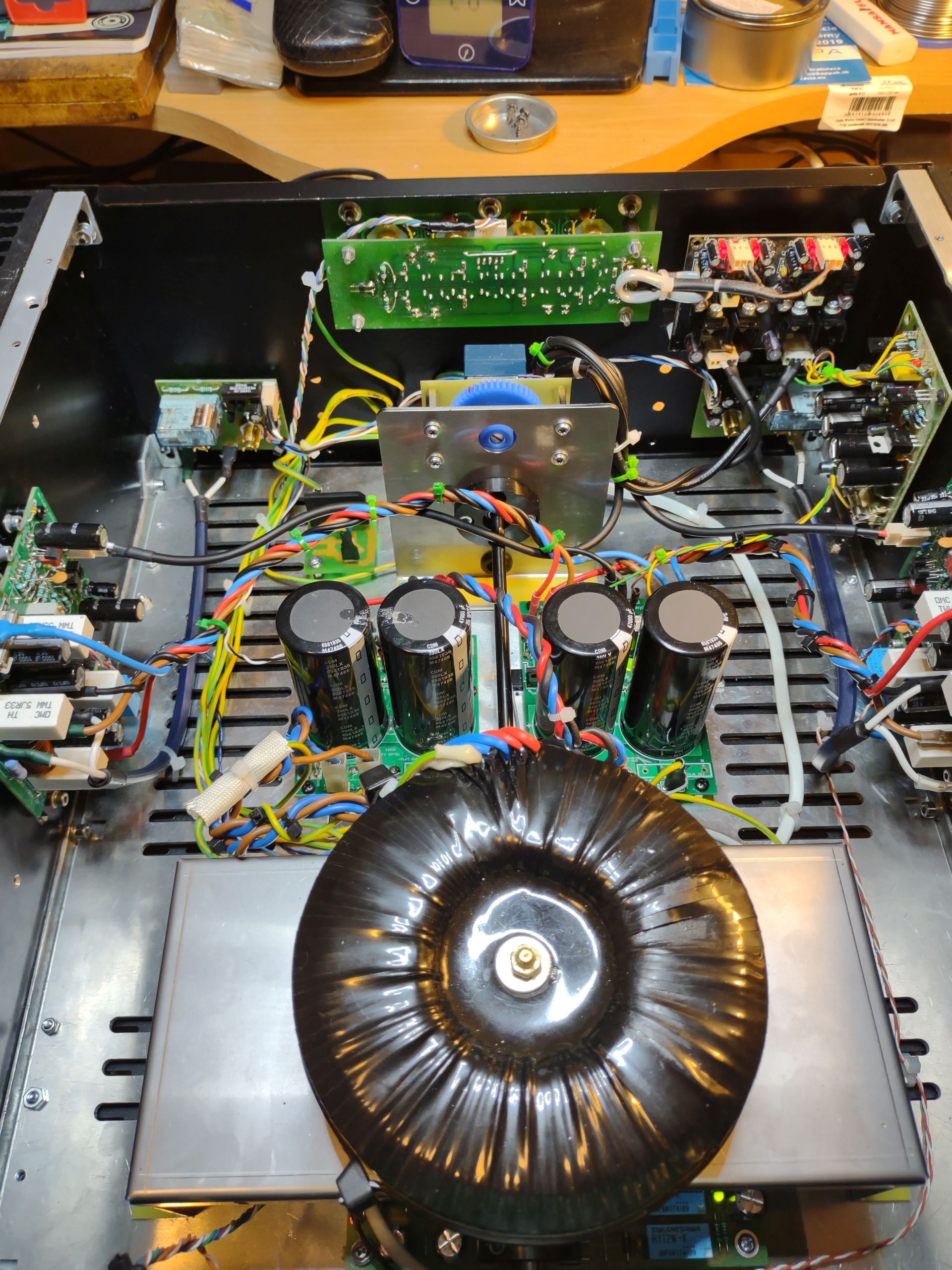

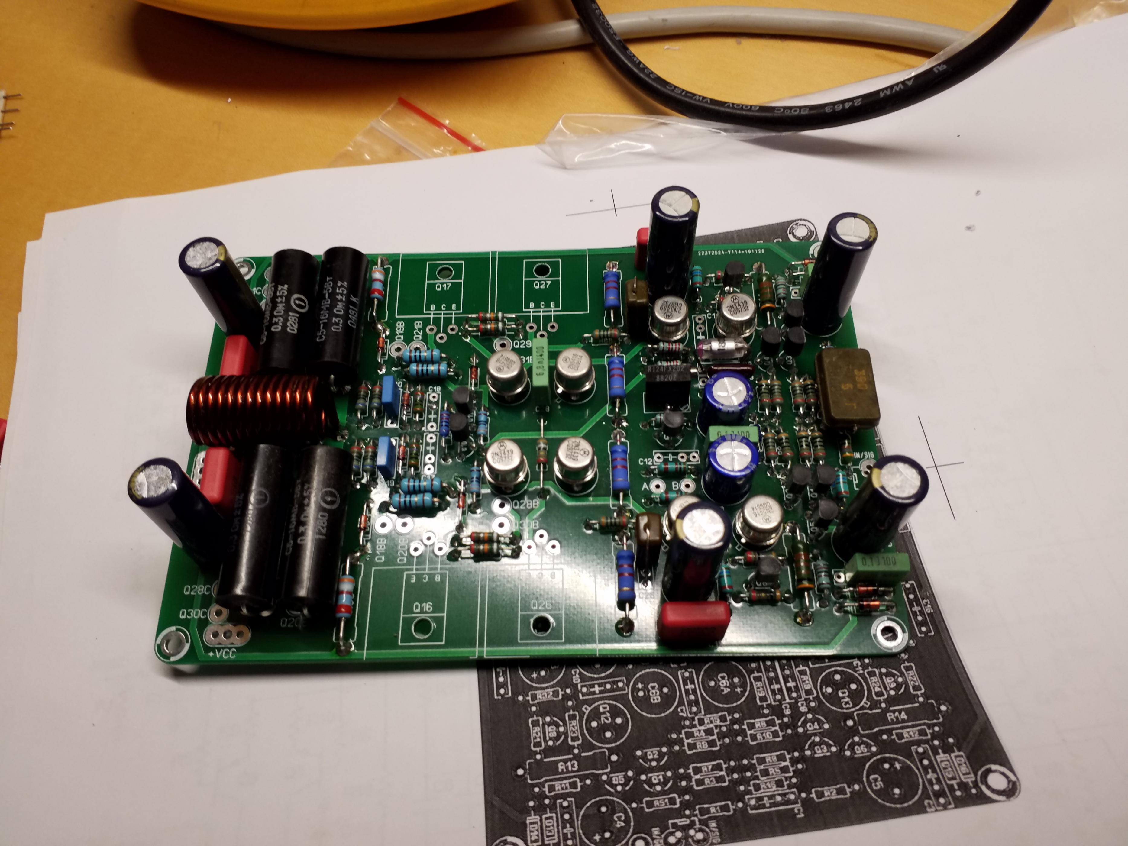

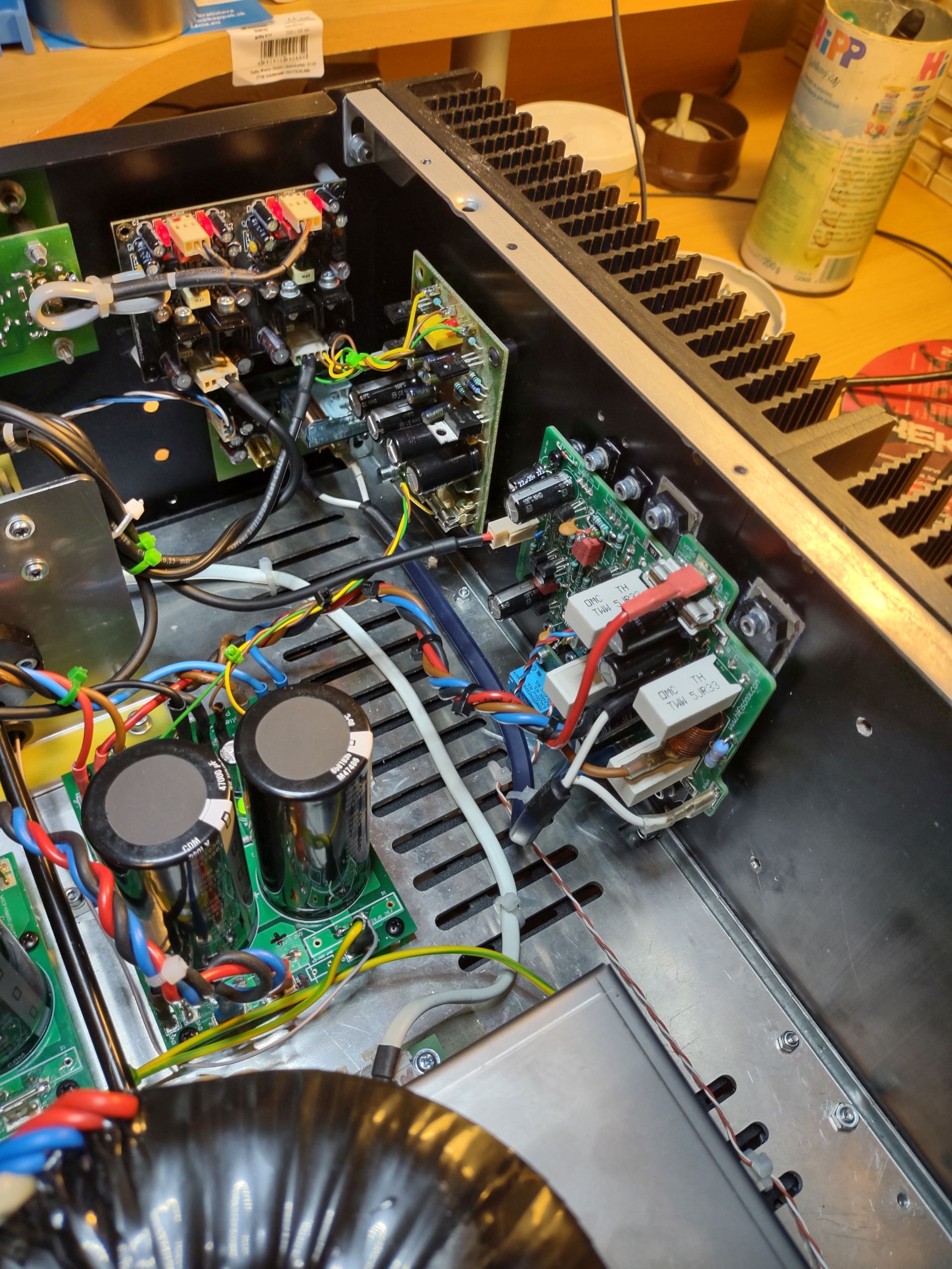

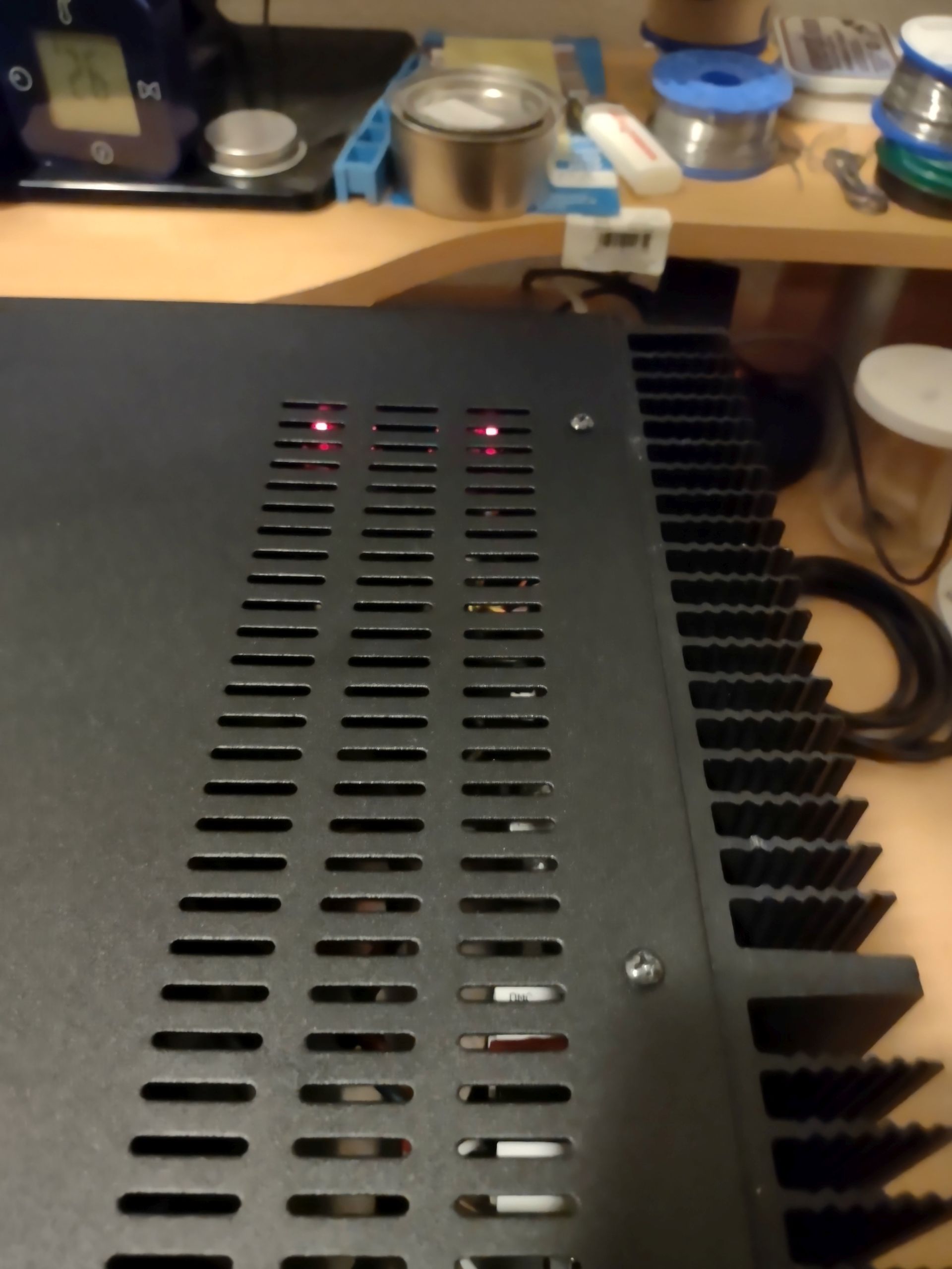

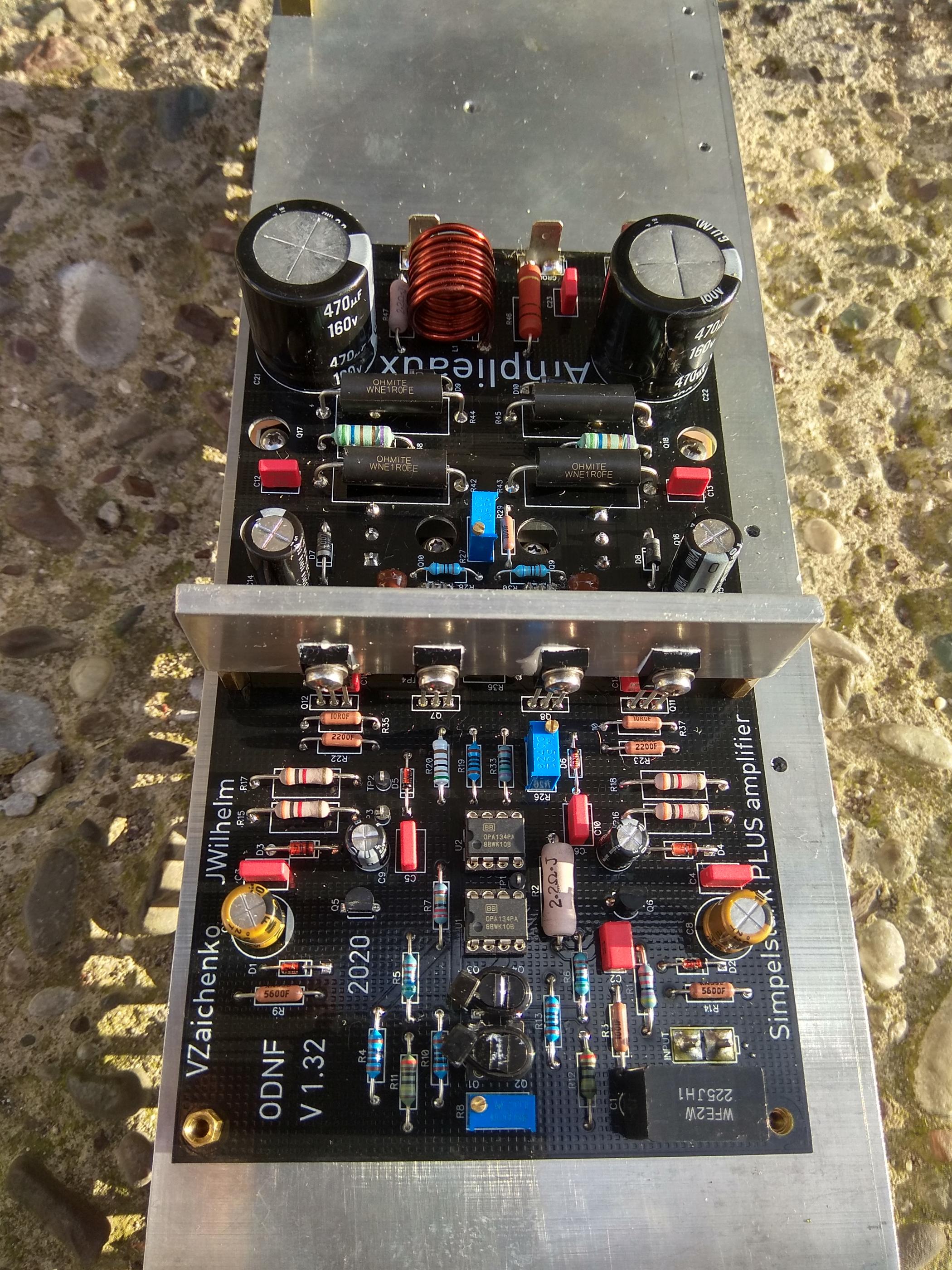

My first diy ever built from scratch, started on first quarantine lockdown, finished one channel, hope to finish second one soon 🙂

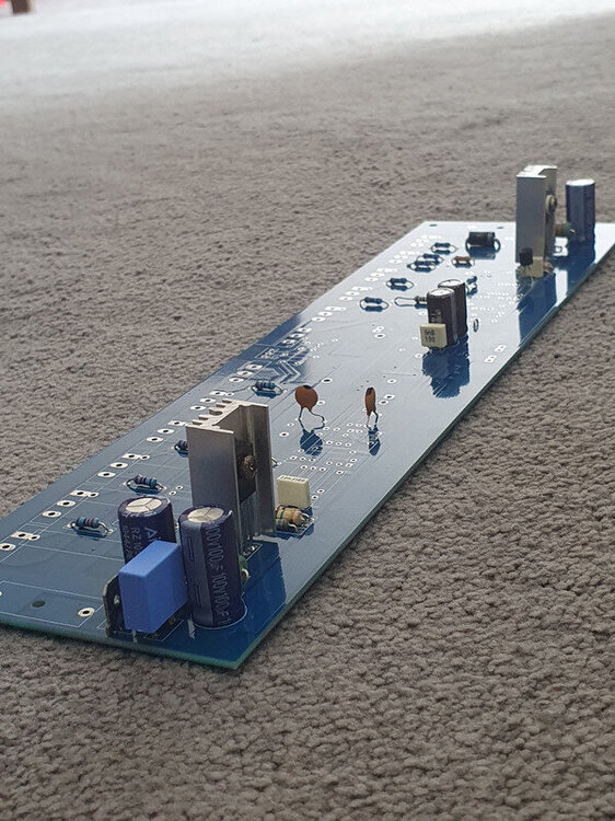

I know it's not a finished amp yet, but I'm just very happy that my leach superamp boards are almost stuffed, everything is closely matched also the capacitors.
Its actually the leach that got me hooked on hifi, as a young boy reading hifi magazines, soon I will own my own, Christmas comes early this year. 🙂

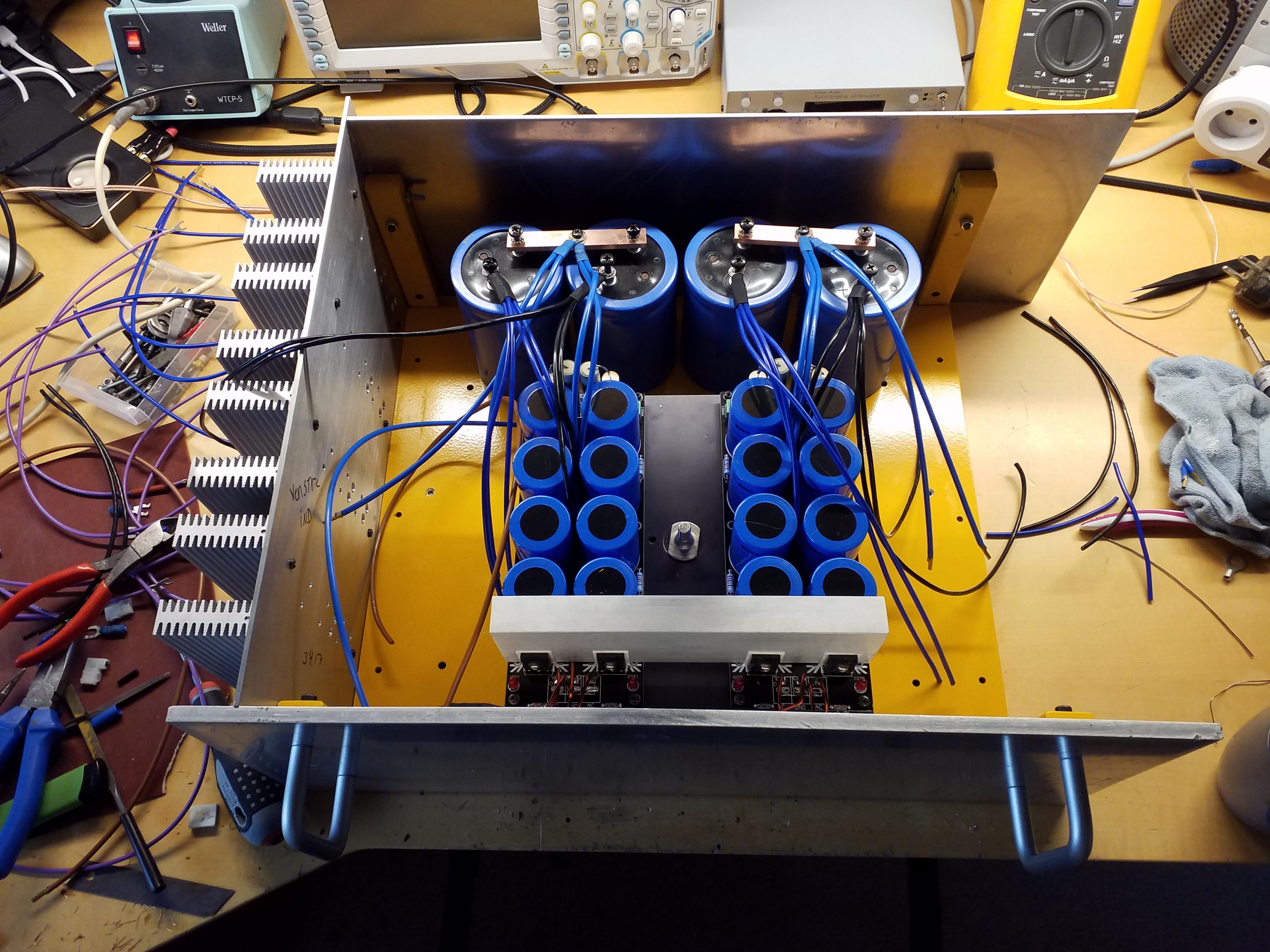

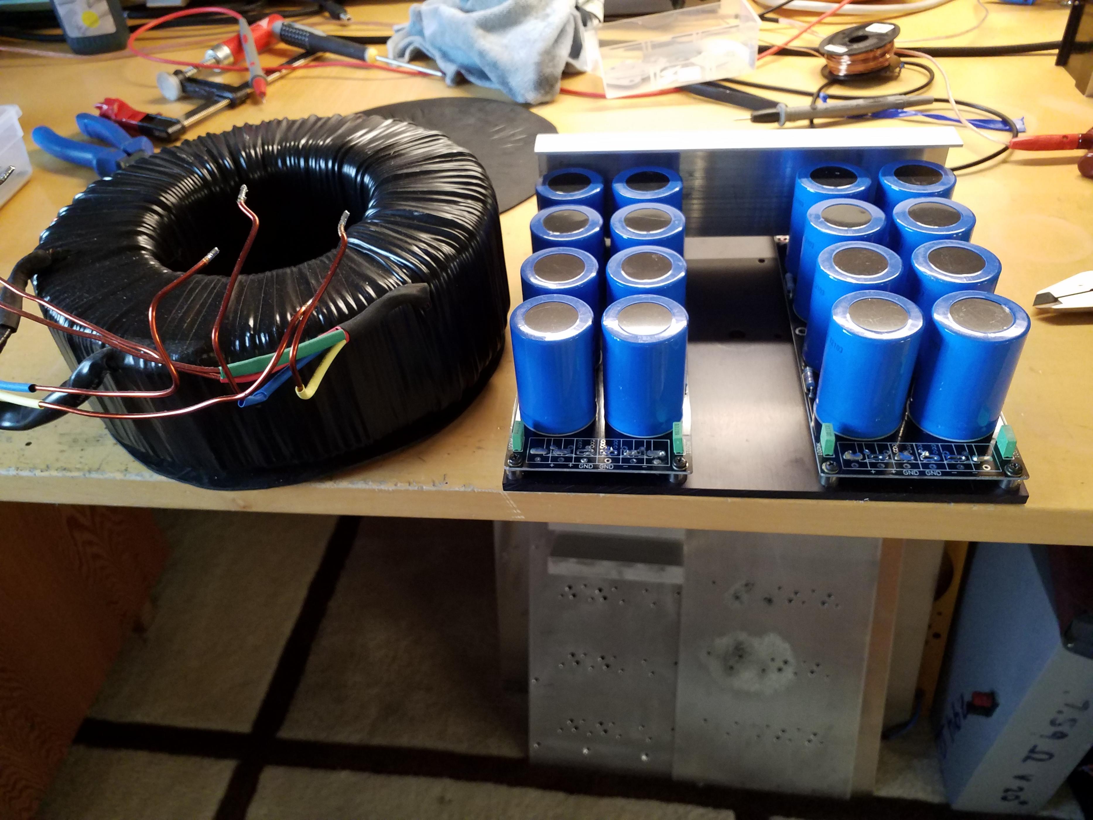

Today I finished most cabeling on my leach superamp, I dont see many new threads regarding this amplifier, I know it's an old design, but still, so I'm posting this pic to show progress and maybe get other diy enthusiasts building it, I believe it's still regarded as a reference amplifier even today.
Psu is +/÷ 67 volt 2kw toroid, and roughly 95000uf pr channel, all kept dual mono, I know psu is overkill, but wanted a stiff low ripple supply, and I have quite many large capacitors in stock that needs to be used

Leach is like Stasis - there were no high voltage transistors at the time - they had to use cascode. With the usual Leach less problems - also better stability. I still listen now and then to Leach amp - a real classic. Good luck with the project!
i think the transformer is under the capacitors....
Yes transformer is underneath the capacitor bank.
I'm glad to hear you still enjoy your leach amplifier oscar, the leach is what sparked my curiosity about hifi some 30 years ago, so now it's time to actually own one.
