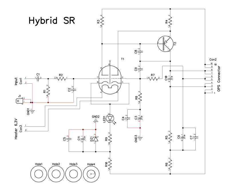

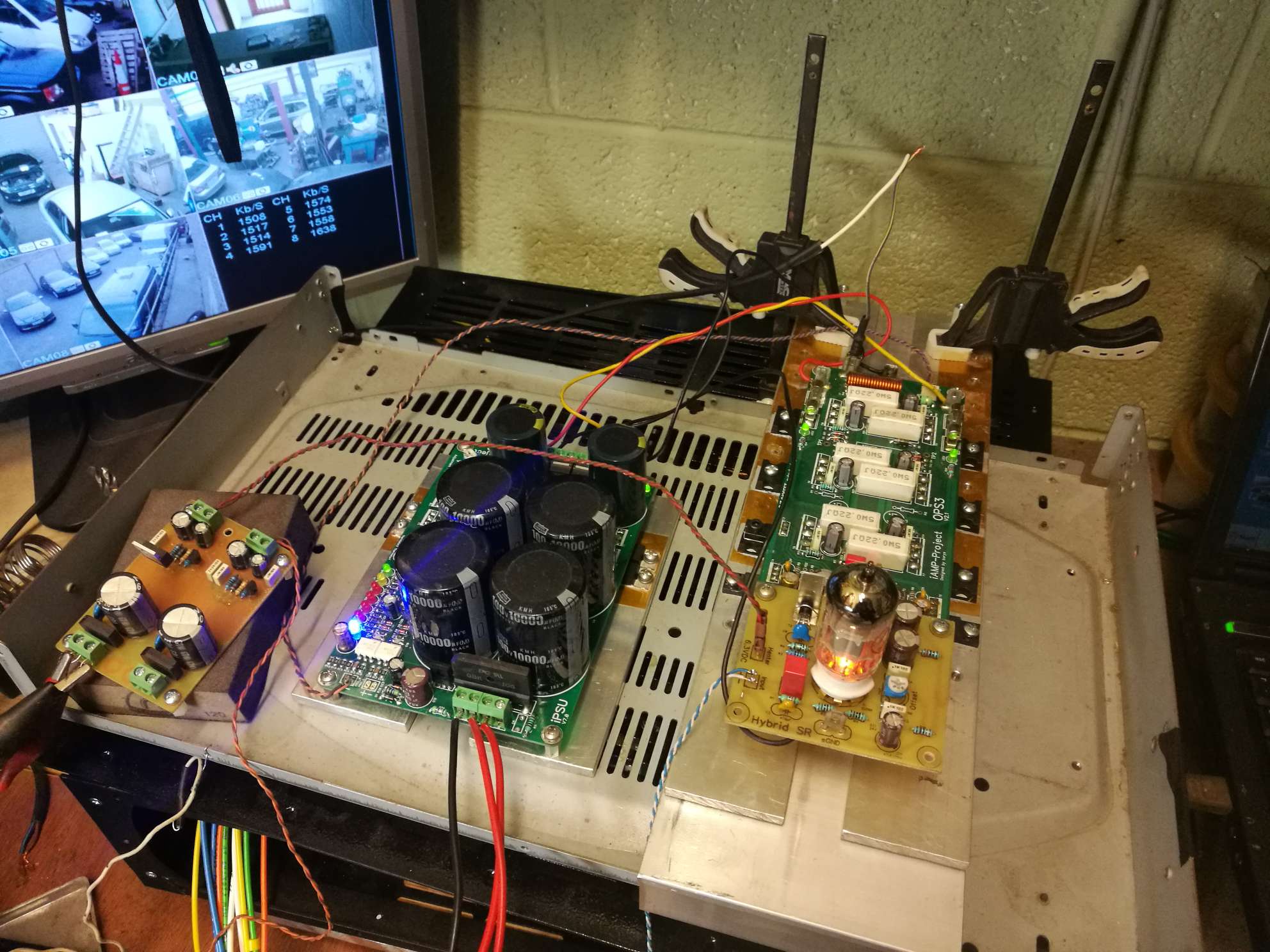

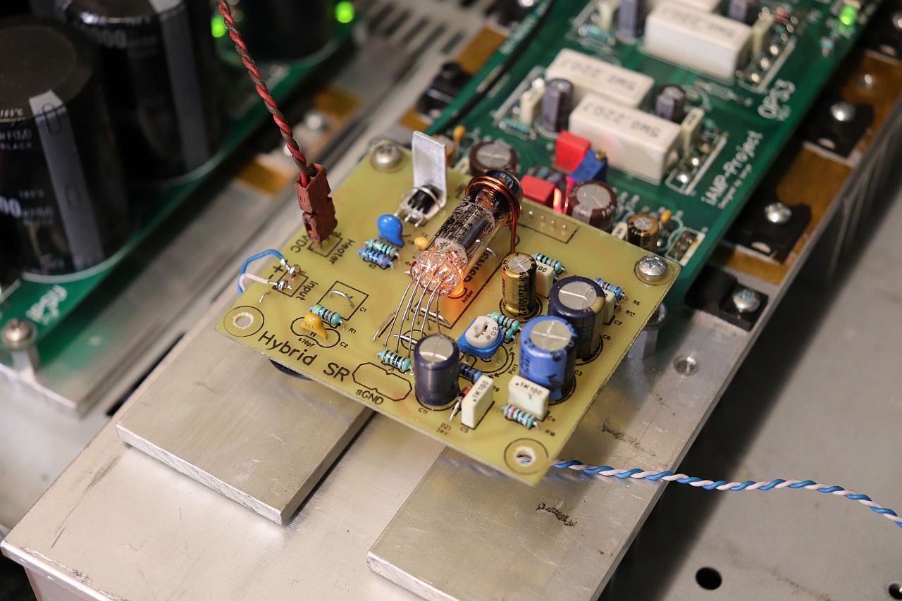

In some free time I have made a smallish input board. Just one transistor + one bulb setup. Needs a bit more work but works good. I do not need a lot of 0,00000x% to listen to the music anyway :D

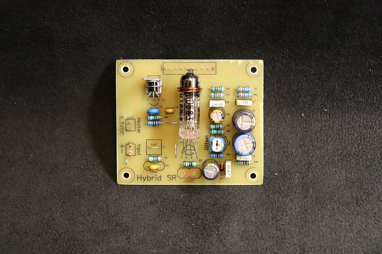

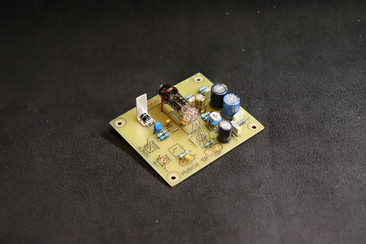

thimios
I couldn't sleep two days ago and had too much time for thinking so yes it is a new idea. I am just playing with some resistors values to get the best results. The thing is that with some ECC88 tubes it sounds quite bad but some other ones are playing really nice. Today I have made a small converter board for 6N16B tube.
Regards

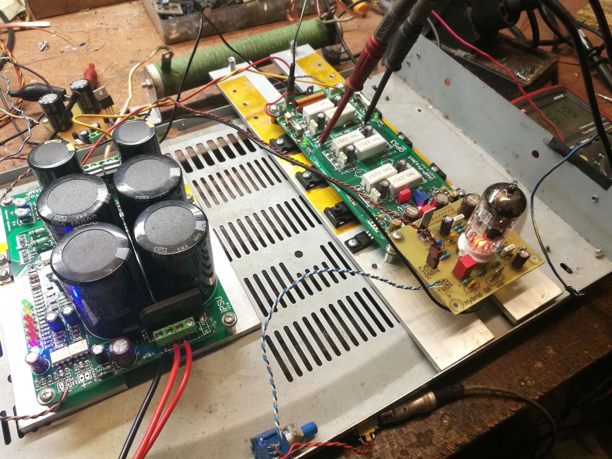

I don't have any better idea for a compact tube than 6N16B :(
But this one runs pretty well, right?
What rails voltage are you using?
Valery
6N16B runs really good in this circuit, voltage rail is 42VDC, grid at -0.8V bias approx 1.4mA per single triode.
thimios
Sound --> first impression, does not sound as valve amp anyway. Good dynamics with powerfull bas kick, rather quick bass response with a bit thin body at the lowest Hz end.
Midlle are nice and clean. Top octave goes a bit forward and it looks like it is not so precise as transistor version of the amplifier. Overall i like it.
Regards
