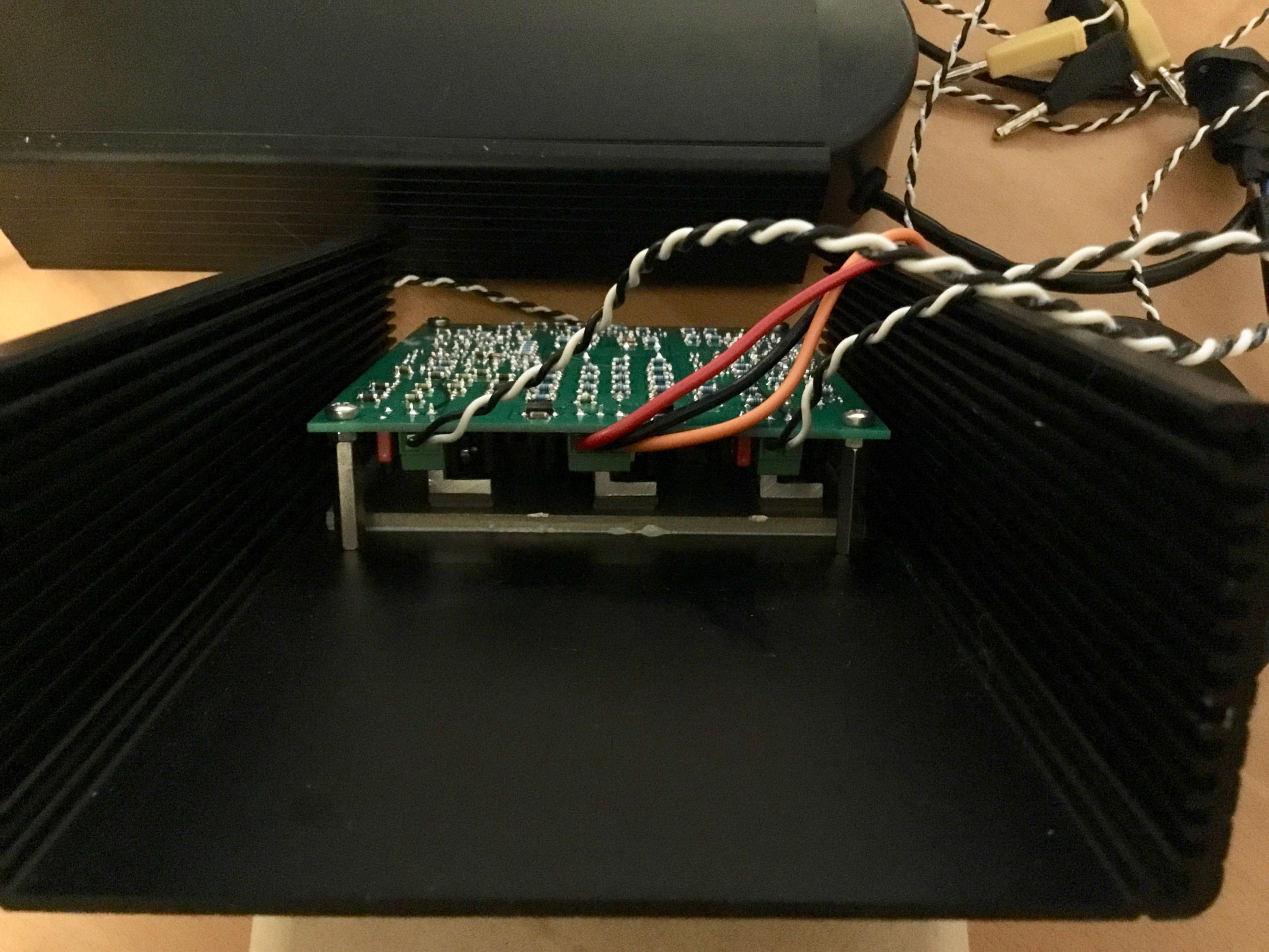

For the power amps, I’m mounting the PCBs upside down with a spreader plate glued into the case with thermally conductive epoxy to transfer heat from the transistor heatsinks to the case, and gap pads on top of the L-channel to transfer heat to the spreader plate. That works really well - the whole lot stays lovely and cool. Their cases are a tad bigger (220 x 125 x 50) to allow for a little 50VA toroidal.
I think I mentioned before that heatsinking for these things is rather fiddly.

Hi xrk971,
Also well thought out. You might want to blow that out after a few years in (intermittent) operation.
Most devices with forced air cooling don't even have a piece of foam for a filter. I have to blow out my computers every year for example. I'd much rather clean a foam filter out every few months. Too bad the case is run at negative pressure! Power supply fan pressurizes, case fan sucks the air out, drawing dust in from every opening. You just can't win.
