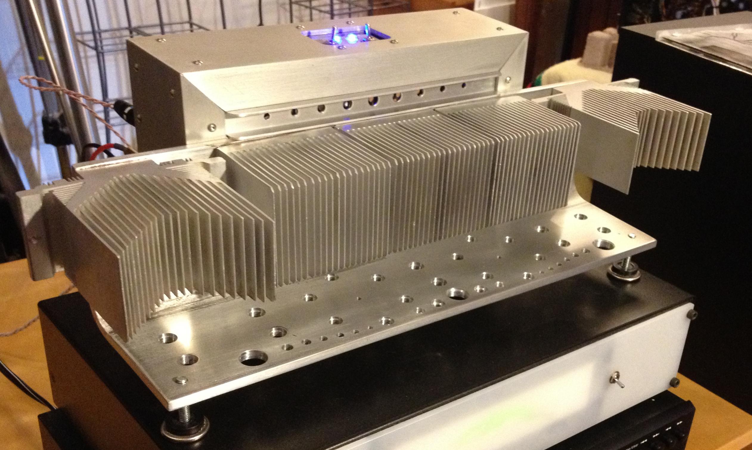

Maybe you won't like me posting something that is basically kit work but I gotta say, it's one super-fine, blow-your-mind, little kit: the Nelson Pass Amp Camp Amp.
This is not my first build, this was a test of my junkyard parts heat sink (it dissipates 62 Watts here, more than I'd hoped 🙂 but the darn little amp sings! Use it to get anyone you want hooked on good SS and soldering 😉

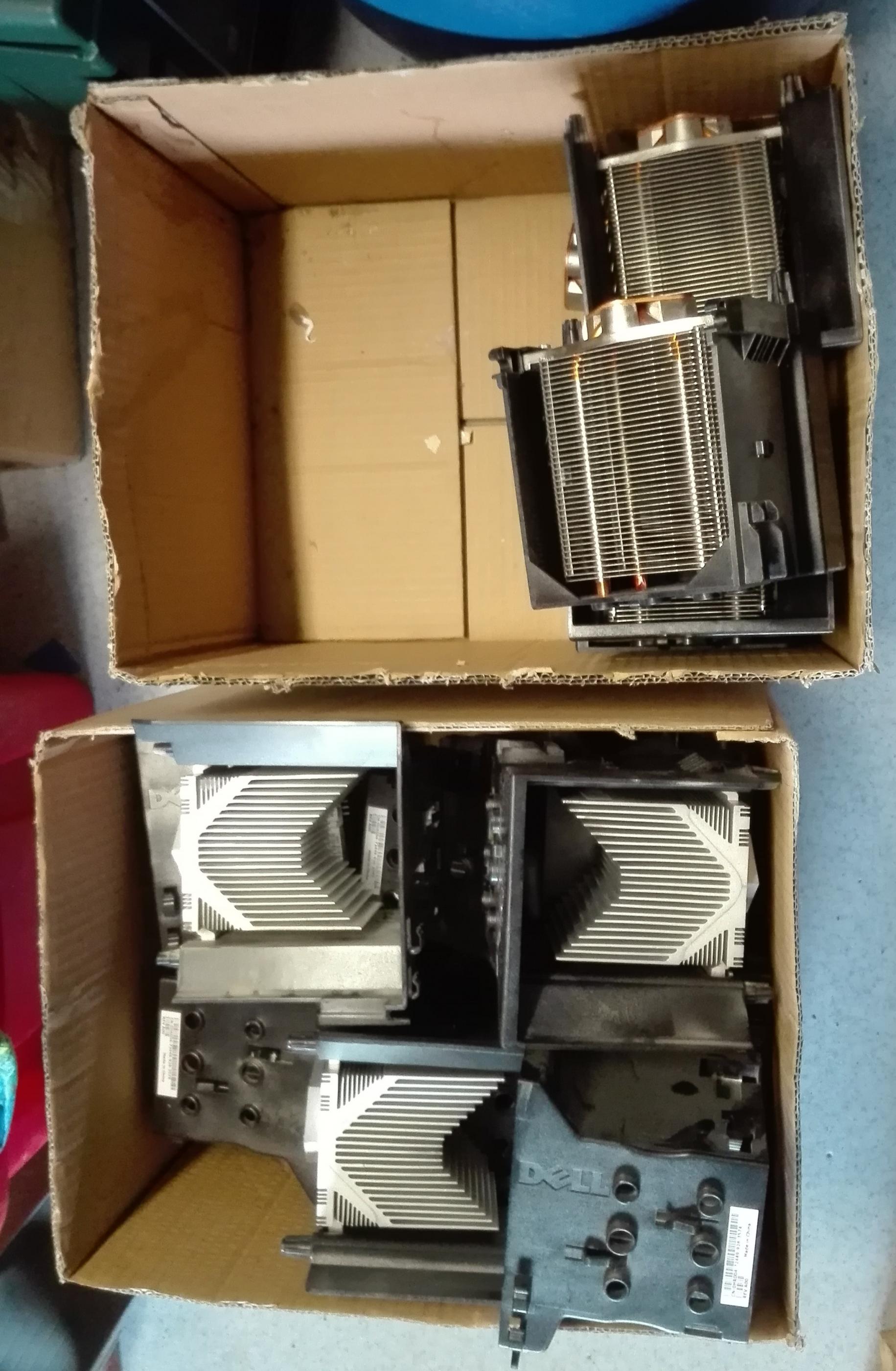

Im lucky enough to have a large metal recycler in my neck of the woods. Even had a guy there looking out for specific styles of heat sinks for a while.
The crab image, well I guess natural forms just get inside ones head. I never looked to nature for the form but it sure is there!

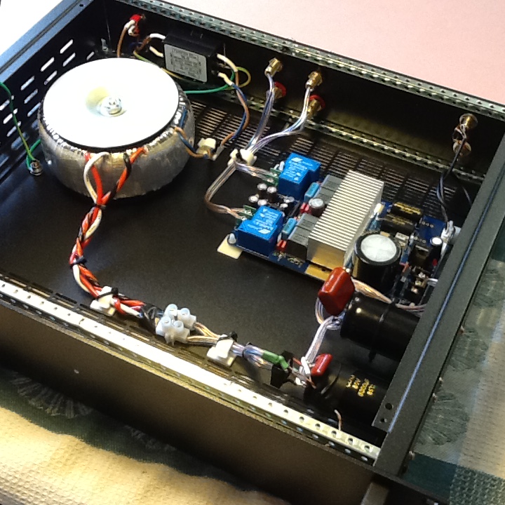

Finished my fifth Tripath T4 Class D amp I have built. The other four sold. Seven Class Ds in all. This is the latest module from Hifimediy (V1.3). PS is rated 560W at 13A. The rec bridge is soldered directly to the the first cap for maximum current transfer. Filter caps snubbed with 0.01, 0.1 and 10uf polies. Tranni is 500VA. Amp can deliver 180Wpc at 0.01% THD. I'm calling this one
"The Ghost". It is uterly transparent.

Nice neat clean wiring. Great craftsmanship there.
But this is solid state class AB forum and amp is class D. I suppose it is "solid state". Is the amp based. Isn't PSU overkill if amp is 180w?
