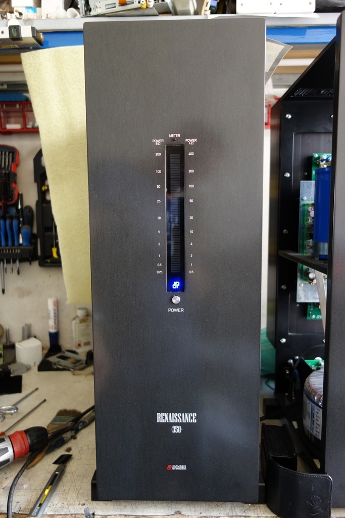

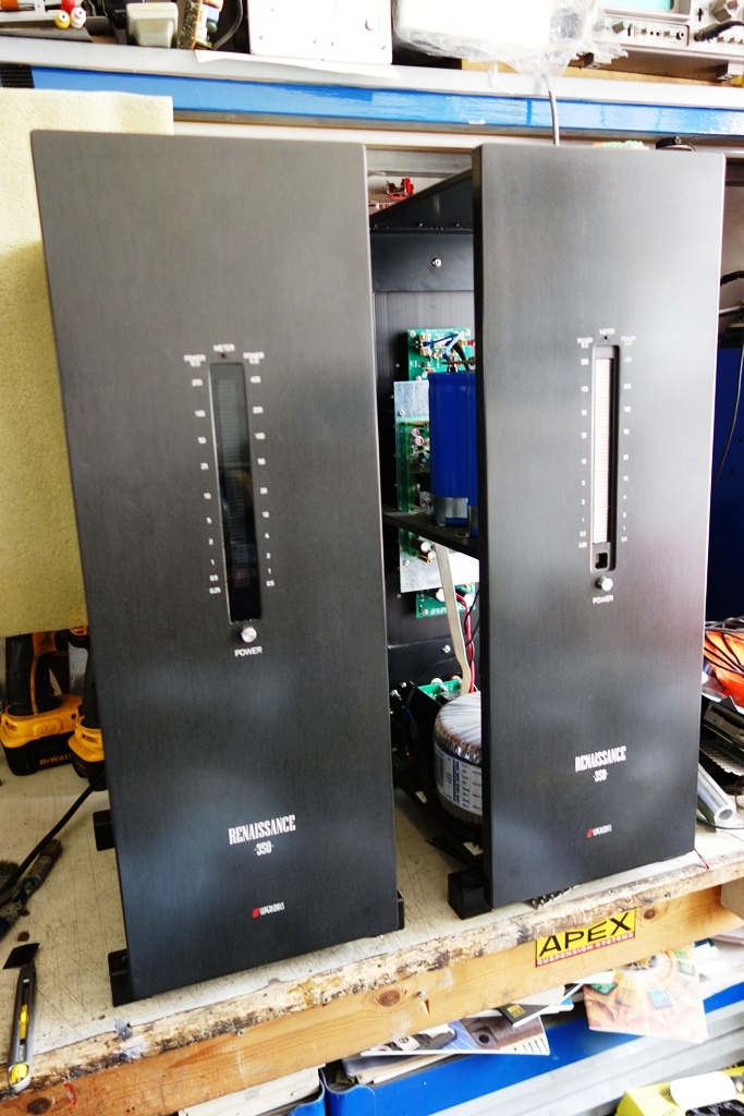

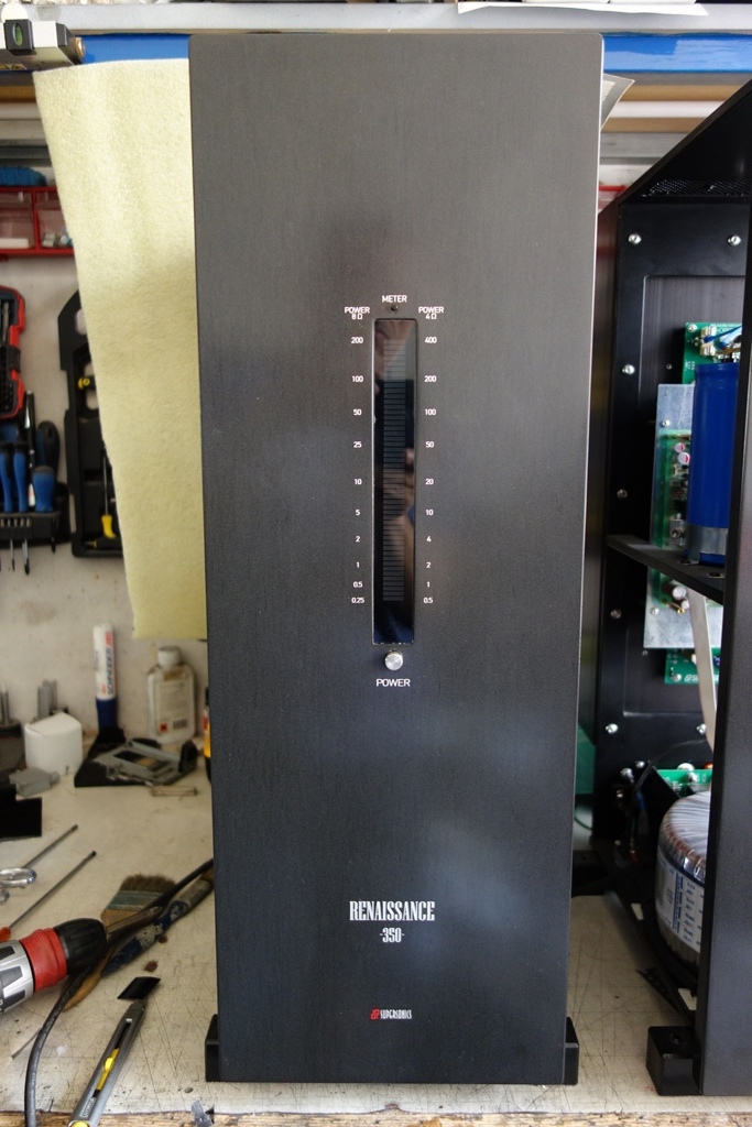

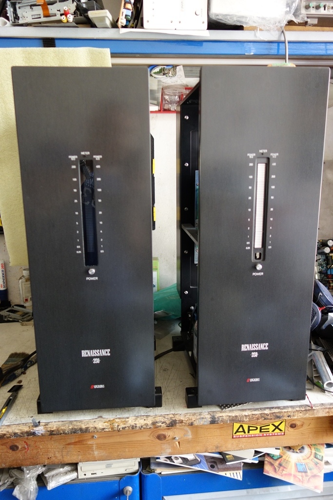

Danish sun in Vietnam, I make up from B&O Pentalab

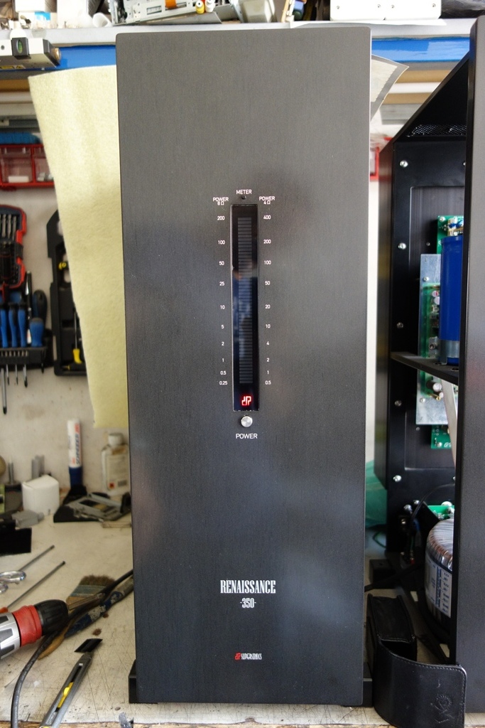

OK, I'll let you see from the other side. Thank
Beautiful!!
Looks to be a powerhouse! 8 pairs of output devices? Beefy power supply and I see you used very high quality square bridges (fast with soft recovery) and very expensive too! What are the amplifier specs?
Do
190Wrms@8Ω first25W@class A
340Wrms@4Ω
1,2KVA 4X56000μF 2bridges(f-s)
highest standards specs components used
no money compromise!
340Wrms@4Ω
Hi venar,
Beautiful work! I can see these as a commercial product, not a DIY effort.
Are these a DIY amplifier talked about on this site, or your own design?

So have measured your heat sink temps top and bottom?
Personal experience with heavy class A did not get me even temps From the bottom of the output mountings to the top section
AB might
Love that kind of look if it works out overall
Regards
David
AB might
Regards
David
It has many slots for exhaust heat.So have measured your heat sink temps top and bottom?
AB might
Regards
David
Thats good, but doesnt really affect the heat generating area that much or even out the cooling fin temps outside
Heat rises, and its nearly impossible to keep the top fin area as cool and thus you get an imbalance of temps right at the output trannies

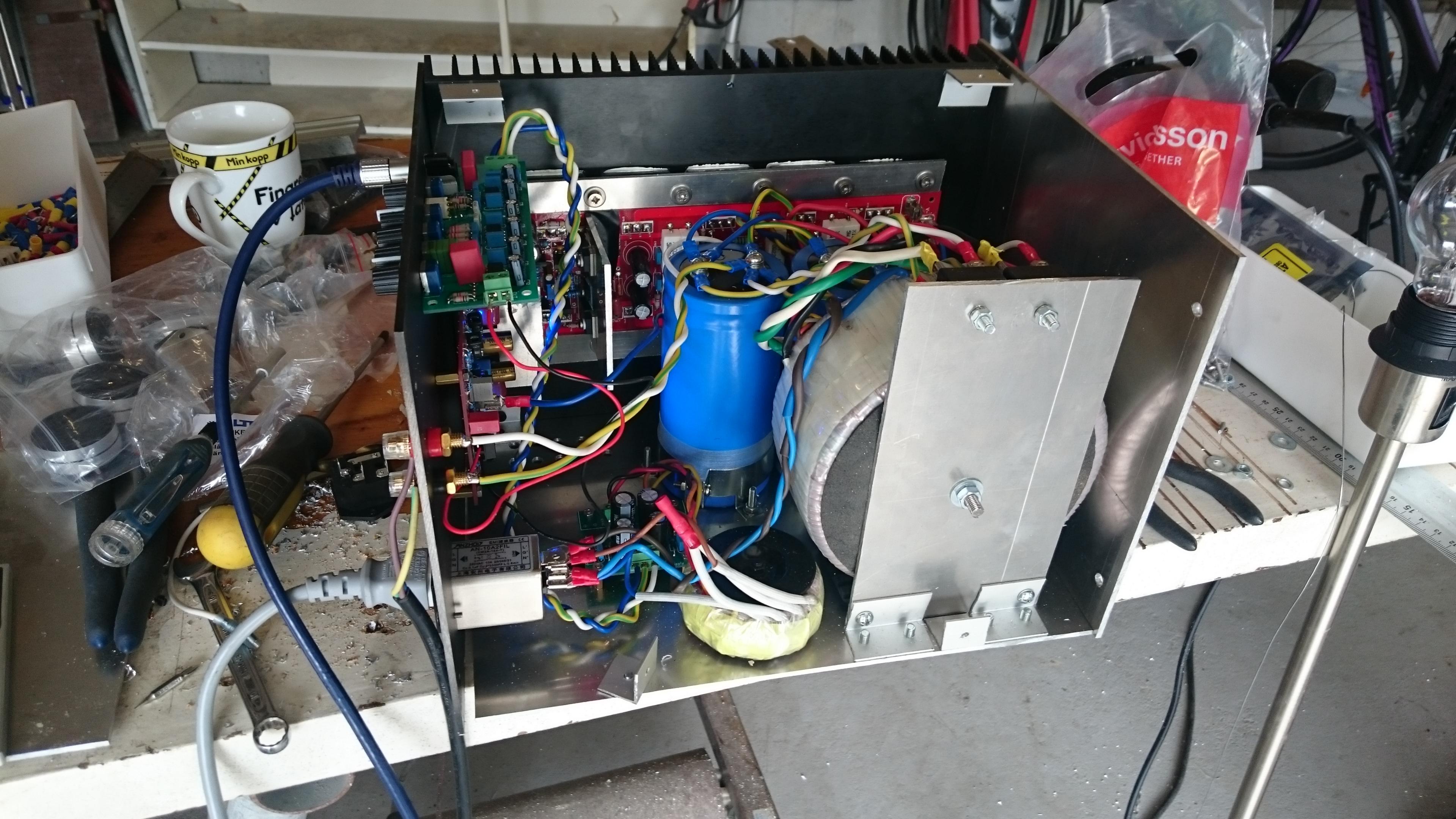

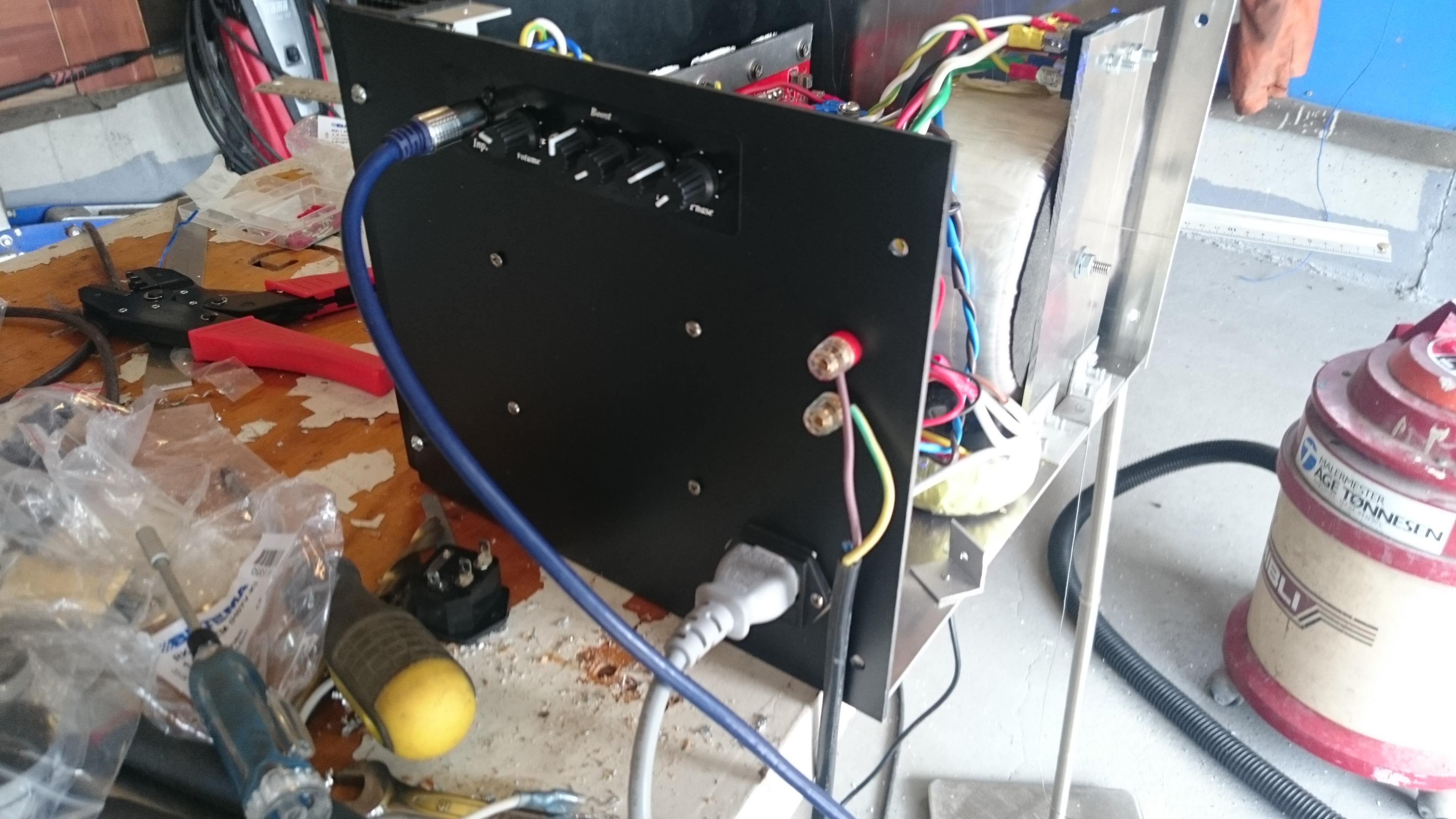

Amaco and Venar, awesome work!
I'm almost embarrased to post my latest build after these.
Here's one of my two monoblocks almost finished.
5p sanken slewmaster with spooky IPS, 2x39000uF caps and 800va transformers.70v rails.
