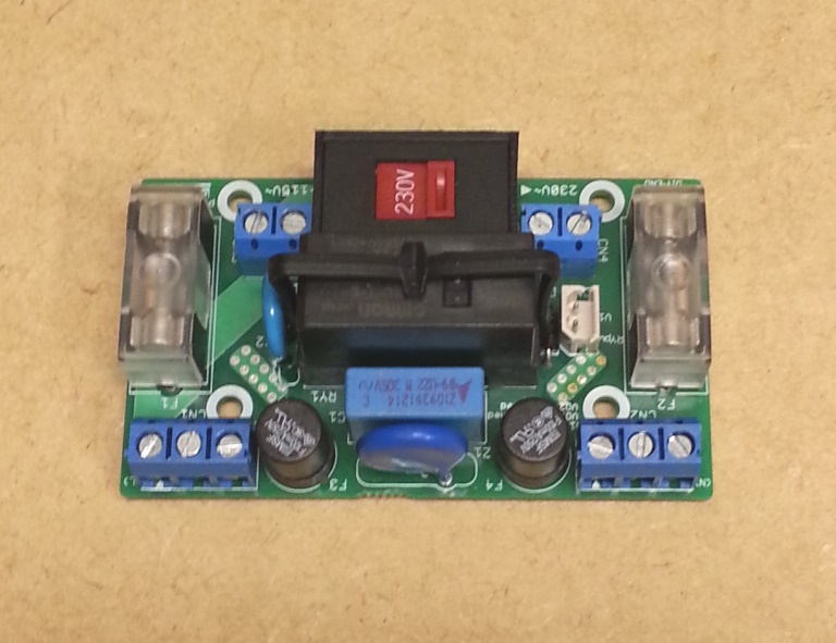

@Kaplaars

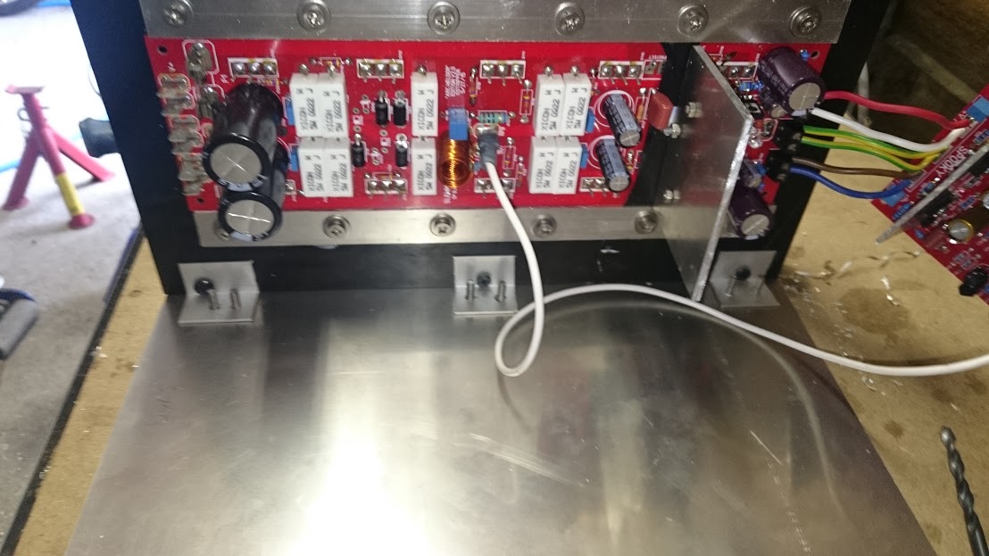

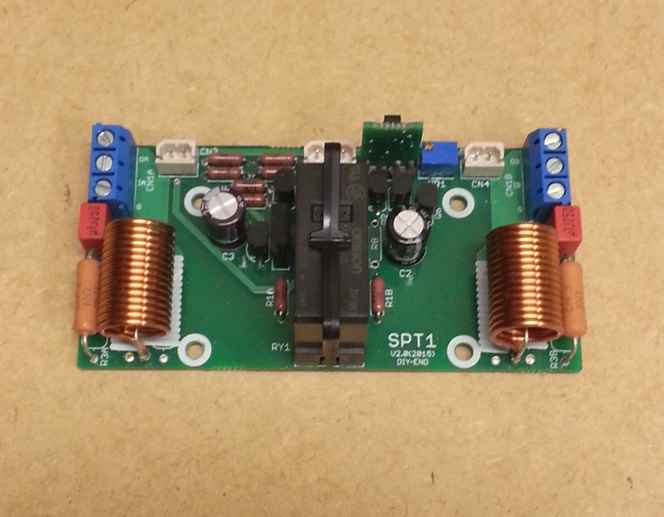

I might be mistaken but it seems as if you added a DC protection board while the amplifier already has relays for DC protection?
Thanks people!!! 😀
@Gideon, there is indeed a dedicated external DC protection circuit. Those relays on the main PCB are not dedicated for DC detection, but are energized via a delay circuit when it is powered on (controlled by CD4020). This way you do not get those power on 'spikes'. Thus I followed the advice of P-A: "Most users rely on internal protection circuits but I've added a separate protection against DC voltage on the amplifier output using an output relay with a protection circuit." Better safe than sorried eh, this thing has to last a lifetime! 😀
In addition there is another relay on the main PCB that I could use for switching it into standby. It would be cool if I could think of something via a remote control, but that is for later 🙂.

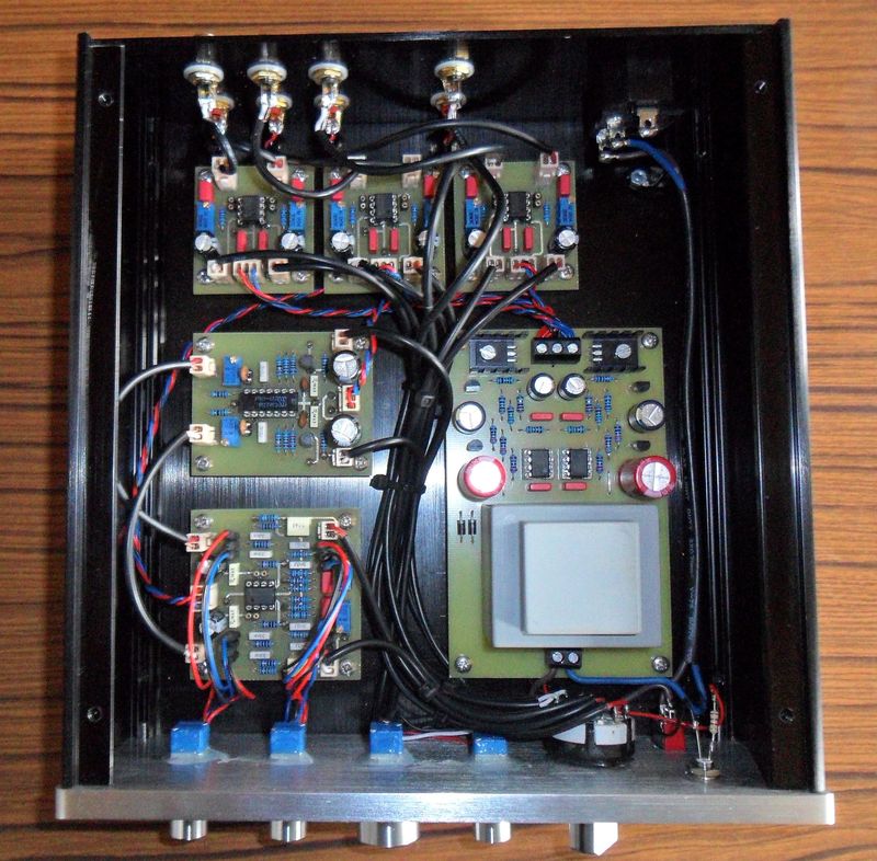

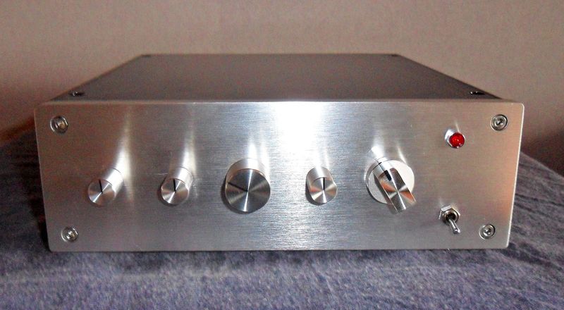

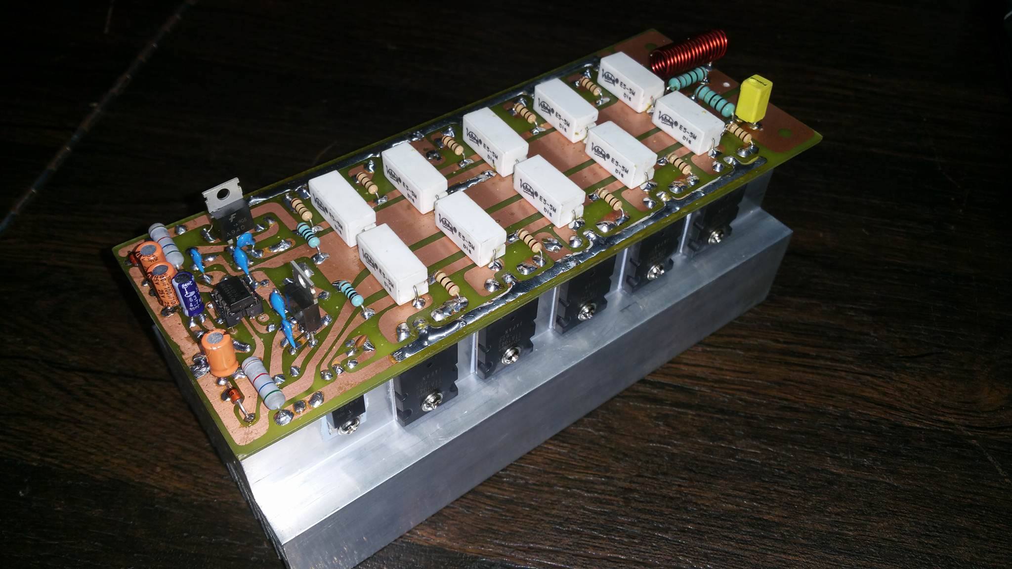

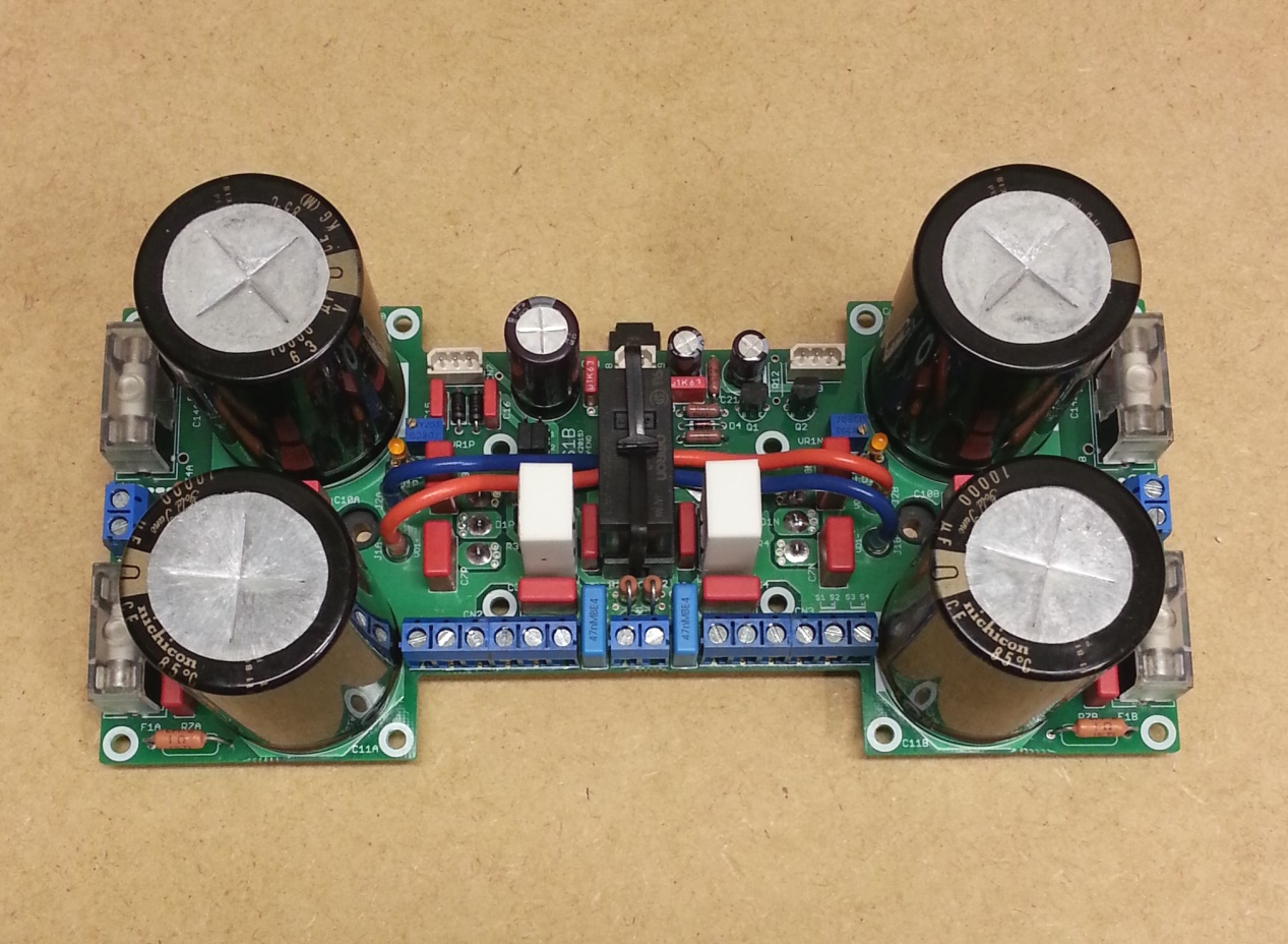

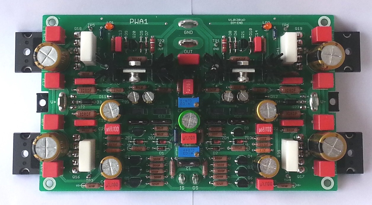

Looks wonderful, Project 16. The circuit boards appear to be home made with care and attention to detail. Do you have schematics to share, and may I ask where you got the case from?
Ranchu32 thank you!
Yes cards are designed and made by me. I think AOP better than NE5532 must provide more.
I'll make an archive with original articles (in French) and my files (pdf, gerbers, etc ...) and send it to you as soon as possible.
I took the case here:
Botier DIY aluminium Noir pour amplificateur 215x228x70mm - Audiophonics

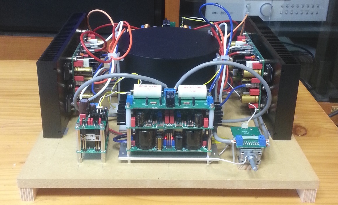

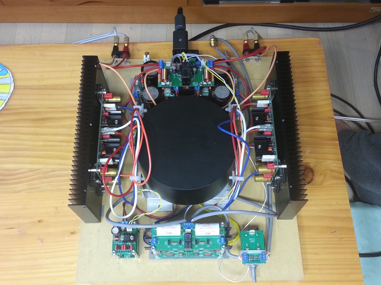

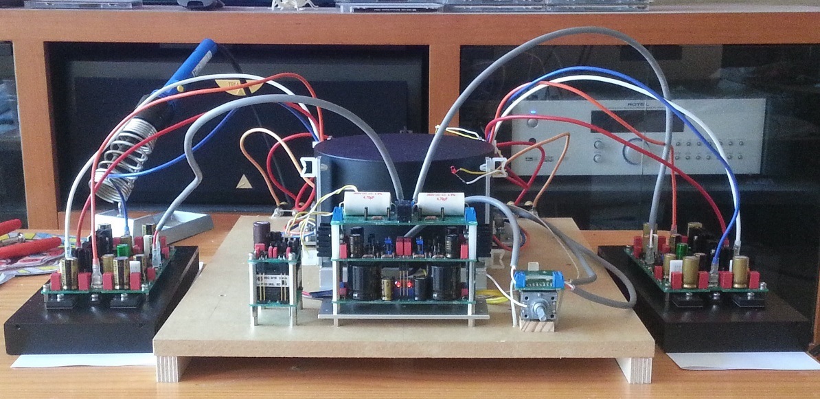

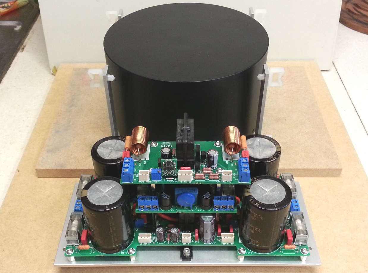

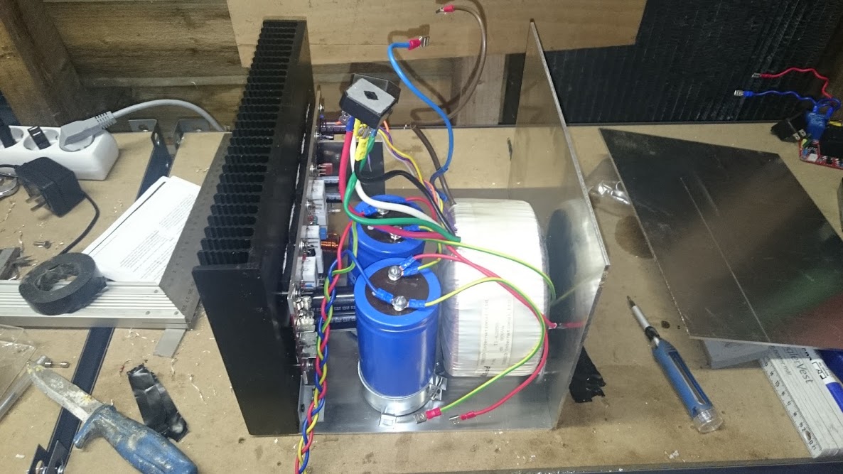

Reference-class integrated amplifier named "A1"
Almost three years has been taken for planning, designing and completing building this amplifier. It is named "A1" as a reference-class integrated amplifier delivering 100W per channel. The final work of casing still remains. However, I put together most of the modules making up the amplifier on a MDF board to listen to music.
The amplifier features as follows:
- a type of integrated amplifier made up of modules performing a specific function
- (not shown in the photo) operates as a power amplifier when the internal pre-amplifier is bypassed via a mode selecting switch
- the power amplifier module based on the Leach power amplifier acclaimed by amplifier DIYers all over the world, with the folowing additional improvements
> ON Semi's Thermaltrak transistors of NJL3281 and NJL1302 with built-in a bias diode instead of popular MJ15000 series transistors, which enable dynamic temperature compensation response, and stable and easier construction
> a circuit of DC offset adjustment added
> Ripple eater circuit for the power of the input stage to be affected less adversely by ripple of the output stage
- power on/off and volume adjustment by manual or remote control

The circuits for soft start and speaker protection are provied as well.
Its sequence is power on => soft start relay turning on in 2 seconds => speaker protection relay turning on in 3 seconds.
Transistors used are as follows;
Input stage - 2SA970-GR/2SC2240-GR by Toshiba, hfe of which is matched in pairs within 2%
Second stage for pre-drive and drive - 2SA970-GR/2SC2240-GR and 2SA1930/2SC5171 by Toshiba, hfe of which is matched in pairs within 3%
Output stage - NJL1302/NJL3281 by ON Semi
