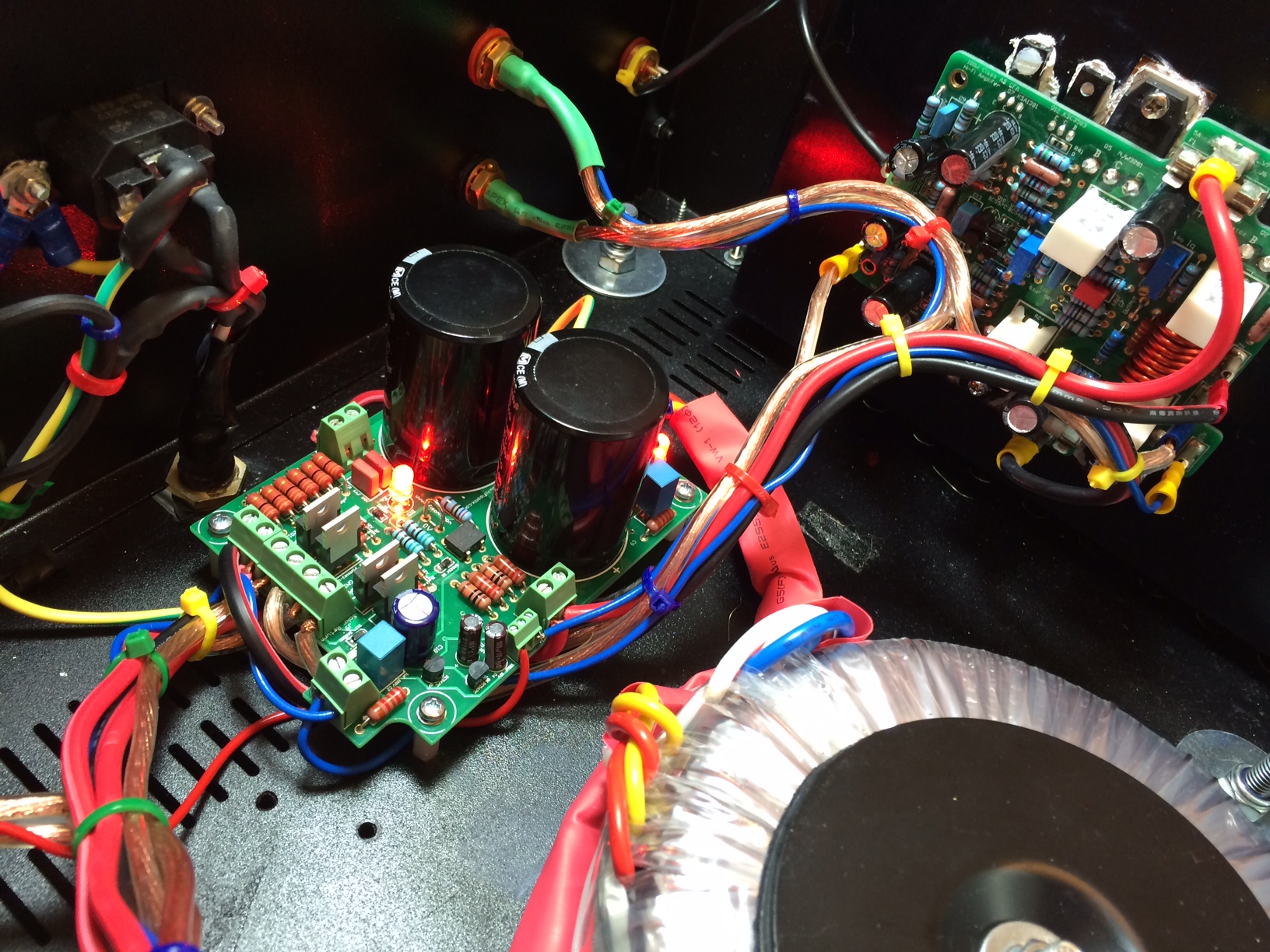

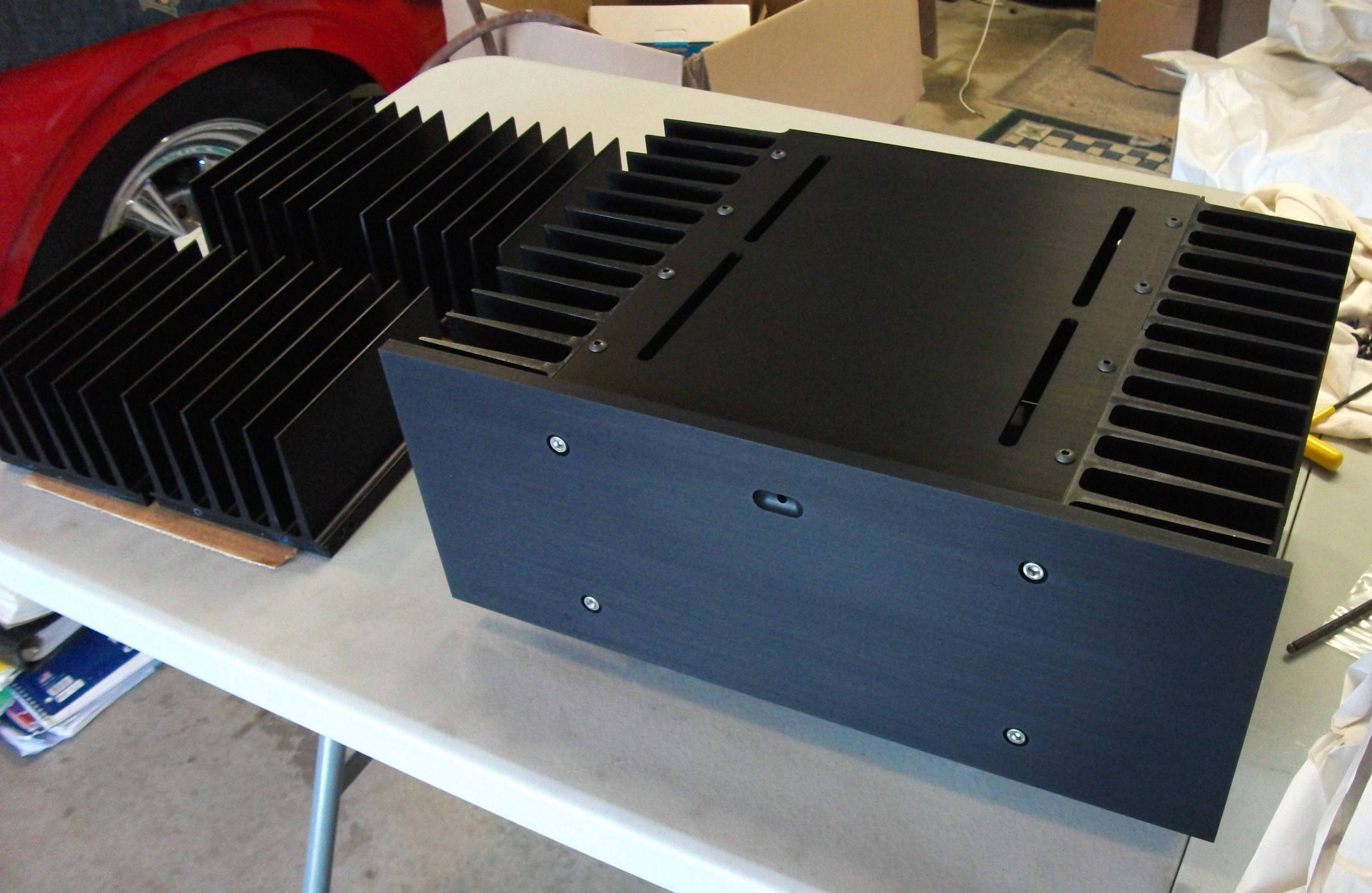

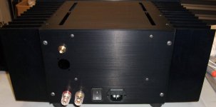

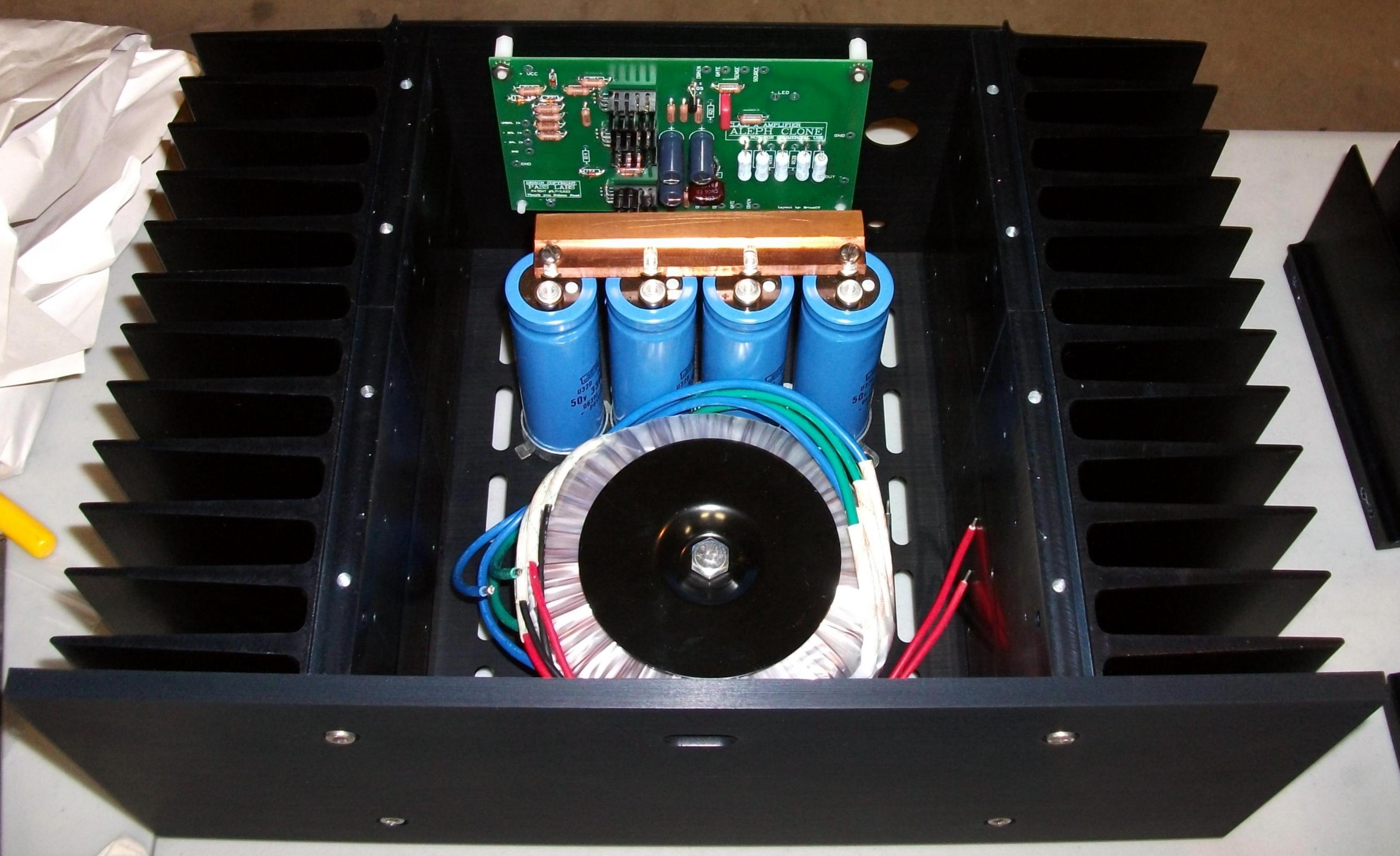

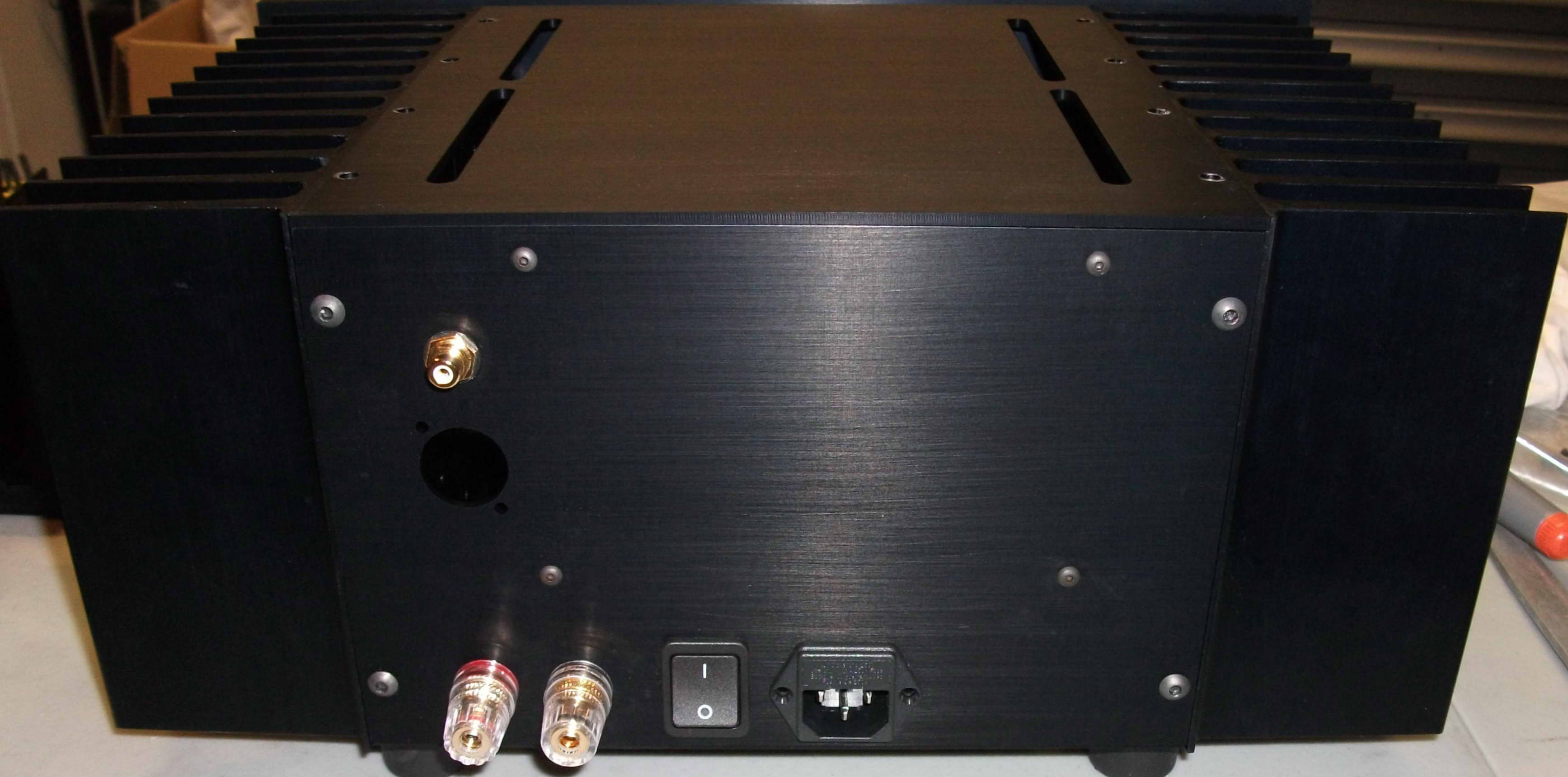

I've just finished assembling a second complete nx-Amp - these are the boards I bought from Jim's Audio on ebay.
The front end diamond buffer resistors on this build, on my original nx-amp build and on my sx-amp have all been increased to 150 Ohms/110 Ohms as detailed in the errata sheet under the nx-Amp build document on my website (NB 120 Ohms instead of 110 Ohms works just as well BTW).
On both nx-amp builds, the PSU +Protect boards have been modded per Bill_P's suggestion (thanks for that Bill!) and work flawlessly.
I've been playing Jack Johnson 'In Between Dreams' (nice crisp recording with fantastic bass and recording space, Paul Simon 'Rhythm of the Saints' which has some incredible, spacey percussion and now playing Diana Krall 'Quiet Nights' - always great recordings with feathery strings.
Both Amps biased up for 320mA total supply current - so OPS sitting at about 130-140mA each (yes, about 100mA more than Doug would recommend).
I am extremely pleased with the result - great bass and mid with very clean an open high end.
:cool:

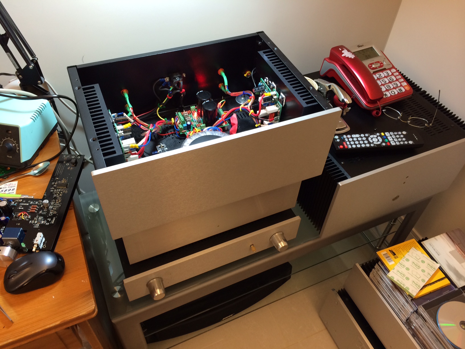

I just completed the bench testing and burn-in on the second amplifier last night. I was able to move them into my listening room and have a brief listen. So far I am quite pleased. I may have to tweek on the AC current gain a bit to see what the results are, but overall very good sounding.
