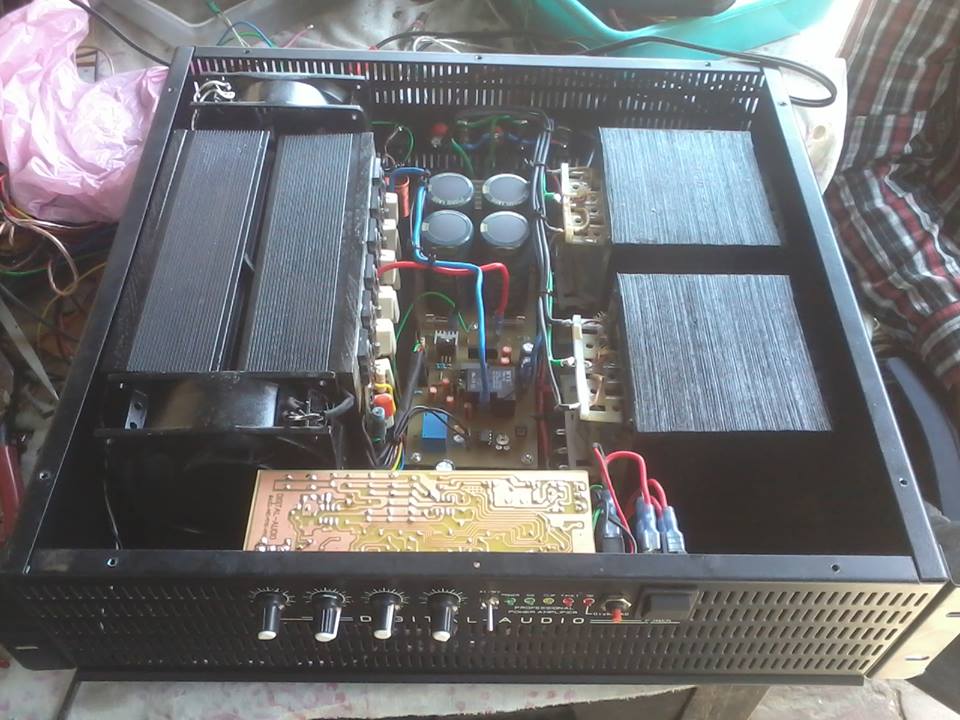

could you inform me with some information about your transformer?AB class mono amp with all protection
warm regards
andrew
v2=?
I=?
Hi Soheil95
greetings transformer secondary AC 65 O 65 2 transformers in parallel 2 50 ampere bridge rectifiers parallel
warm regards
Andrew
warm regards
Andrew
