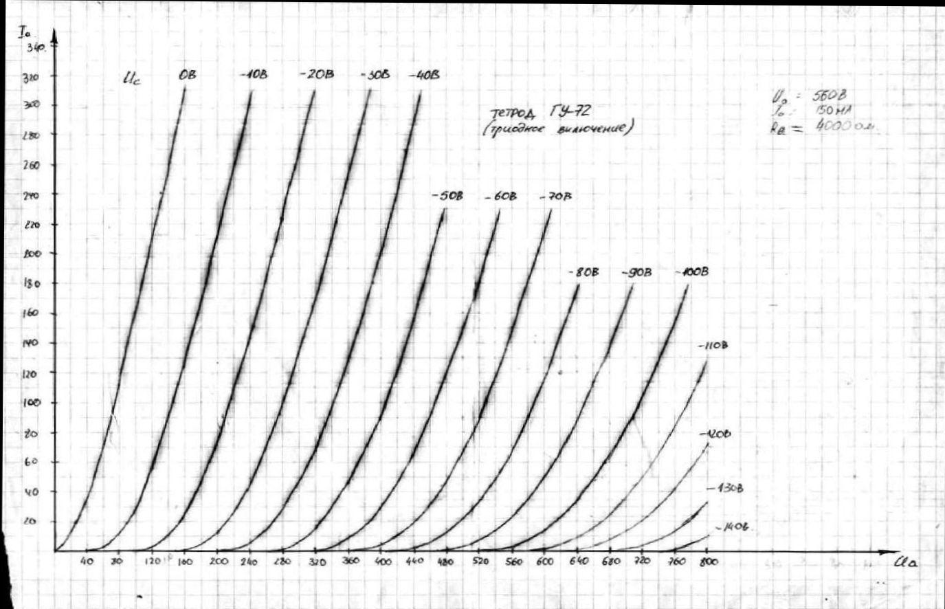

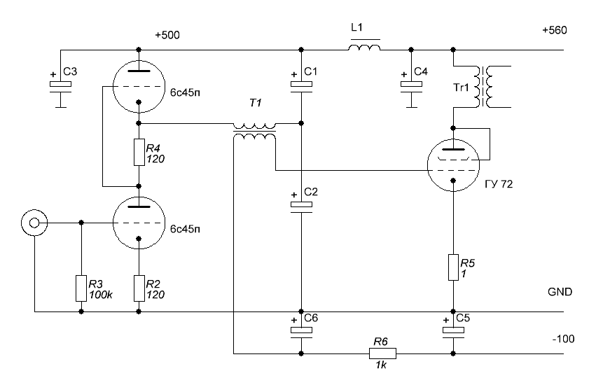

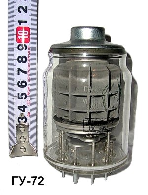

I thought of monoblocks on GU-72
For now it is necessary to complete some amplifiers for friends. 8W and 30W

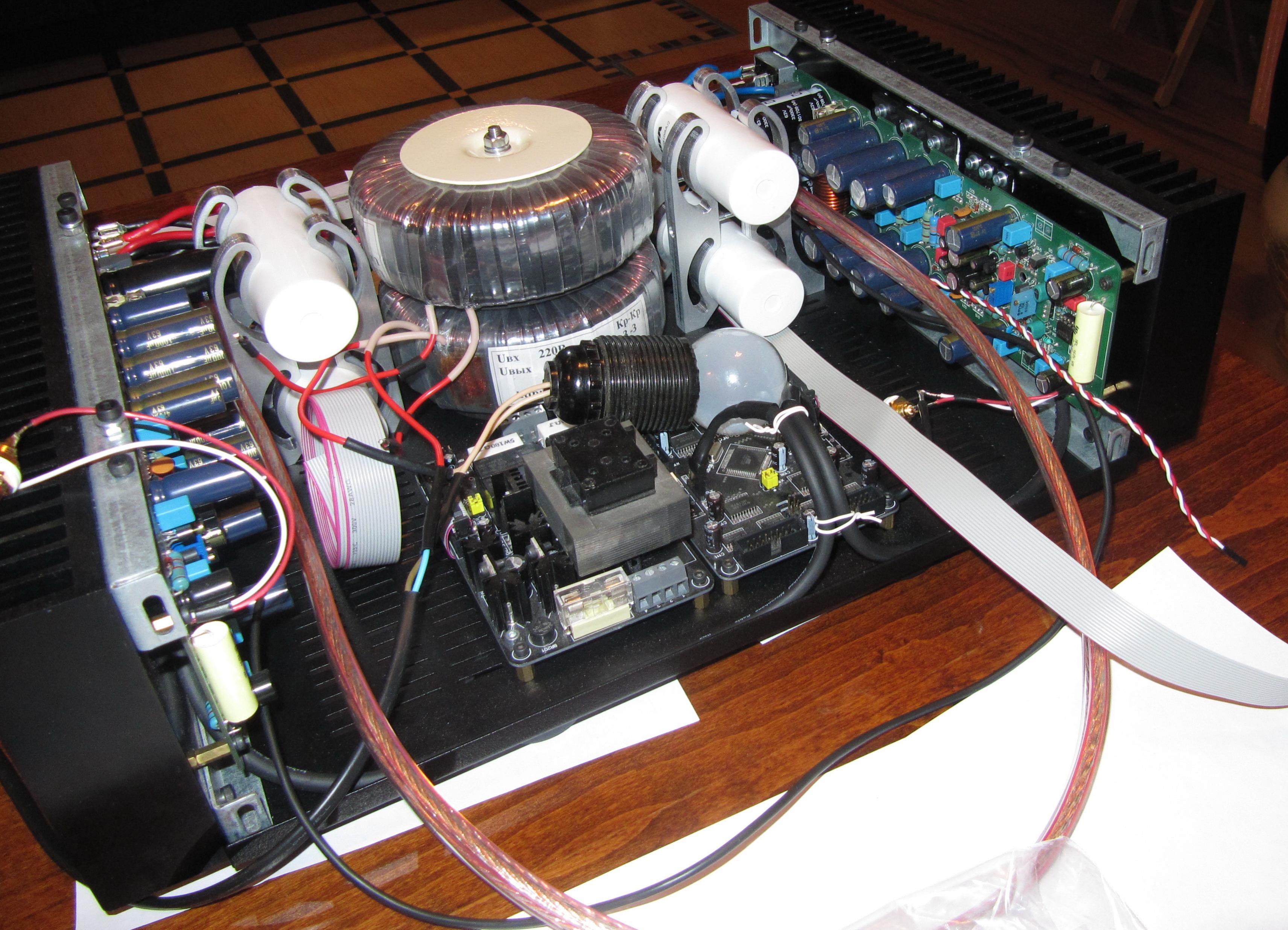

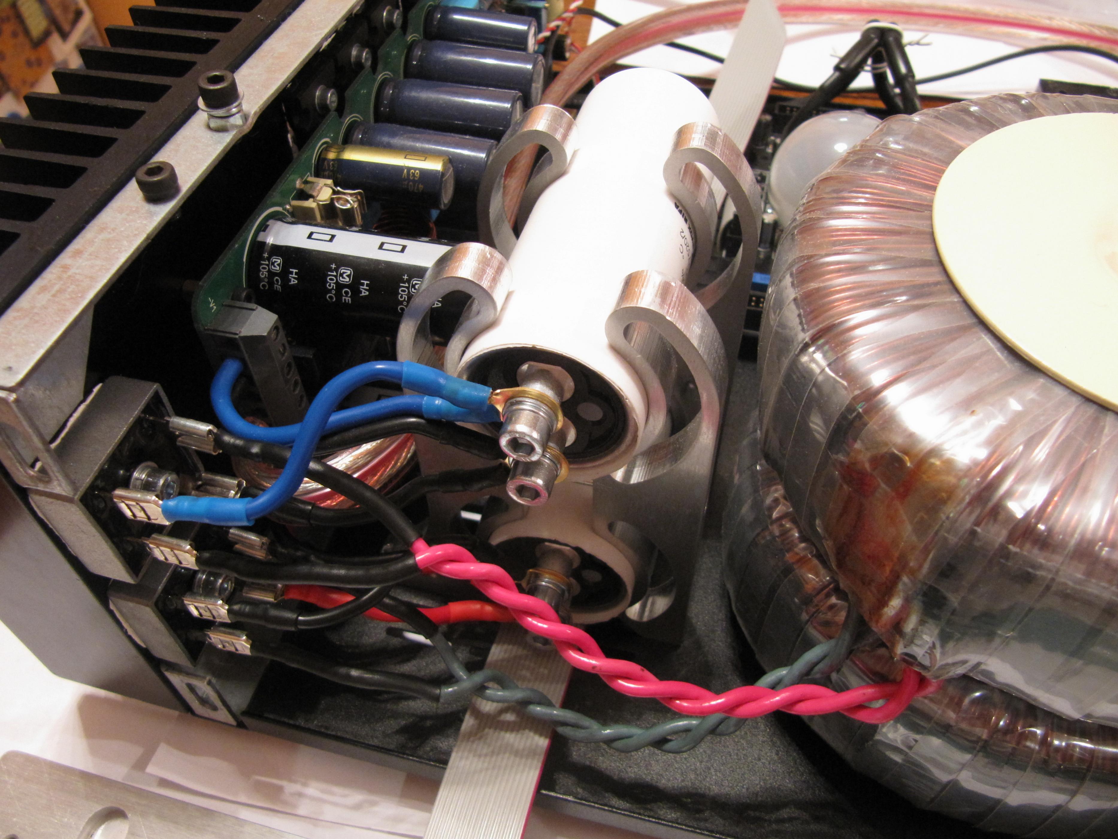

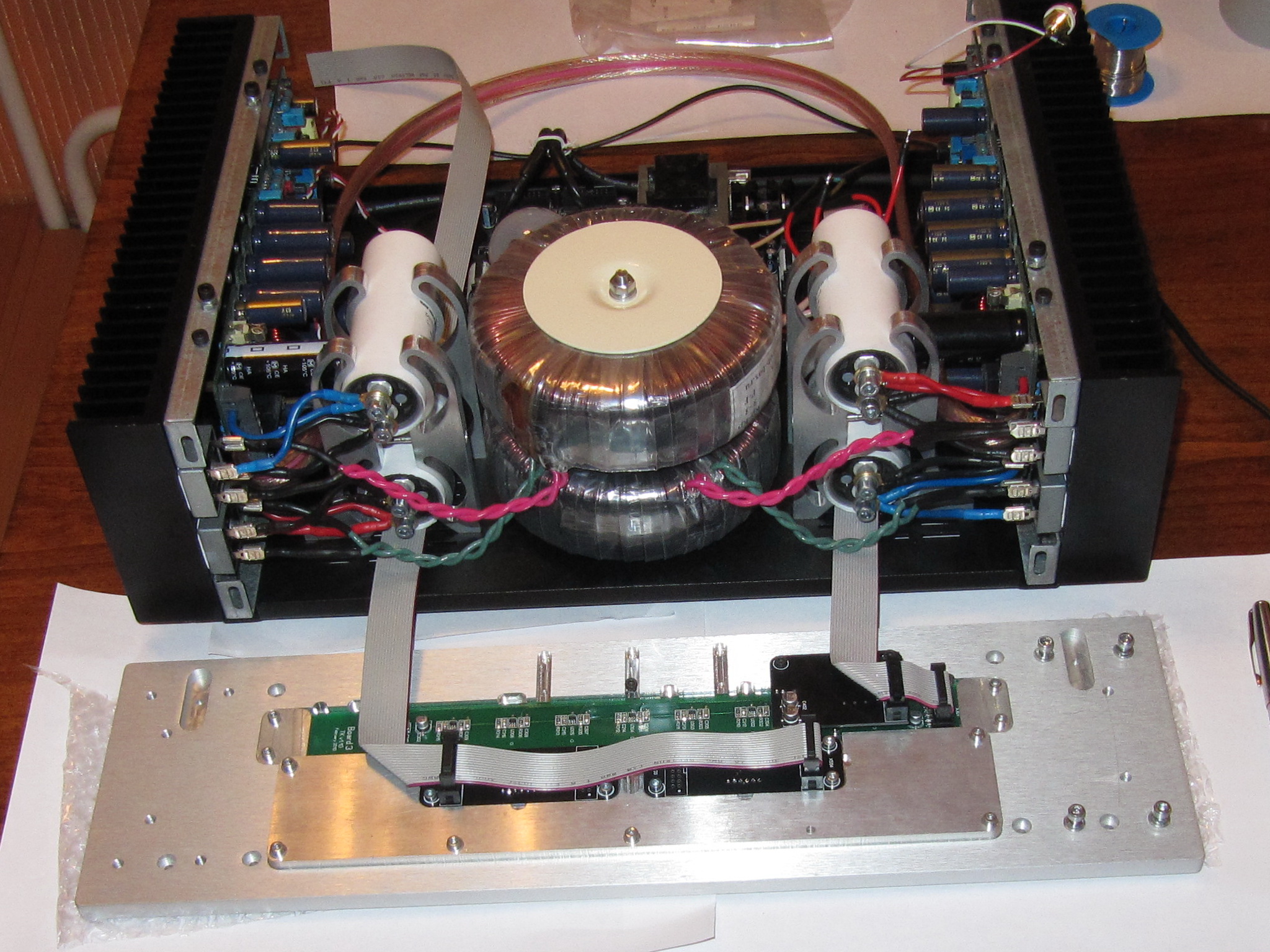

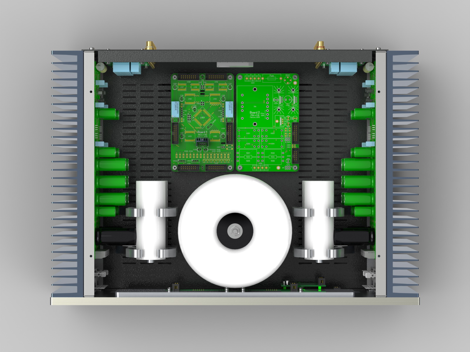

Hi all!
My last project at assembling: 2x200 @ 4 Ohm in AB class, dual mono, with MCU system (DC and temp. protection, 128dB relay attenuator, LED display, IR receiver, soft-start and etc.).
I am trying at last 4 years finish this amp 🙁

Good build.

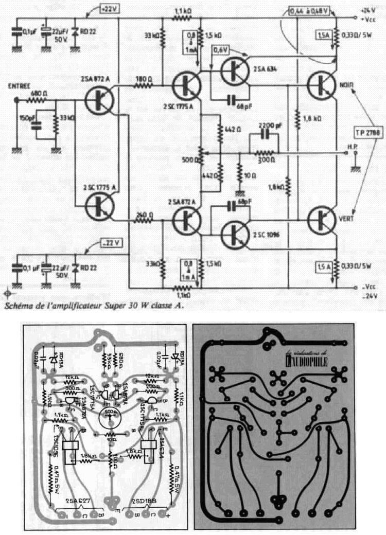

I was curious to do a spice simulation on this amp. Everyone who swears by it could be surprised at the actual performance.
I can say one thing: if using that schematic as a base, it requires some serious double-checking and attention, because it's full of mistakes and confusions.
I couldn't find all the right models, as most of the transistors are now obsolete, so I used others that should work and tried to get it going. I had to change some values and correct mistakes to make it work. Perhaps the models are part of the issue, but I can't see any performance worth mentioning. We can get much better with a class ab amp. class a is supposed to be very low distortion, but that's really not the case, very far from it.

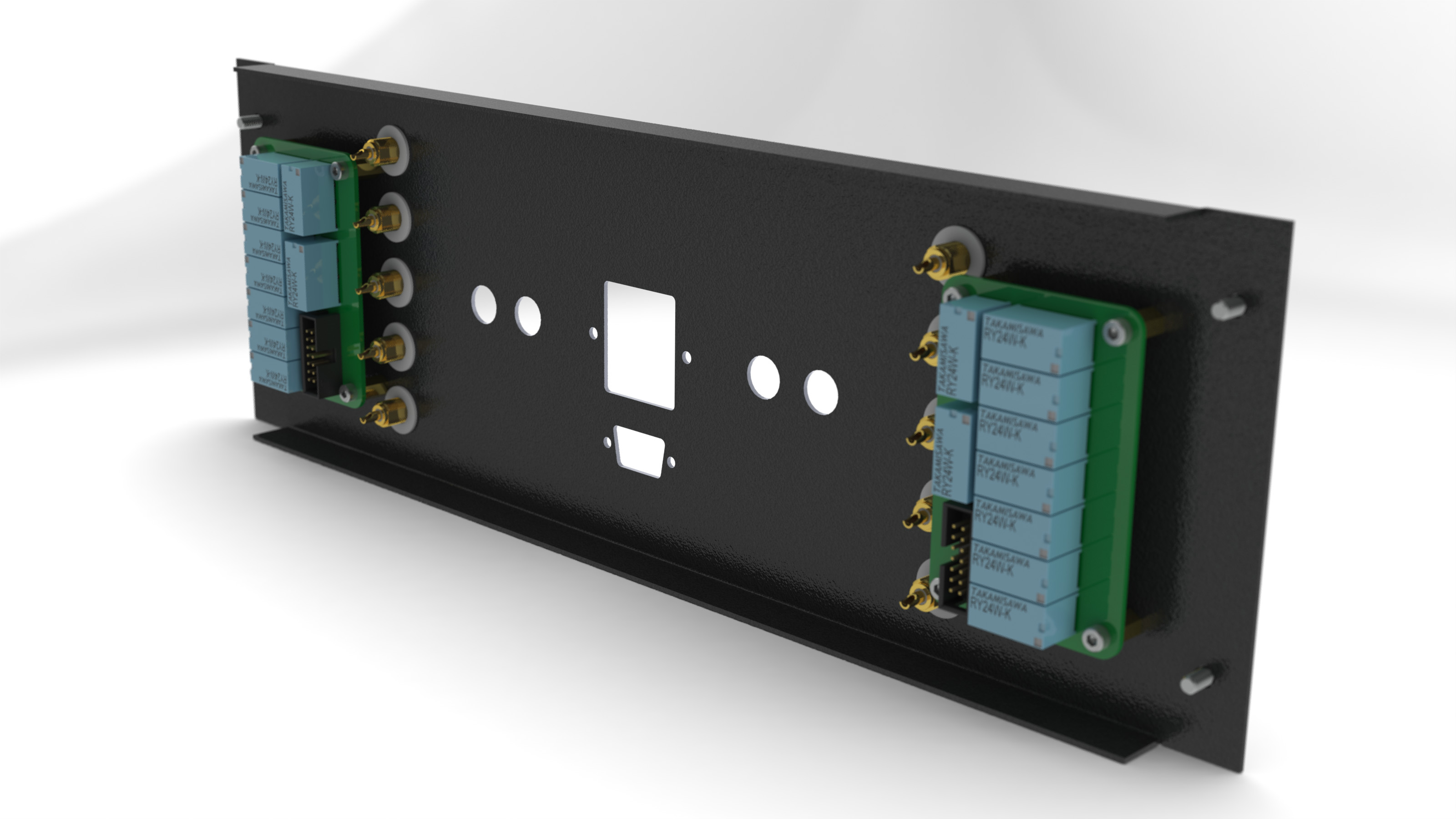

Hi all!

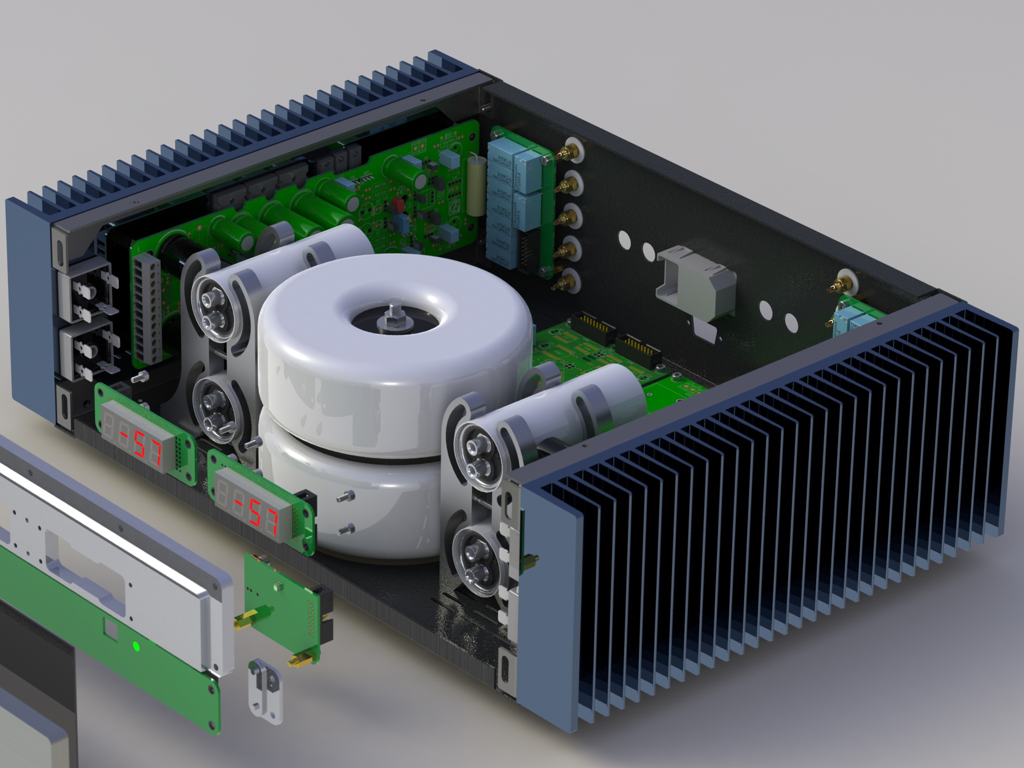

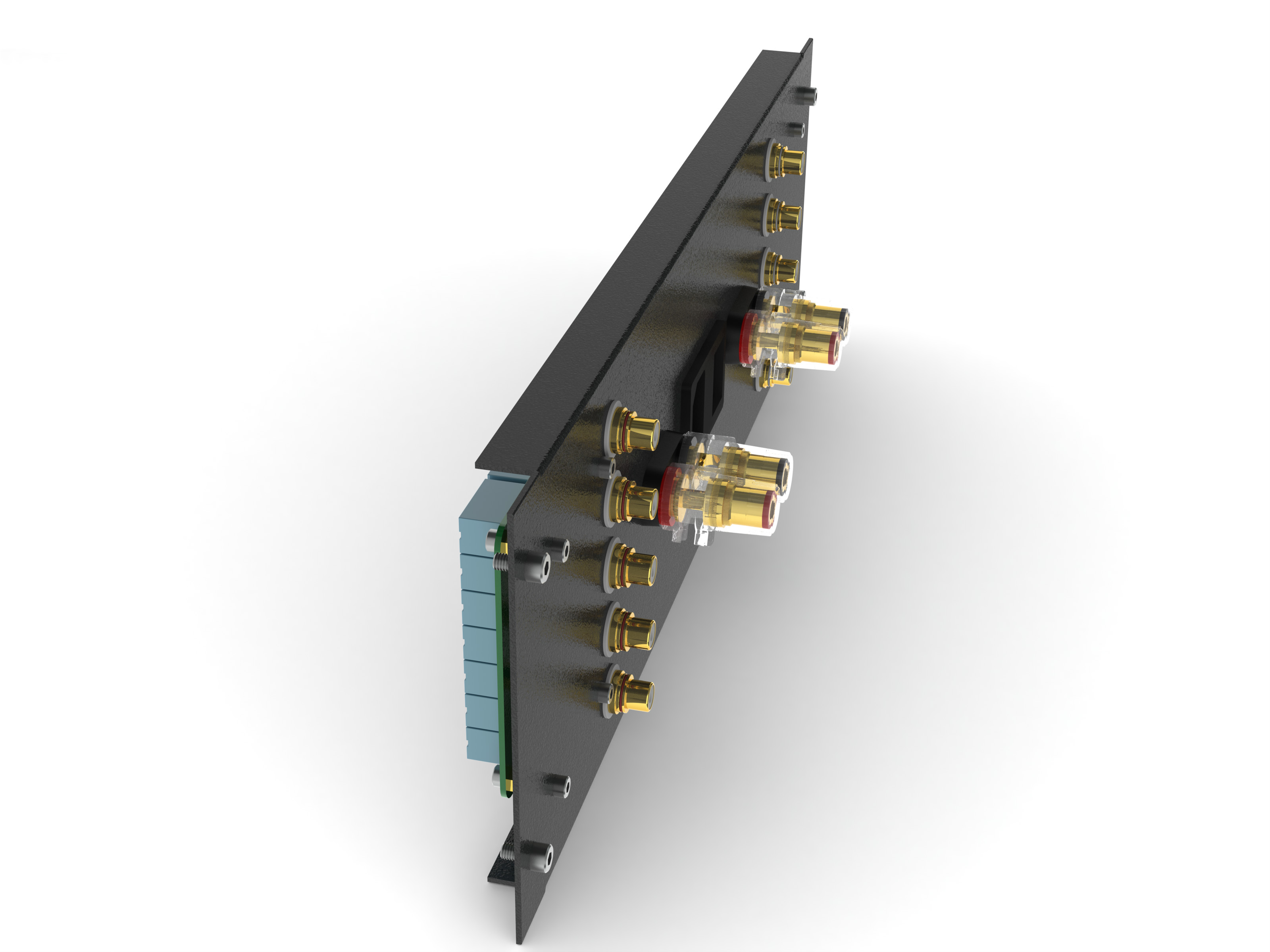

Well done for your perseverance & result. What did you draw the model with, it's a work of art on its own. 🙂

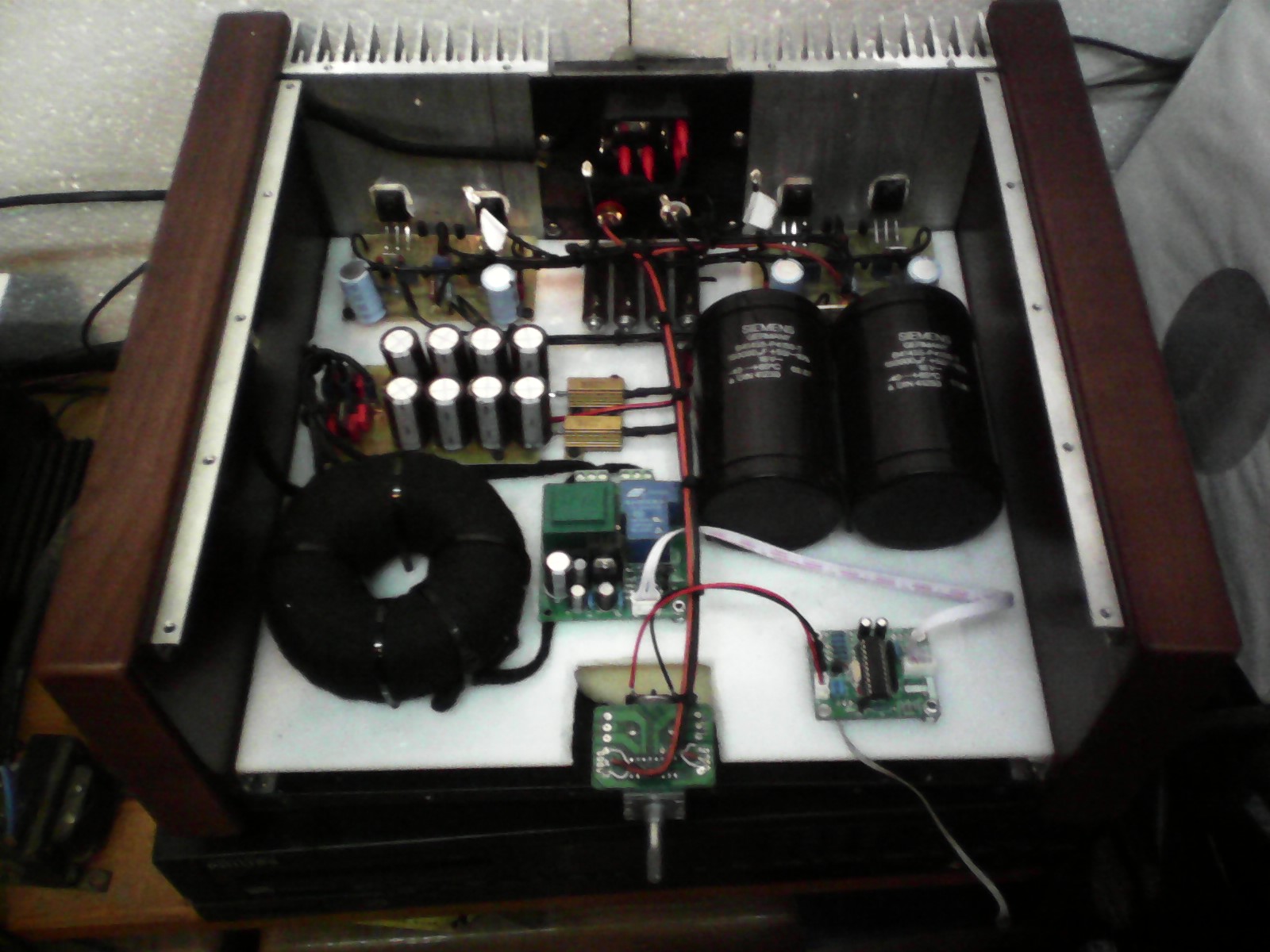

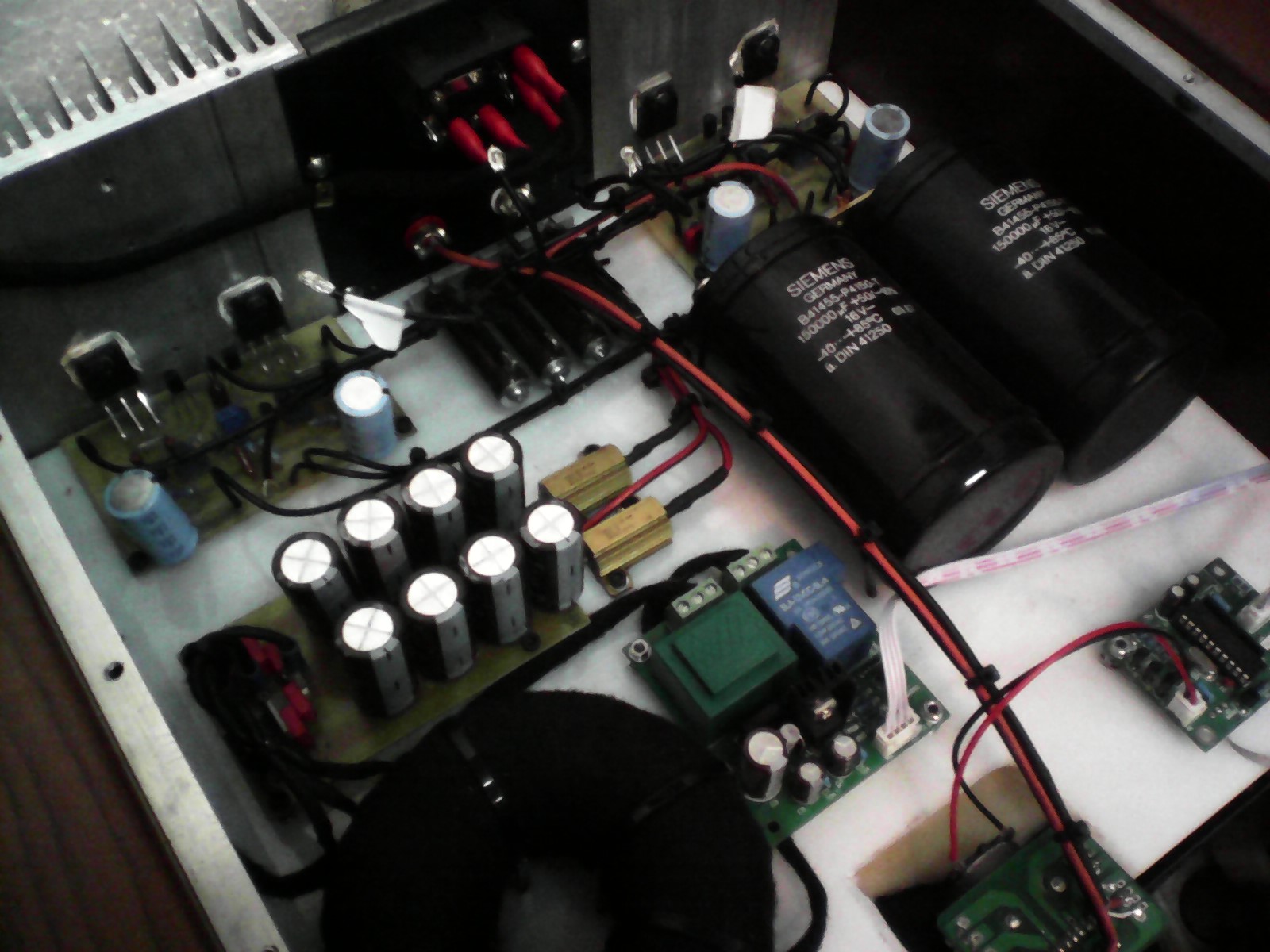

Hiraga Le Monstre 8W
This has a very nice vintage look to that design. Well done!
Thanks for job evaluation! I did it for an interior in Stimpank styleThat Hiraga Monster amplifier has a very nice and suitable vintage lookr!
Thanks )Well done for your perseverance & result. What did you draw the model with, it's a work of art on its own. 🙂
The model is drawed with Solidworks and rendered with Photoworks (I have tried to use Maxwellrender, but it was not succesful, because all file names are in russian language and Maxwell can't read it).
Here is some pics from Photoworks:
Thanks )
There great, did it take 3 years for the drawing & 1 year for the amp 😀
Keep up the great work

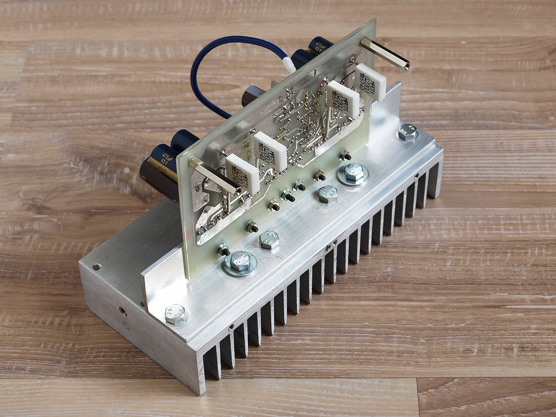

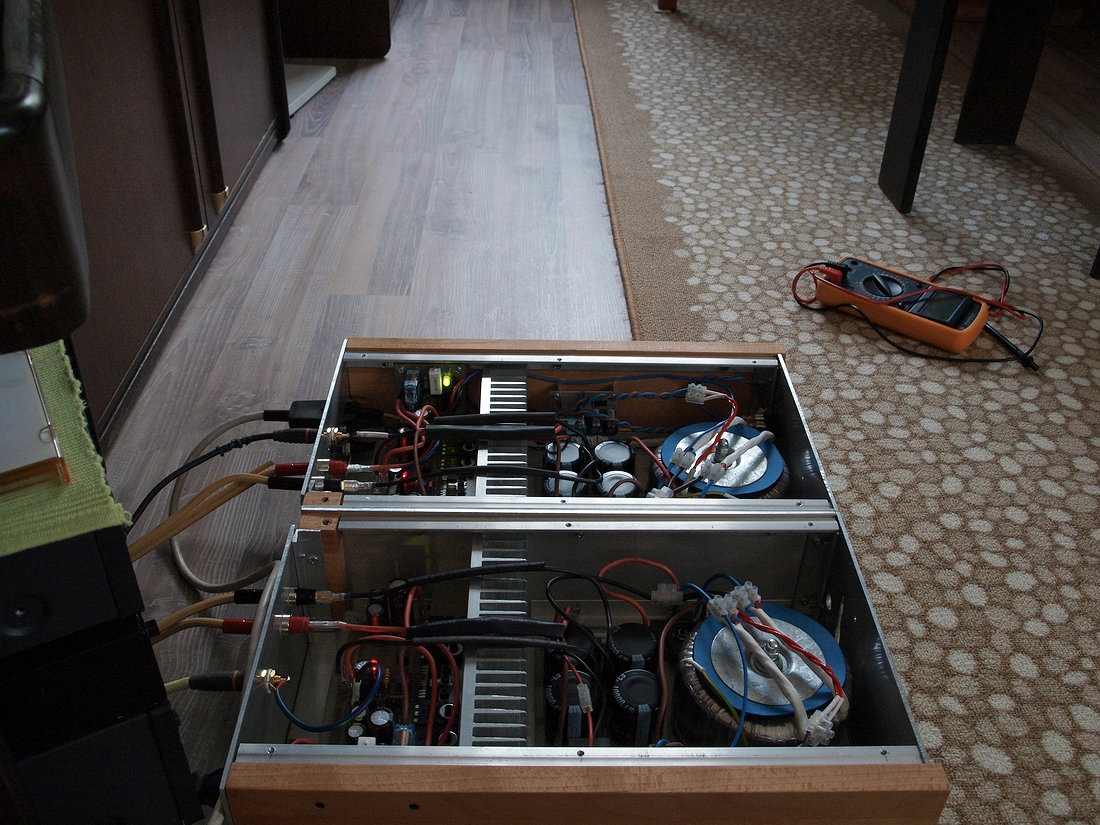

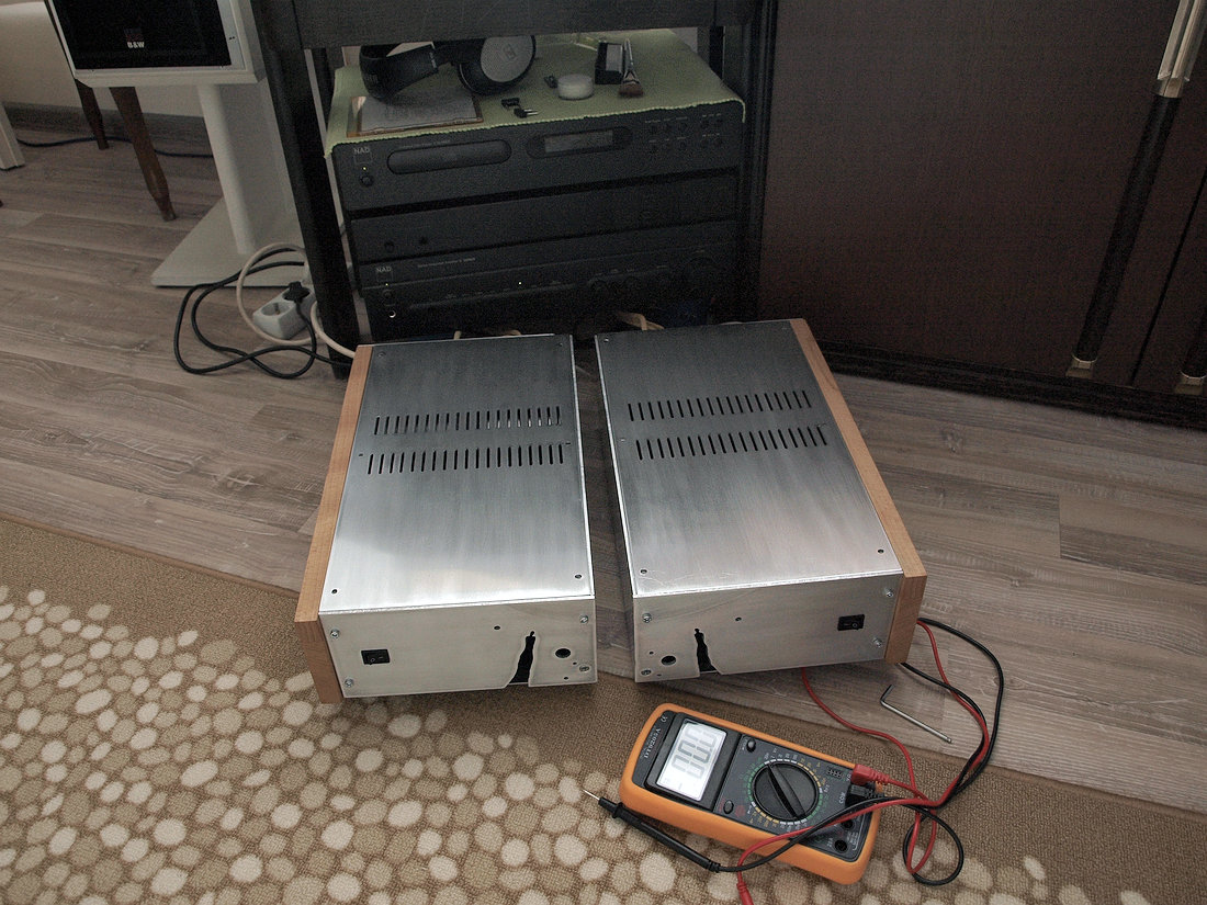

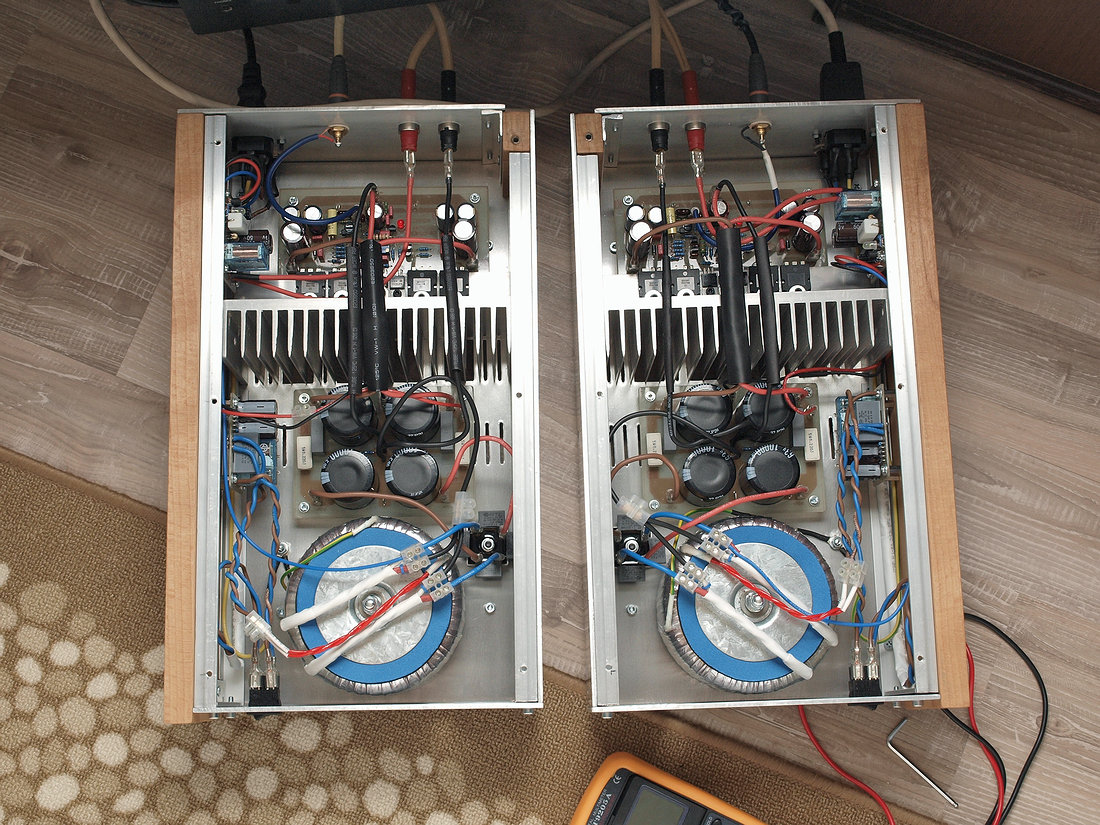

TECHNO power amplifier by Dr.Borivoje Jagodic

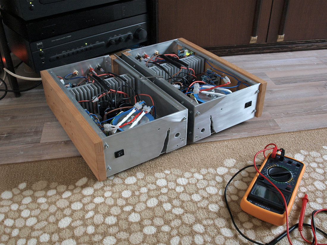

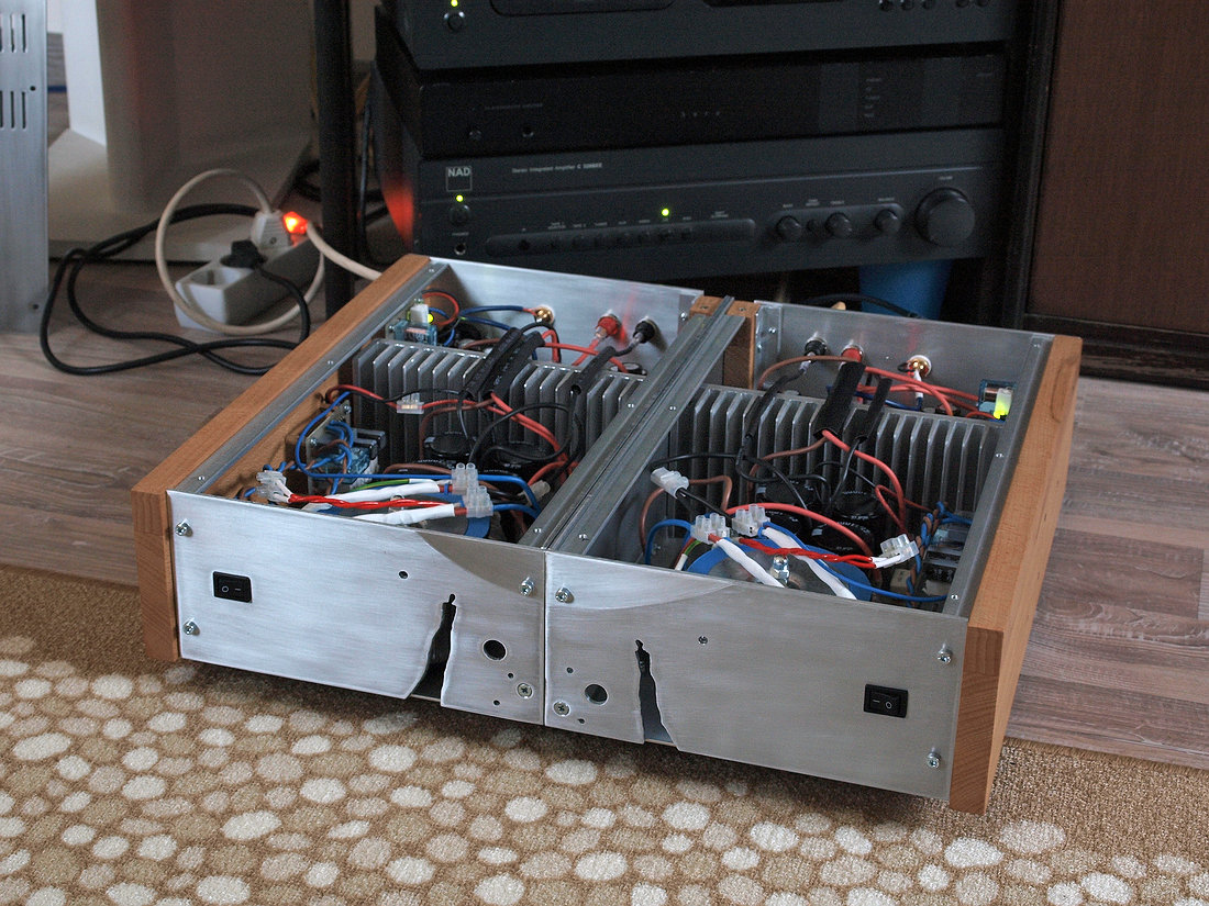

"Techno" is finished, just some details missing... Music is here: "Dusko Goykovich - Menina Moca" and everything is OK...
very nice Mr Kolja
layout looks much like my monos
but have become too dusty to show 😛
may need a rebuild it seems
very nice Mr Kolja
Thank you for your kind words!

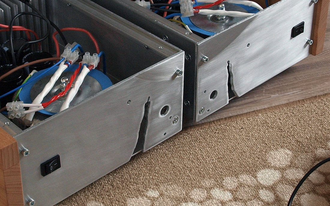

kolja, have to say, it is this picture I like most
Sorry for sending front plate unfinished... 🙂 Is this one better?
