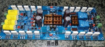

LM1875T (25W) x2 (using PT-40 to power), BTL mode (60W) is able by grounding the R-channel and sounds very nice for Bass guitar playing.

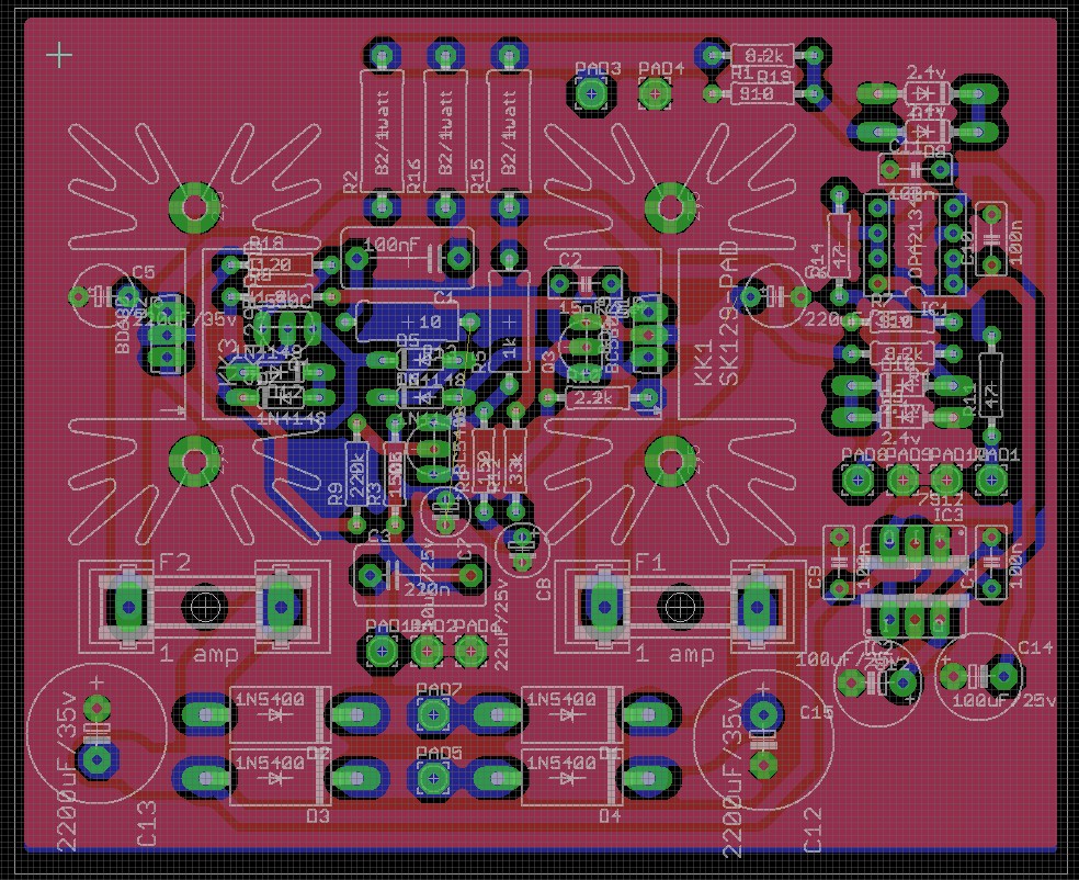

Is there a specific pcb program that is used for making this very nice board?

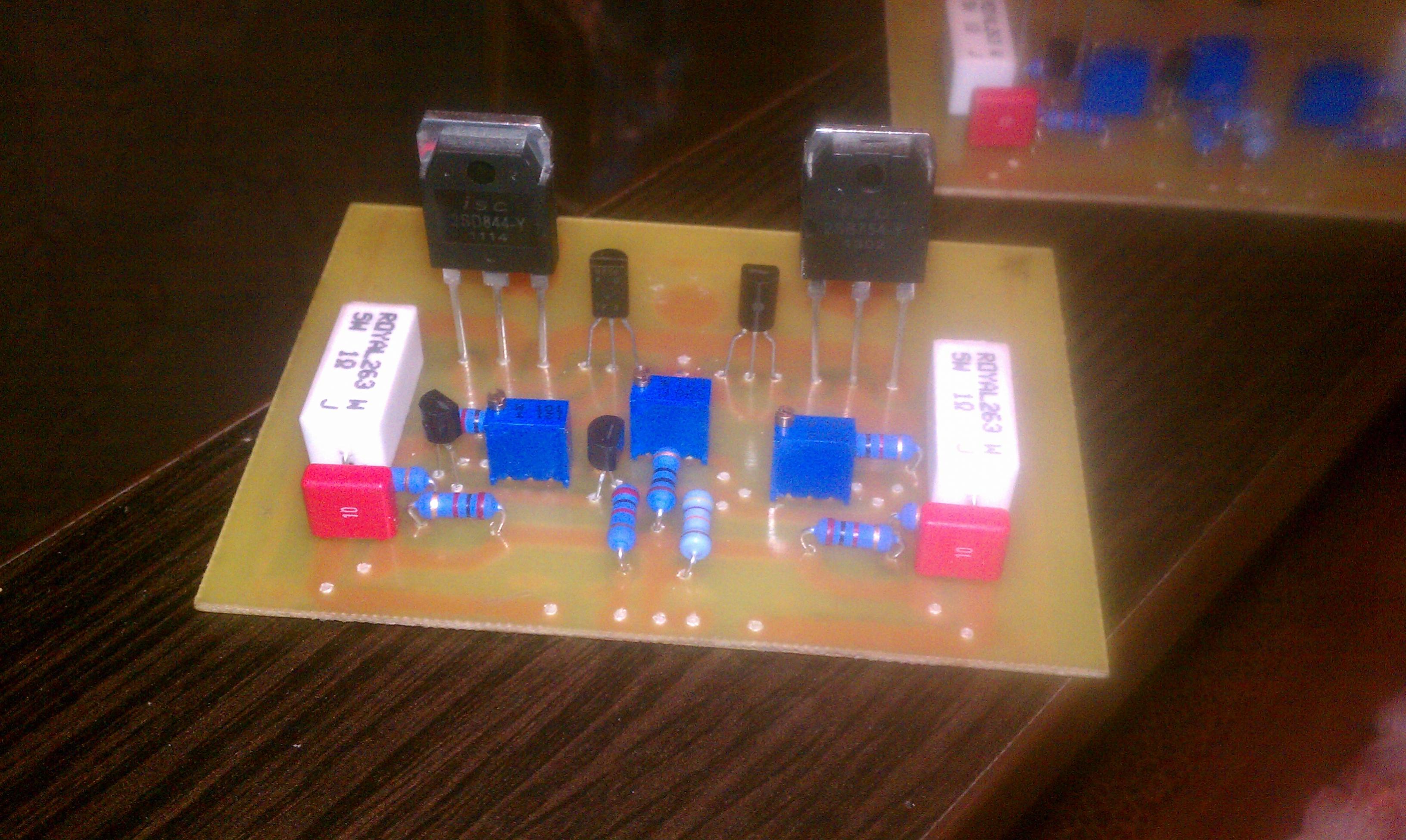

I have here done a pcb for a class B speaker measurement amplifier who get to be tested.

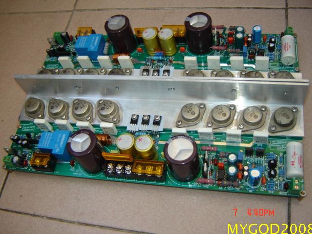

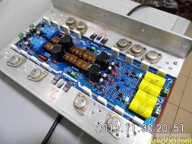

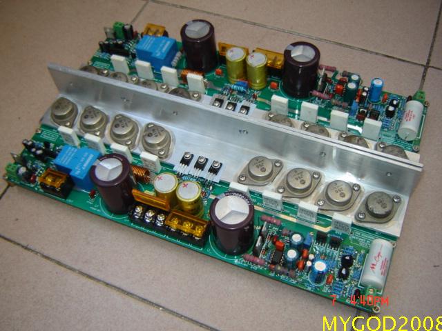

one of my amps
PHP:

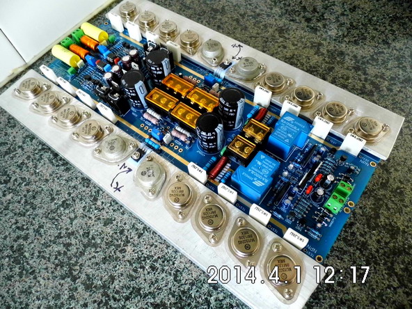

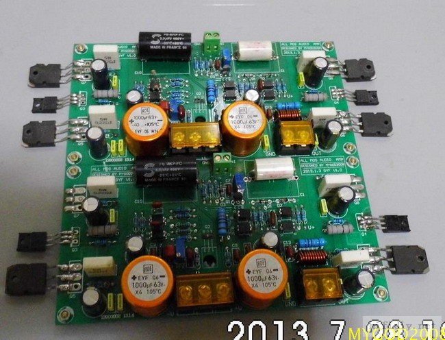

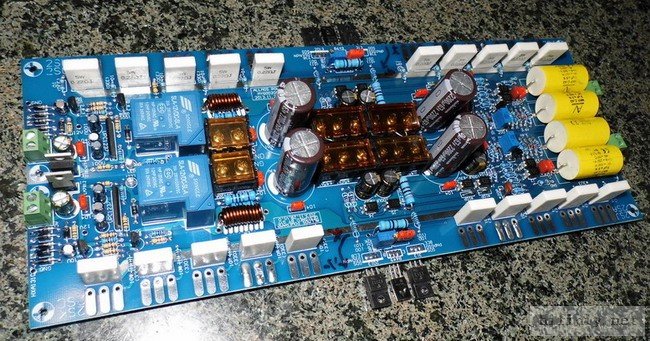

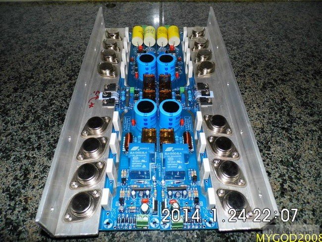

What is the power device e.g. 2N3055? or FET?
MJE15024/25 ,THE OTHER IS 2SK135/J50😀😀
Whose brds? Inerested in the bipolars (transistors MJEs...)MJE15024/25 ,THE OTHER IS 2SK135/J50😀😀
I HAVE ALSO DIYED THIS AMP TWO YEARS AGO ,IT IS CALLED SC-480

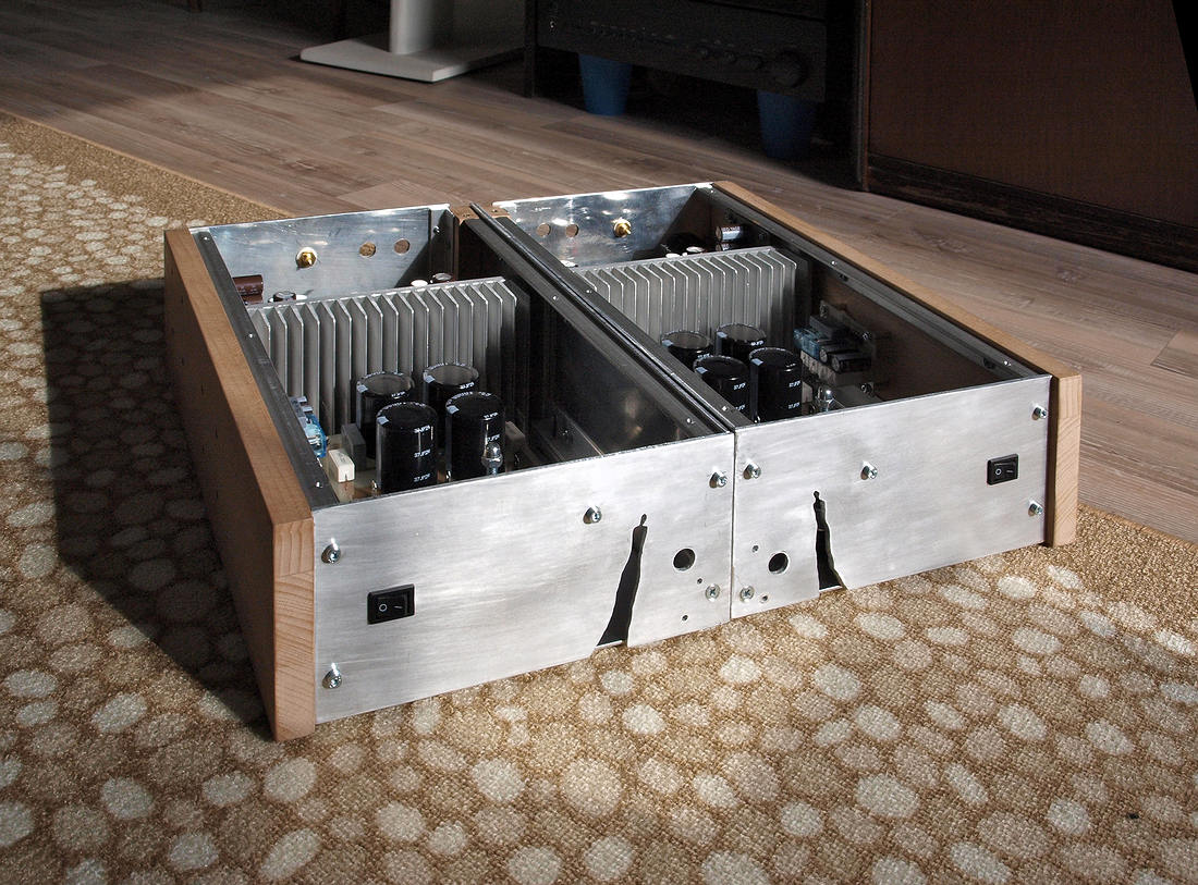

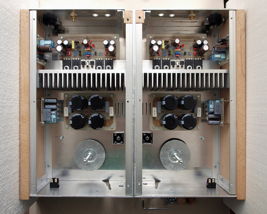

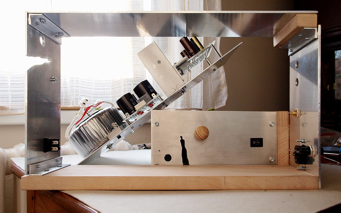

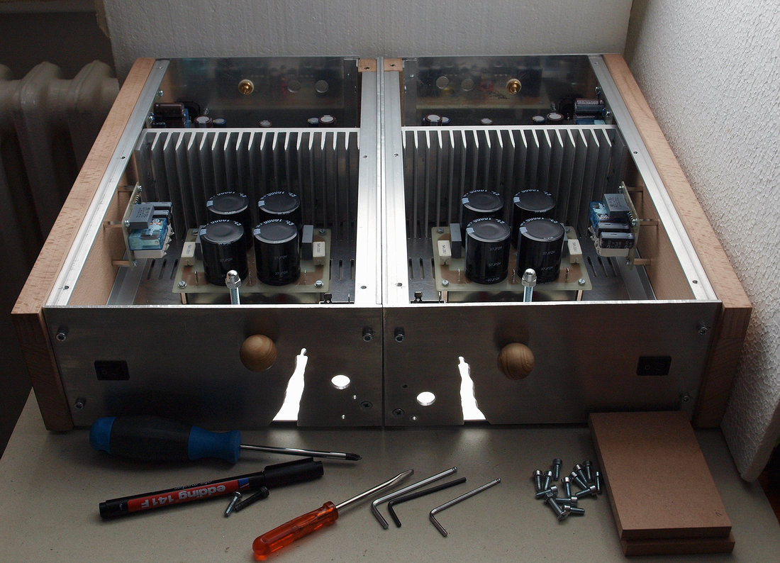

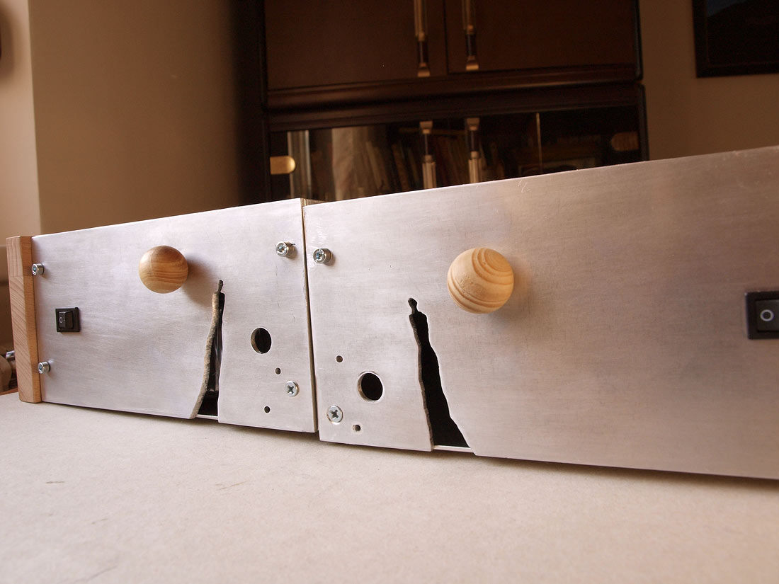

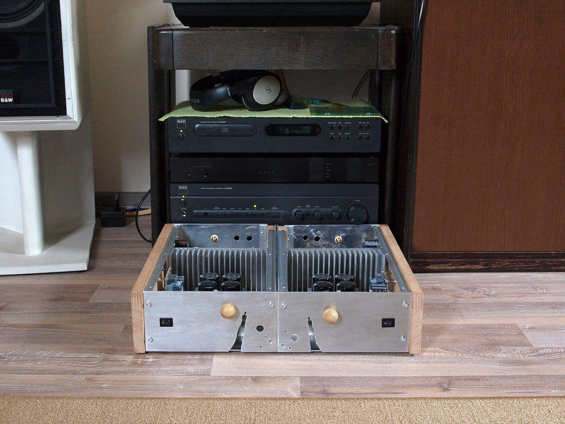

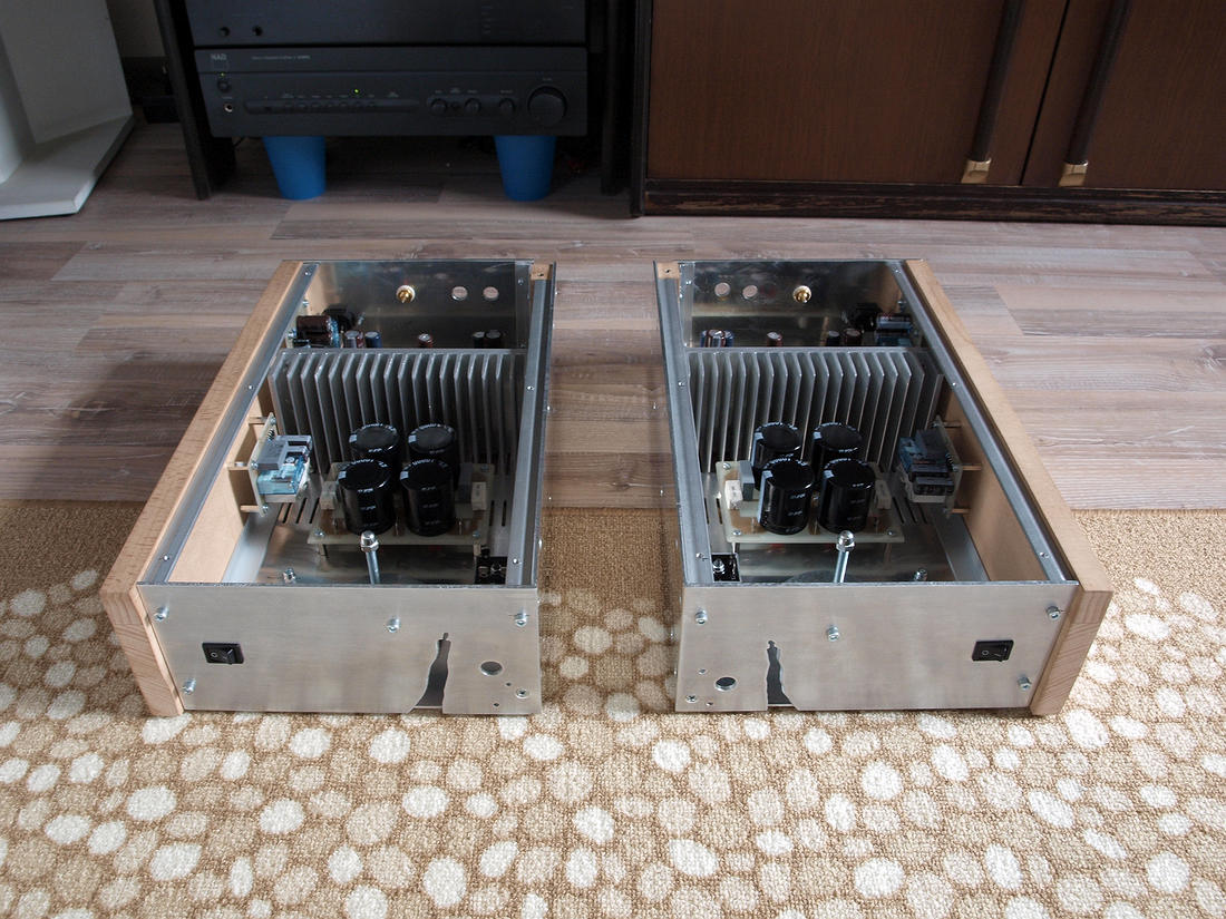

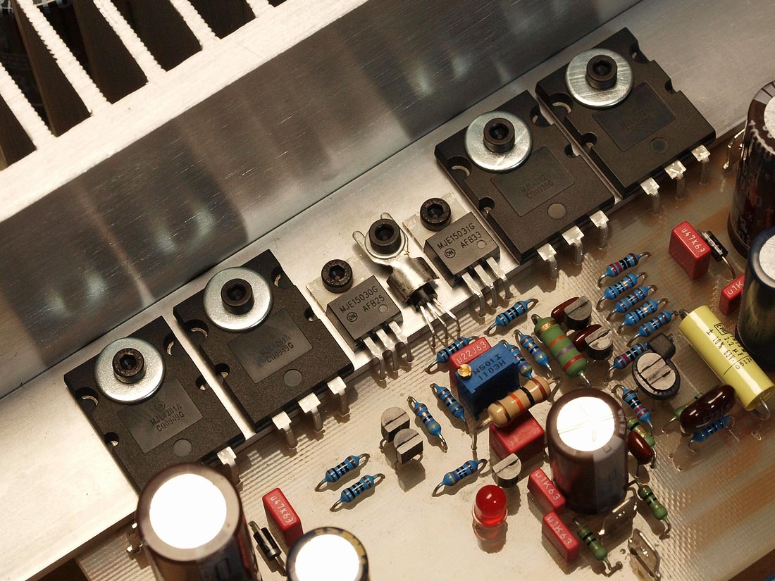

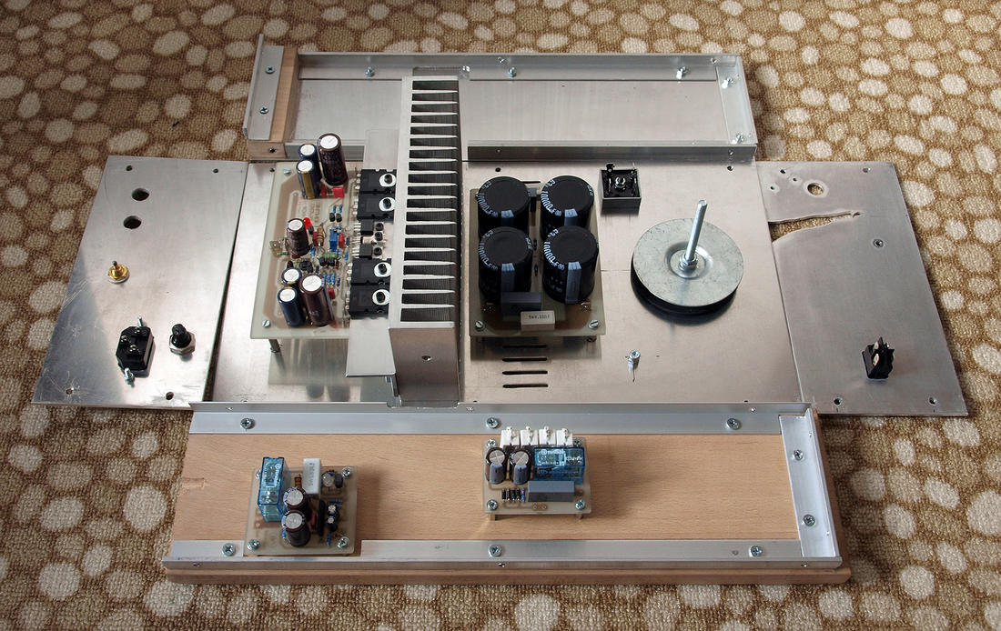

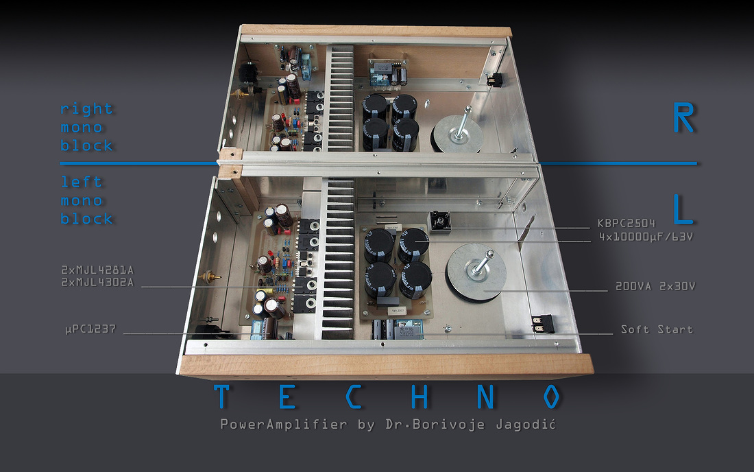

"Wireless" 🙂 TECHNO power amplifier by Dr.Borivoje Jagodic. Mono blocks still unfinished, but I want to share photos of my first DIY amplifier...
I don't see any wiring, so have you powered up those modules yet?
Because I don't see any mica or other kind of isolators on any transistors on the heatsink. And no thermal grease.
They may not be visible on the photos. But if they're not there and you have not yet powered up those modules, you might want to rethink this and double check for proper isolation, or your first diy amp might just blow up in your face. (unless you use the light bulb trick)

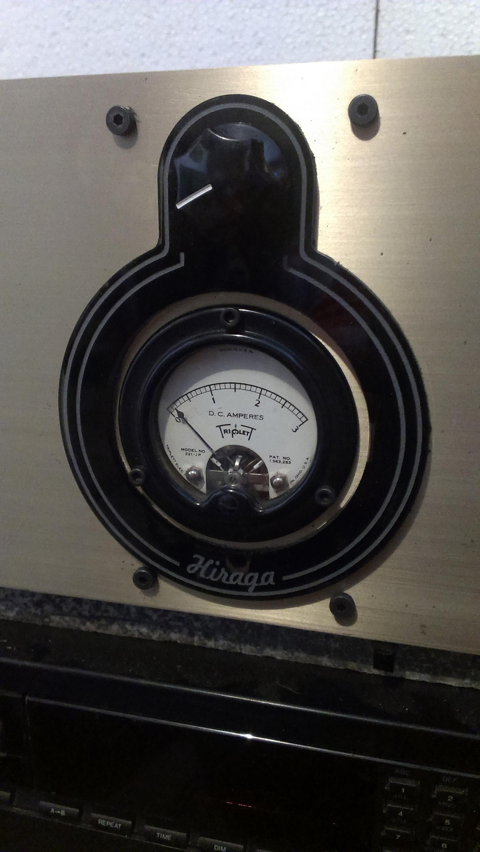

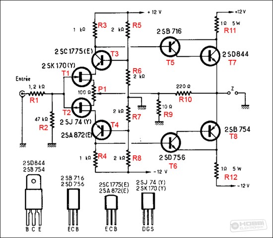

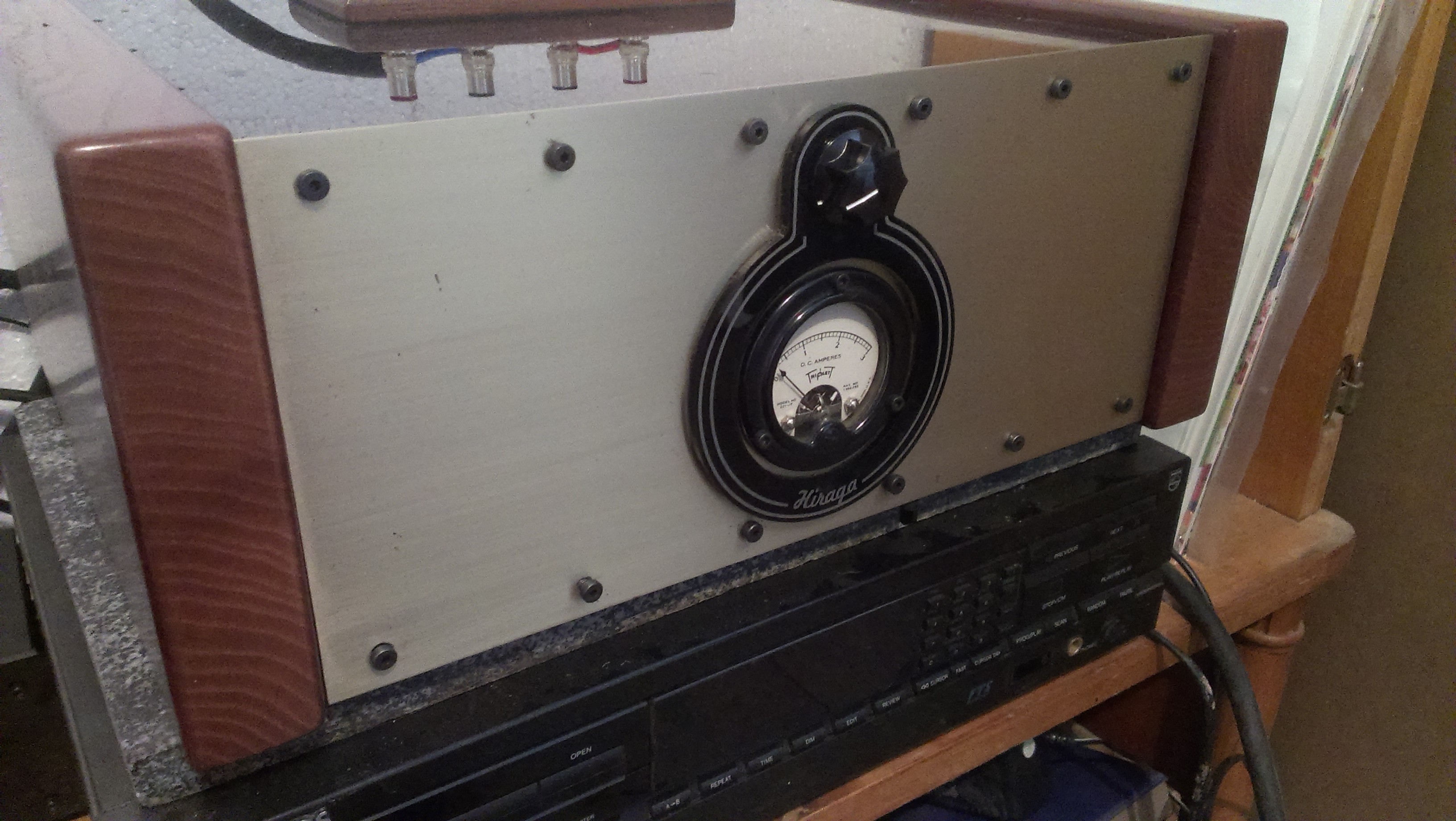

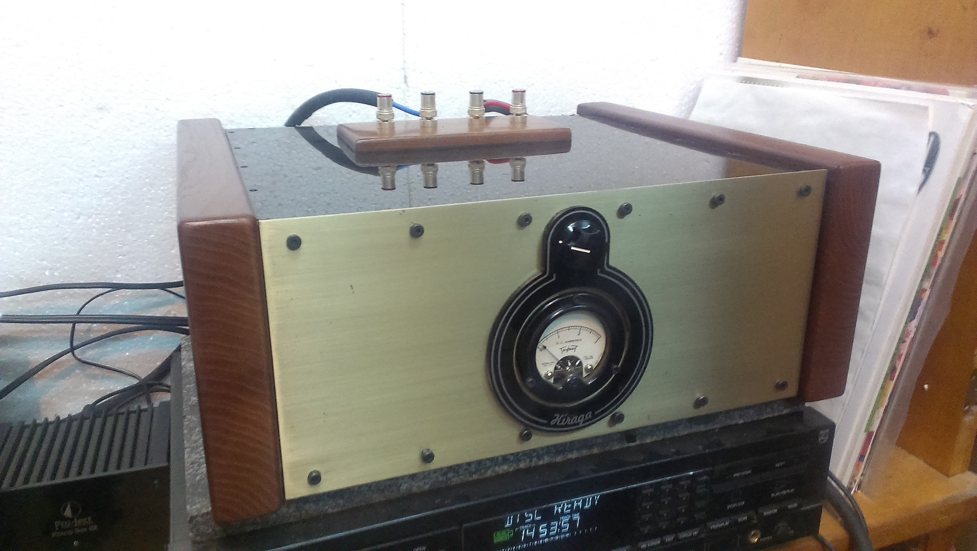

Tannoy 2528 in closed box 140 l.What kind of speakers will this drive?
Well, at least there is some volume behind it for somewhat low end better response. But those are coaxial full range aren't they? I wouldn't expect the efficiency much over 90db. It doesn't seem like this would provide much volume and for dynamic range, the amp would be pegged right away.
This is unfinished amplifier, so I made joke "Wireless" = still without wires... And still without thermal grease... 🙂
You tell it on the basis of experience and check or empirically? Hiraga perfectly controls 10" loudspeakers - I claim on the basis of experience of use)))
Control isn't the issue. What I was referring to is the sound volume that can be achieved with low efficiency speakers and such a low amount of power.
If you had speakers with an efficiency like 100db or more, then 8W is plenty, although it's good to have headroom to never clip on large transients, especially if the recording has a high dynamic range.
On low efficiency hifi speakers, commonly 90db or lower, then more watts are needed to obtain a good level of volume. So you must be listening at low level, always, or you'll clip right away and not get much higher sound volume. With classical music, you get by listening at low levels, but anything with a bit of a beat to it will require more.
