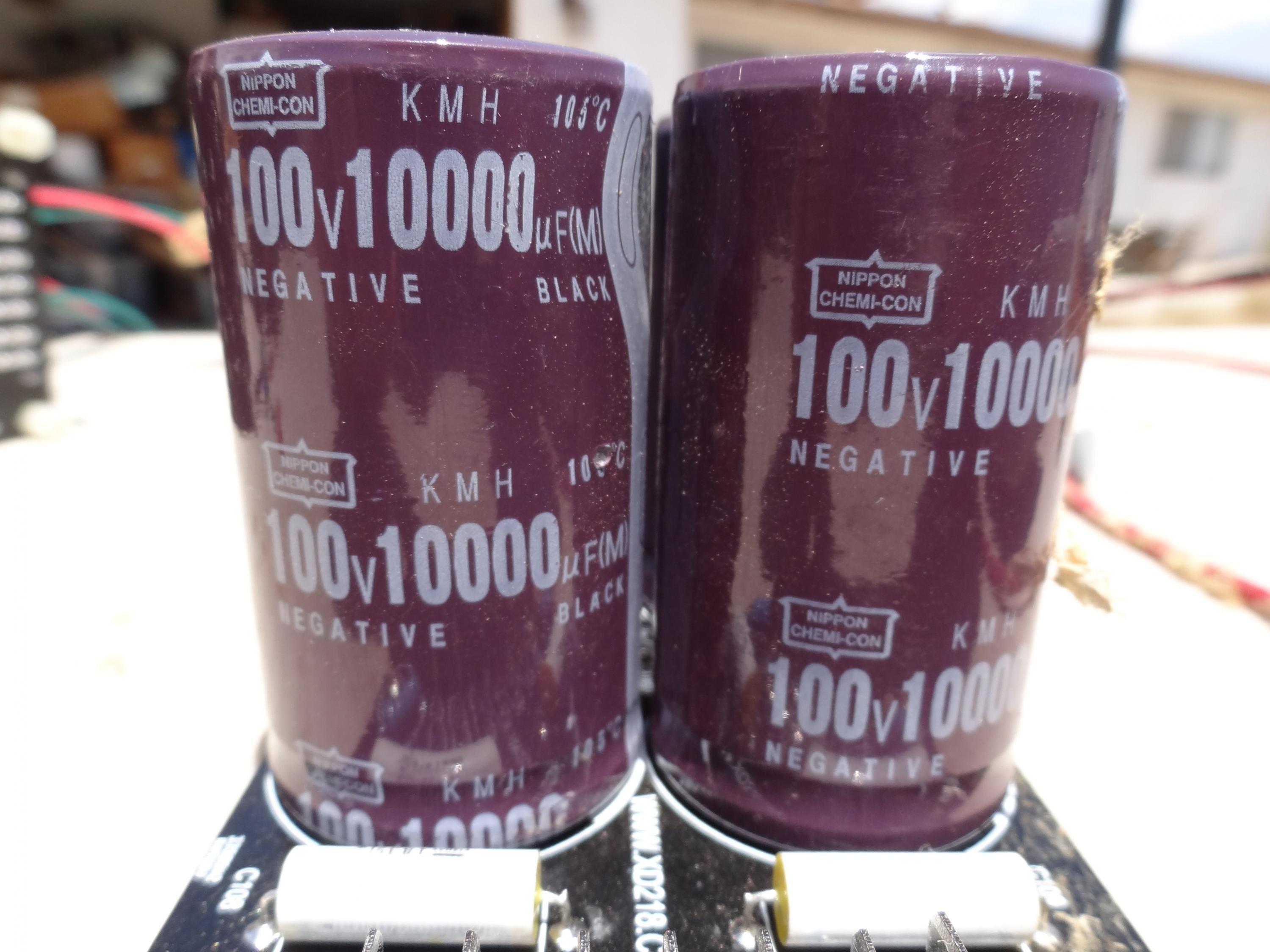

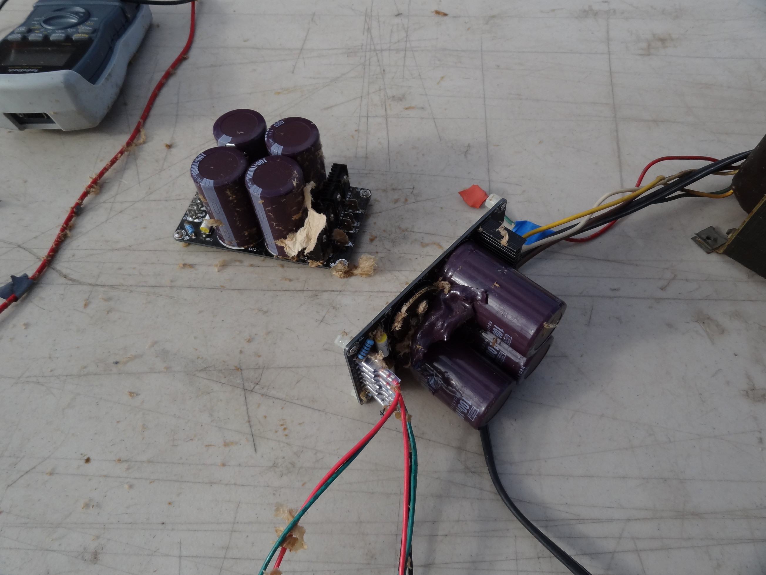

Lower voltage is OK but don't believe the 100V label. There is a reason you will only find these caps on ebay.😉 Doesn't matter it has a lot of total capacitance. The amplifier has a +-55V , maybe smaller voltage supply.

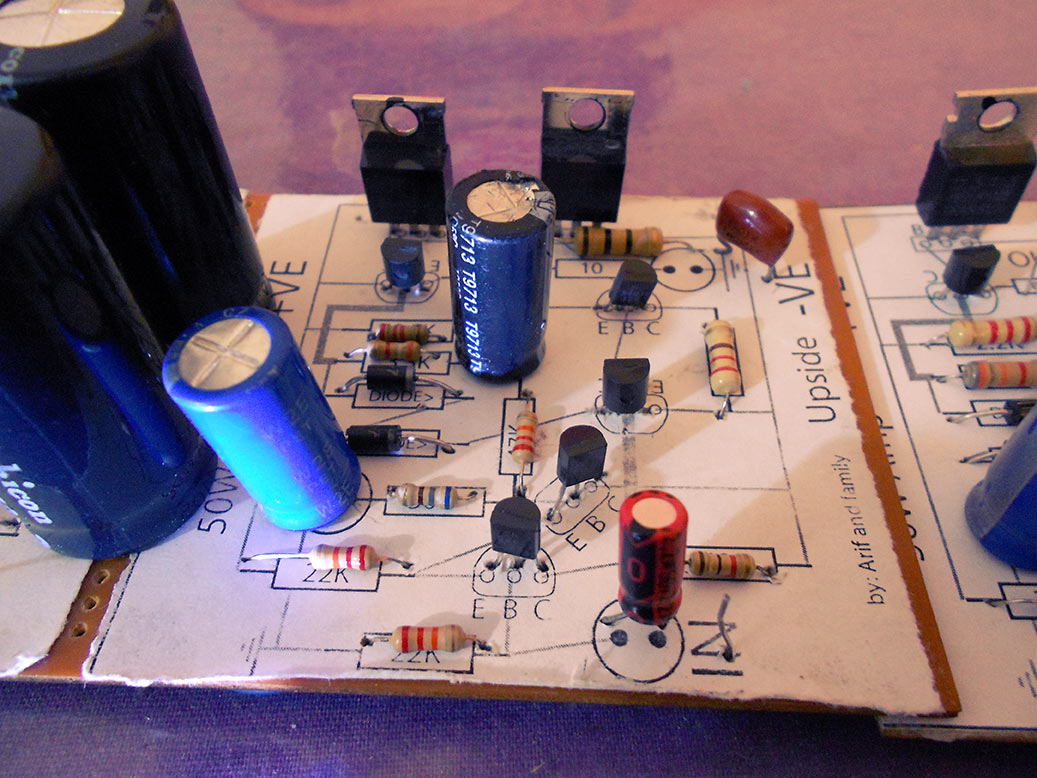

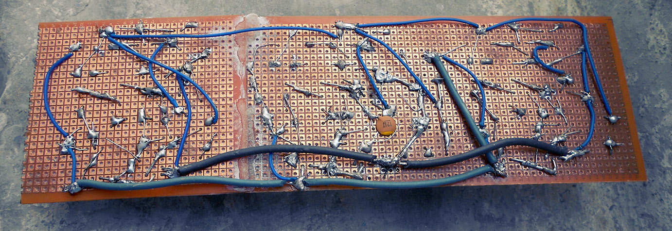

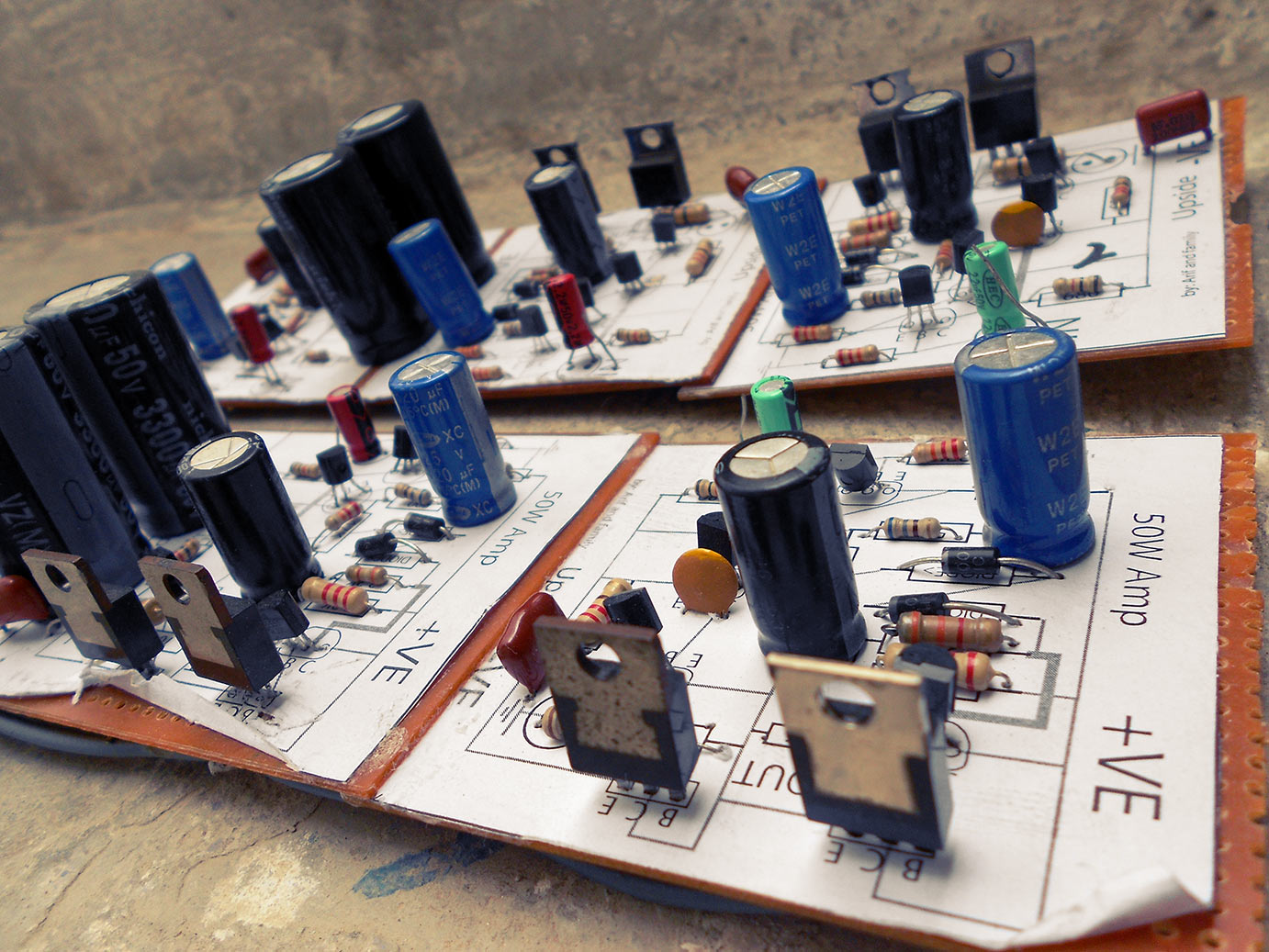

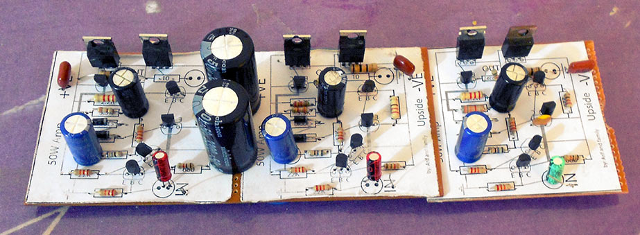

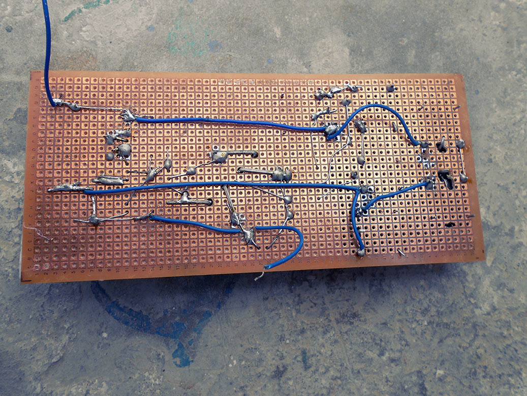

not even entry class beauty , but here is my way of doing things when i was unable to find it easy to print on pcb. Used veroboard and made design on paper to remember things. These are 3 channels using old 2SD313 2N5401 and 2n555. Giving approx 50 watts of power on +/-40 supply. going for 5.1 setup. If i got time after this one will go for better designs.
Joined 2009
I love the method used !
It can be seen in some old gear.
(Terry, you naughty boy)

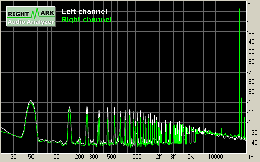

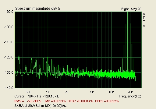

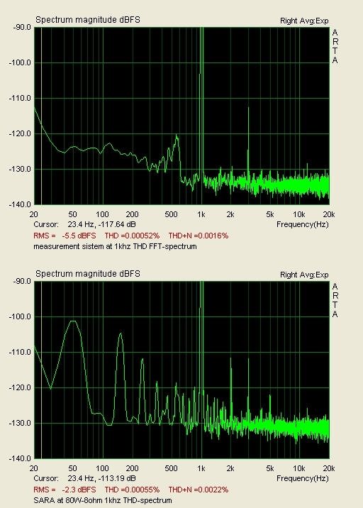

THD and IMD for SARA amplifier...

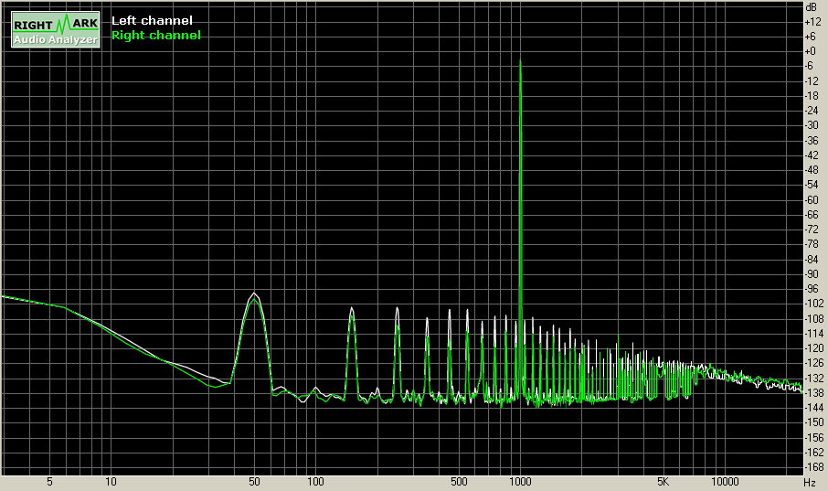

I can't read the THD due to the dominance of mains harmonics out beyond 6kHz.
THD aprox 0.0002% ; THD+N is obviously bigger, 0.001% if I remerber...
I was re-routing the cables inside the chassis, I was finding new position for the transformers and the noise going down a lot. After new measurements, we have a new results. Real THD at 1khz it is almost like in simulation, except 3th harmonic wich is generate in over 90% from measurement sistem. IMD-( 19khz+20khz ) with 1khz related product it is smaller then the noise. In simulation that product it is at -139dB from the 19khz+20khz signals.
In first photo it is the measurement sistem THD, in a second photo it is a THD of a measurement sistem + SARA power amplifier at 80W-8ohm.

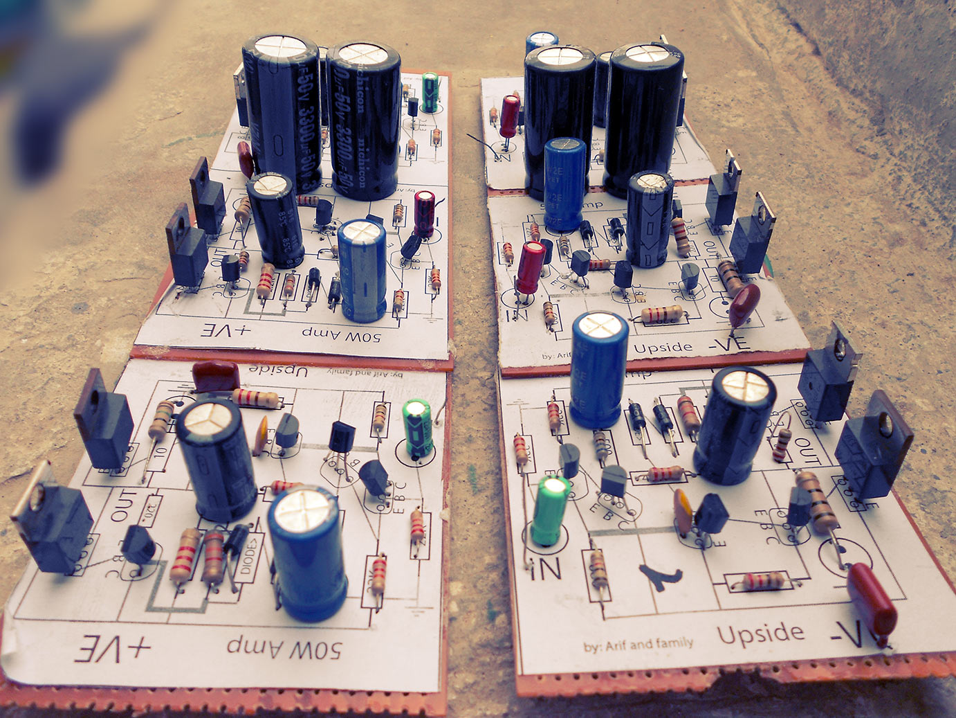

6 channel (5.1) amplifier

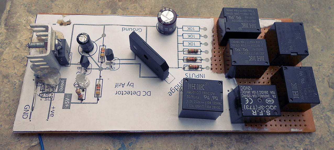

This is my "Jugaad Amplifier". Jugaad is an Asian word for "an innovative fix or a simple work-around".
Speaker protection circuits with relays for all six channels. working fine in initial tests and simulations.
6 channels amplifiers (no awesome pcb here therefor Jugaad )

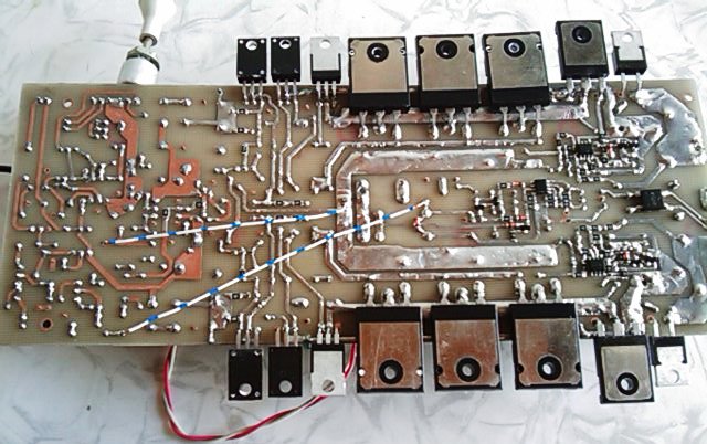

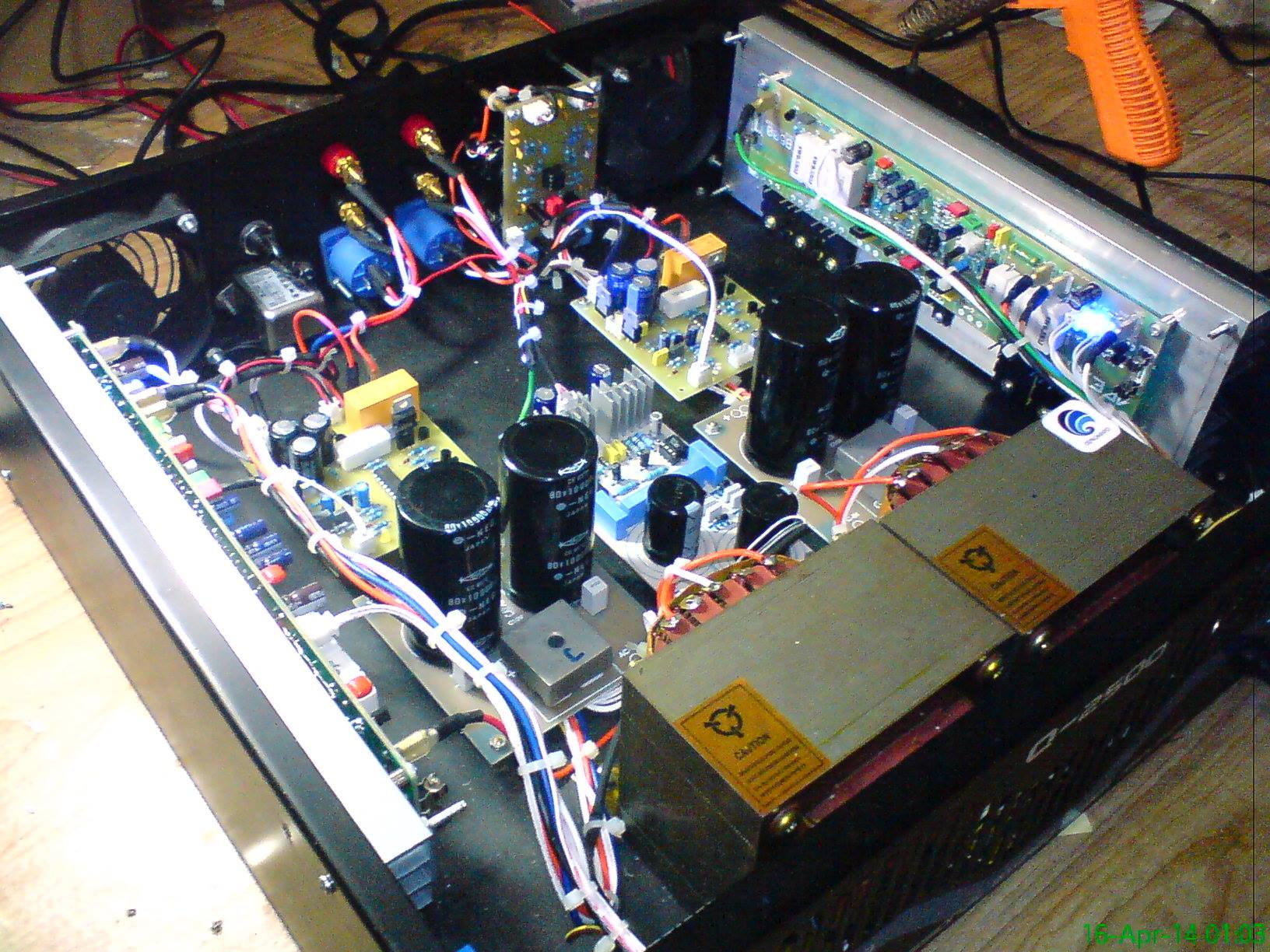

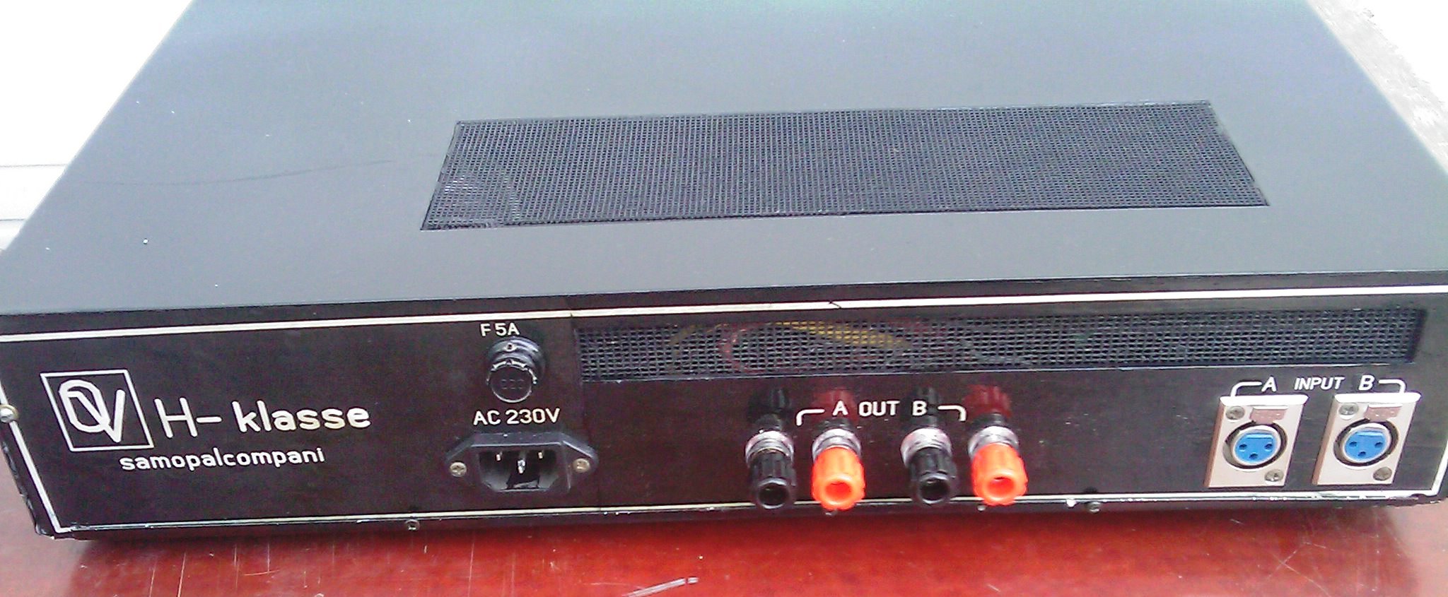

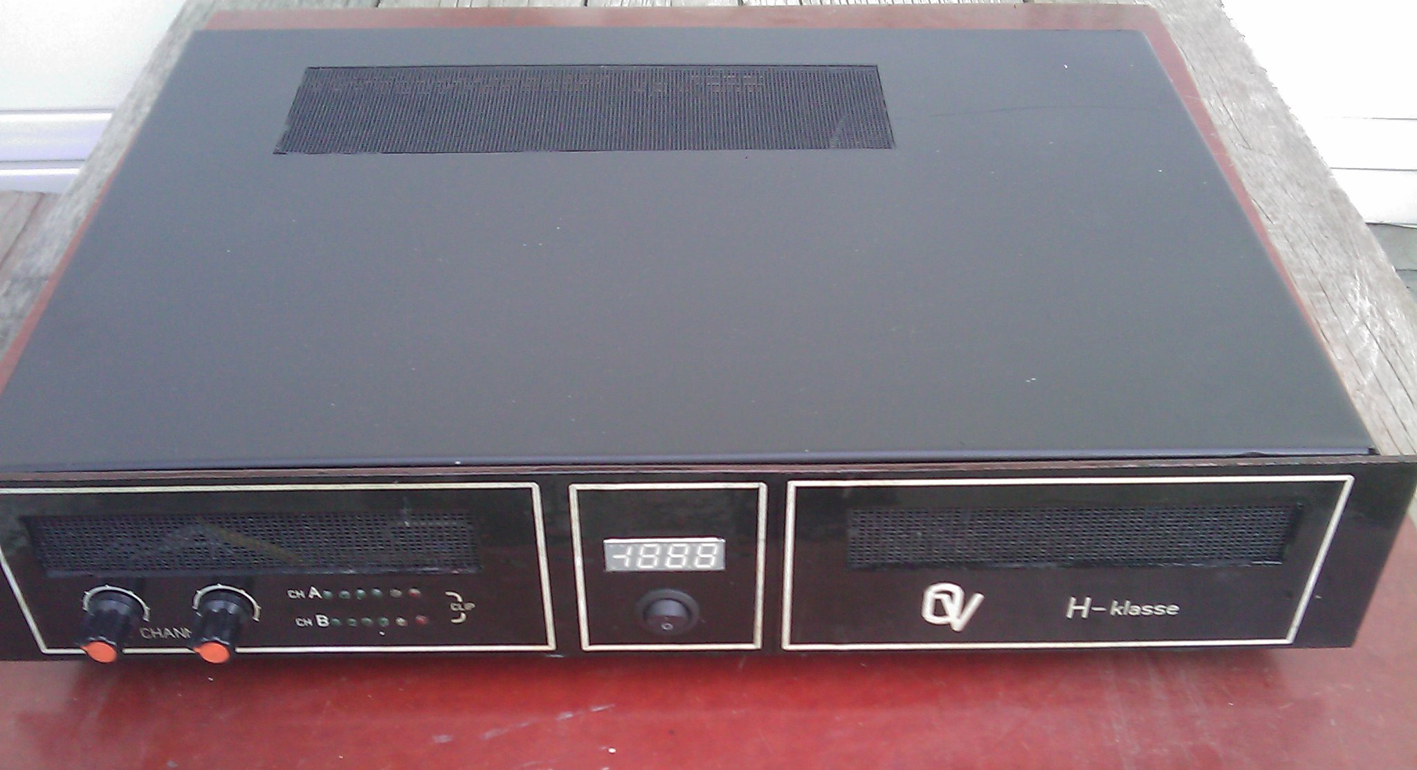

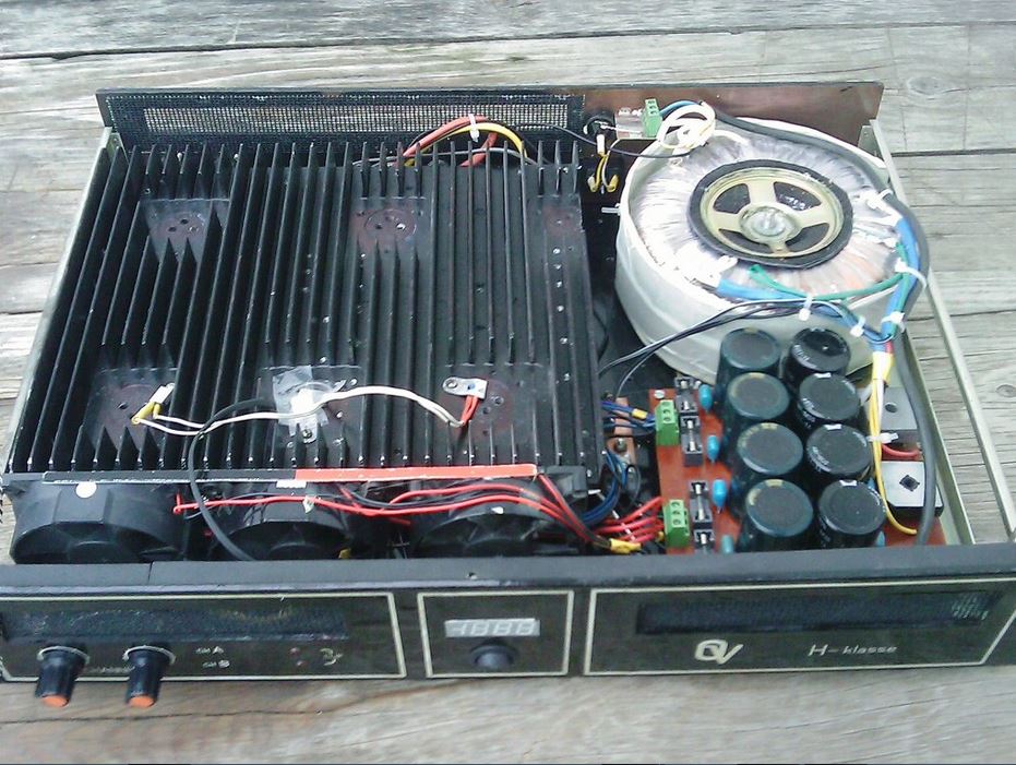

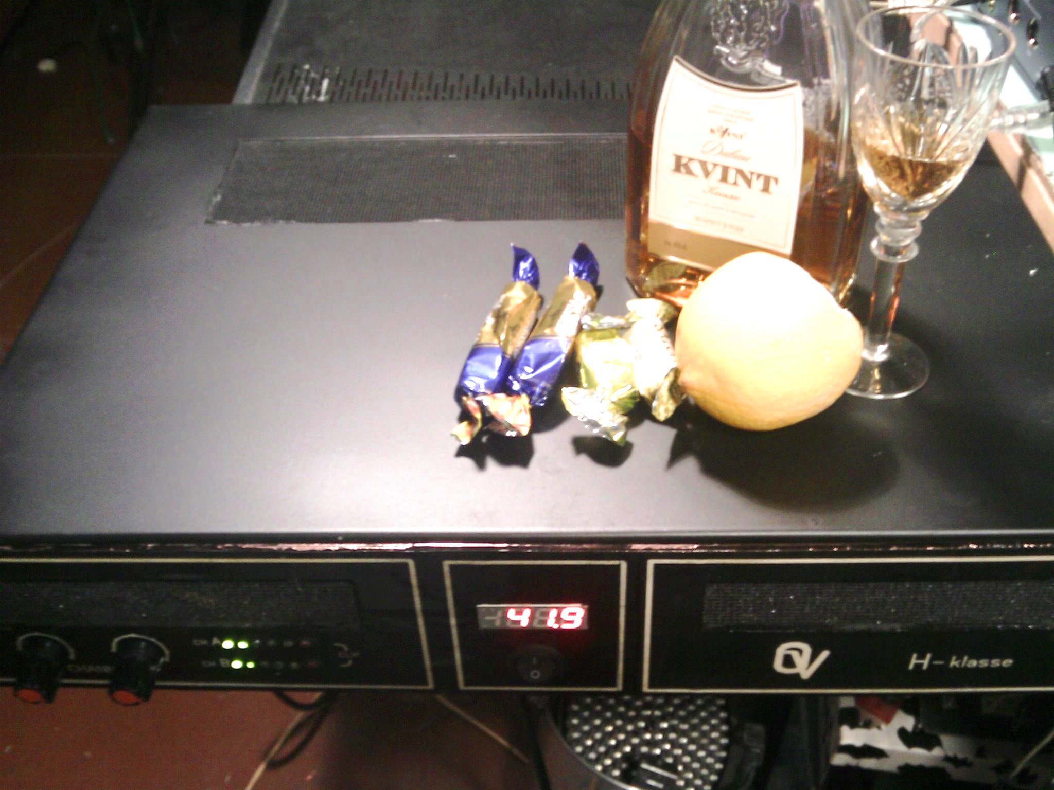

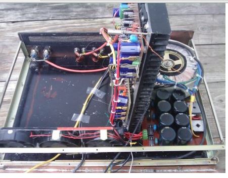

Natali PRO, H-klasse 500+500W, +50/100V, speaker protection, thermal protection, temperature indicator, clip limiter.

nice jugaad amplifier kit

Looks like a lotta power in a small case - impressive !
Interesting use of an older speaker frame to hold your toroid 😛
