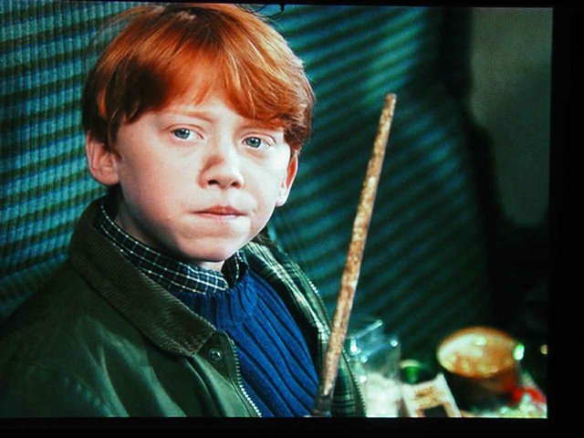

X1 DLP Screenshot
Thought you guys might want a shot of what you aspire to. This is with the X1 DLP projector (SVGA MMD) right out of the box, I know the colors need tweaking. Image size is approx 110" diagonal.
